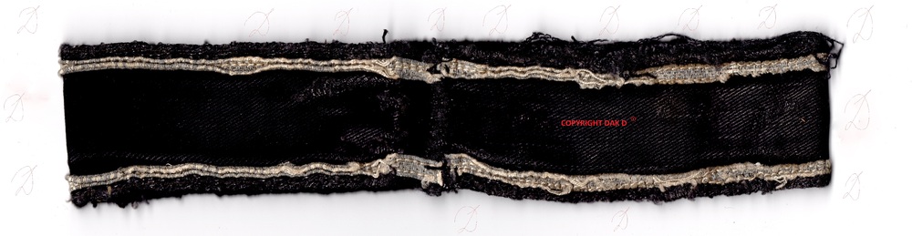

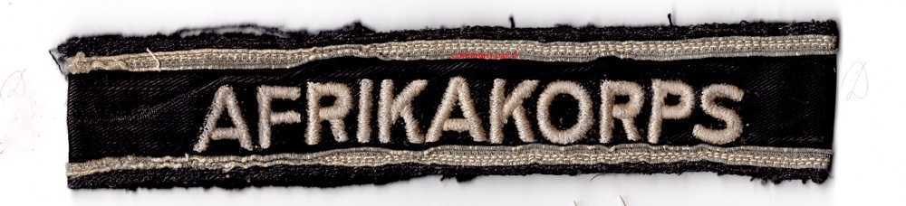

1/ Rare original, locally made black DAK cuff tilte.These rare black variants were probably locally made in Tripoli, or Naples whatever the case these original non - official versions are very hard to find and there are some fakes on the market.There a few different black DAK titles, but I will not be covering all of them in this thread for now.
1/b Reverse of the black "Afrikakorps" cuff title, showing typical rubbing and wear for a uniform removed title.
1/c Reverse inside showing the back details and the letters

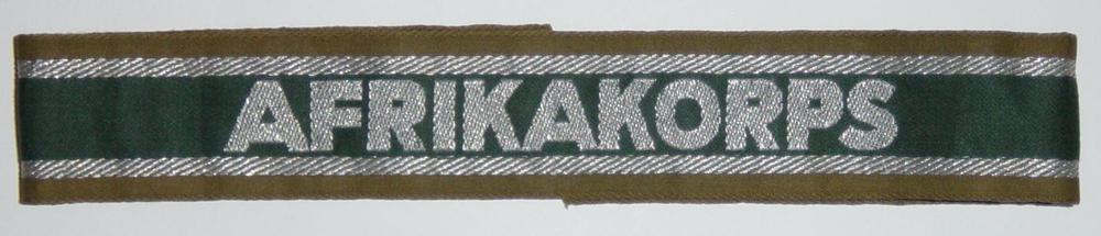

3/  This is the variant original "Afrikakorps" cuff title : note the inside shape of the top part of R & P are the same size. This version has been questioned by some novice collectors. However, it is a fine original variant title. This title is also fairly easy to find in Europe.
3/b The reverse of the original variant "Afrikakorps" cuff title, showing the construction of the letters and title. Note the R&P on this one.

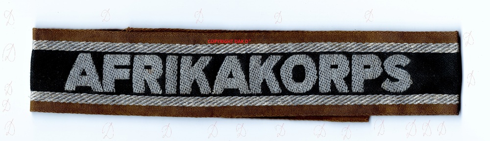

4/ Late original Tan/ Ginger variant of the "Afrikakorps" cuff title, there is no evidence these were ever issued to German soldiers serving in North Africa. These are the most common Afrikakorps cuff titles found in the USA today.
4/b The reverse of the Tan/Ginger Varient, showing the construction of the title and lettering.

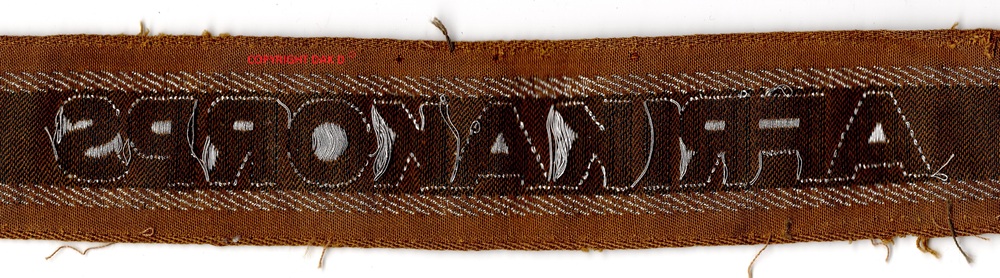

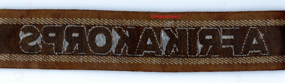

5/ This is a typical "Tartan Weave" fake Afrikakorps cuff title, that is also known as the "Diamond Back fake"
5b The reverse of the tartan weave fake
5c a close up view of the reverse

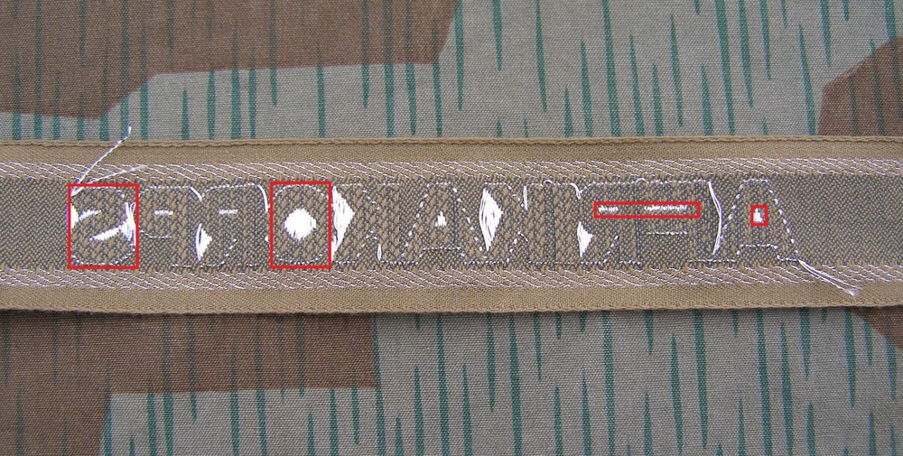

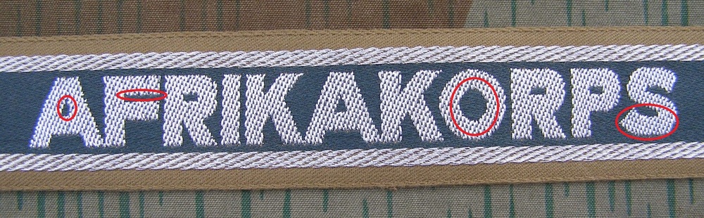

5/d Points to look at on the front of this well known fake.
5/e Points to look at on the back Note : the diamond back shape to the "O" and typical tartan weave.

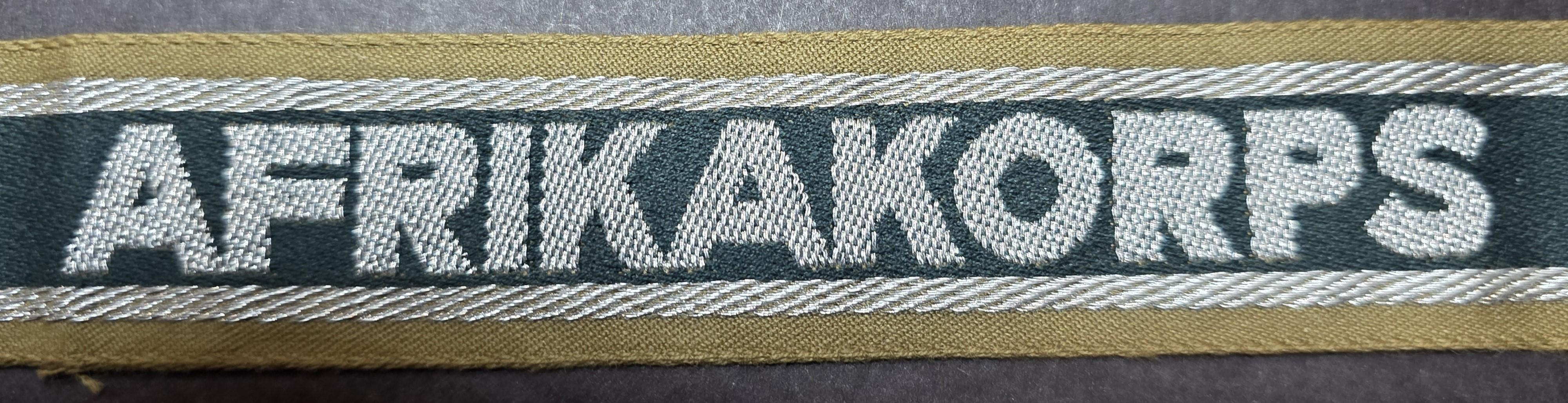

I am new here so go easy on me.  🙂

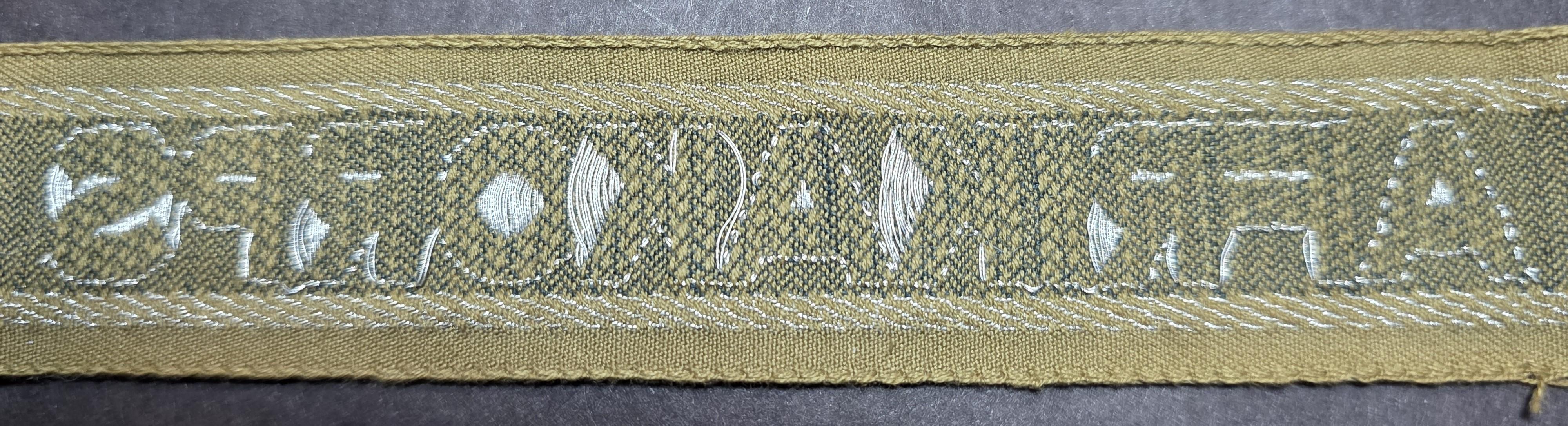

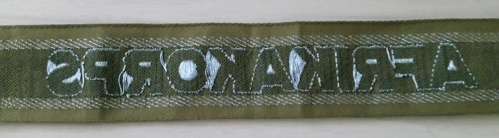

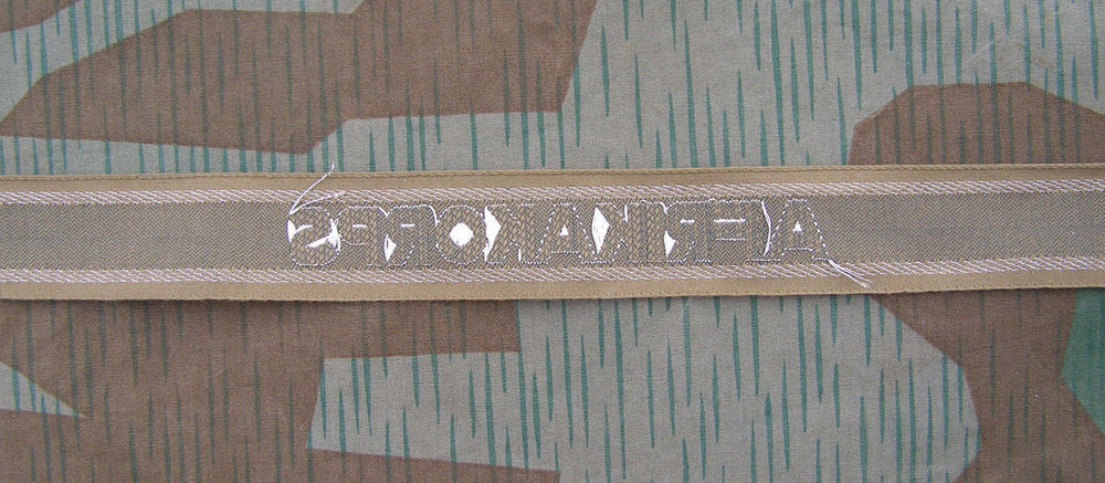

DAK D, excellent post and references!  I am a bit confused with the last two original examples and the reproduction.  At face value, I can see what you are saying, but I have an example I got back in the early 1970's (see photos} that have some differences from the repo.  I hope you can fill me in on the attached photos:
1. The Reproduction's silver rapped thread making the words AFRIKAKORPS are clipped off at the letters A and S (on the reverse).  Your posted original photos and the below example does not.
2. Also on the reverse, the thread jump between the letters R and O is at the bottom of the R, all the examples you have posted with this version of the cuff title jump from the top of the R.
3. The last photo show the cuff title is made with left hand thread.  Left hand thread was very common in war time Germany (right hand thread was scarce).  For the last 50 years, left hand thread seems to be very rare.
4. My photos appear to show a diamond back letter O.
I am aware that all of the different reproductions being made are making it a nightmare at times for authentication and my attached photos are likely of a reproduction.  Hopefully you can see my confusion.  Thank you for entertaining my observations.

Hi @cageybee91, the diamond "O" stitching on back side is used on reproductions. The "O" should be round on the variation type cuff title. @DAK Dwas my mentor on all things DAK and is a good friend. He taught me what to look for. Hope this helps!
