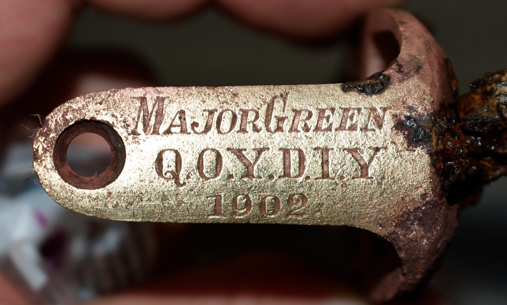

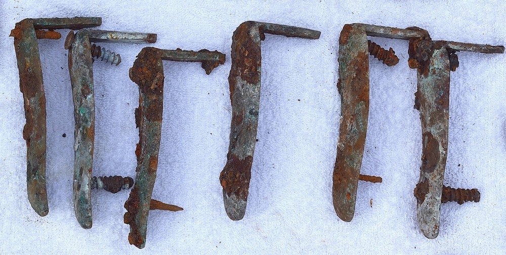

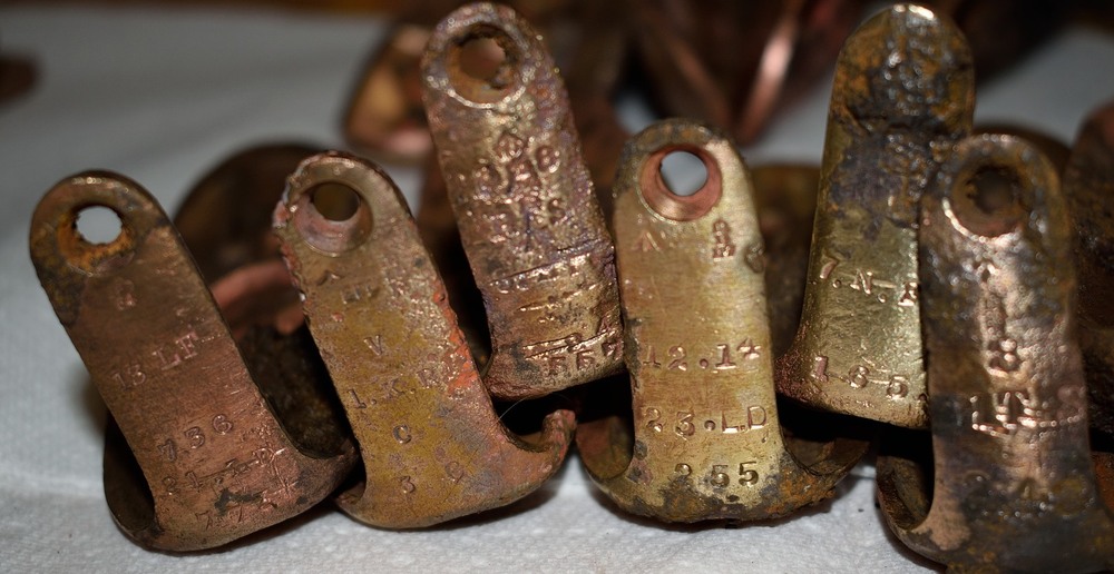

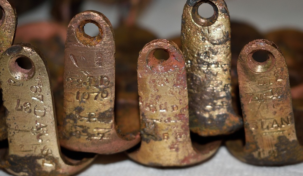

Steve T Posted December 10, 2016 Posted December 10, 2016 During a recent trip to the British army dump site permission of mine, a fair few Long Lee butt plates were, once again, recovered. The tang on these butt plates are nearly always marked with unit identification letters and numbers. However, during cleaning, one was marked with something totally unexpected and caused a huge amount of excitement. This is how they looked after an initial clean. And then after something a little more intensive.... The tangs usually look like this... But NOT this one !!! After some frantic research on the internet, the descendants of Major Green were traced, and I have now spoken to his great nephew. I was pleased to find that he was as excited as I was and is soon going to be in possession of a small piece of his family's history. QOYDIY - Queen's Own Yorkshire Dragoons Imperial Yeomanry The history of each item I recover is so very important, and people sometimes find it hard to understand why I don't sell anything I recover. This is exactly why. Every relic recovered is a little piece of history, not something to be sold to the highest bidder. They are recovered and preserved so the history can be shared with future generations or, in this case, members of a serviceman's family. 3

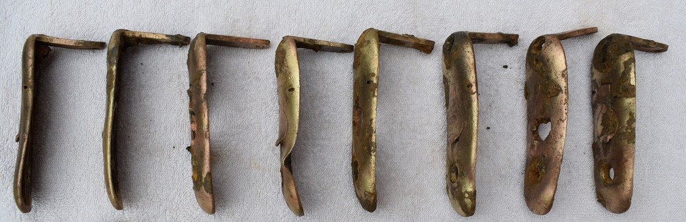

Desert Rat Posted December 11, 2016 Posted December 11, 2016 Hello Steve, These have come up Superb! after cleaning them...what method did you use please? Desert Rat
Steve T Posted December 11, 2016 Author Posted December 11, 2016 Step 1 - Smack with a hammer to remove all big chunks of rust Step 2 - Scrub with stiff wire brush to remove as much mud and leftover loose rust as possible Step 3 - Soak in a 10-20% solution of citric acid, using very hot water, for at least 12 hours Step 4 - Remove from citric acid, rinse, dunk in strong sodium bicarb solution to neutralise any left over acid Step 5 - Dry Step 6 - Whizz a wire brush attachment on an electric pillar drill all over the item Step 7 - Take photos as they now look awesome. 1
