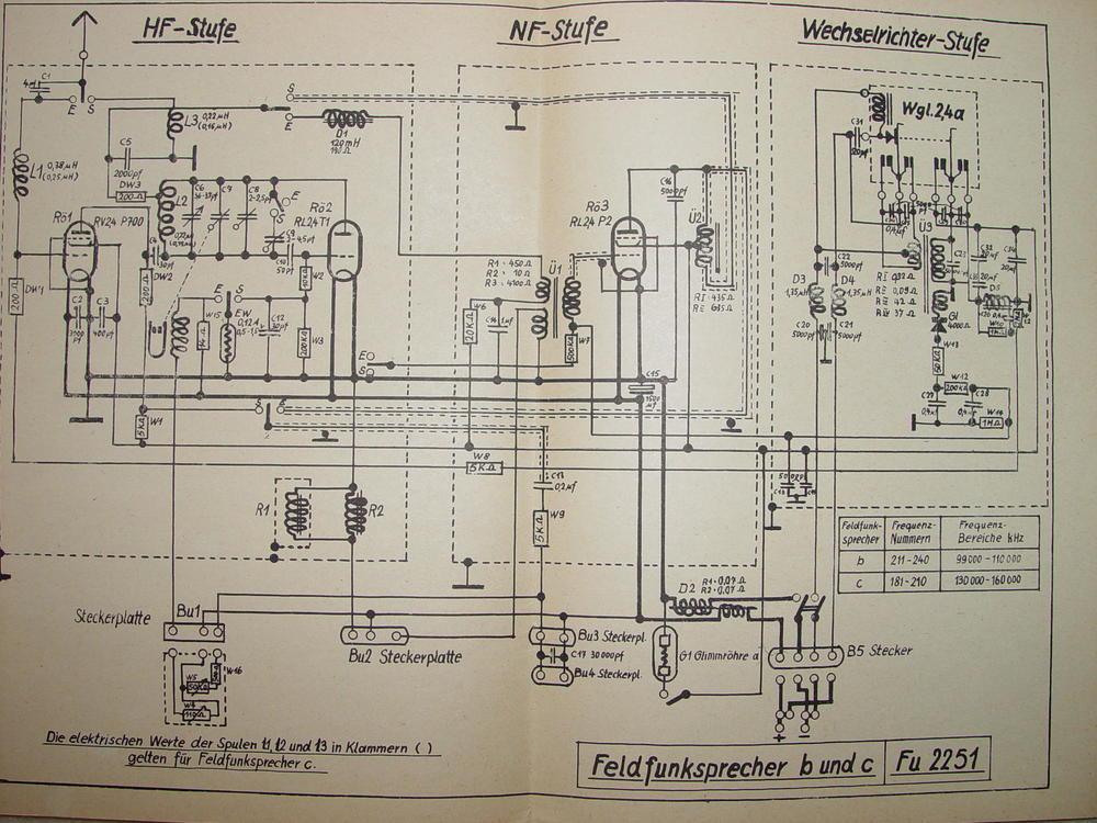

 A quick look at the schematic shows that the only electronic differences between the b and c versions are the values of coils L1, L2 and L3: DSC00497.thumb.JPG.fe98a04cba3c8072f818507928d7ee3a.JPG
With these different coils, the Feldfunkspecher.c (Feldfu.c) operated from 130 to 160 MHz, which partially overlaps with the FuSp.a.1. Despite the overlap, new channel numbers 181 to 210 were assigned to the Feldfu.c.
Note:  the "c" channel numbers sit under the "b" channel numbers, despite the frequency being higher; the channel number of both b and c were chosen just above those of the Fusp.a.1 (151-178),  making is clear that the new Feldfu.b and c models were never intended to be used together with the FuSp.a.1.
The higher frequency pushed the design limits of the valves, as a result the power output of the Feldfu.c was considerable smaller than that of the "b" model. The range of the Feldfu.c was about 500 meters, less than half that of the "b" model.

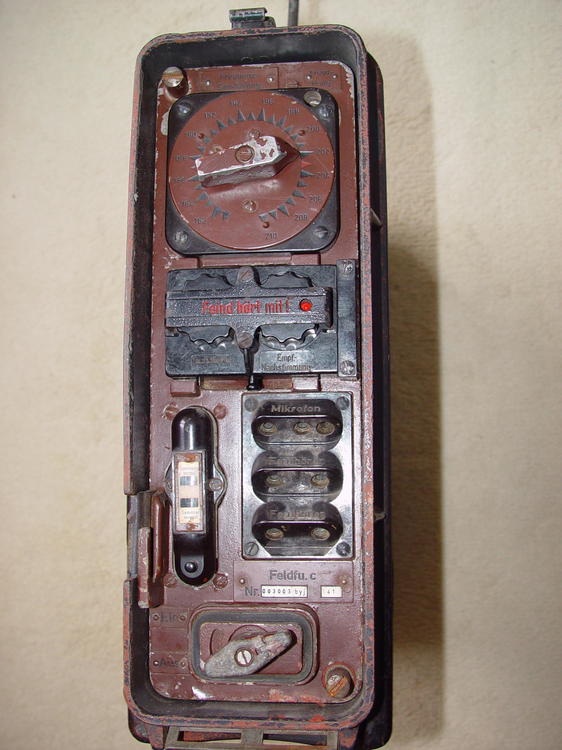

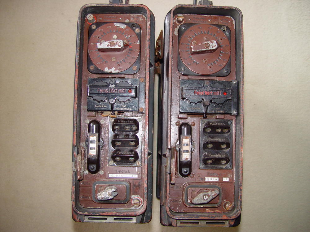

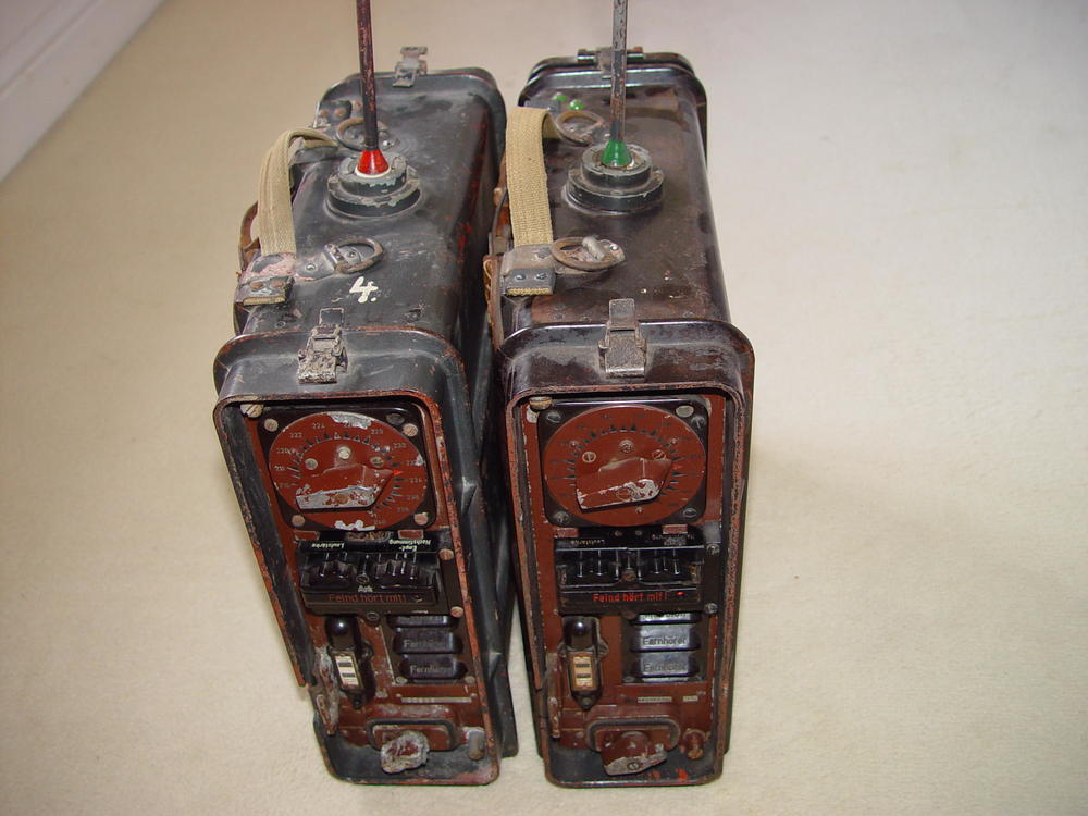

Externally, there is very little to differentiate the Feldfu.b and c models:

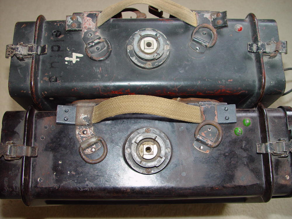

Apart from the type plate and the frequency dial numbers, the two radios are identical. A few small differences become apparent if top of the boxes are observed:

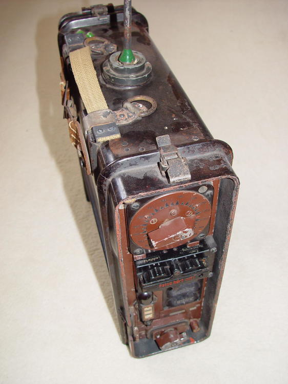

The Feldfu.c box would have been painted with the "Feldfu.c legend like on the Feldfu.b; unfortunately most of the paintwork has disappeared from the external box of the Feldfu.c. What does remain however are the feeler shapes. Whereas the Feldfu.b has a single red dot, the Feldfu.c has two green dots. (the feeler shapes allow the two radios to be recognised by touch in the dark). A Wider view shows that the green colour coding was also used for the antenna:

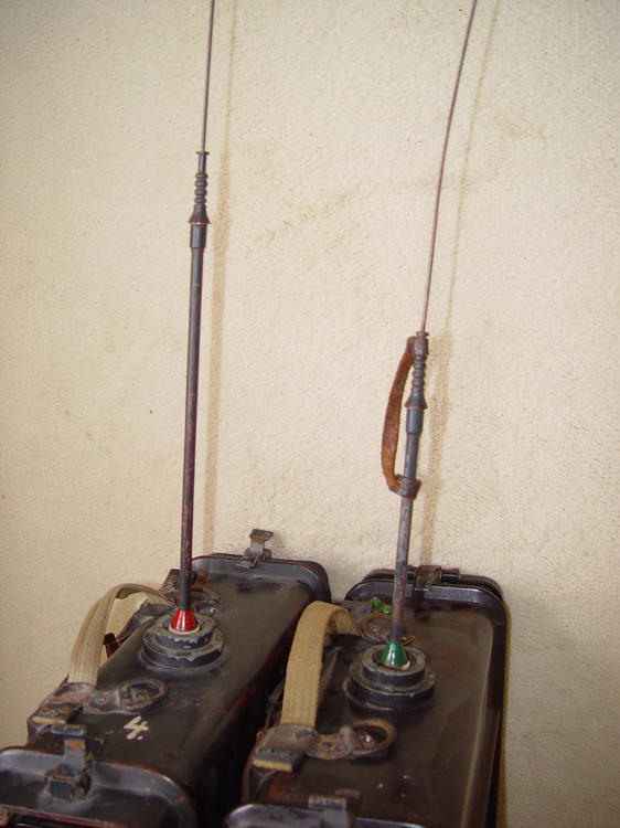

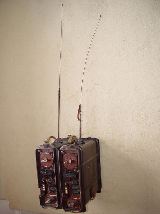

Because the Frequency of the Feldfu.c was higher, the antenna length could be shorter, the next two pictures show the differences between the Feldfu.b and Feldfu.c antenna:

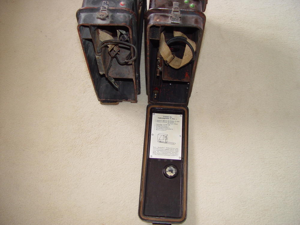

The Feldfu.c has a two part antenna, with a shorter bottom rod and a whip top section. The two sections were kept together with a short leather retaining strap. The green code would furthermore be used to paint a green dot on the rear cover of the radio. Like on the early Feldfu.b, the early type of rear lid (with a simple hinge and storage compartment legend) was used:
Production of the Feldfu.c was relatively short-lived, so all Feldfu.c's have the early thin rim boxes:

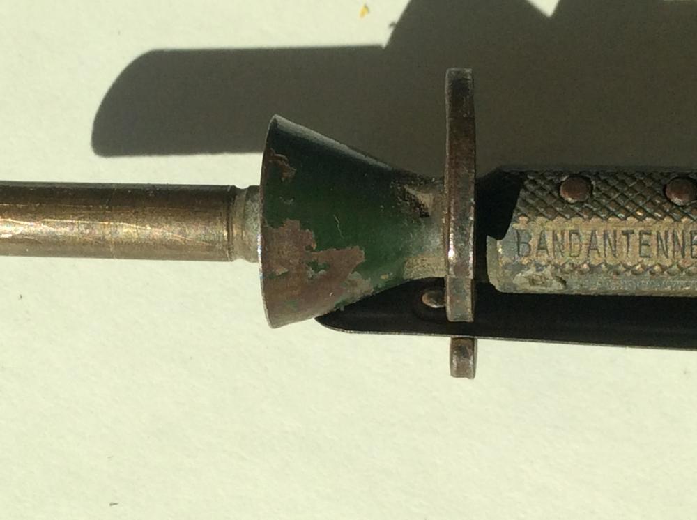

We now have some evidence of a foldable antenna for the Feldfu.c as well.  It is likely that production of the Feldfu.c was halted somewhere in 1942 before the new antenna was introduced in 1943, so the new foldable antennas were probably used as replacement items.

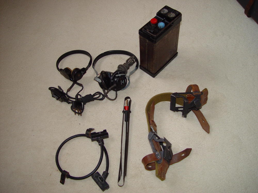

Like all Feldfu models, the Feldfu.c came with a full set of accessories:
Note that the above photograph shows the later foldable antenna of the Feldfu.b, the other accessories are identical.

Some pictures of the feldfu c steel band antenna FAAD0718-D911-4937-9310-BF724D9BE04D.thumb.jpeg.320bdaf85d3c31e14d9f89cd65da20e0.jpegBB7D96AF-BEDD-4D16-918E-4DF39B2283B4.thumb.jpeg.9750f4e3a87640f8dc07eee0e32b201a.jpeg6F0A0B01-4060-4D1A-B1B8-49B8506137CE.thumb.jpeg.14288e9faa6cb1e42a2d23f00a42705f.jpeg9A12D082-F752-4E7F-A6CA-59682834D121.thumb.jpeg.2aa3edc45cb86ce3f6b097a4cf93d408.jpeg
