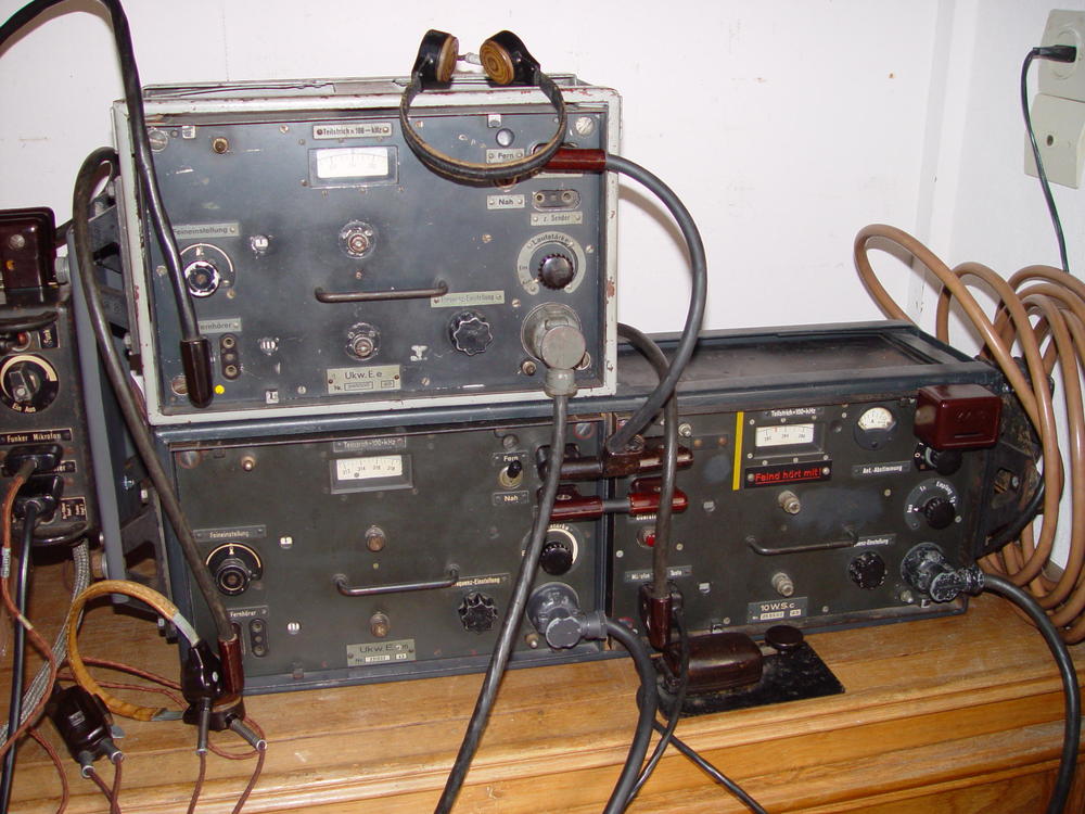

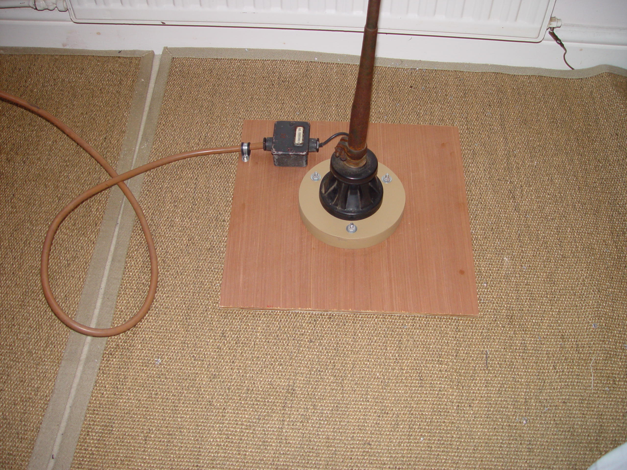

My Fu2/5 setup was quite messy, so I decided I build a few display boards to demo the Panzer radio setup for an impending exhibition. Makes it a bit easier to transport, set up and demonstrate. Unfortunately not a lot to hear on 10m VHF at the moment but at least I can demonstrate the intercom. Only missing the "Scheifringübertrager"...
regards,
Funksammler
DSC01359.thumb.JPG.0d3ea80d4de774d2865743eac1c7d9c5.JPGDSC01360.thumb.JPG.75355ea3bd2789131de9bd04b1ef45e6.JPGDSC01361.thumb.JPG.4edc71488e75d28234b15501d34ac7c3.JPGDSC01362.thumb.JPG.46a1e5f14c7d03c2de84672cd576b8f0.JPG
Great job FS.   Looks like you have all the pieces, and created a nice display.  This looks like the Panther layout.  Do you have the antenna matching boxes also?
Are you plugging the speaker into the Bosch receptacle?
Edited by kriegsfunker
Only the "Schleifringübertrager" is missing unfortunately. It will eventually evolve into a full Panther A setup. I have a complete and original "Antennekabel p", it is rather set in its shape after being coiled up for 75+ years and I have some worries about damaging it by uncoiling it. The late war coax cable has a soft silicon type insulation which can short out if not handled carefully....
regards,
Funksammler

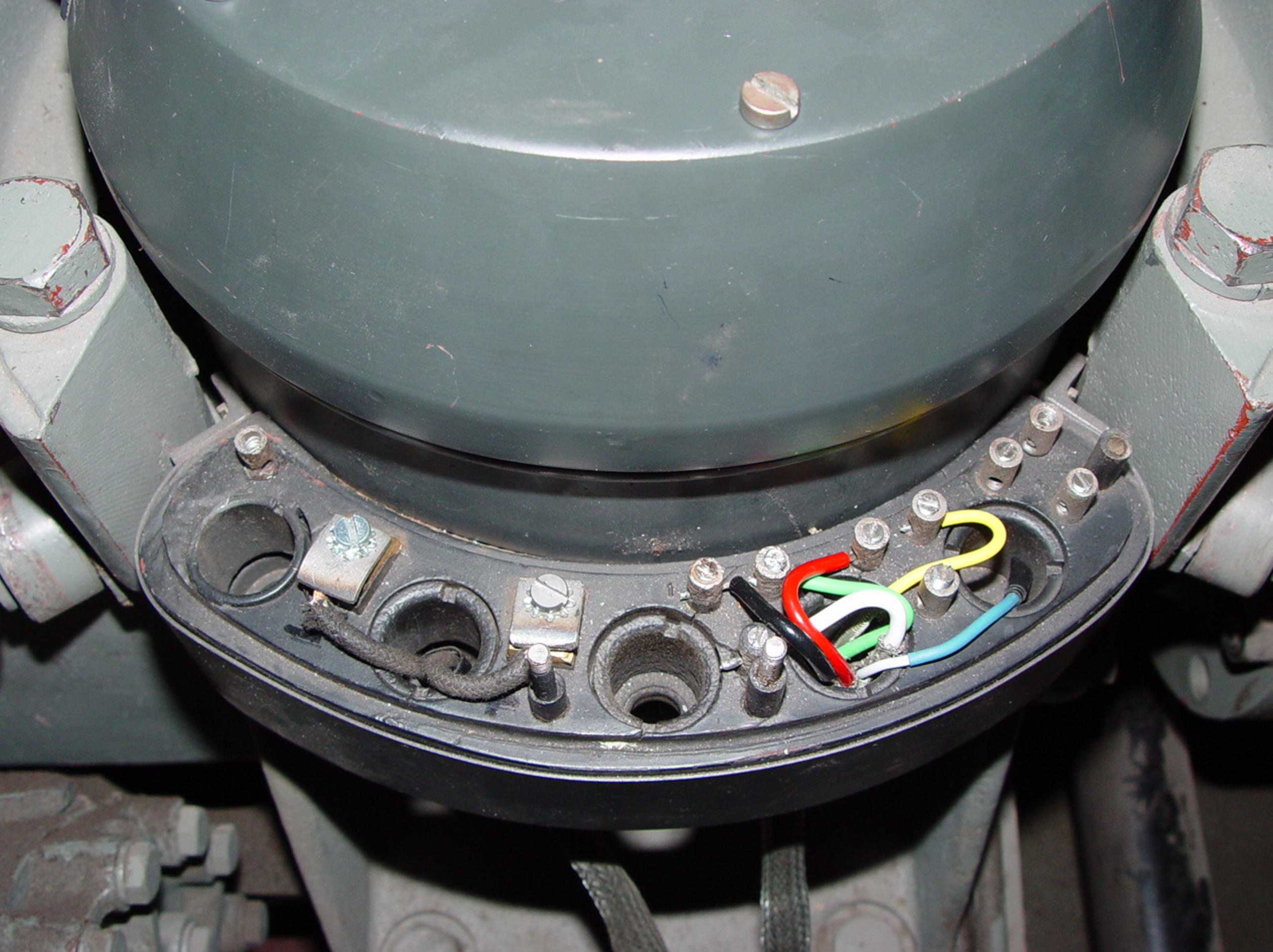

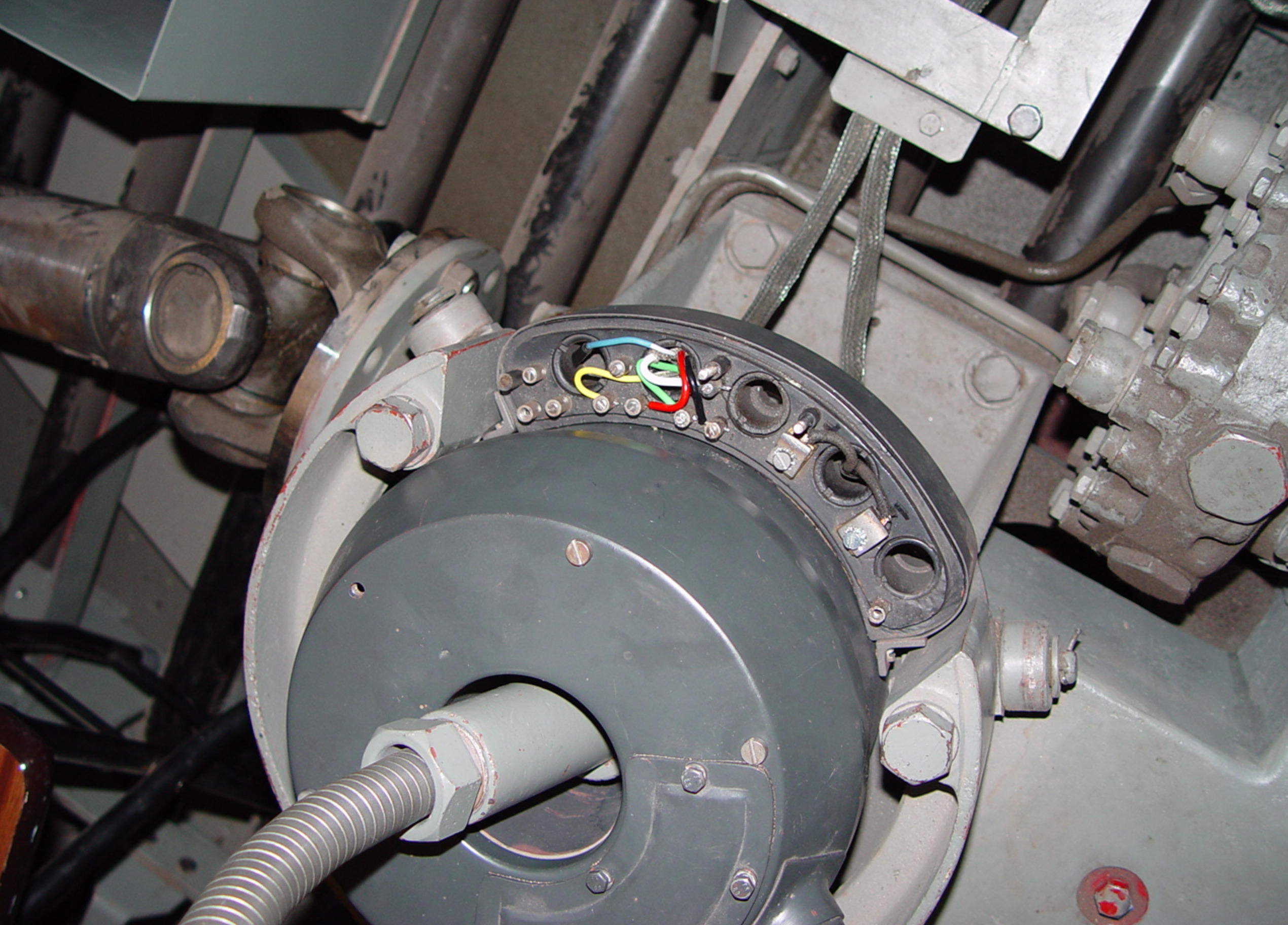

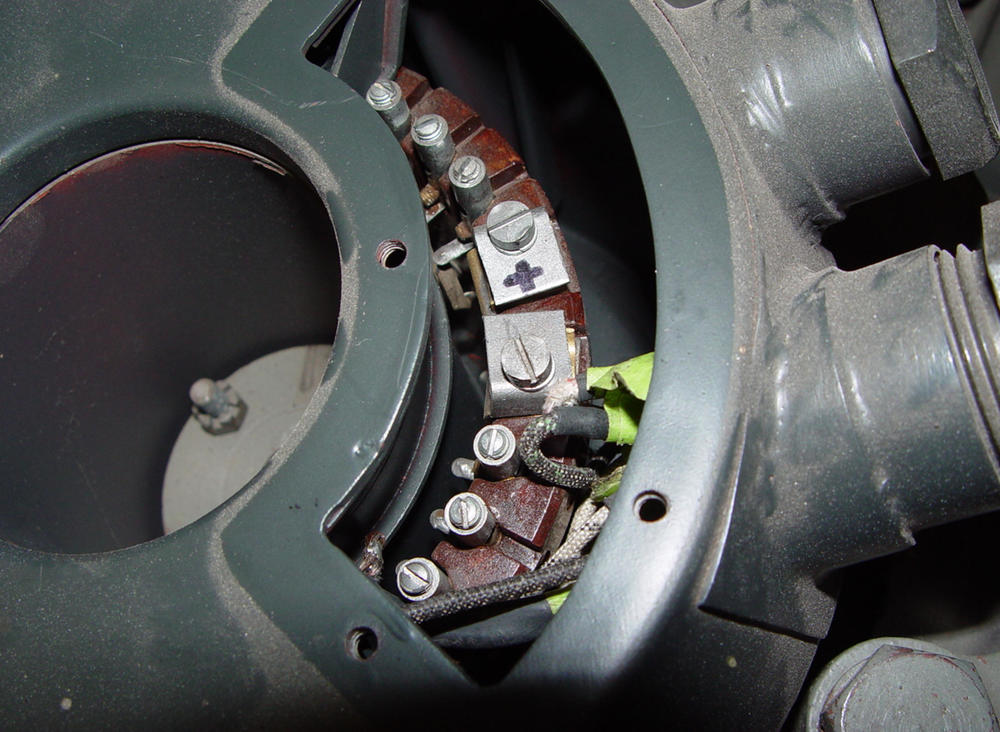

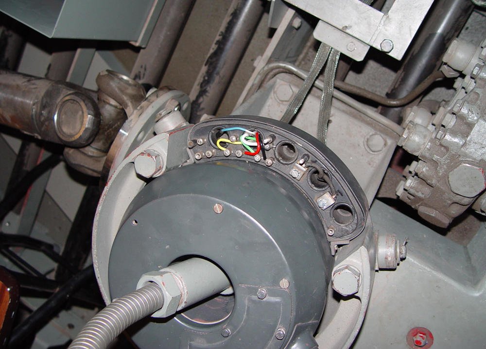

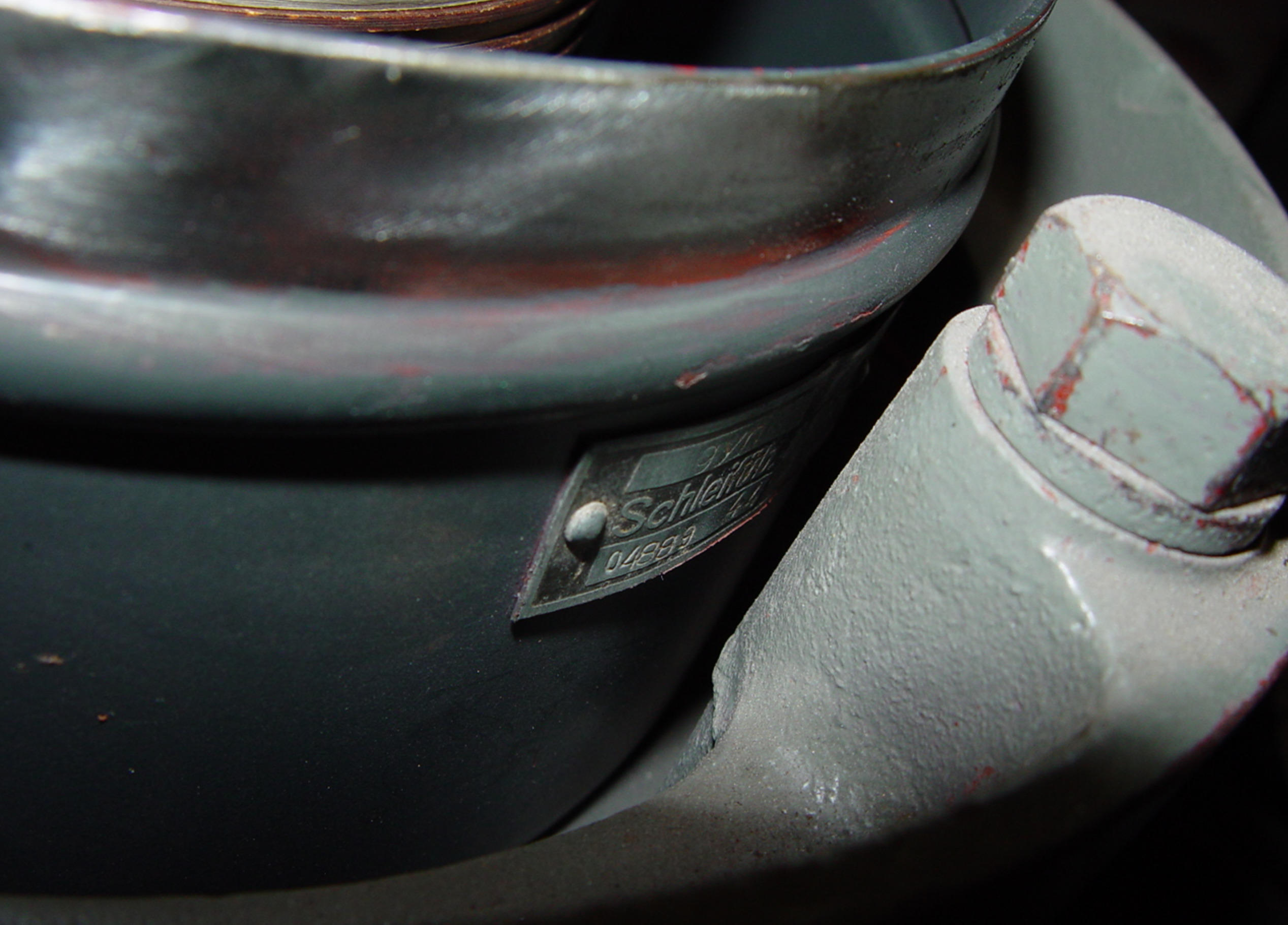

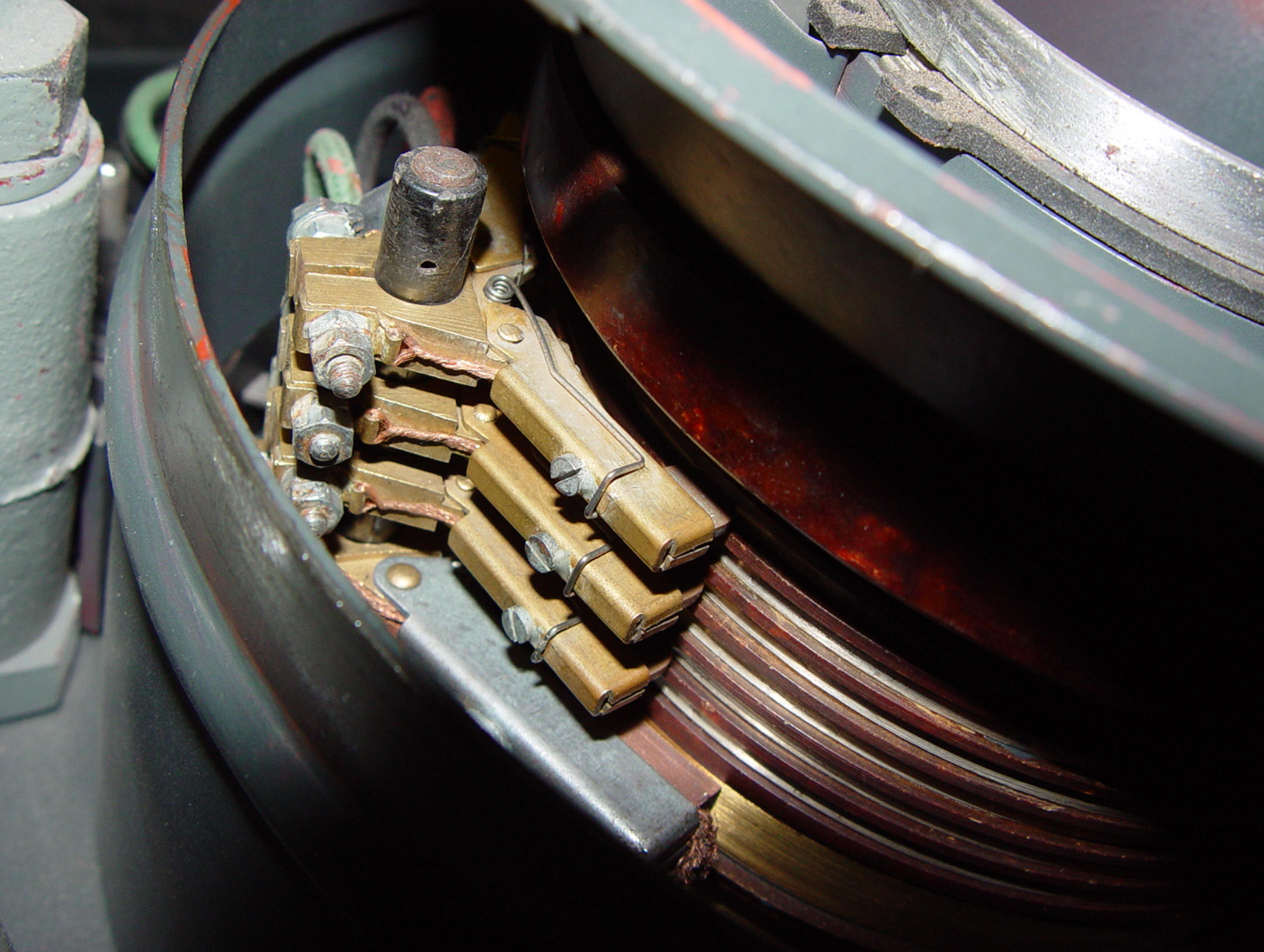

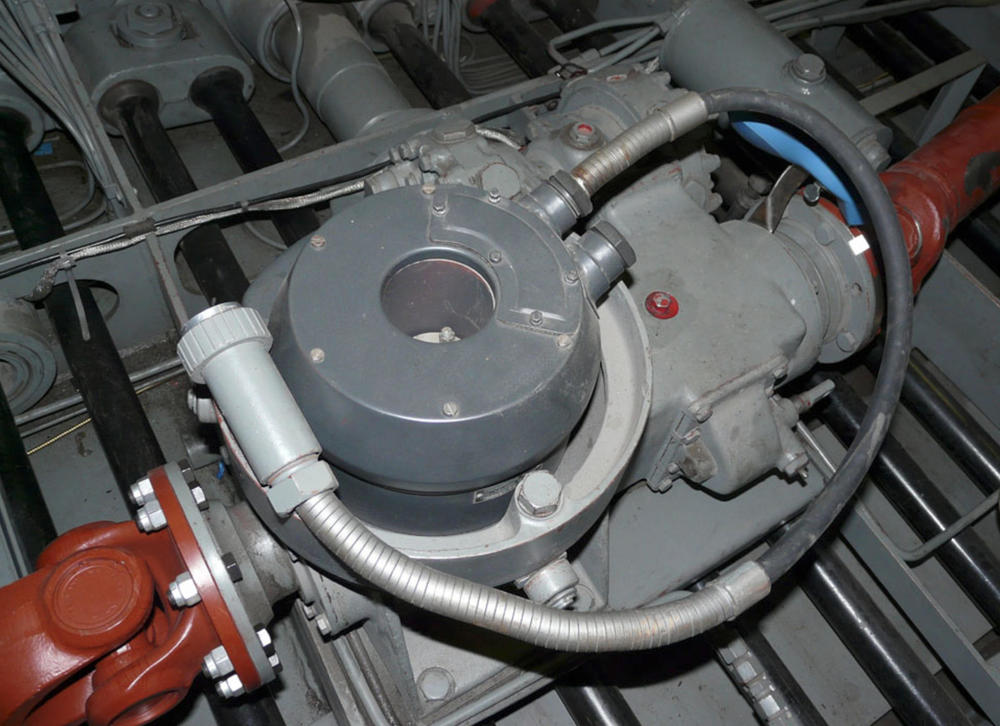

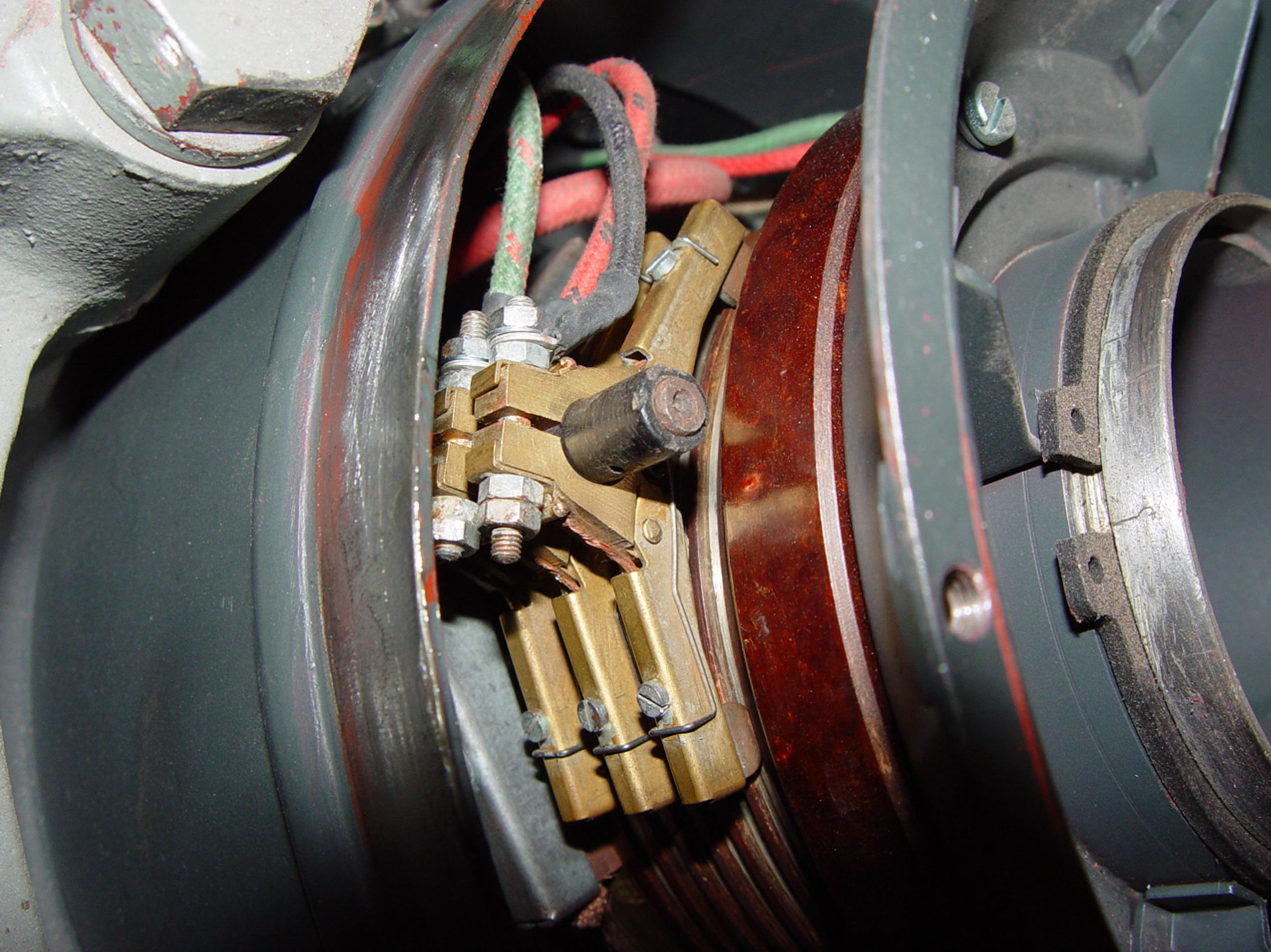

Very nice setup.   The slip ring was a rarety I only saw once at the Littlefield collection.   He was able to procure one in its original box.   I'm sure no one bothered to remove them from scrap tanks after the war, and they were smelted together with the rest of the tank.  Here are the pics I took from the one installed in that Panther:
1528177977_Screenshotfrom2019-05-2320-44-02.thumb.jpg.a133e1033b8f9a0bd20888eb67b17cce.jpg167259628_Screenshotfrom2019-05-2320-45-18.thumb.jpg.3a2101d96089d4970c8e544d0b3c1e97.jpg1146455174_Screenshotfrom2019-05-2320-44-16.thumb.jpg.dd321a76fcd59c92e918efa203b41799.jpg638889412_Screenshotfrom2019-05-2320-45-02.thumb.jpg.f4d6735820480d6867706cfe2931a19e.jpg720429455_Screenshotfrom2019-05-2320-44-42.thumb.jpg.4c523c5e6aab39d266d95605bba9252b.jpg631723073_Screenshotfrom2019-05-2320-46-15.thumb.jpg.0ed1987279e9b4fc4afc32079cfb8cf2.jpg69948367_Screenshotfrom2019-05-2320-46-01.thumb.jpg.efdf0625b67f23f6fed998ec583f3e1f.jpg1551300694_Screenshotfrom2019-05-2320-45-46.thumb.jpg.239b3b25f1bad3b81549ef57b239c7e8.jpg839699103_Screenshotfrom2019-05-2320-45-32.thumb.jpg.19e927dd9558c38c2f97128bf0586088.jpg

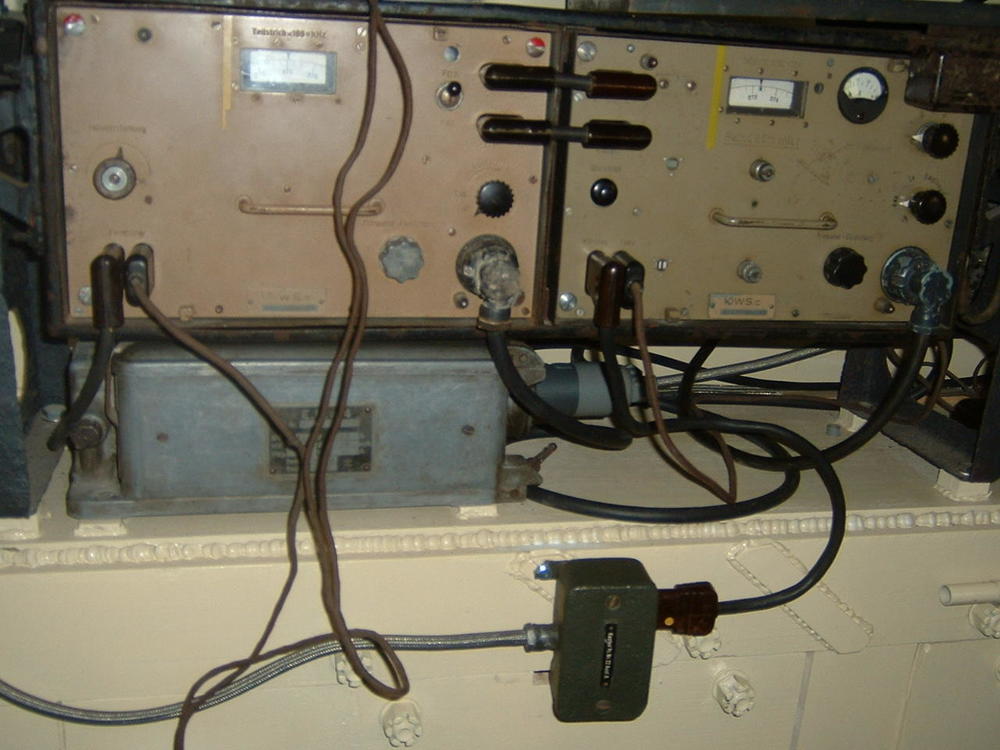

Hello folks,
I have a LSG(Fu)b connected to the UKWEe receiver. One can hear all the transmissions voice and morse from the 10WSc.
Cheers
Hello Folks,
Sounds from my STUG Fu5 display.
Made with my mobile, so not the best quality, but you realize the noise generated by two umformers and vibrator from LSG(Fu)b.
The LSG(Fu)b covers the noises quite effectively when sending morse.
Cheers

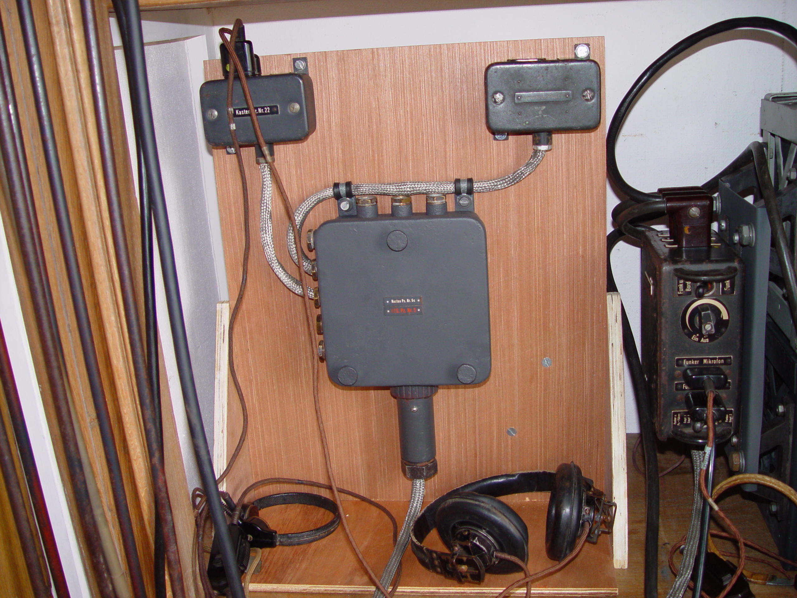

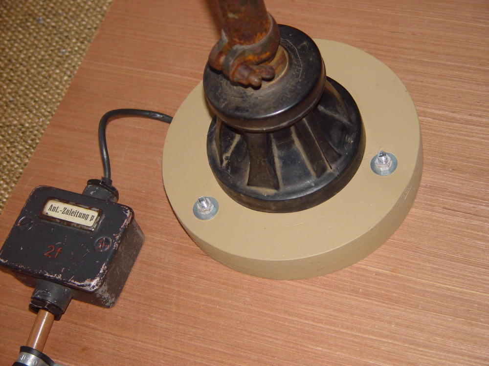

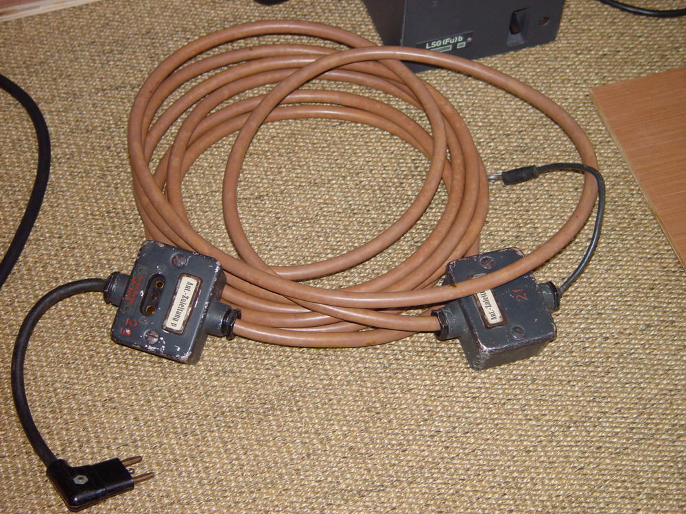

Hello folks,
Just sharing a picture of the restored 22b now in place.
Patch cable to the sender is ready, I'm preparing the one for the receiver.
