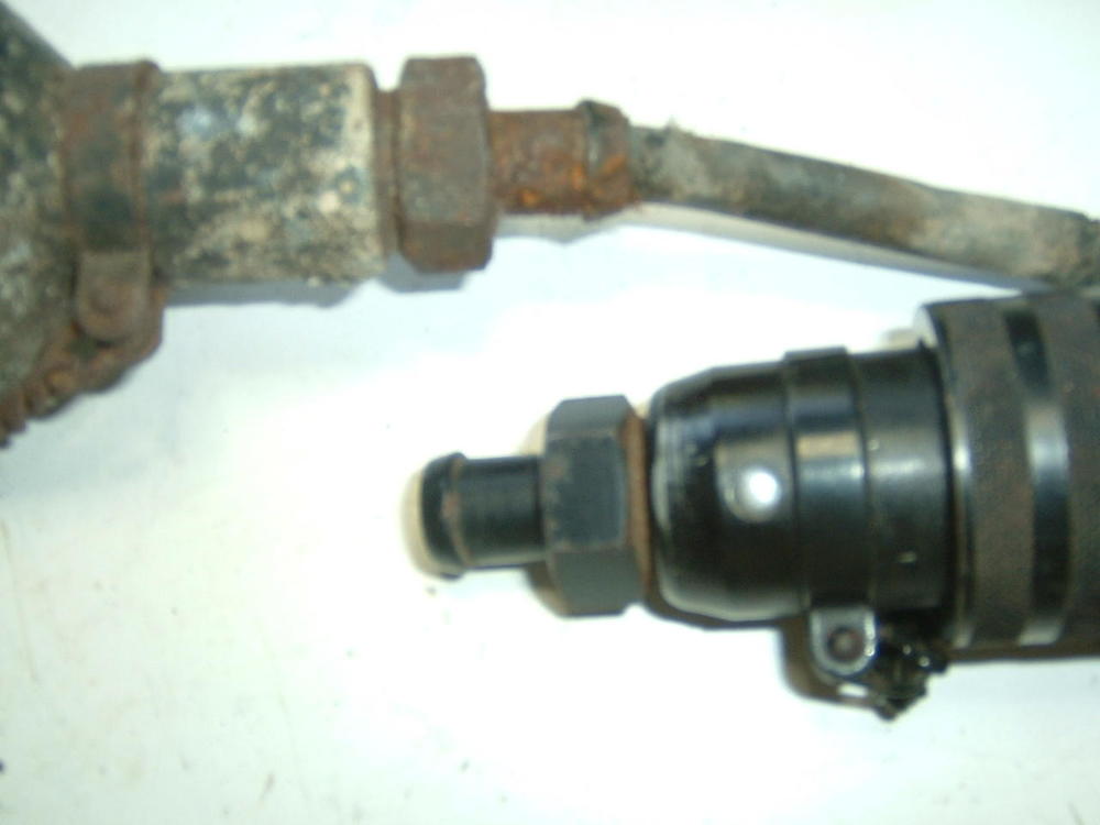

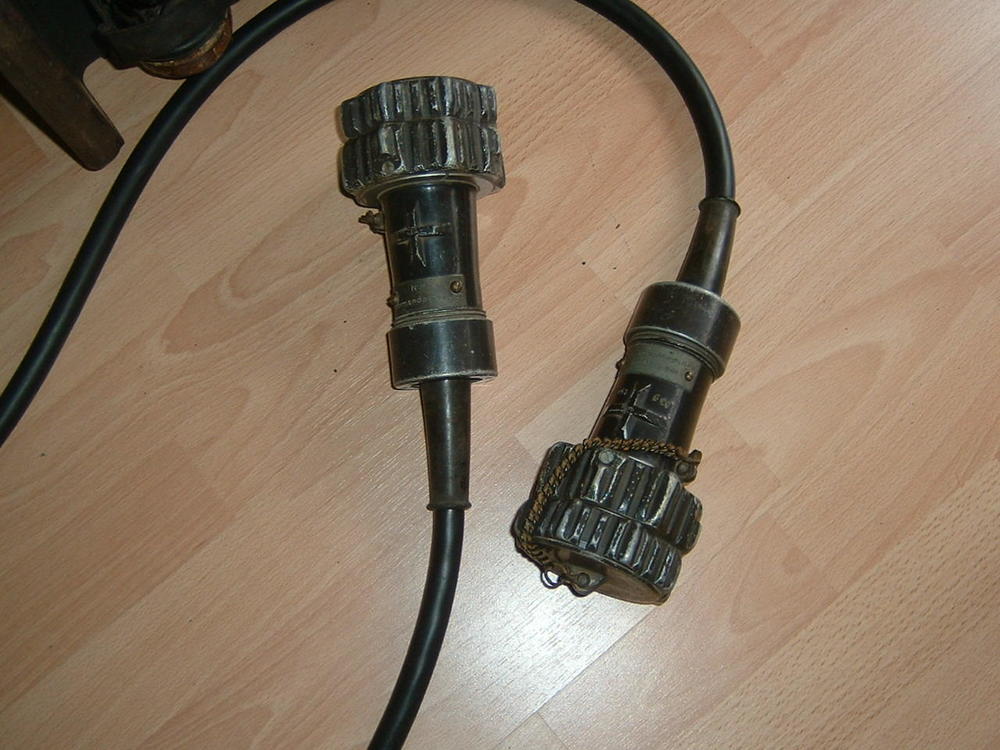

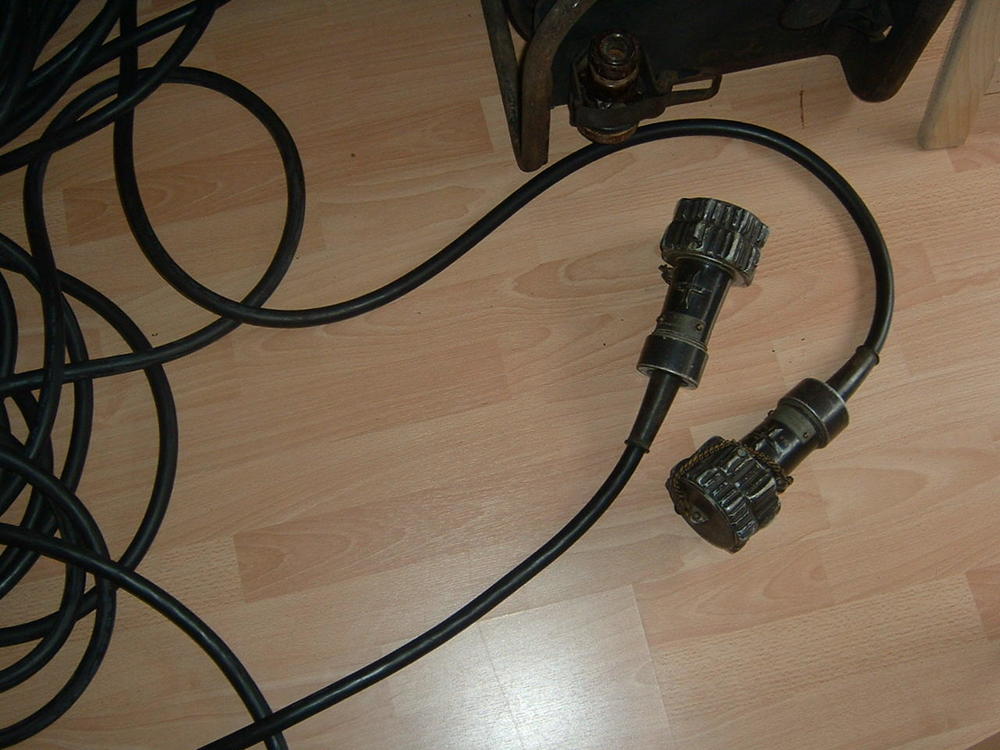

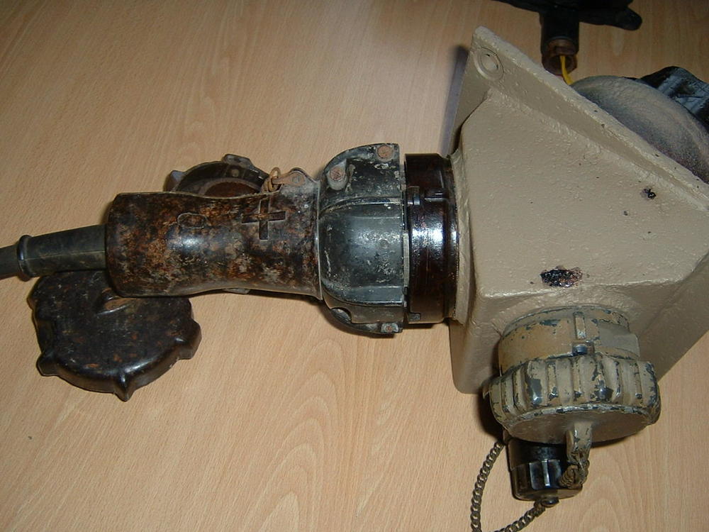

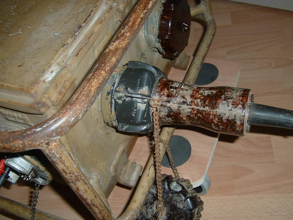

dufleuve Posted September 16, 2019 Author Posted September 16, 2019 Both connectors now attached to the cable. The power connection between KdoG40 and Betriebschaltkasten is ready ! Anyone has those devices to test ? 😀 I'm still looking for a cable of 46 to 60 conductors, 17-18mm diameter, rubber or rubber like, 30 and/or 60 meter long. Cheers 2

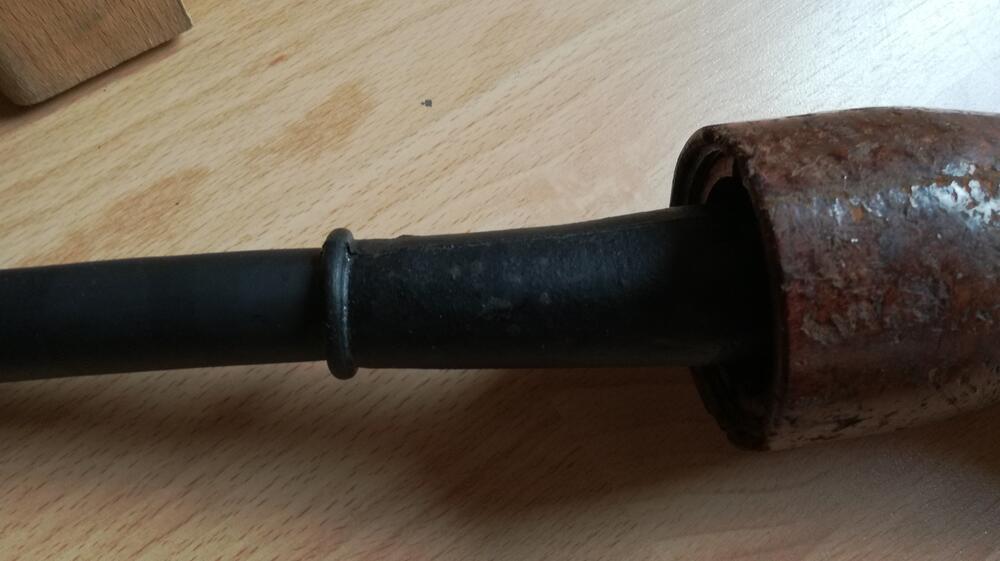

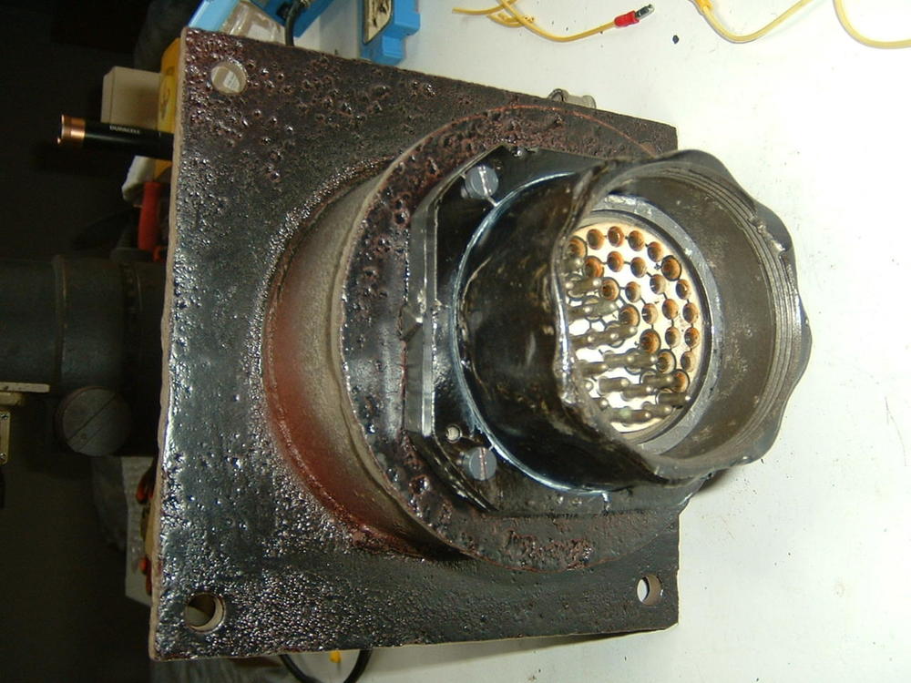

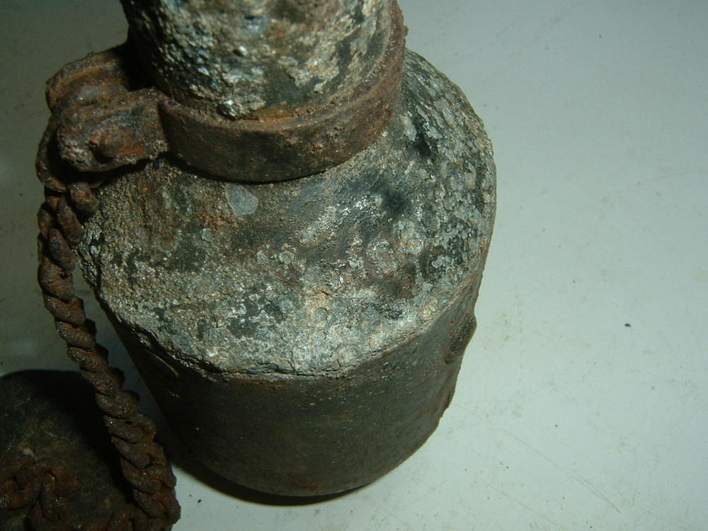

dufleuve Posted October 9, 2019 Author Posted October 9, 2019 Latest addition: renkstecker 14 HS that perfectly fits the 14 HS renkdose on the flak Anschlusskasten. Purpose of this connection still unknown... 1

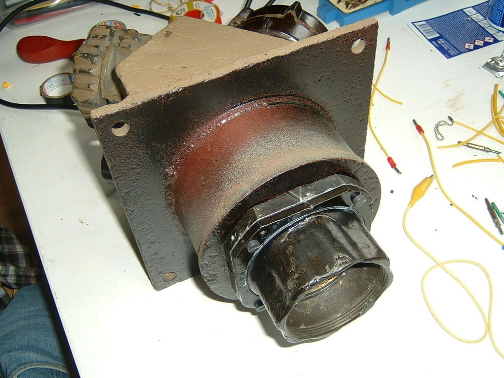

dufleuve Posted November 6, 2019 Author Posted November 6, 2019 Ubertragungsanschlusskasten for the flak 8,8 cm now complete. The inner renkdose 46HS cabling is done. 1

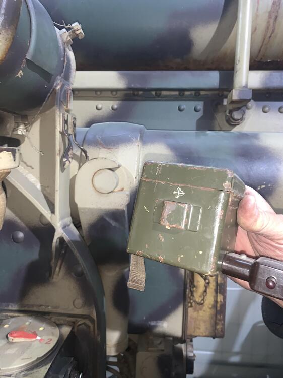

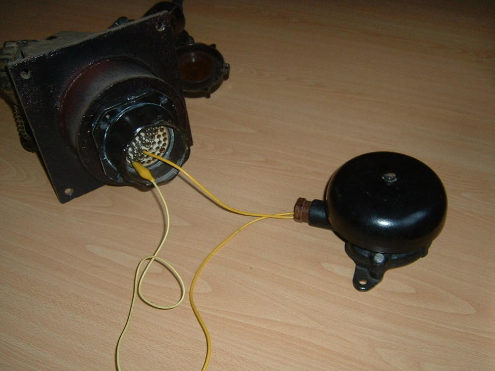

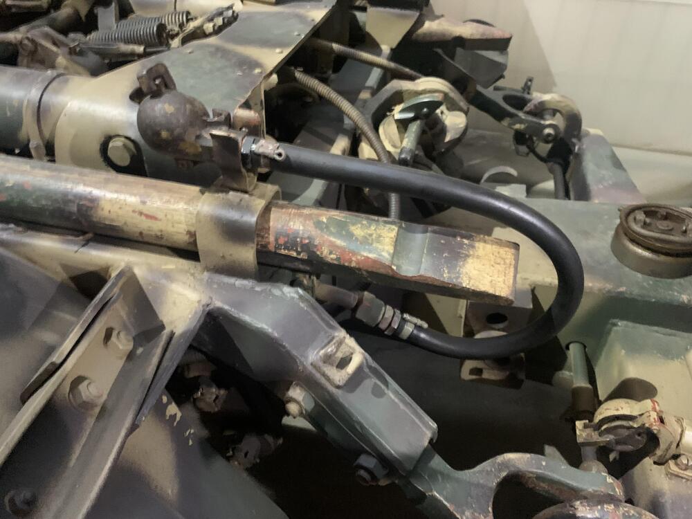

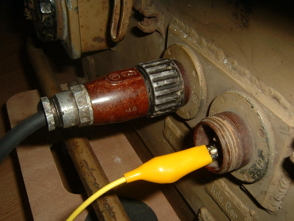

dufleuve Posted December 12, 2019 Author Posted December 12, 2019 Testing the Feuerglocke. The firing bell was located on the Flak gun. It was used to give the go fire or other instructions. It could be activated from the Kommandogerät, from the Verteilerkasten or from the Fernsprechgerät fur Kommandozwecke. I used obviously the Verteilerkasten 12V sammler connection to provide the needed DC voltage for the bell. Ubertragungsleitung 37b is connecting Geschütz IV to the Flak gun Anschlusskaten. The firing bell circuit uses both pins 23 (ground) and 5 (12v neg). The connector next to the 12v sammler is used to close the circuit and activate the bell. I unfortunately cannot let you enjoy the sweet sound of the little bell 😀 1 1

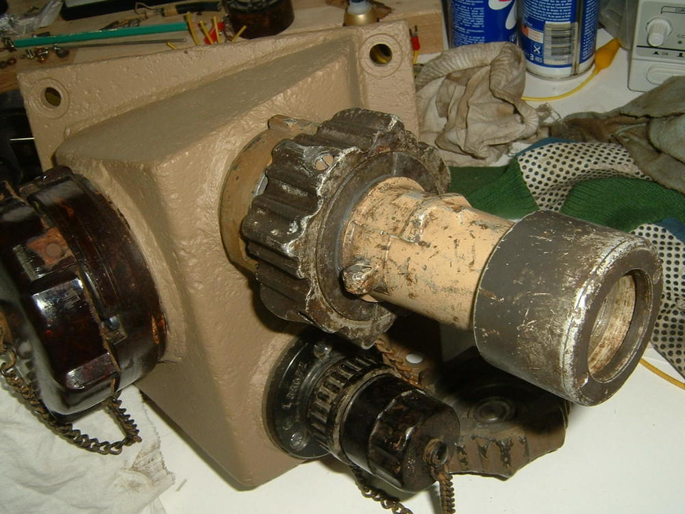

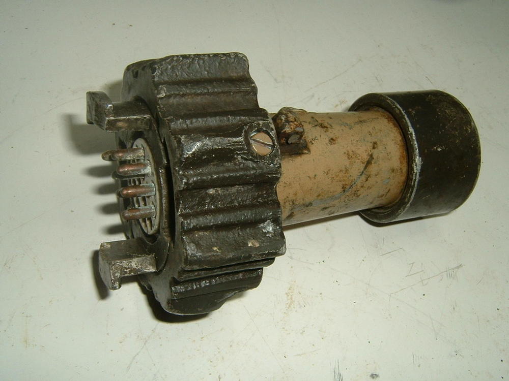

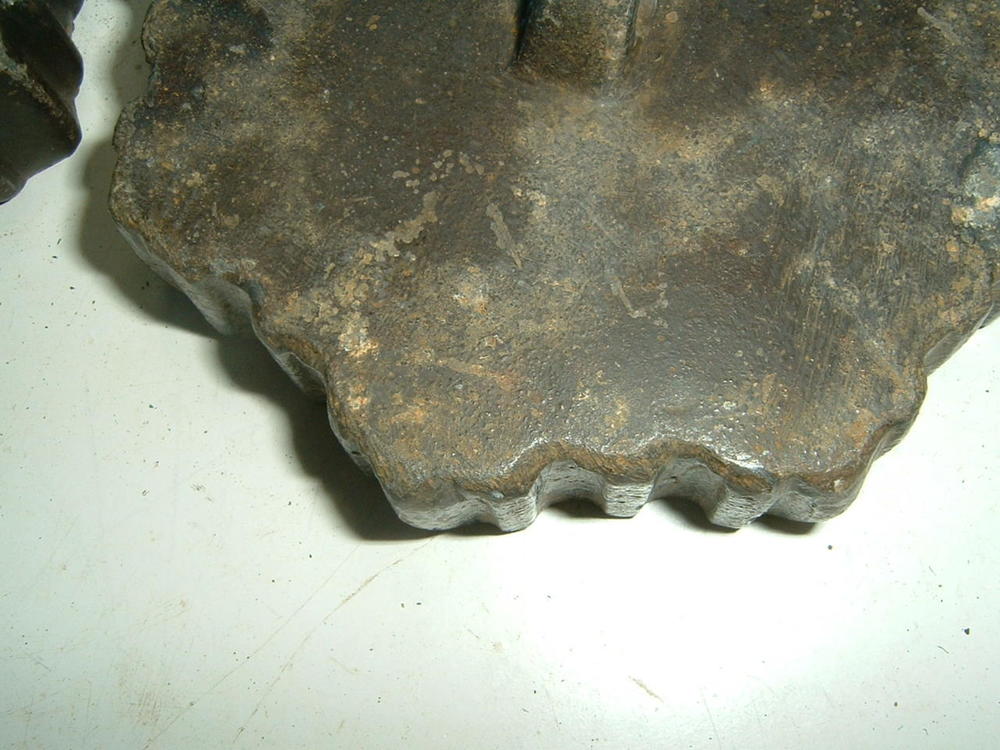

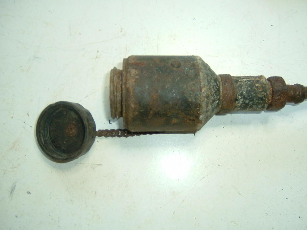

dufleuve Posted January 10, 2020 Author Posted January 10, 2020 Happy New Year Folks !! Latest addition to the Flak connectors: the 24HS renkstecker bakelite model. It is a dug out according to seller, but quite well preserved. The cover was still locked on it, so the connecting pins were protected from rust. In last picture, you can see the size difference with the 46HS model. Some more dismantling and cleaning needed. Will proceed in the coming days. 1 1

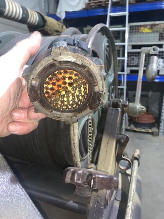

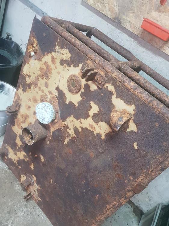

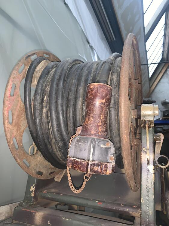

dufleuve Posted February 12, 2020 Author Posted February 12, 2020 A nice view of the Anschluss Kasten at the base of a static flak88. 1 1

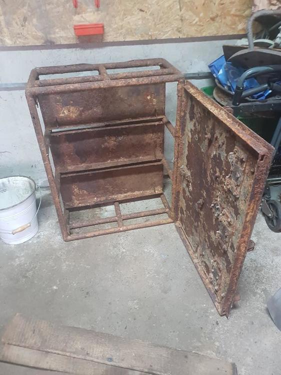

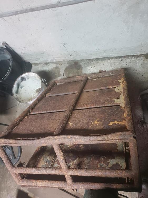

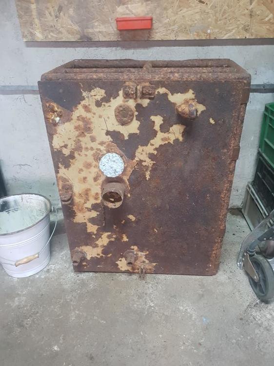

dufleuve Posted April 9, 2020 Author Posted April 9, 2020 Hello folks, Last addition to the flak direction system. The battery box for the Kommandogerät 40 betriebschaltkasten. It holds three 12v batteries to provide the 36V DC for the Kommandogerät. A bit of the original paint left on the cover, but I will have it sandblasted after removal of all the fittings. I'm still looking after the KdoG40 manual to have the complete description of it. Cheers 3

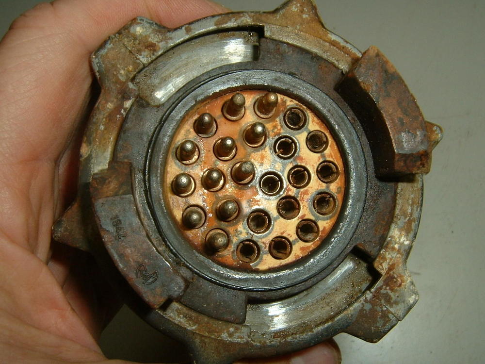

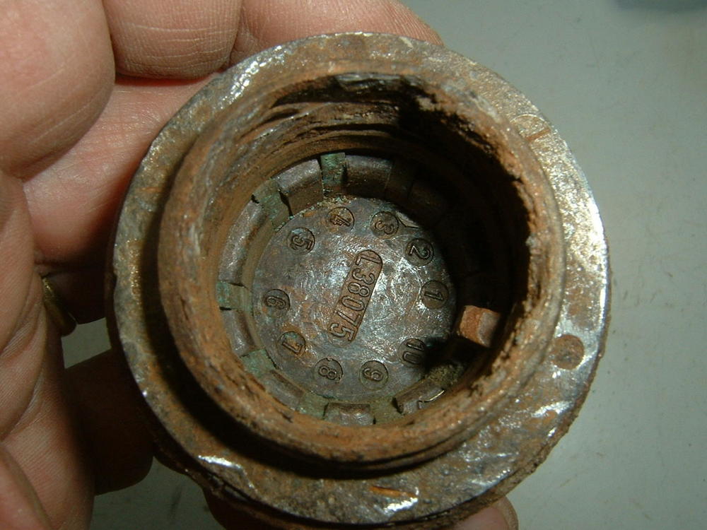

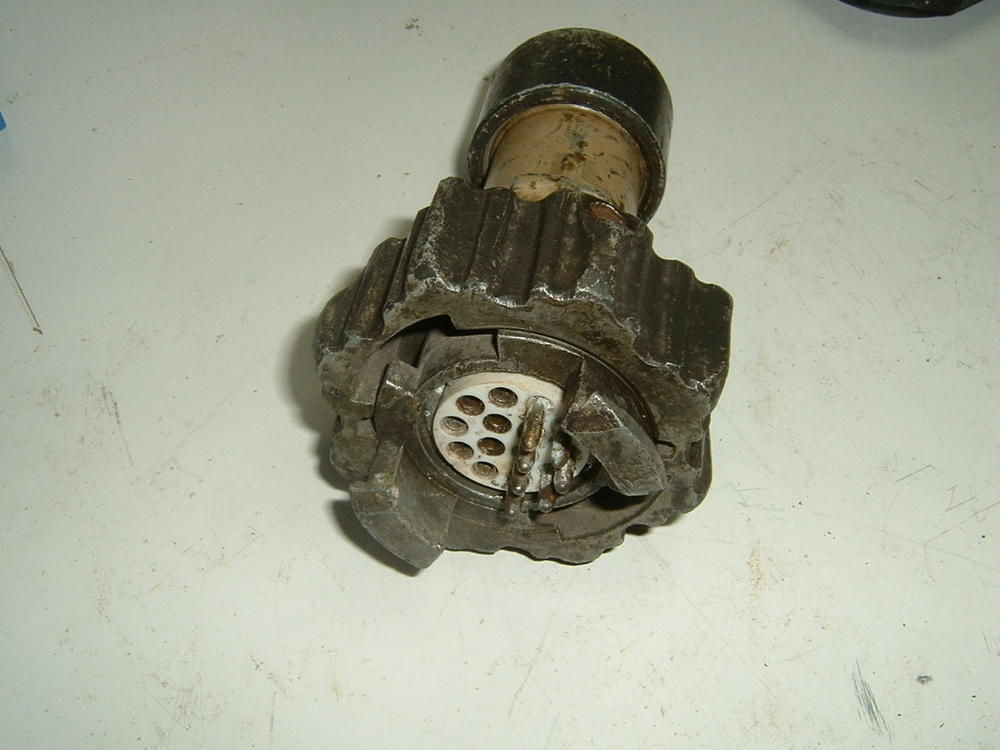

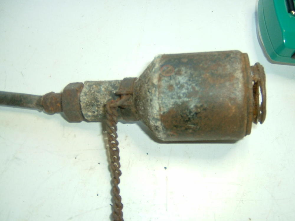

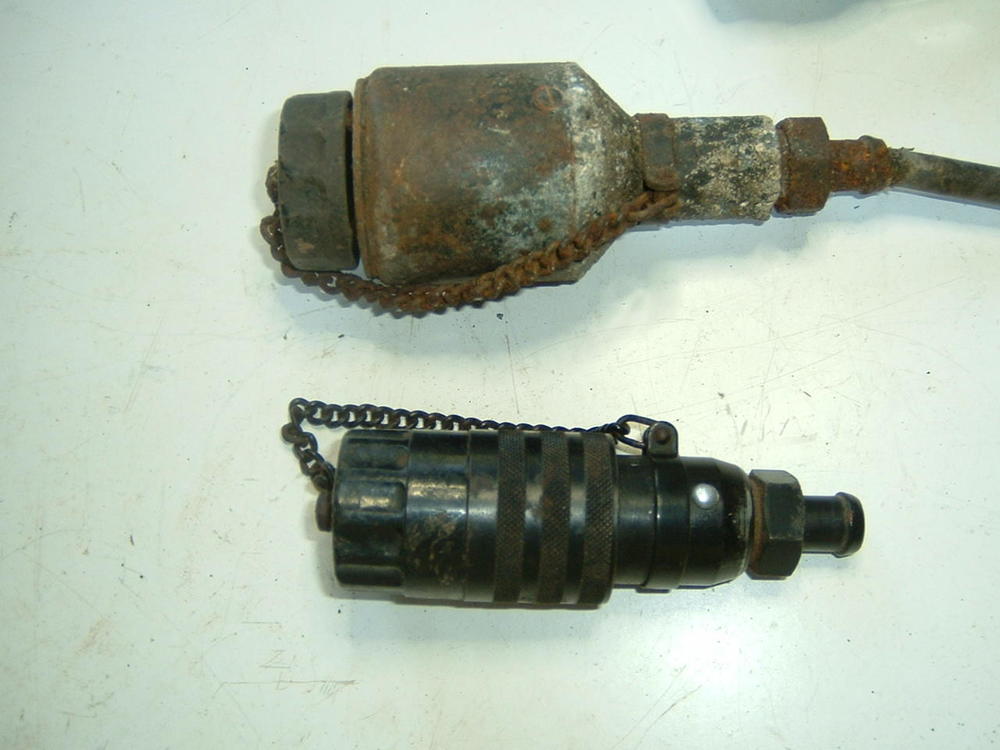

dufleuve Posted May 6, 2020 Author Posted May 6, 2020 Hello folks, I finally got an example of the female 10 pins connector, alas in bad shape. At least, I know now what to look for. See the male plug alongside for comparison.

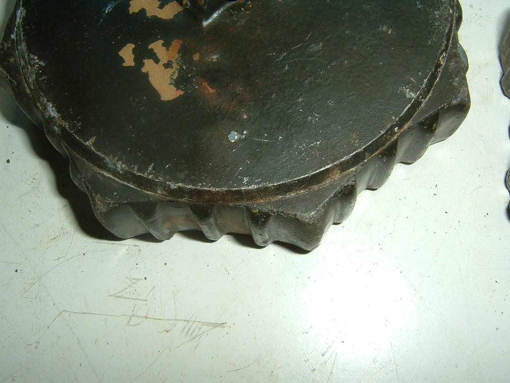

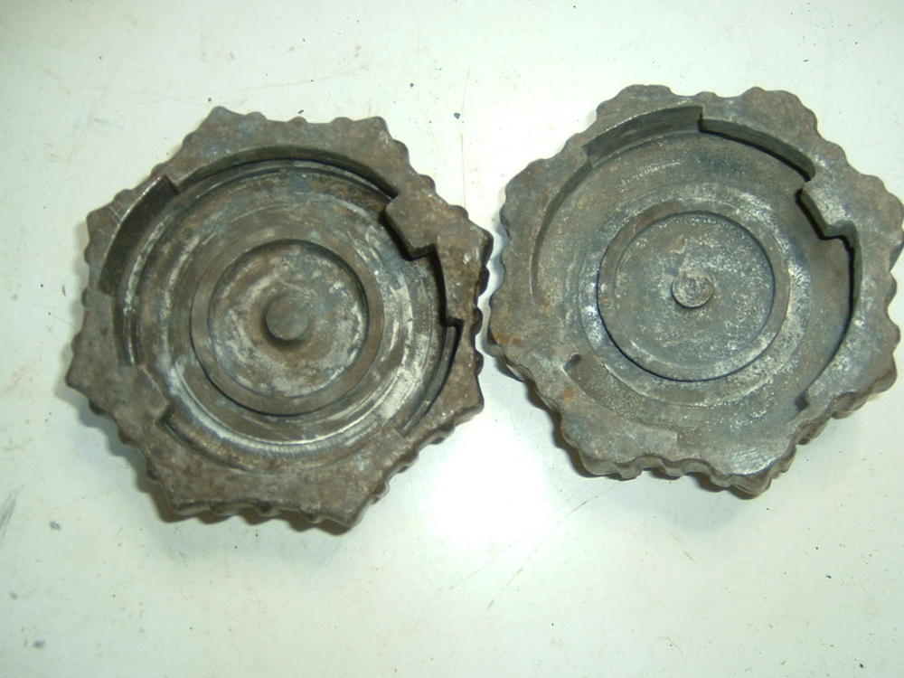

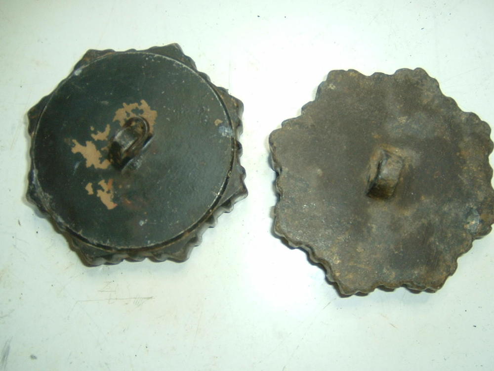

dufleuve Posted May 6, 2020 Author Posted May 6, 2020 Some differences in the covers for the 46HS Renkdose. With screwed on top or flat top.

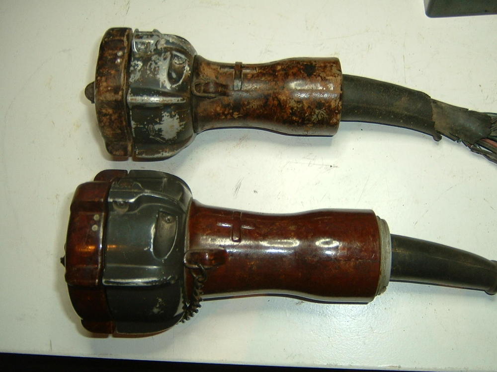

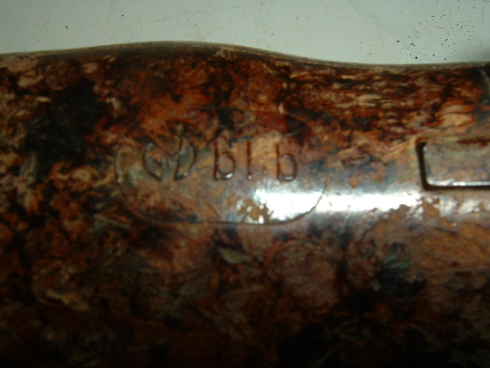

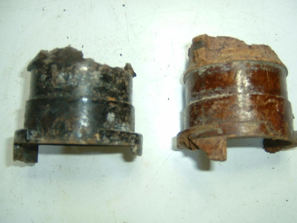

dufleuve Posted May 6, 2020 Author Posted May 6, 2020 Also the bakelite Renkstecker 46HS show some differences. I got a relic that is a kind of black hard plastic instead of the usual brown composite.

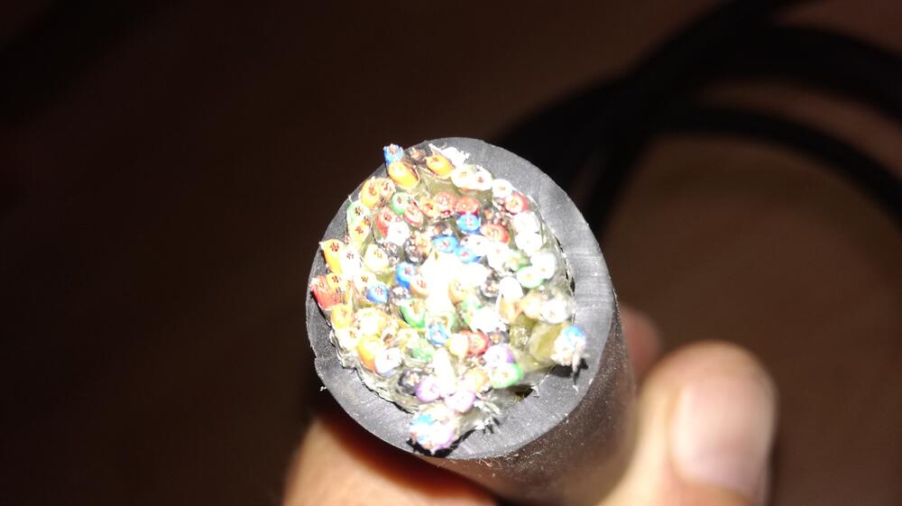

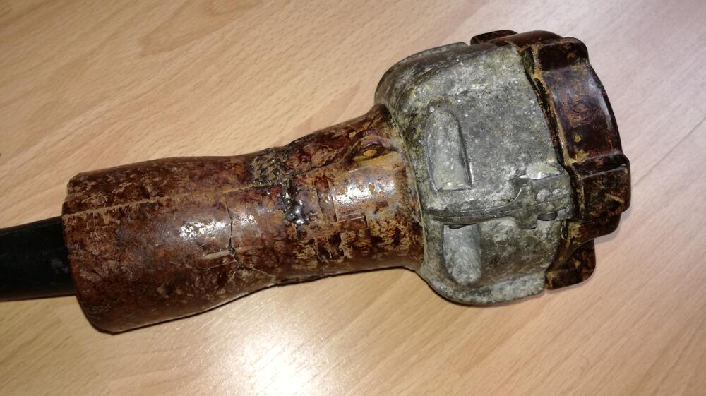

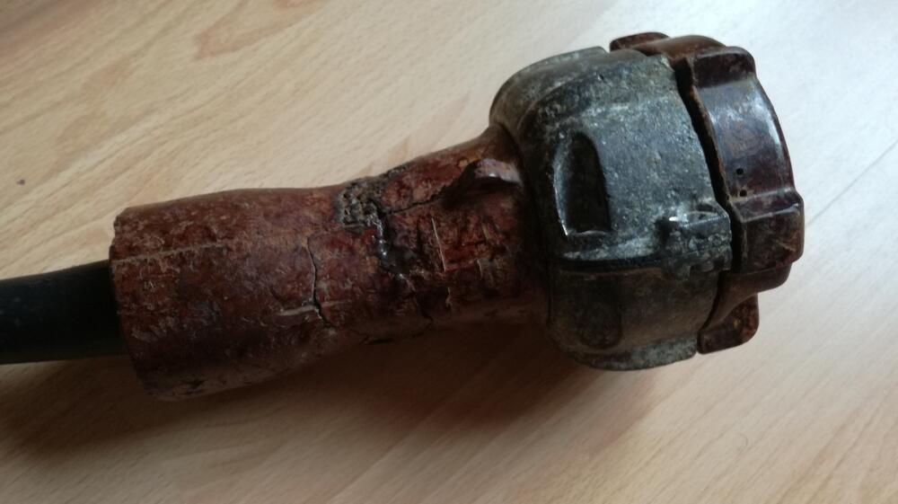

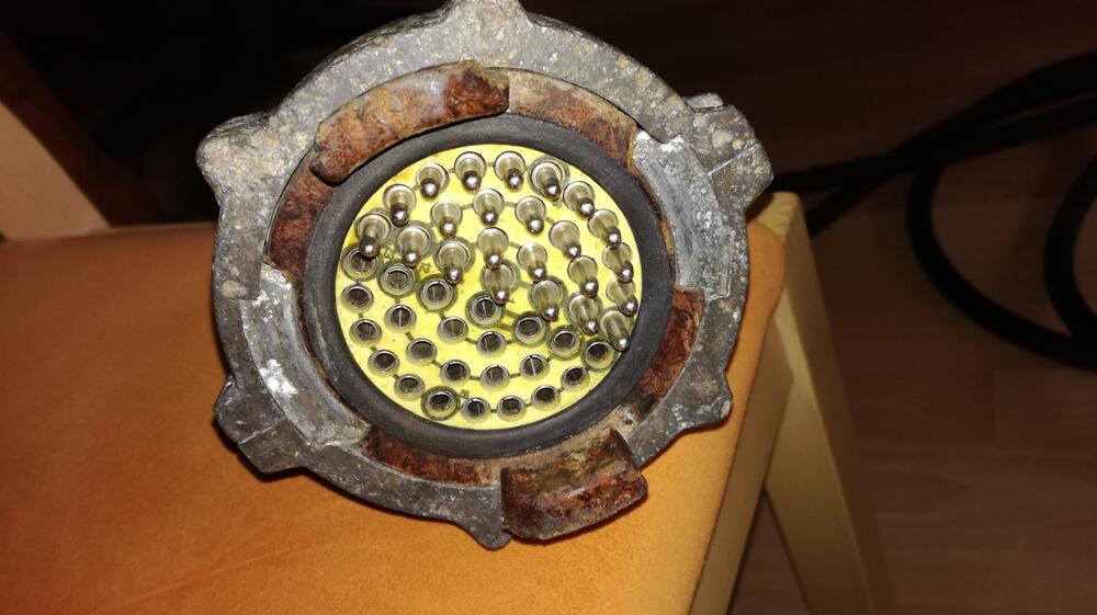

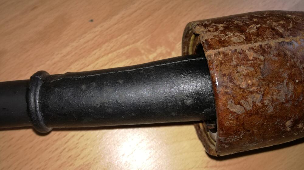

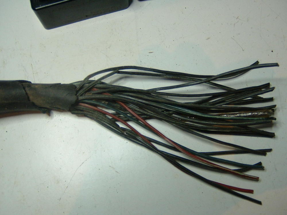

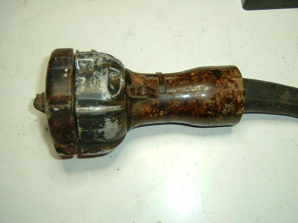

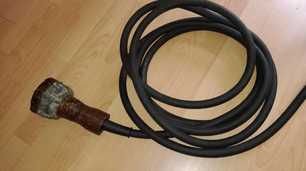

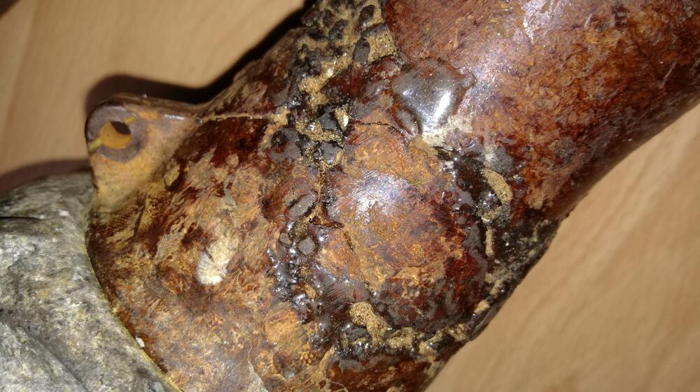

dufleuve Posted September 3, 2022 Author Posted September 3, 2022 Hello folks, I found the right cable to rebuild the 5m Ubertragungsleitung 37. It is 20,5 mm in diametre and holds 40 pairs of conductors. The original cable uses 66 conductors as some pins use two conductors I made a first try with a restored 46 HS bakelit renkstecker. Soldering the 66 conductors is challenging, will have to improve the workbench and preparation of the various cables. Here is the result. You see the Renkstecker is a heavily rebuild ground dug. Did not want to commit a good one to this first try. Next step is to restore a second HS46 Renkstecker to complete the cable. I'll then probably order a bigger lenght of cable to build the 30m version with better preserved connectors. Again, if you have those connectors or parts in any shape, I'm interested. Cheers
