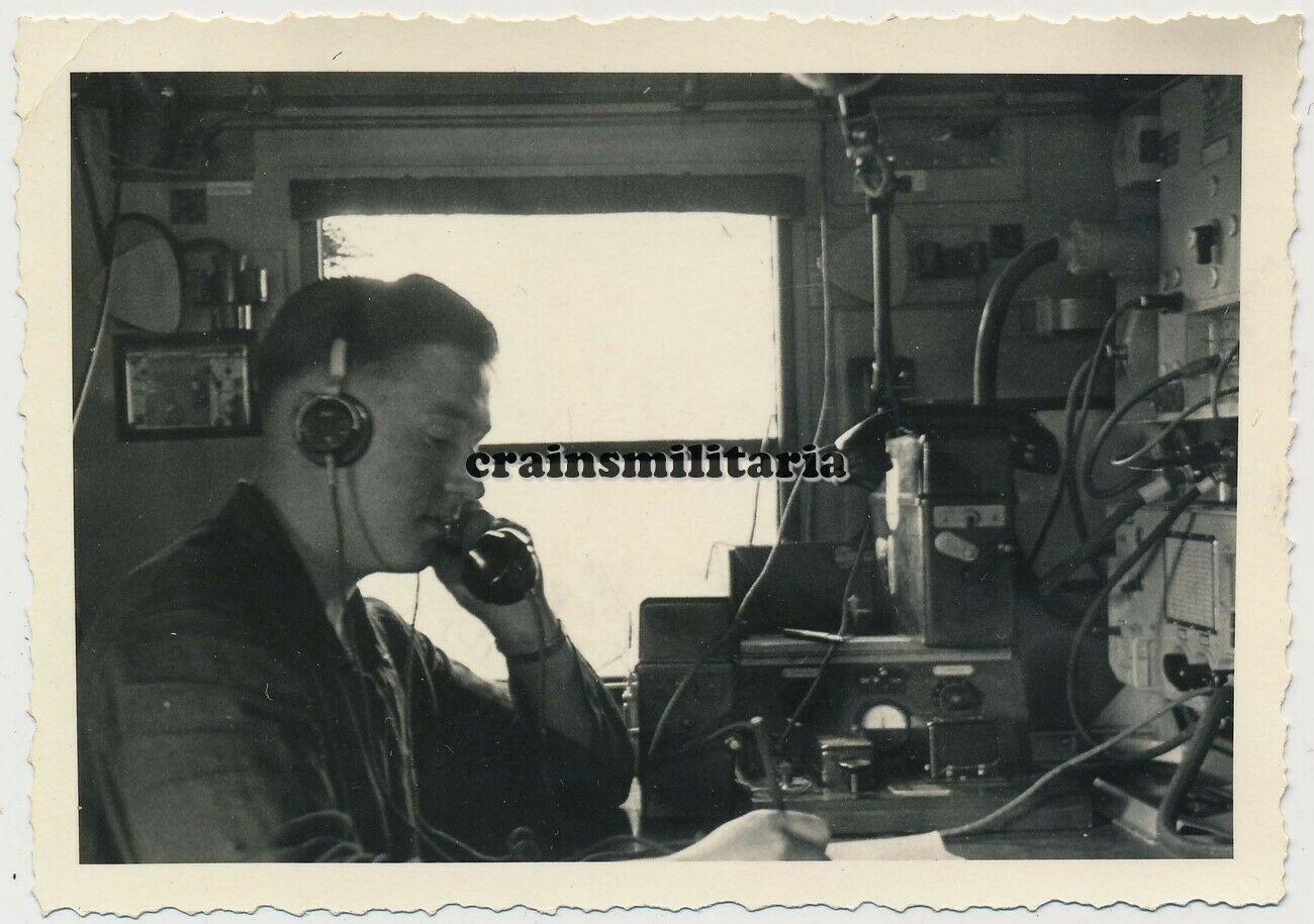

Funksammler Posted October 15, 2019 Posted October 15, 2019 Ferntastgerät FTG.1. This unit would normally be placed remotely to key the transmitter of the FuG III. The connection unit near the transmitter was the FTZ.1. The connection between the FTG and FTZ unit incorporated two FF33's and used a three line connection between the two stations. regards, Funksammler 1
val Posted October 15, 2019 Author Posted October 15, 2019 Thanks. Do you have nice images of both FTG.1 and FTZ.1?
Funksammler Posted October 15, 2019 Posted October 15, 2019 They are in one of Werner's articles in Radiobote. I should have some pictures somewhere, but I can't remember where.... regards, Funksammler 1
val Posted October 15, 2019 Author Posted October 15, 2019 6 minutes ago, Funksammler said: They are in one of Werner's articles in Radiobote. I should have some pictures somewhere, but I can't remember where.... regards, Funksammler With your hint it's easy to find. Thanks! https://www.radiomuseum.org/forumdata/users/15752/RADIOBOTE/Hefte/RB_2015_57_1.pdf 1
