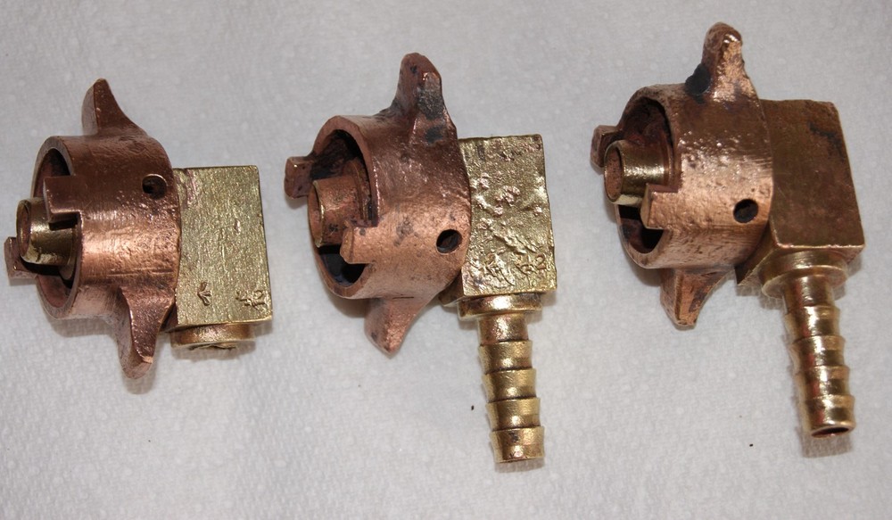

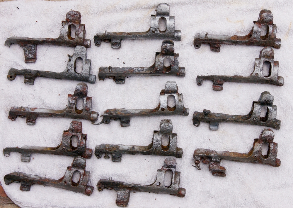

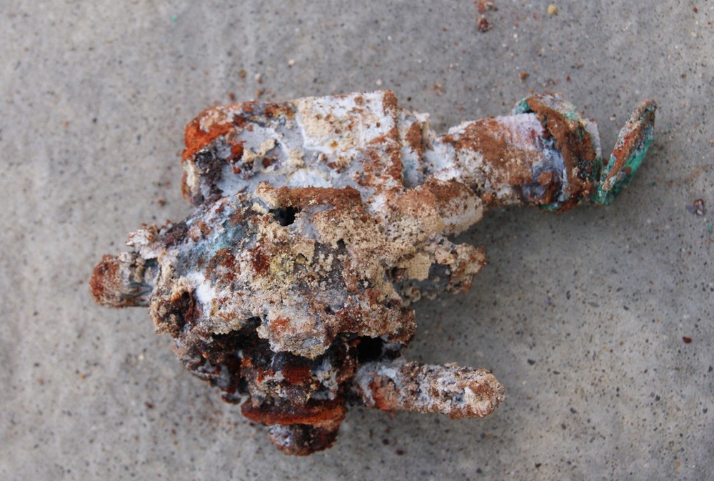

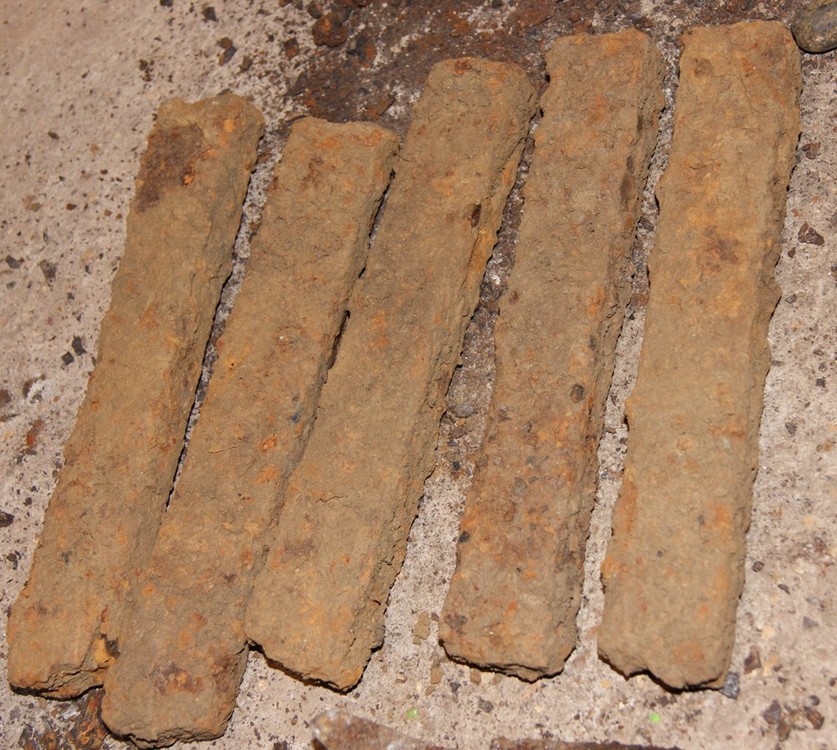

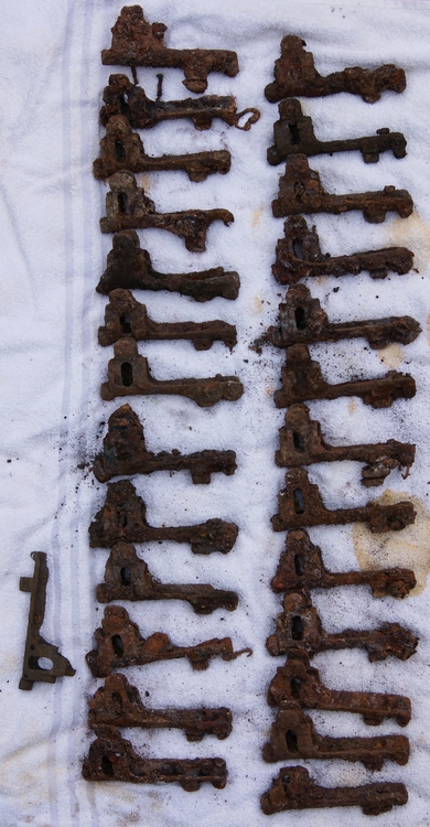

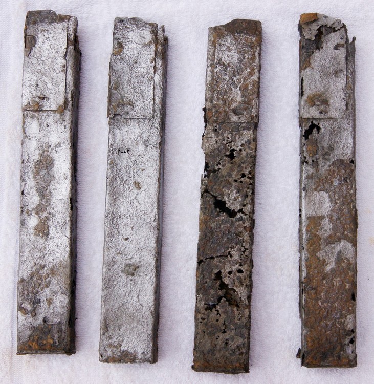

Steve T Posted March 4, 2016 Posted March 4, 2016 General rule of thumb is that a normally heated room in a house will be fine. Garages will be damper and colder and WILL result in items rusting. Material and leather is a different matter and, as a ground dug specialist, I have little knowledge in this area so will leave it to the other guys. But your normal everyday metal objects will be fine inside your house. If you want advice on cleaning and preserving ground dug relics, just ask Been doing it 20 years and am getting half decent at it..... Some examples.......... Sten mags freshly out the ground.... Same mags, a couple of days later..... Vickers connector for attaching the condenser pipe to the water jacket, as it came out the ground..... What it and two others i found looked like 24 hours later..... Lastly, Lee-Enfield No. 1 nose caps, (just a couple), shortly after being recovered.... And after cleaning and preserving...... 1
