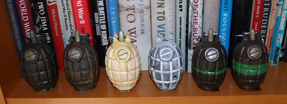

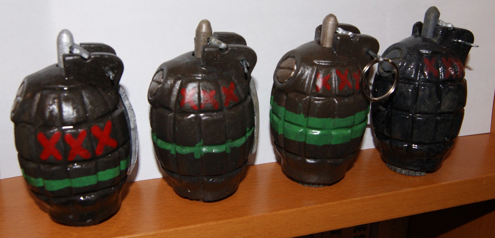

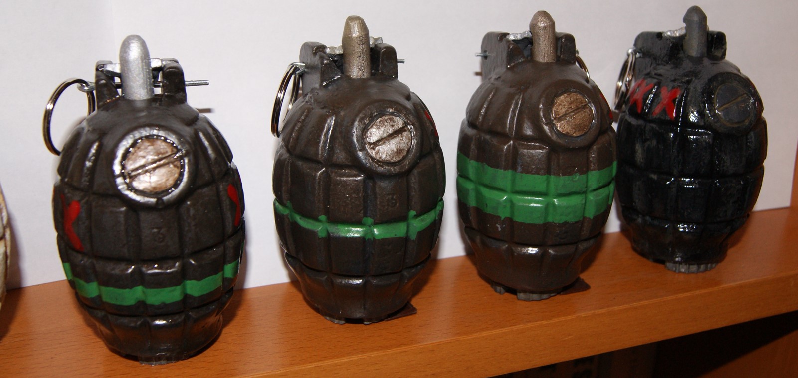

Steve T Posted April 13, 2016 Author Posted April 13, 2016 Six now complete. Which one do you like best as I have 4 more to do and can't decide how to paint them @Davejb @Ham & Jam @HetzersGonnaHetz @Mav352 @Manu Della Valle 1
Guest Fred Karno's Army Posted April 13, 2016 Posted April 13, 2016 The two next to the end ones on both sides ,look fantastic mate .
jeeeensy Posted April 13, 2016 Posted April 13, 2016 19 hours ago, Steve T said: What do you reckon @jeeeensy ? I know you're a stick grenade freak but you might appreciate these as well wow they've turned out great,, well done.. like the shellac finished one,, got my vote all day long,,
Davejb Posted April 13, 2016 Posted April 13, 2016 Yes I like the two on the right, looks more like my one that has an original coating. Now on the subject of holes.......Who dug those holes???. Who,s always digging ruddy great holes deeper that anyone else??Who under cuts their holes so when you think you,re on solid ground, your actually standing above Tom, Dick or Harry and then the ground gives way and you,re in a scene from the Great Escape, you ,you mad tunnel rat assassin .... and that still does,nt alter the fact I,ve got two throbbing flat looking toes!!!!!!!!!!!!!!all because of you,,,, my 36 was perfectly happy sitting on my shelf until you started delving into the realms of moulding , I bet you even had music on and copying that scene from GHOST!!!!!!!!!! 1
Mav352 Posted April 13, 2016 Posted April 13, 2016 I'm with @Ham & Jam on this one, the two that are one in from each end. @Davejb keep this up mate and the government will have us wearing P.P.E to handle militaria

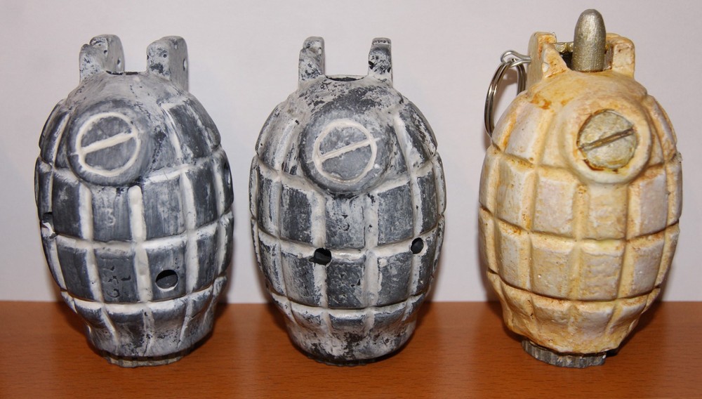

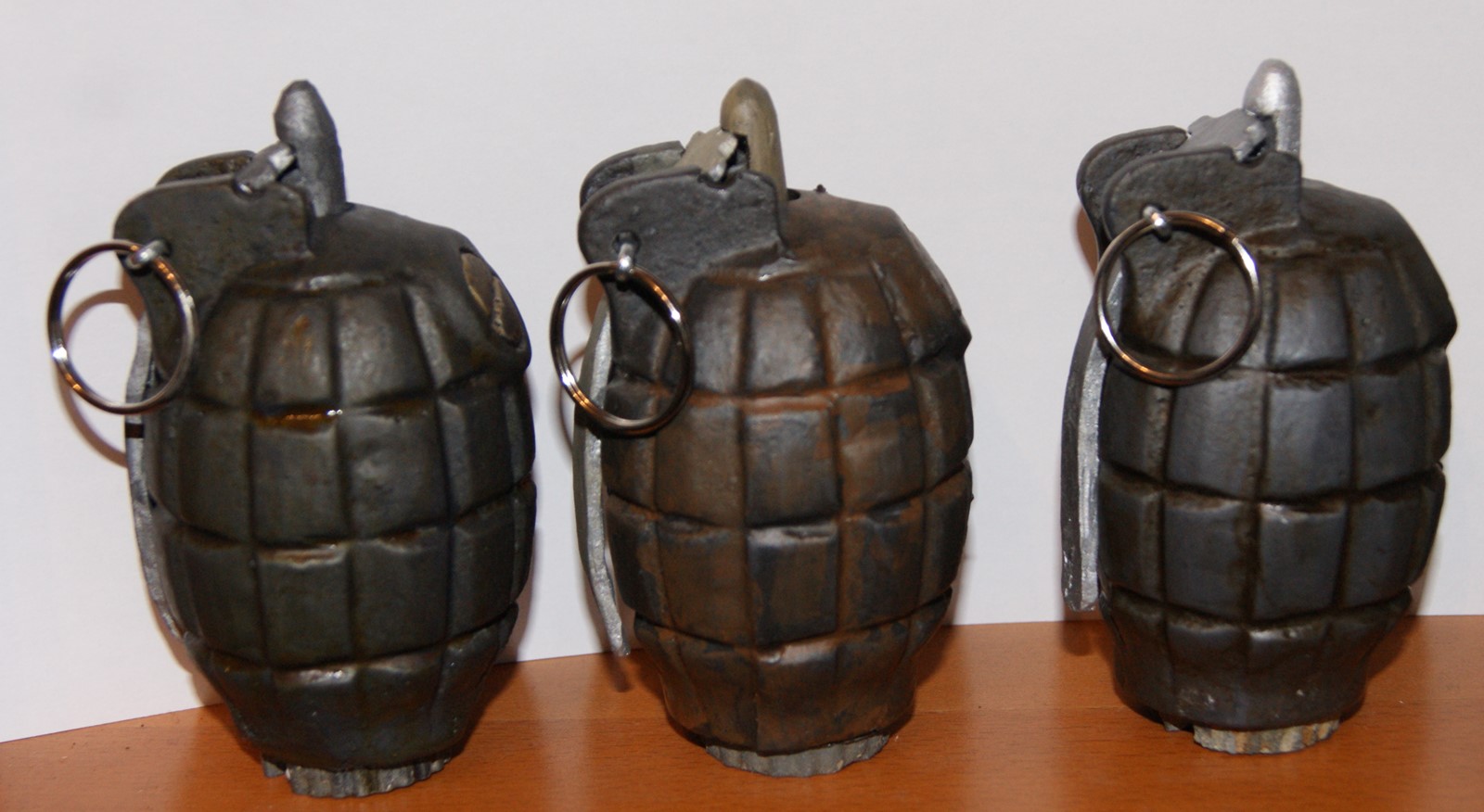

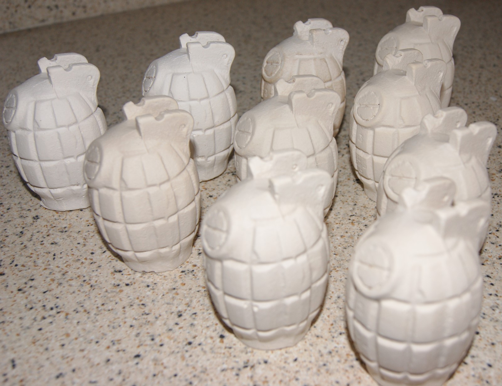

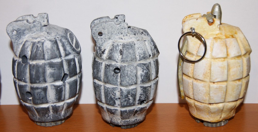

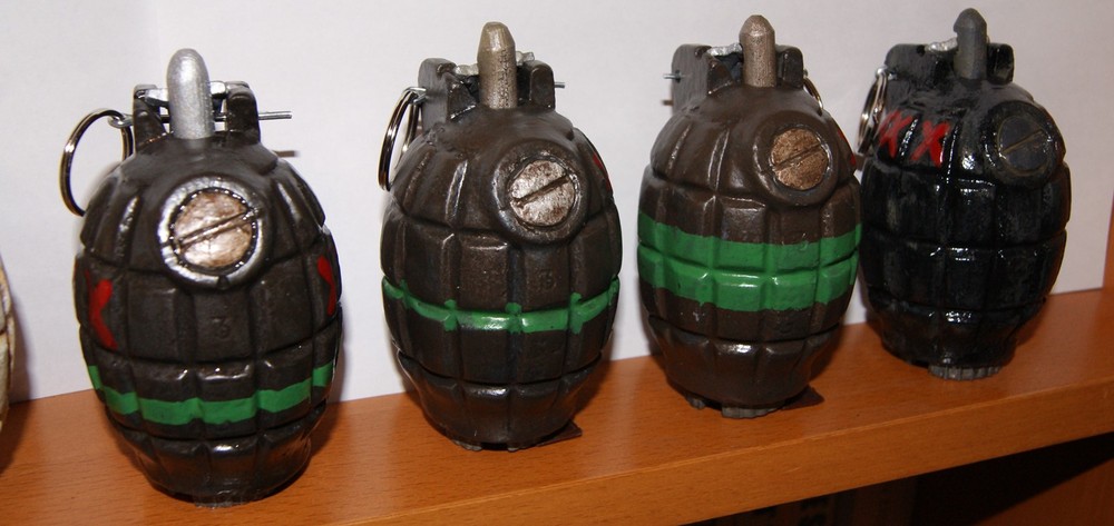

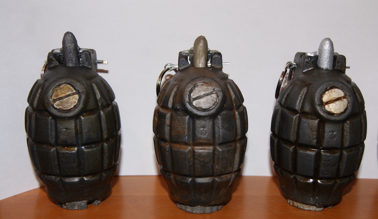

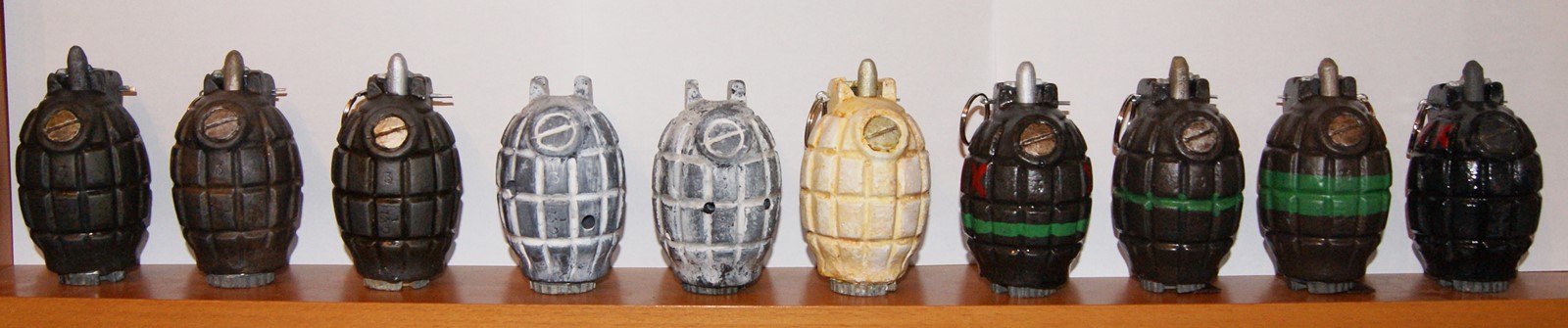

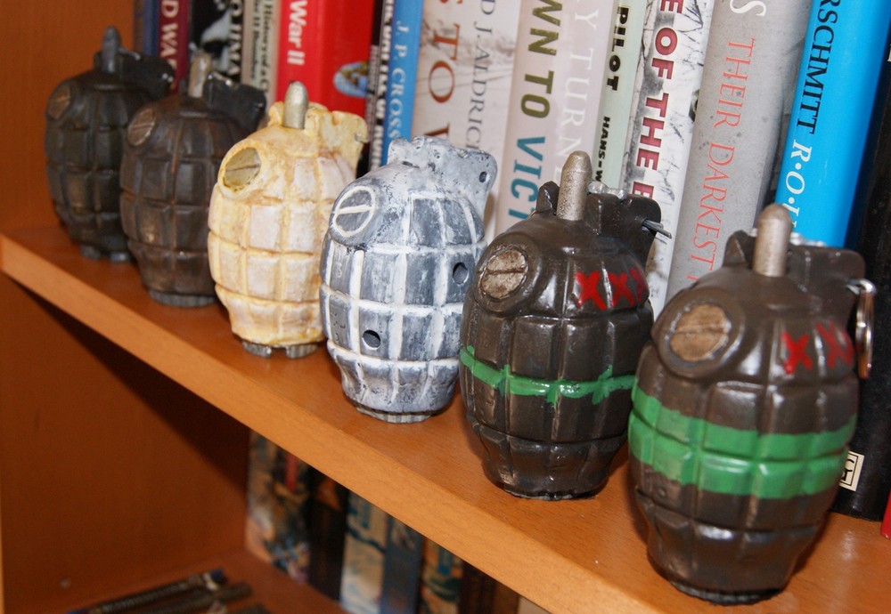

Steve T Posted April 13, 2016 Author Posted April 13, 2016 All done Finished Very VERY pleased with how they've all turned out. 10 replica No 36M grenades......... Silicone rubber mould made using one of my original grenades, ten plaster of paris replicas cast, all ten now painted. All have original base plugs. The striker column is a piece of wooden dowel cut to size/shape, the spoon is air dry clay, (formed in a mould made from the same clay and an original spoon), ring and split pin from the hardware shop Finally got the shellac coating right on the one with the green line around the middle and the X's on the second row down. Found a picture of this type in 'Weapons of the WW2 Tommy'. So......which one(s) do you like best? @Ham & Jam @Lenny @Davejb @HetzersGonnaHetz @jeeeensy @Manu Della Valle @BenVK @Mav352 A reminder of how they started out..... And what they look like now in my War Room First batch, 3 with nearly all shellac and paint worn off, down to bare metal, (painted 'steel' then wash applied of varying colours to match rust or shellac) Second batch, all practice. First two painted 'steel' then white applied all over and quickly rubbed off with kitchen roll before it dried. Last one painted solid white then wash applied. Last batch. First three painted 'steel' and then varying wash applied, (first one is the best I think.....wash allows steel to show through). Last one in gloss black, wash applied to age. 1
Davejb Posted April 13, 2016 Posted April 13, 2016 The 3 steel ones and the 3 green stripe ones are my favourites, so which one do I get for my pain and suffering
HetzersGonnaHetz Posted April 13, 2016 Posted April 13, 2016 @Steve T, my favourite is the middle one on the first pic of 3, all look good tho!
Steve T Posted April 13, 2016 Author Posted April 13, 2016 26 minutes ago, Davejb said: The 3 steel ones and the 3 green stripe ones are my favourites, so which one do I get for my pain and suffering An unpainted one. It'll give you something to do whilst your toes get better.
Steve T Posted April 13, 2016 Author Posted April 13, 2016 I have to say I do like the steel ones, but I think my favorite is the last one I did........green stripe near the bottom, 3 big red Xs. (because the shellac coat works really well.....the pic doesn't do it justice )
