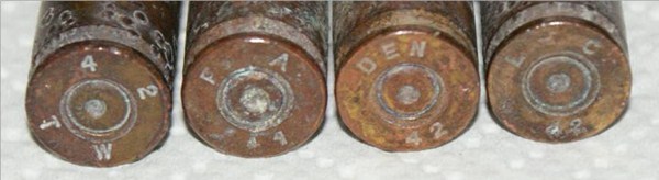

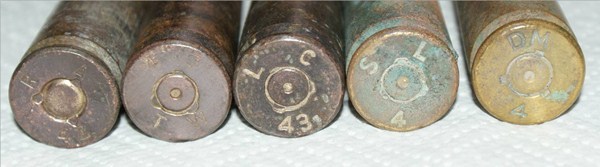

With American cartridges, the headstamps are usually very short, sharp and sweet ! Take for example these 50 calibre cartridges, again found on various airbases around the UK.
56c9cf3392e6a_50calupright.jpeg.6c0376da
56c9cf3334e28_50calheadstamps.jpeg.97167
The headstamps on these are not as detailed as some. Usually you get the manufacturer ‘code’ and the last two digits of the year, EXCEPT in the case of 1944 which is always represented by a single ‘4’. So on these cartridges you have RA 43, TW 43, LC 43, SL 4 and DM 4. RA is Remington Arms Company, Tw is Twin Cities ordnance plant, LC is Lake City Ammunition Plant, SL is St Louis Ordnance Plant and DM is Des Moines Ordnance Plant.
These headstamps are repeated in standard 30 calibre and Carbine rounds. Take for example these 30 calibre cartridges, found on Slapton Sands.The headstamps all follow the same principals as the 50 cal cartridges.

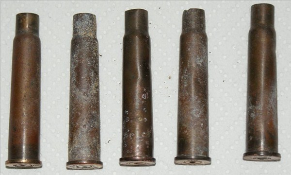

British cartridges tended to be a little more verbose. Take for example these cartridges, all found on an old D-Day practice beach.
56c9cf3448d26_303upright.jpeg.1e40fa37b6
56c9cf33e8461_303headstamps.jpeg.6d6c52a
The headstamps, as you can see, contain a little more information. We still have the manufacturer ‘code’ and the year of manufacture (as either 2 or 4 digit), but we also regularly see ‘VII’ which denotes it is a standard Mark VII cartridge, and in some instances ‘303’ which obviously denotes the calibre. Different Roman numerals denote different 'marks' of cartridge. You may also see the marks 'Z' or IZ' which denote the type of cordite/powder used.
It is interesting to note that the last three cartridges all have the same ‘odd’ shaped firing pin mark. This elongated mark is made by the firing pin of a Bren gun. A Lee-Enfield makes the ‘dot’ mark in the left hand two cartridges. So not only does the headstamp tell us something, even the firing pin mark can !

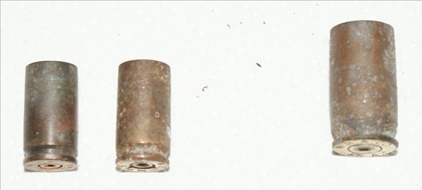

Now let’s look at 9mm and .45 calibre cartridges, again found on a D-Day practice beach.
56c9cf30cf6cf_9mm45headstamp.jpeg.df35a2
56c9cf312f41a_9mm45upright.jpeg.dc748bc4
Now you can see a pattern emerging ! Hopefully you can now determine what the headstamps mean when you look at them. You have the manufacturer code, the year stamp and the calibre………….It’s easy once you know what you’re looking at !

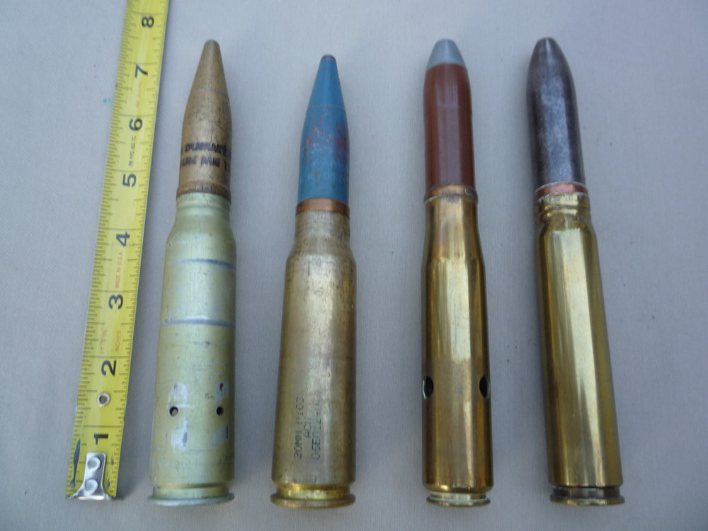

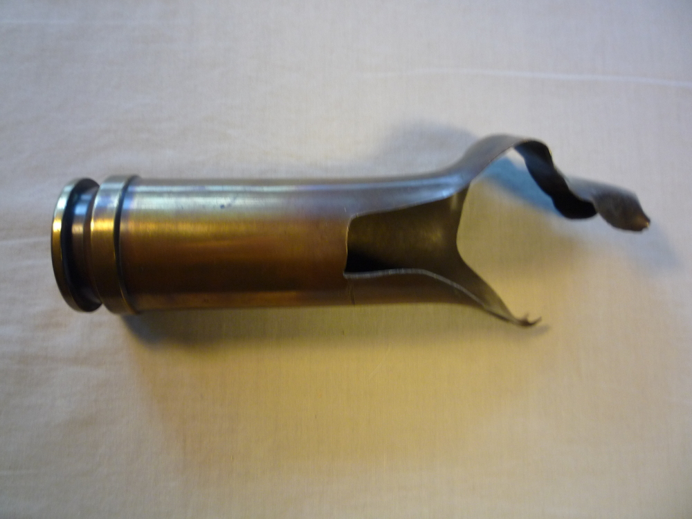

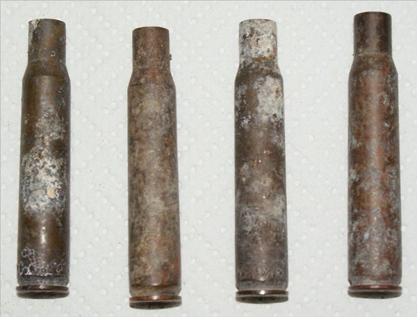

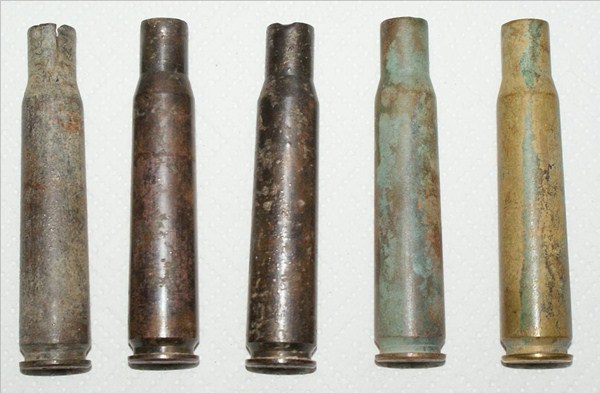

Some 20mm rounds
"Cooked off" German 37mm.
German 37mm headstamp.  A lot of information there.  Interesting--after "6348" looks like a Jewish star of David.
Upper--French 37mm Hotchkiss round.  Around WW1 British, USA, French, & Russian all used this weapon in some form or other.
Lower--USA 37mm from a Bell p-39 Airacobra.  This was given to me by a gentleman who worked on P-39's in WW2.

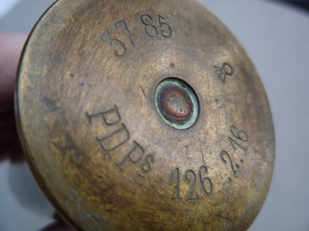

French 37mm head stamp. "37-85" means 37mm for Modele 1885. "PD.Ps" means, Pinchart Denys, Paris (arsenal?).  "2-16" means DOM Feb. 1916,  "126" is still a mystery to me.

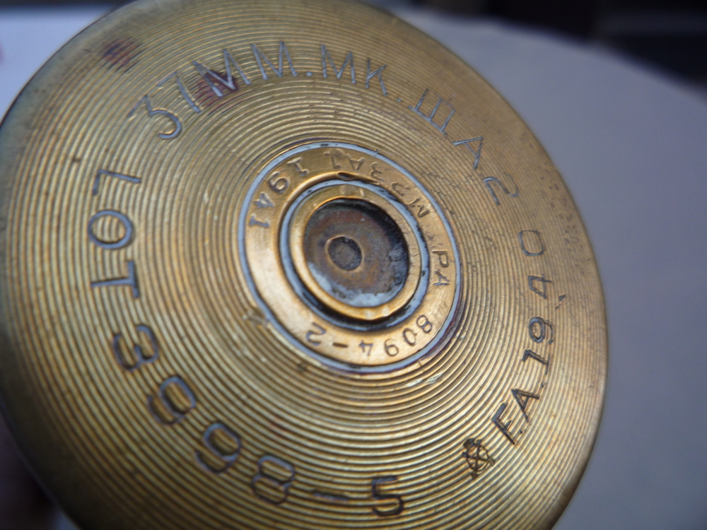

USA 37mm headstamp
