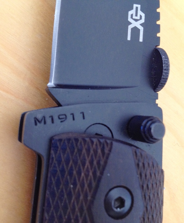

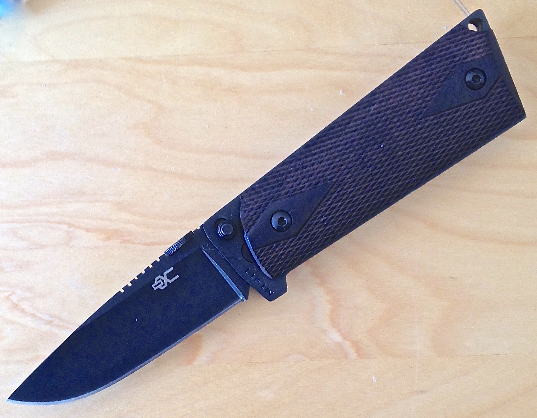

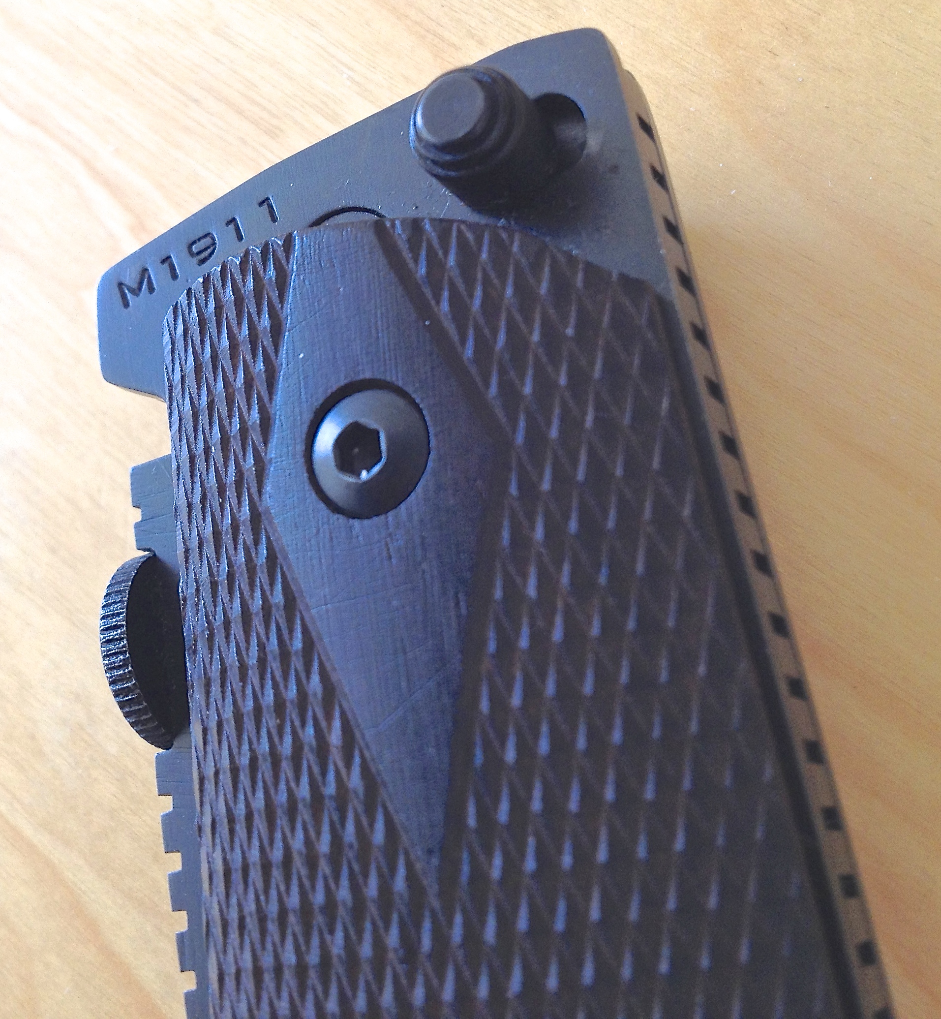

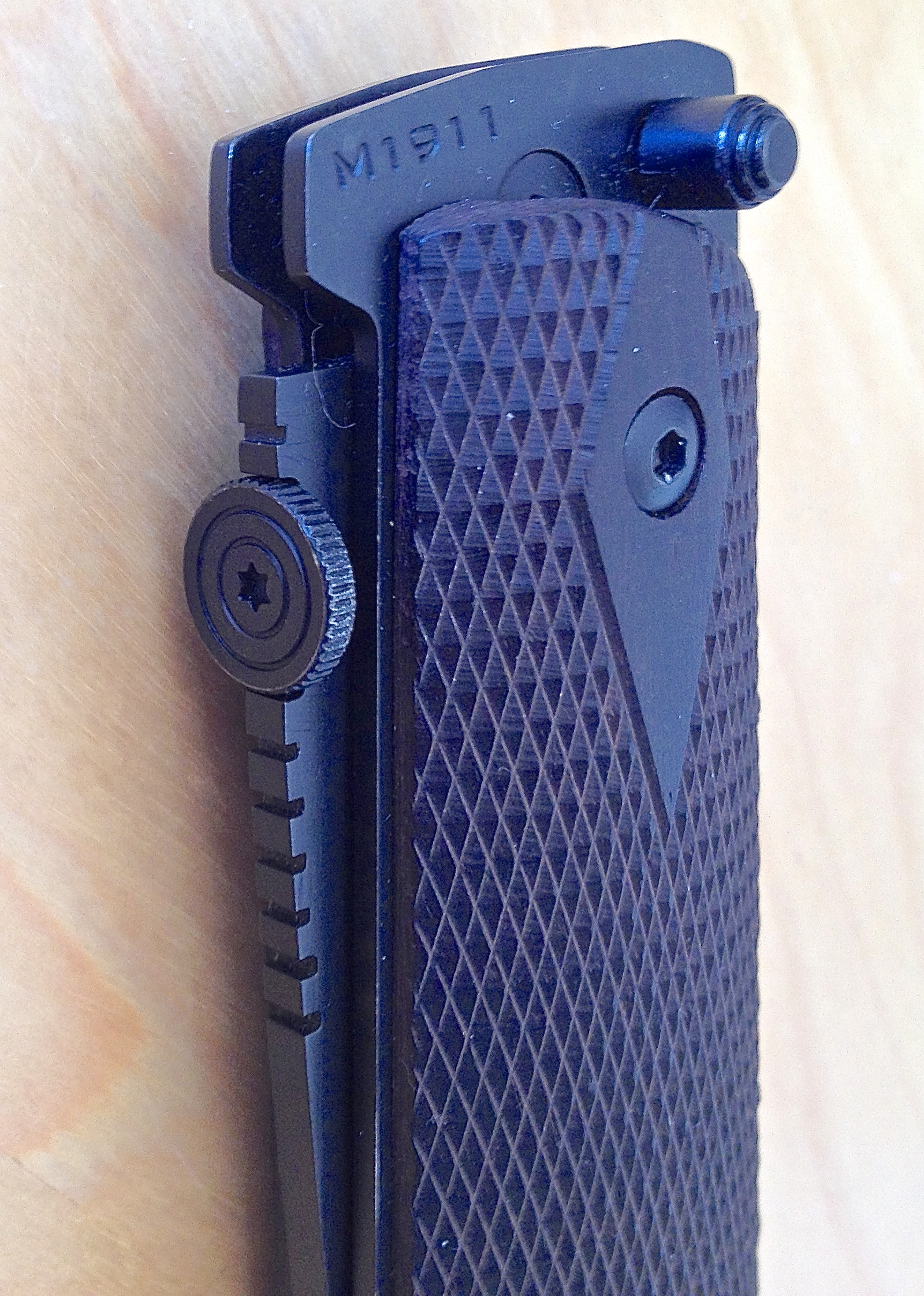

Tony Walker Posted June 6, 2016 Posted June 6, 2016 All you 1911 Auto fans might be interested in this M1911 knife. I was sent it by the manufacturer when we lived in Arizona as a writers' sample, so I could write a magazine article about it. Only just re-discovered it at the bottom of a drawer the other day, still in the box. I think it's probably illegal for carrying in the UK, as it's a lock knife, but to me, the interesting thing is that the grips are from a 1911 pistol. I can't find a copy of the article I wrote, but when I did it, I had some scrimshaw imitation ivory grips on it. 1

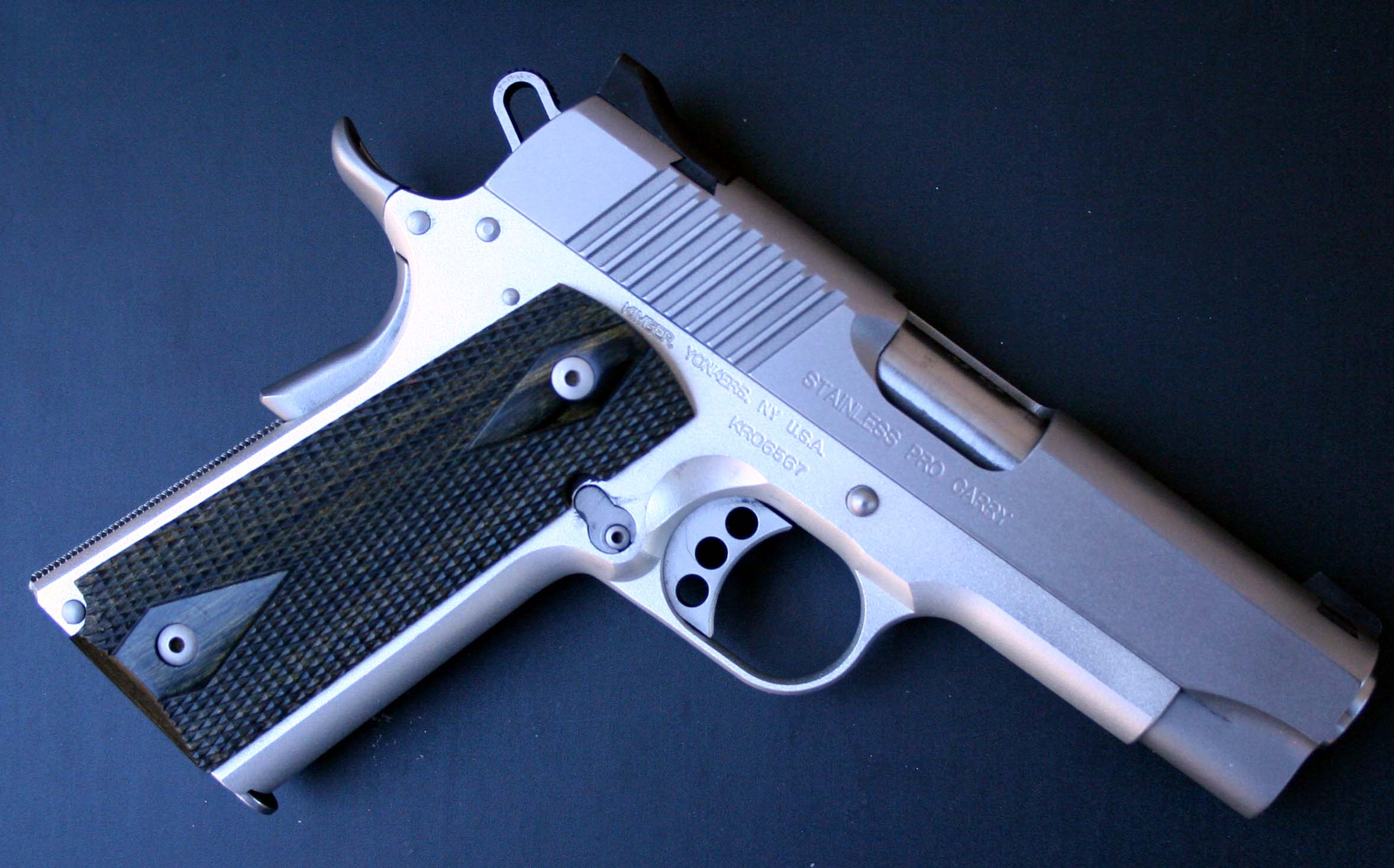

Tony Walker Posted June 9, 2016 Posted June 9, 2016 ..and here's a picture of my wife's Kimber Pro-Carry .45, together with a couple of pics of her with her Gold Cup, with fancy pewter Colt grips, and shooting her compensated Colt Commander in a match in Arizona. 1
