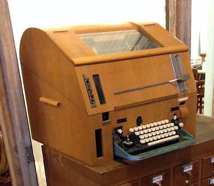

val Posted September 28, 2018 Author Posted September 28, 2018 22 hours ago, Telegraphentruppe said: But my guess stays Another modell of the T36. Found it! It's Siemens. https://commons.wikimedia.org/wiki/File:Siemens_T38_(1).jpg https://commons.wikimedia.org/wiki/Category:Fernschreiber_Siemens_T38

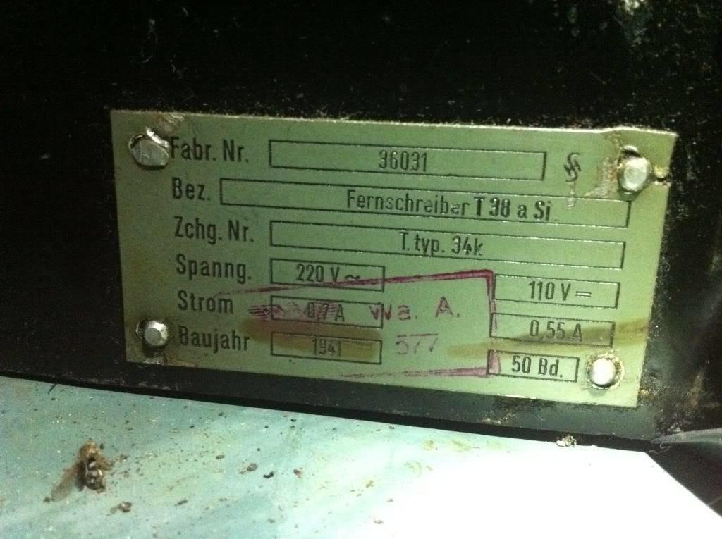

Telegraphentruppe Posted September 28, 2018 Posted September 28, 2018 Top, very good detective work. One Riddle solved. But why stand on the plate Ttyp 34 ? But the one on the pics is the one on the foto. Now we need the type of the Fernschaltgerät.
