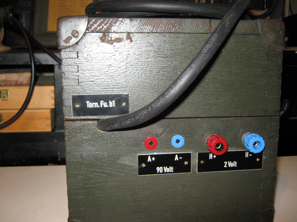

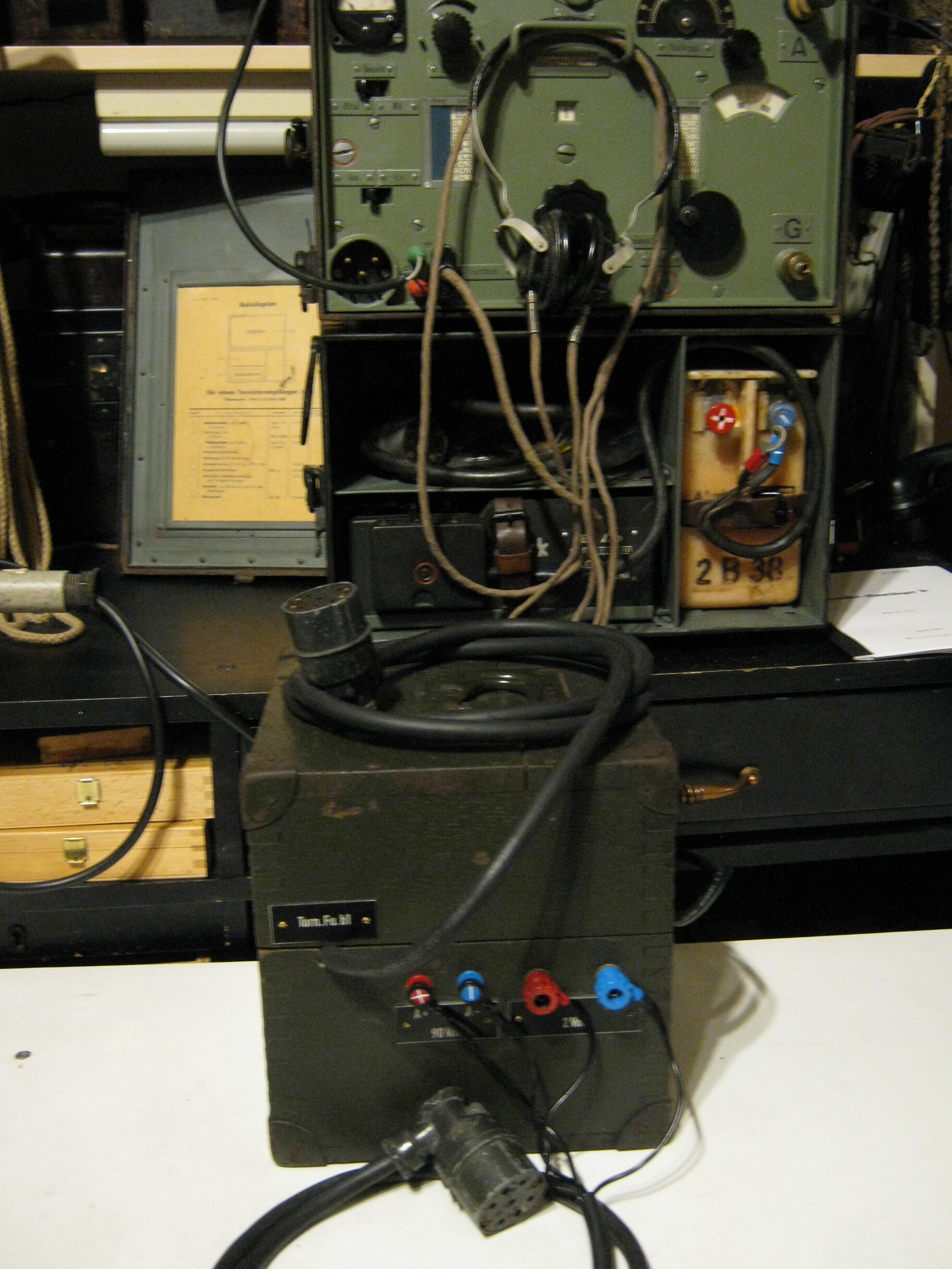

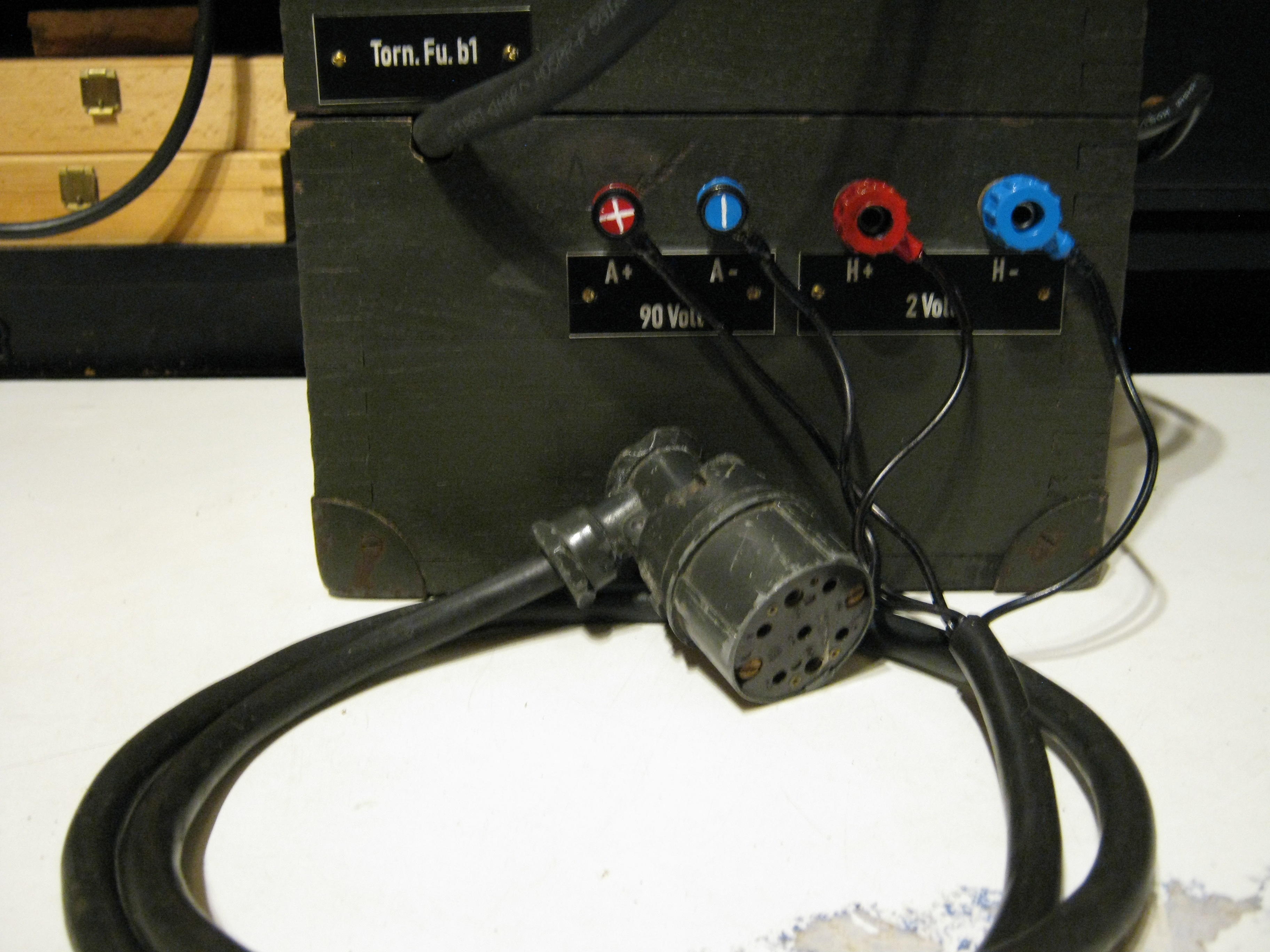

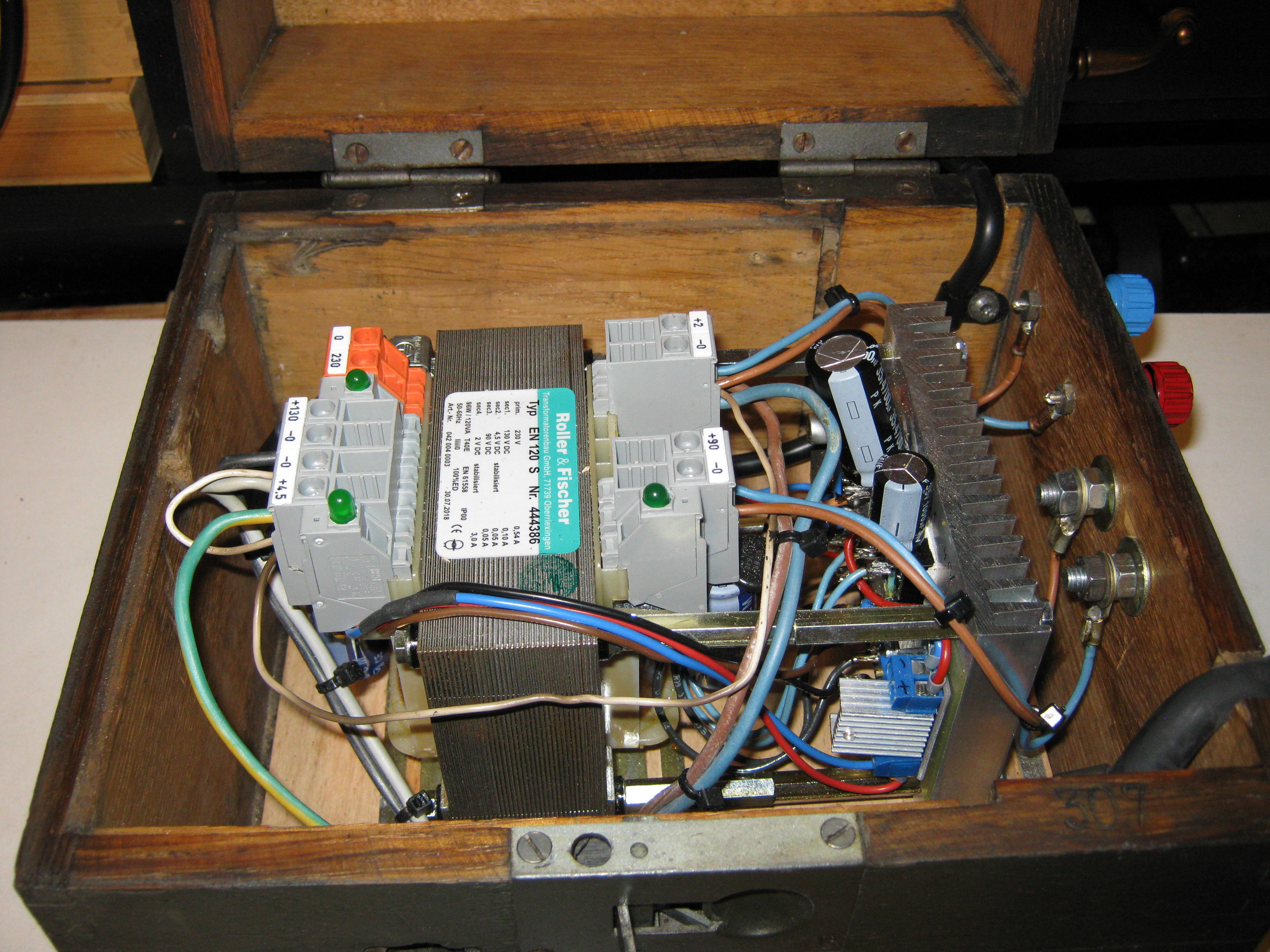

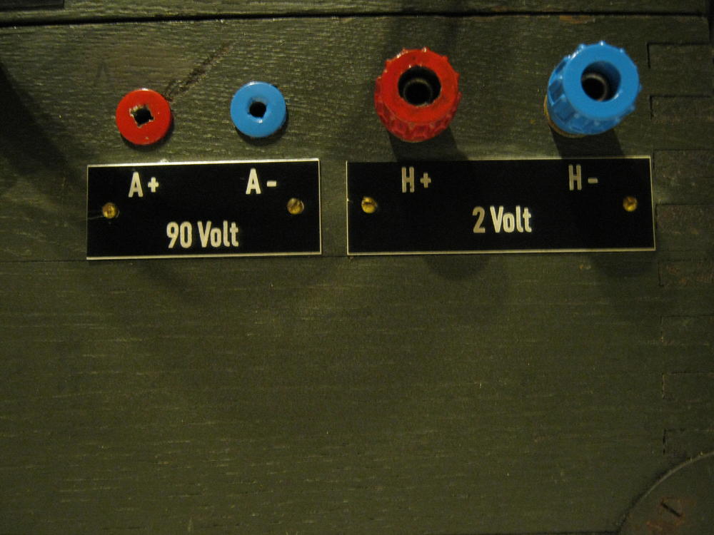

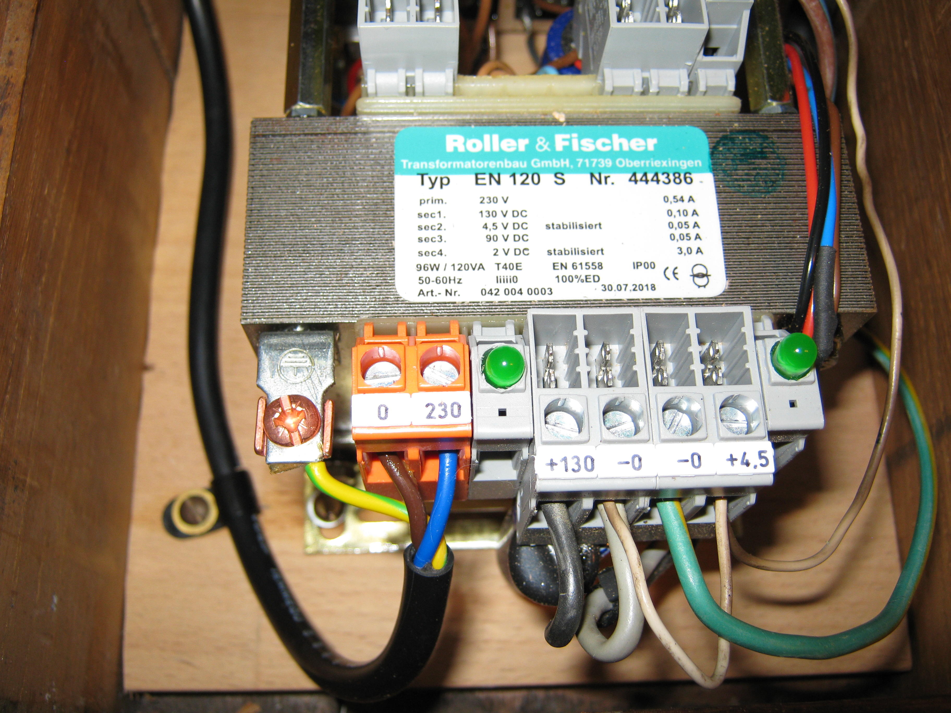

I want you to meet my transformer for my radios today.

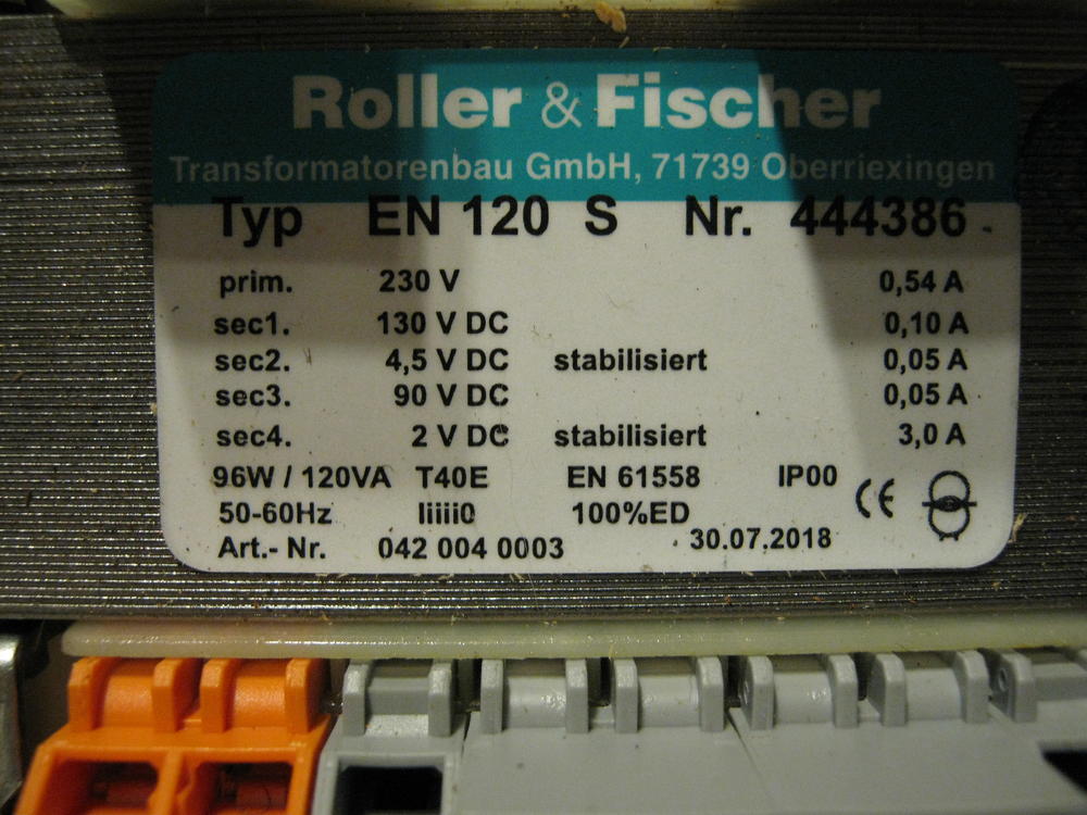

The transformer was made by Roller & Fischer according to my wishes.
Input
230 Volt.
Output
130 Volt,
90 Volt,
4,5 Volt
2 Volt
(DC)
2 volts and 4.5 volts were stabilized, under full load 1.93 volts were measured at 2 volts and 4.42 volts at 4.5 volts.
Thus this transformer is suitable for almost all Wehrmacht radio sets.

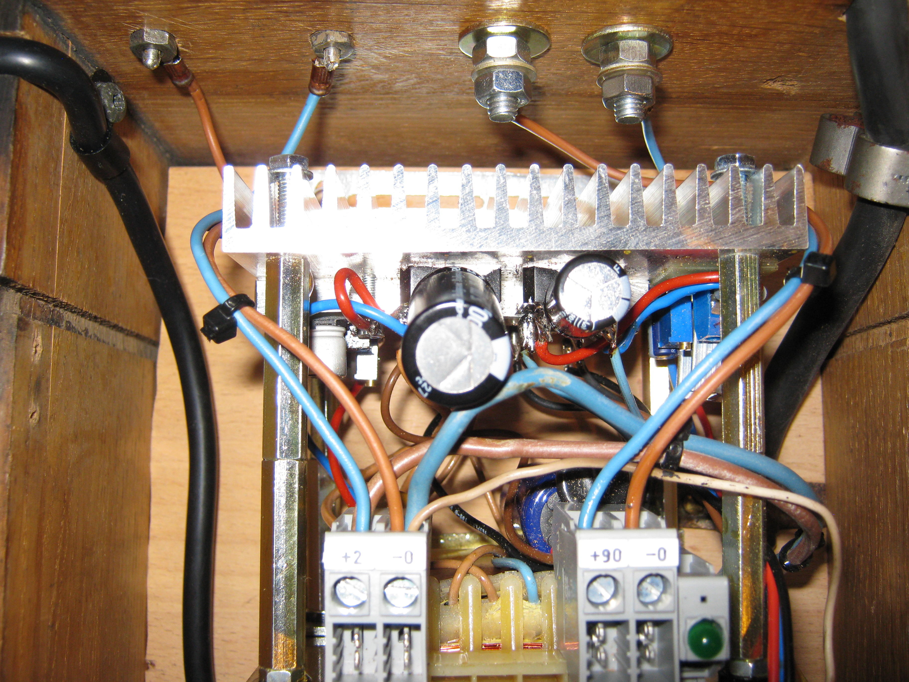

@Alperator nice work! I would however use extra isolation around the output wires (2V & 90v).
Currently they are touching metal radiator there and if things get hot and isolation melts, bad
thing can happen...
Good idea, I'll put some more insulation on it.
Thanks for the tip.
