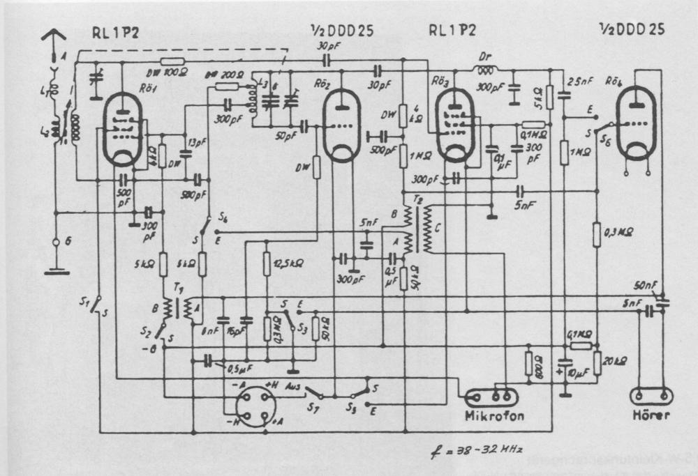

The circuitry of the Dorette roughly follows that of the Feldunksprecher h with only one of the two RL1P2 HF valves in use while receiving or transmitting. The designers added a clever trick in the receiver: after passing the HF signal from the antenna through valve three the LF signal from the oscillator/detector passes through the same valve for a second time. This so called reflex circuit essentially adds a amplifier stage without having to add an extra valve:
Note that the switch box of the microphone was not used to switch between receive and transmit, this was purely done with the main switch on the Dorette itself.

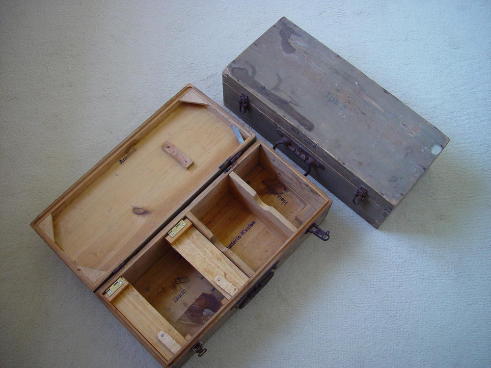

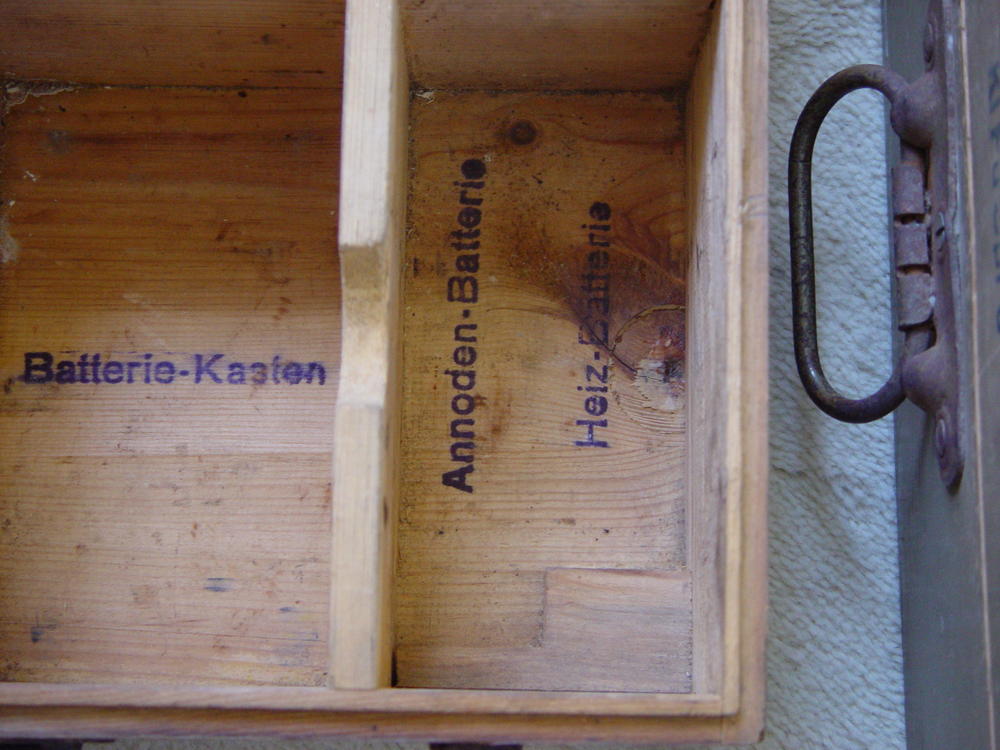

The Dorette was supplied in a wooden box "Transportkasten a" which held the radio, battery case, Dfh.f and Kmf.c headset, antenna and batteries in separate compartments:
The two airtight-packed batteries were stored separately and were only to be opened immediately before use:

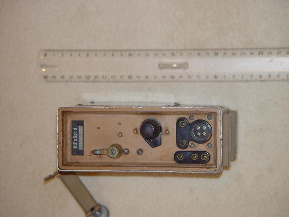

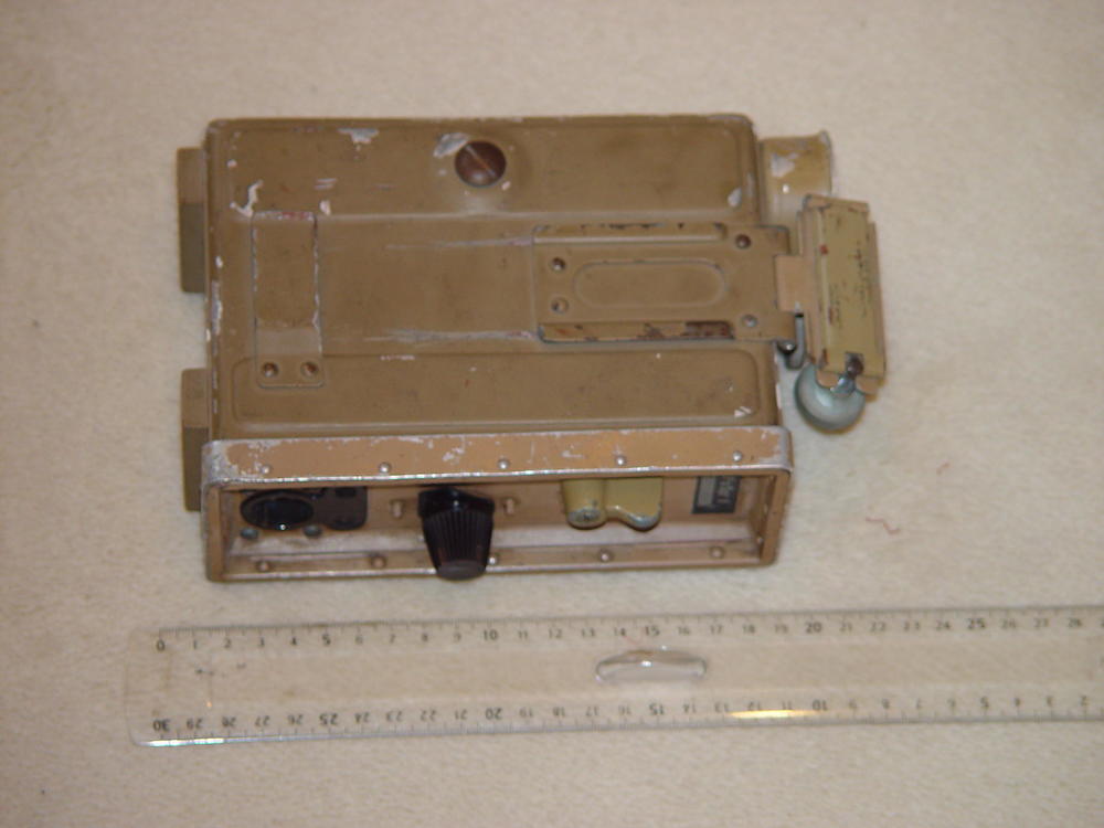

The radio itself is a triumph of minimalistic design. The front panel contains sockets for the power supply, Dfh.f headphone and Kmf.c throat microphone. A main switch (off, receive, transmit) and the frequency tuning knob complete the panel:

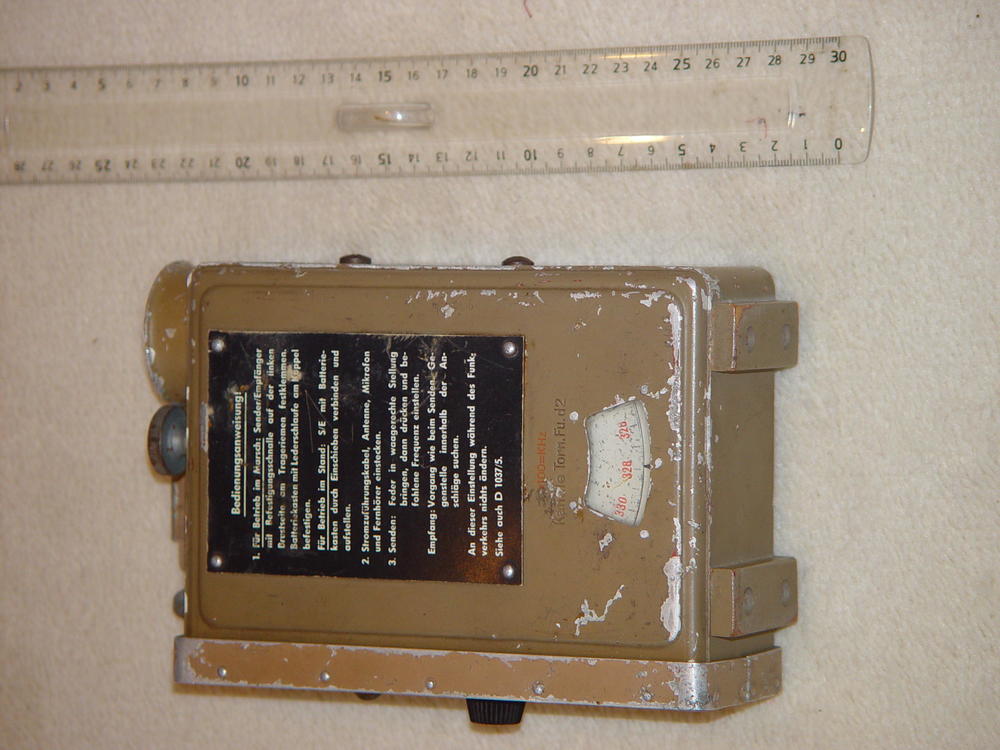

The front side of the radio contains the frequency dial and the used instructions:

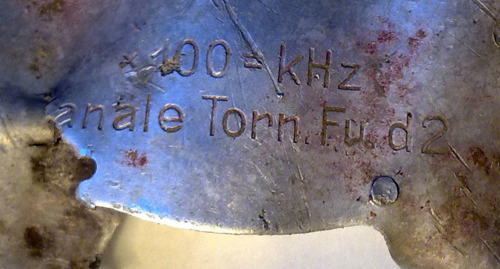

Note: The photograph shows the radio tuned to 32.8 MHz, which would allow it to communicate with the FU5 tank set or the Feldfunksprecher f. The higher frequencies are calibrated in the same channel numbers as the Torn.Fu.d2.

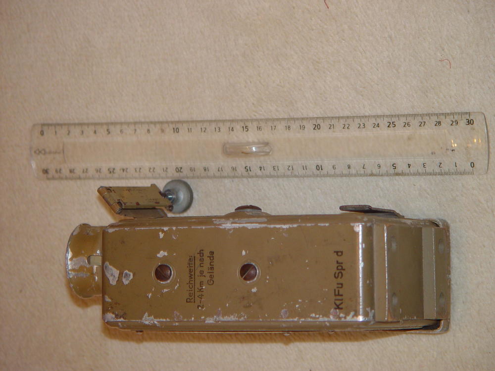

The back of the radio shows the range of the radio (2-4 km, depending on topography):
The carrying side shows the brackets used to attach the radio to the standard Y-straps of the soldier; the top clamp was clamped around the Y-strap while the bottom bracket slide behind the strap to keep the radio upright.

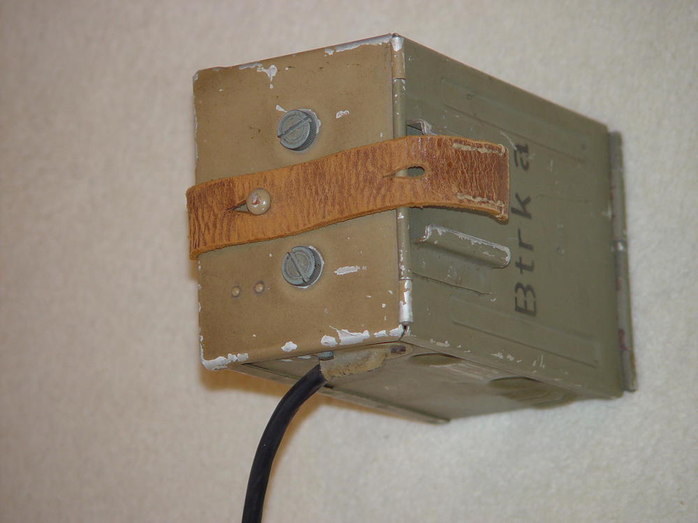

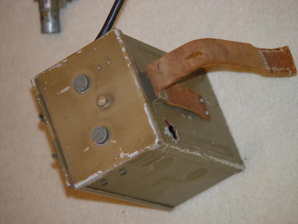

The battery box (Batteriekasten A) contained the two Zinc-Air batteries. A leather strap allowed it to be hung on the belt of the soldier, or it could be configured as a carrying handle:
On the rear, the battery box has a bracket that allows it to be attached to the radio itself:
Note: again notice how the box is made from components finished in different shades of tan.

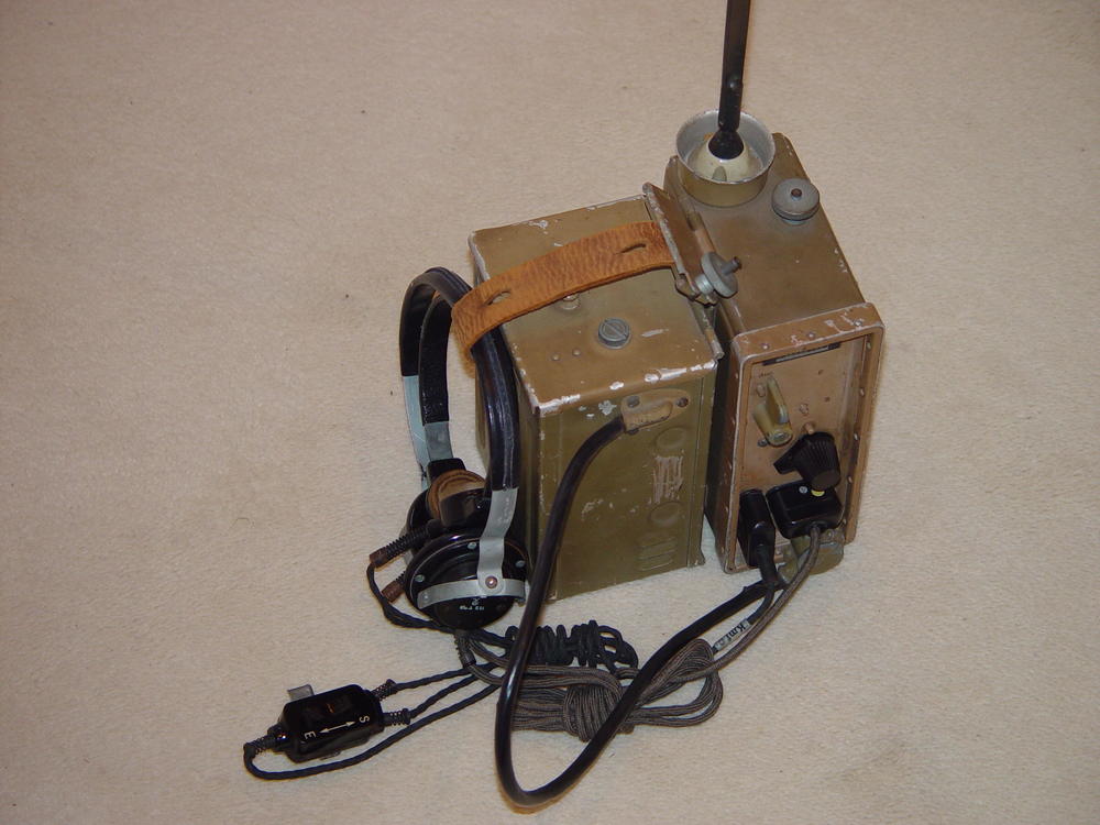

The dorette as a static radio station, complete with antenna, Dfh.f headset and Kmf.c throat microphone. The battery box is attached to the radio while the leather strap of the battery box is used as a carrying handle:

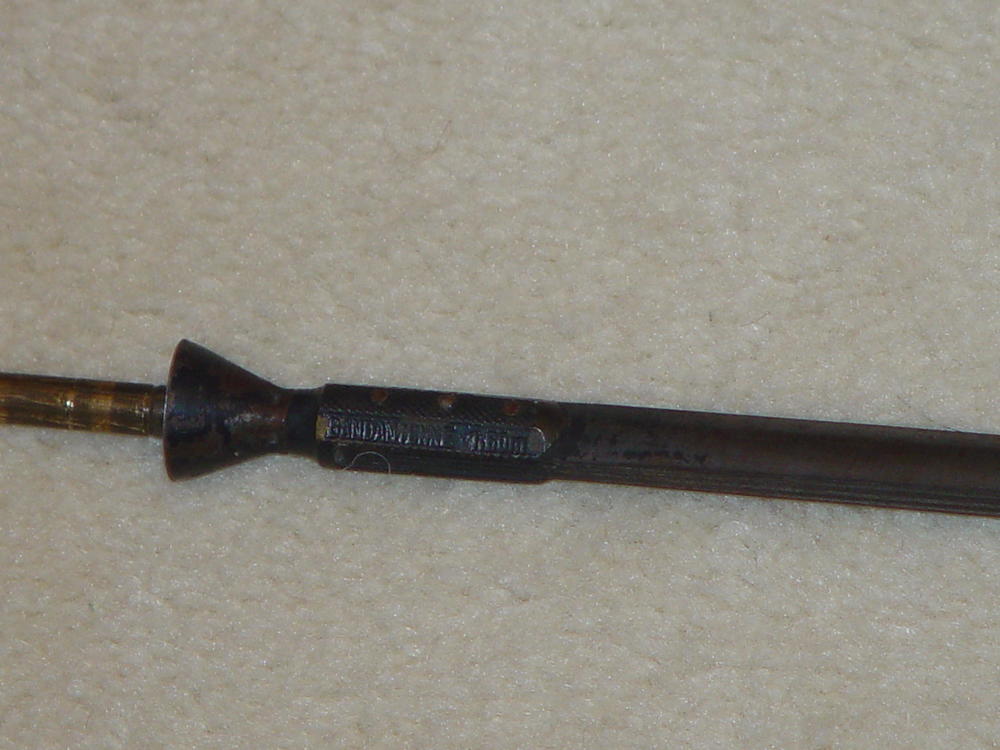

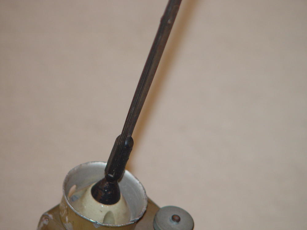

The Dorette uses a fairly long pliable "Bandantenne":
The correct antenna for the Dorette is 1.6 meters long and is clearly marked so on the base:

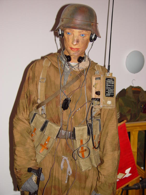

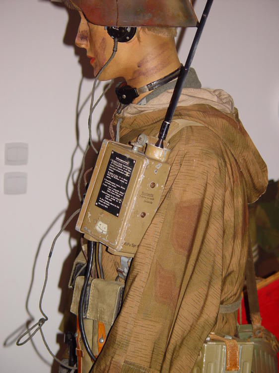

Alternatively, the radio could be worn on the chest, attached to the standard belt and y-straps  as in this impression of a late war infantryman:
The radio is secured to the Y-straps:
The battery box is attached to the belt near where the entrenching tool is normally worn:

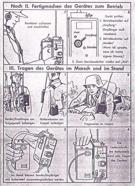

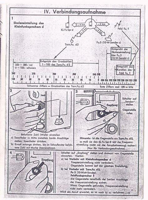

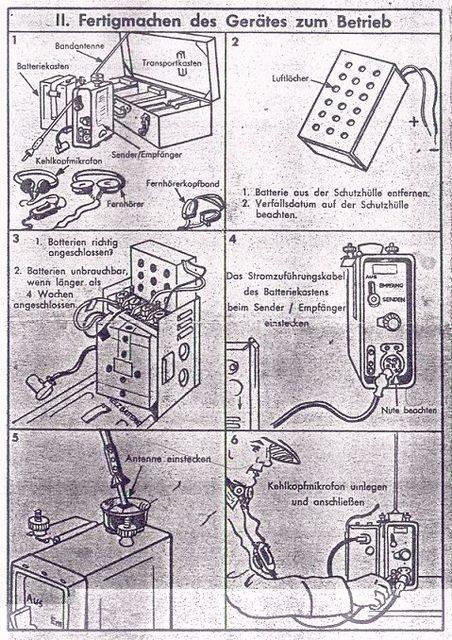

An instruction leaflet was delivered with each boxed set detailing the basic preparations for operation:
1786519601_Anleitung2.jpg.513c9ded260f05d8f3540b81b4015344.jpg1225393032_Anleitung2a.jpg.6642341cb8c65f36645a323788ec1265.jpg
Note: the first cartoon shows that a "Fernhörerkopfband" was delivered with the Dorette. So far no complete Dorette boxes have been found with a headband in place so it is unclear of this accessory was actually supplied.
Another section describes the frequency band and the possible connections with other radios that could be made.
Further sections describe how the range could be increased by pointing the antenna or using a wire antenna. The final section gives some examples of how the radio traffic should be conducted including code names:

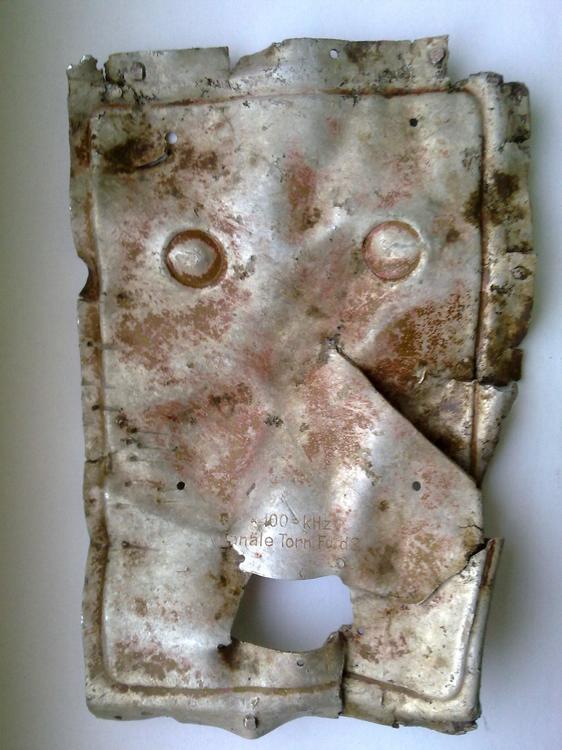

As @Funksammler already mentioned, most ground dug Kl.Fu.Spr.d's come from Baltics.
Here i add a images of ground dug early version Dorette found in Estonia.
And this relict is from Heiligenbeil Pocket.
Seems like a direct hit!

One of the best and most correct schematics.
Hello val
very clean schematic, i suppose the connections for powering
are seen from outside  the set ?
regards pierre
9 minutes ago, tornfuté said:
Hello val
regards pierre
Yes, from outside.
