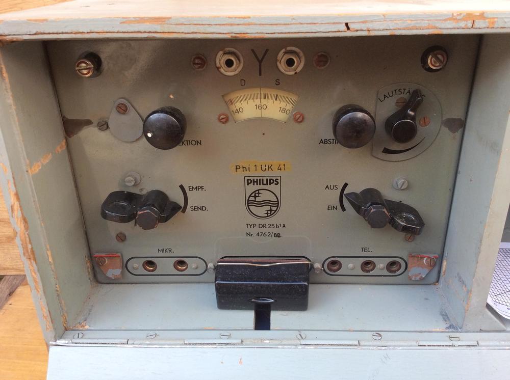

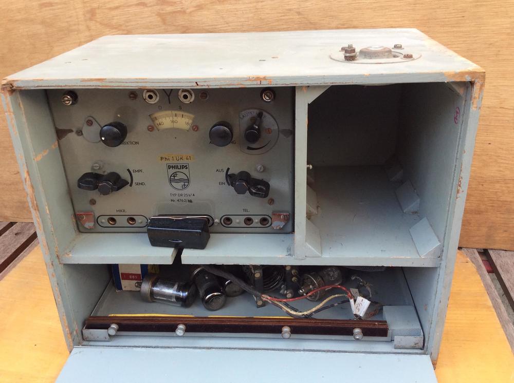

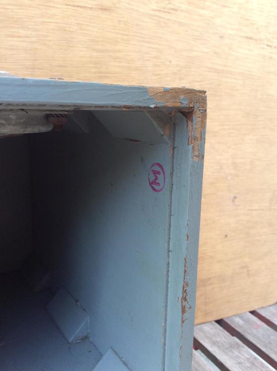

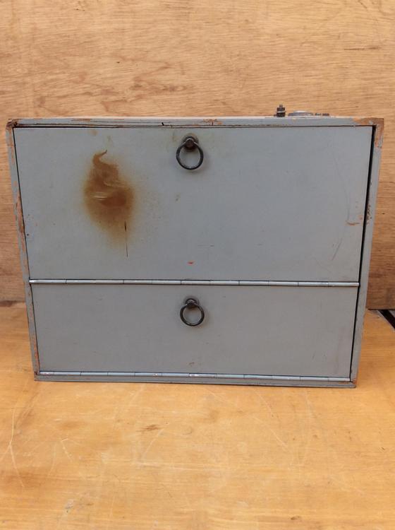

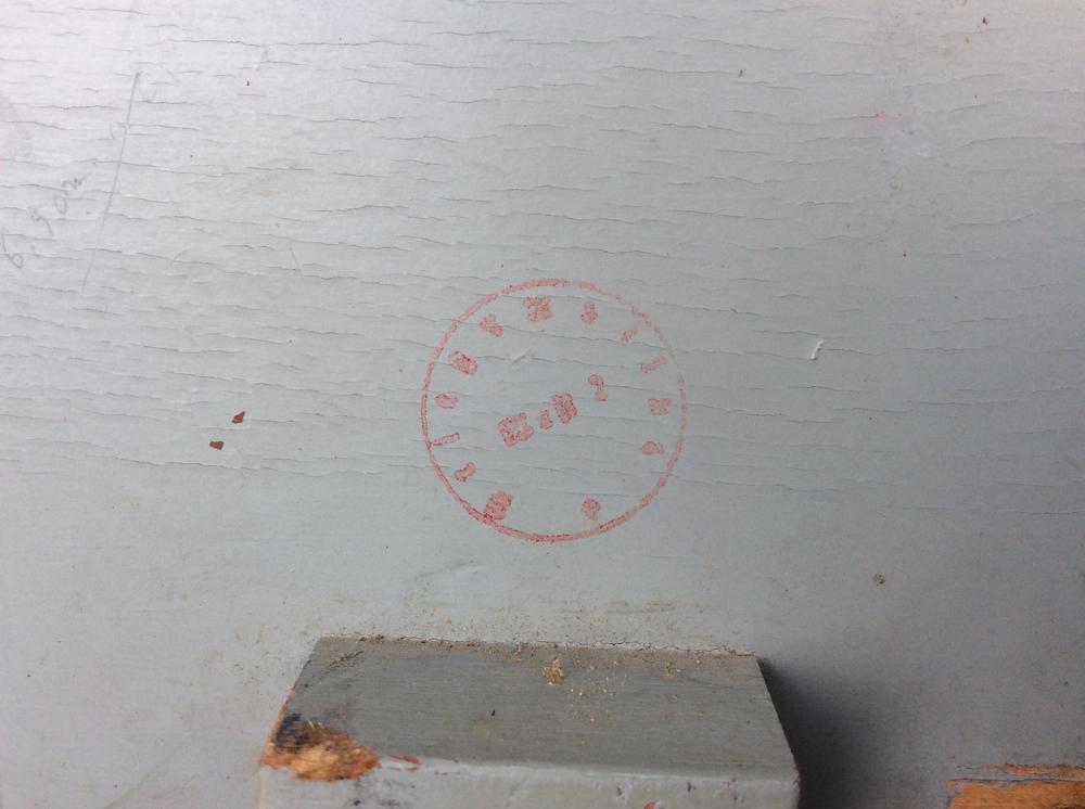

tornfuté Posted October 12, 2018 Posted October 12, 2018 it’s a vhf transceiver 37,5 to 46,2 mhz tubes : 2 x KDD1 and 2 DF25 power output is 1 watt A3 mode = voice accessories are one mike with 2 prongs connectors and one headphone with a 3 prongs connector like nearly on each marine set , lower part part of set is for batteries This set is in grey marine color , we see 2 marks one round one where it’s written kriegsmarine , and a small one a M. i have read in trenkle that the set is instable and unsatisfactory for any use. I don’t know where it’s used , may be for harbour ships like tugs , or fisher ship, i know they are used for recovering pilots shot down at sea. I know it because there is in one notice an antenna for a one watt set, on board fishing ships from 17V.P Flotille , it’s mentionned but without set name so it can be also from LO 1 uk 35 also one watt., antenna strahler is 1,67 m and placed on top of mast at 13 meter above main deck. now the pictures of set 1 1 1

tornfuté Posted October 12, 2018 Author Posted October 12, 2018 Val i have no idea about batteries it must be value like on the schematic the radioorg set seems me adapted , antenna base is from torn eb , and on my set there is no carrying handles, about psu it can be a well done psu they are not a lot of infos about this set 1

tornfuté Posted October 12, 2018 Author Posted October 12, 2018 Val i know the Uori psu , indeed it’s for the phi uk 41 , but it ´s something else a biger psu that will never fit in the batterie box , hence i believe the small one is a well hand made . the available place or height is 97 mm , compare with UORi schematic
val Posted October 13, 2018 Posted October 13, 2018 @tornfuté i think you are right the psu is self made and box is also not original, maybe converted forim Torn.E.b accessory box or hand made and handles taken from Torn.E.b box.
tornfuté Posted October 13, 2018 Author Posted October 13, 2018 Some infos i found in my papers around 1200 sets were furnished to KM, the set was never use on board ship , it’s a portable set put in a frame with a canvas , 2 antennas type were used a l/4 and a l/2 batteries are 1 x 150 v batterie and 3 x 4;5 v, it was used in Danzig aera at the end of WW2 when troops evacuate due to red army attacks about what i had written on 17 flotille fisher ship , the antenna must be for the Lo1 uk35 1 1

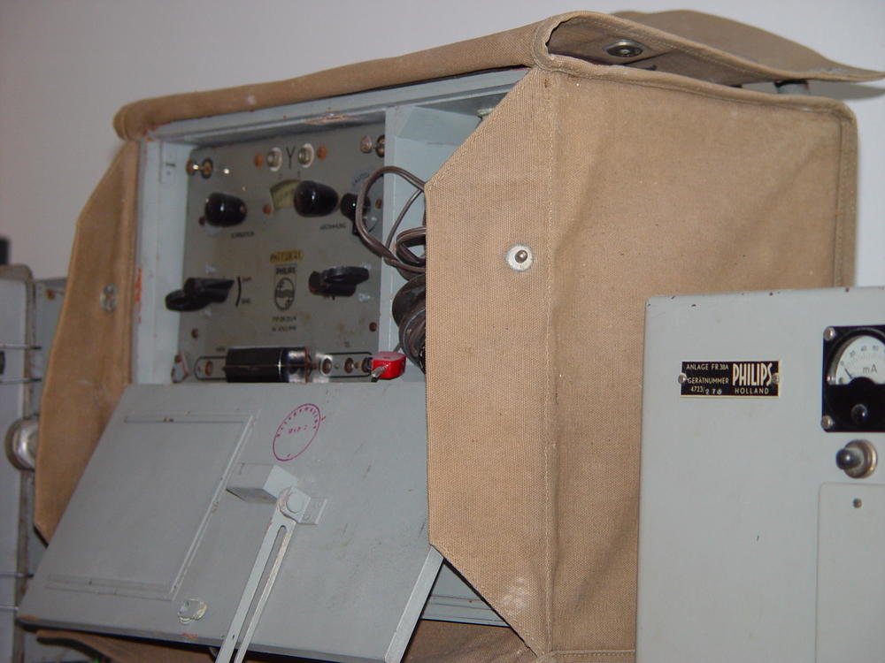

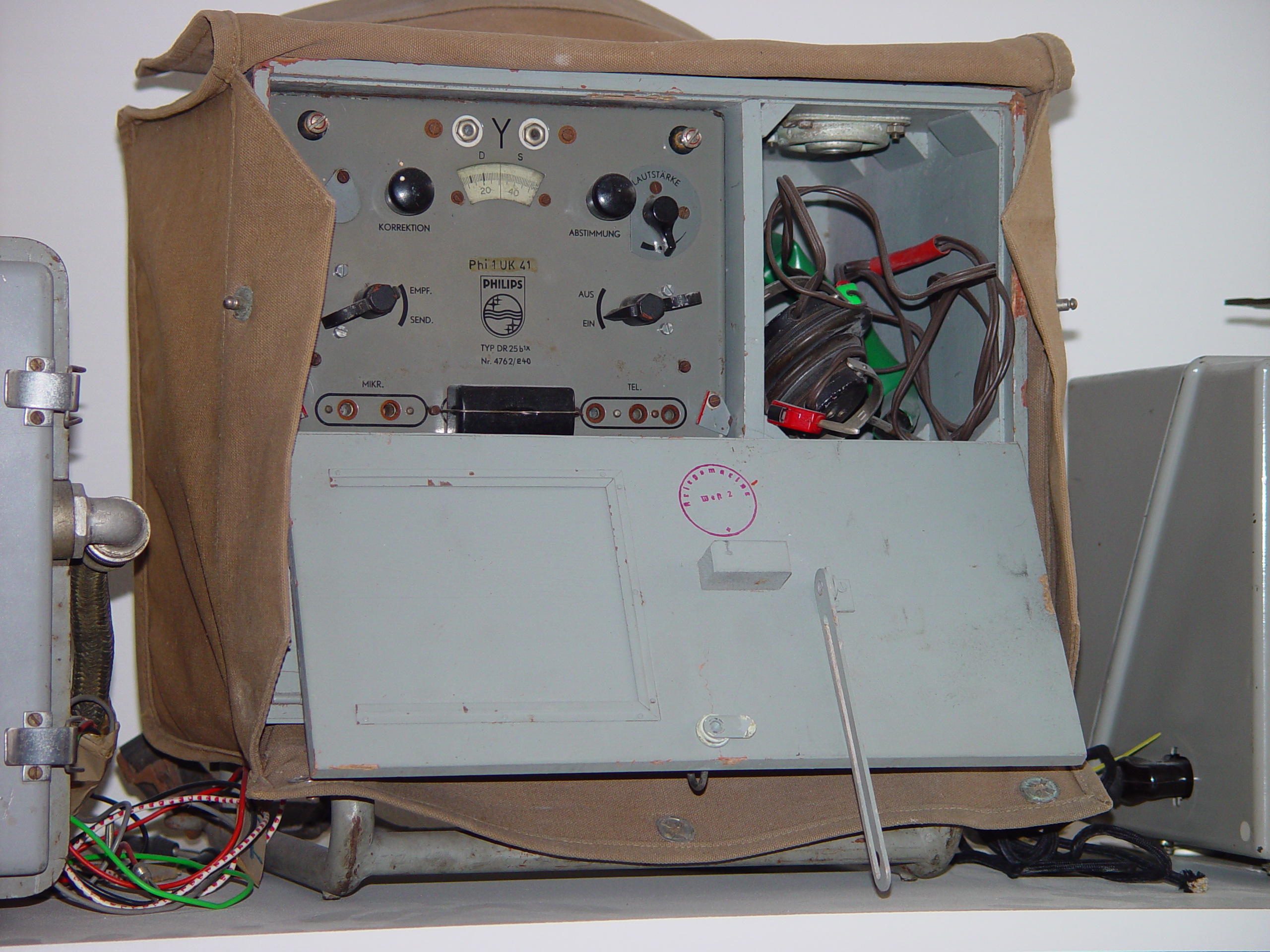

Funksammler Posted October 14, 2018 Posted October 14, 2018 A few pictures of the Phi1UK41 with the canvas cover. The later Phi1UK43 not longer used the canvas cover. 1
