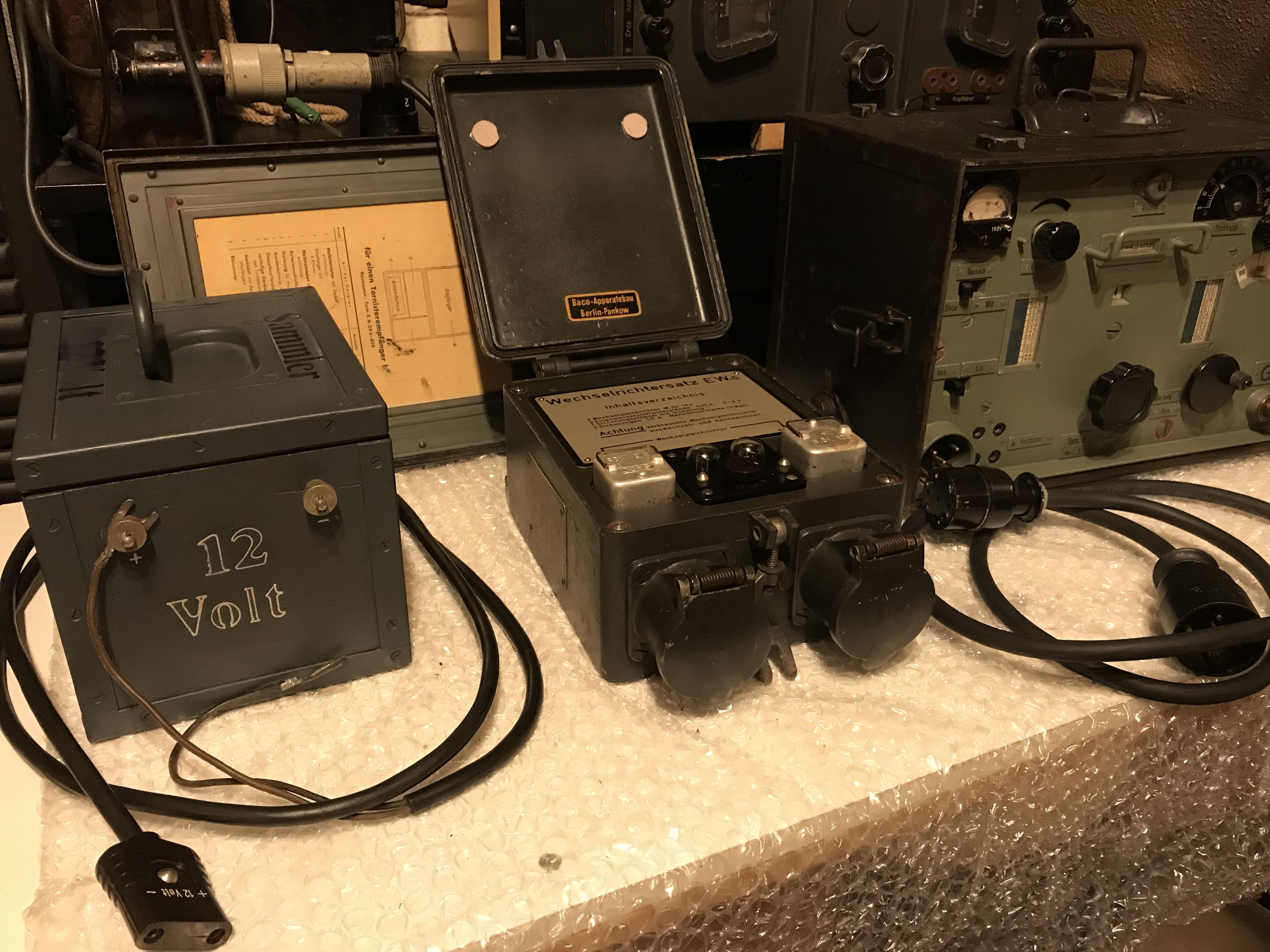

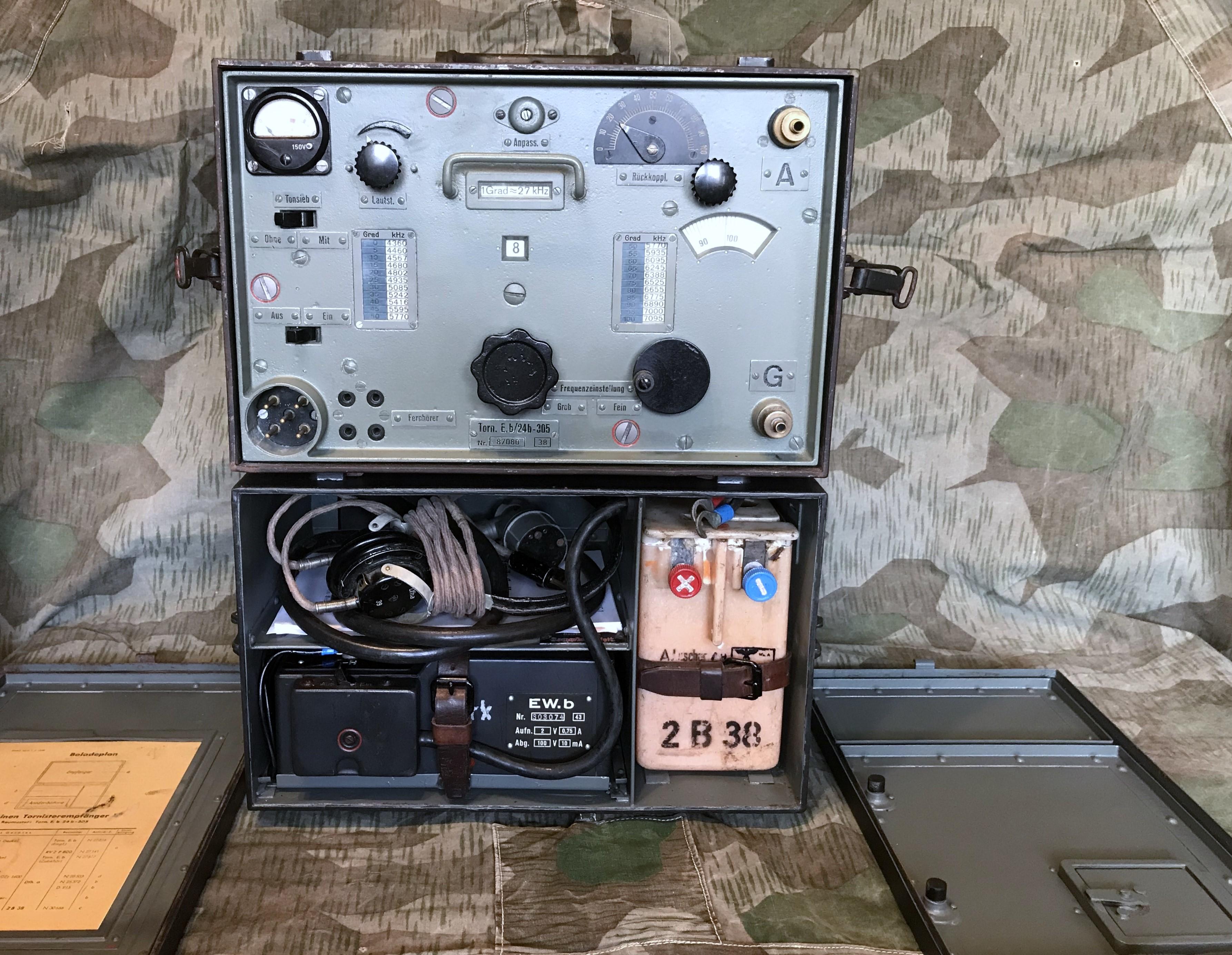

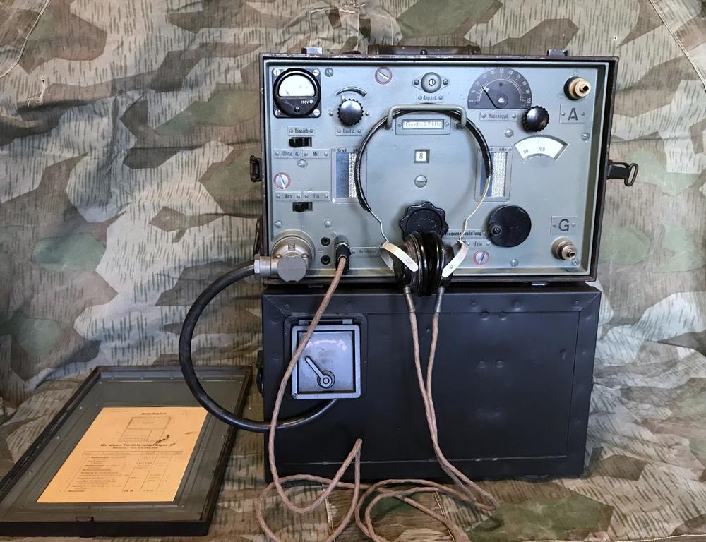

my Torn. E. bIMG_9963.thumb.JPG.72e763a49cc63d6ec9031db6f8abf150.JPGIMG_9966.thumb.JPG.de2bf4e63f17a8521c9c23ae973619c2.JPGIMG_9968.thumb.JPG.03b9fbde78f168e6a67212da33b69253.JPGIMG_9971.thumb.JPG.91df1b8a4635ba0bdd11c2e2b47d4a61.JPGIMG_9972.thumb.JPG.9695167f5f0f6d63716f4670e37e0049.JPGIMG_9978.thumb.JPG.b482c7f719c3b6bec7d255e6183ee023.JPGIMG_9979.thumb.JPG.b289df6db2af79d99b1f921259e4dcbe.JPGIMG_9973.thumb.JPG.de4189a8e44b2fc77fbc0b737954bf11.JPG

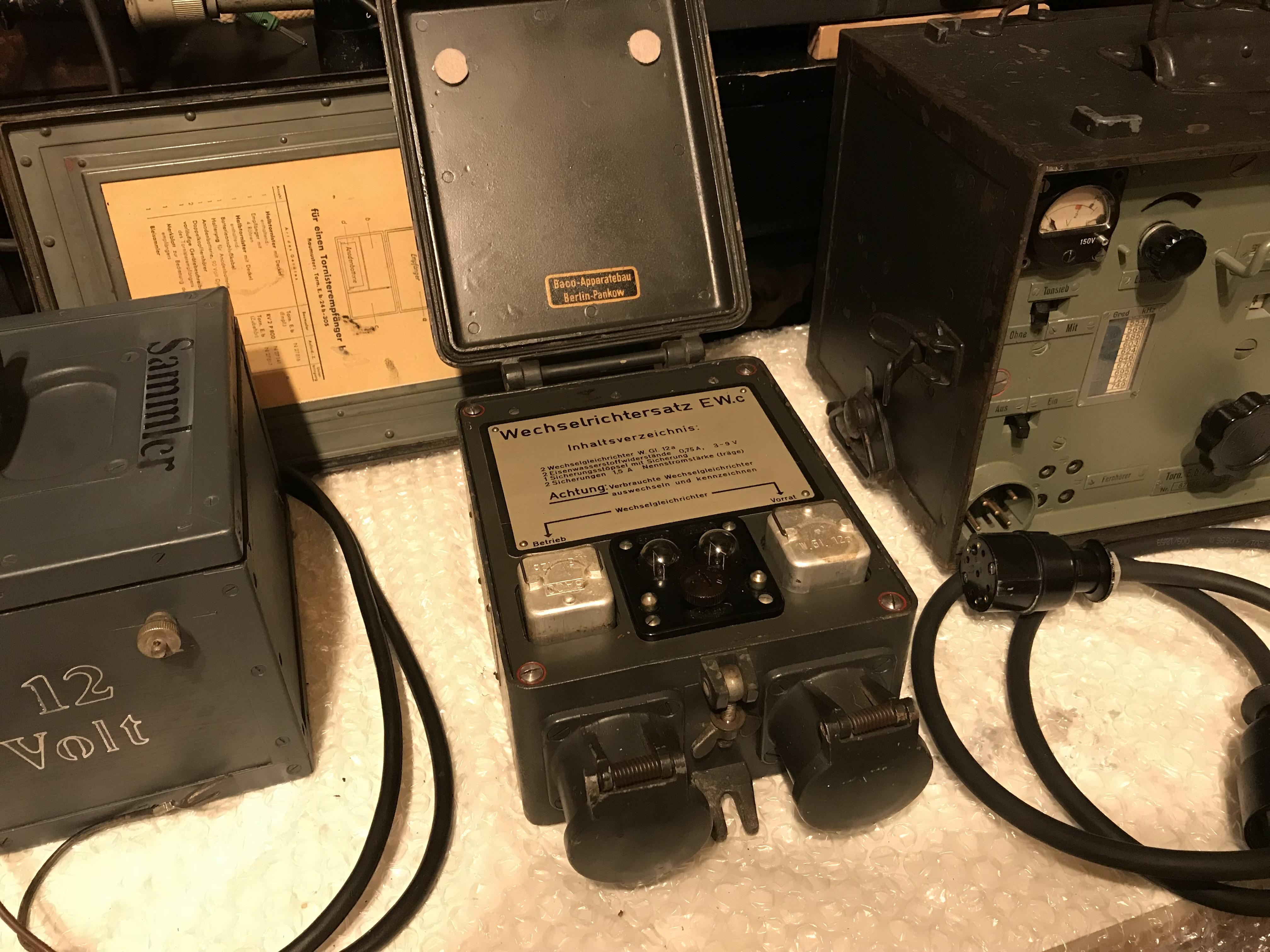

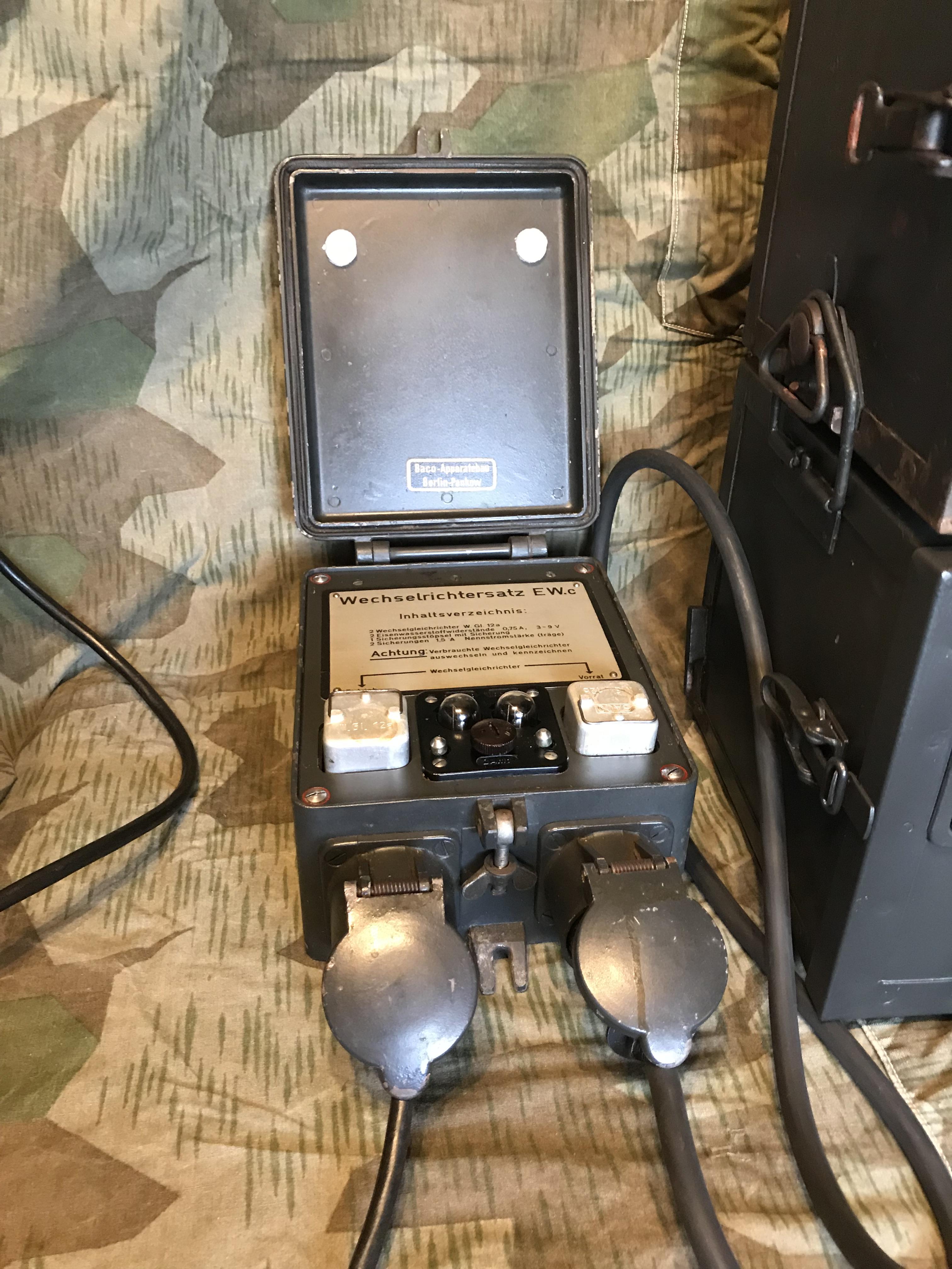

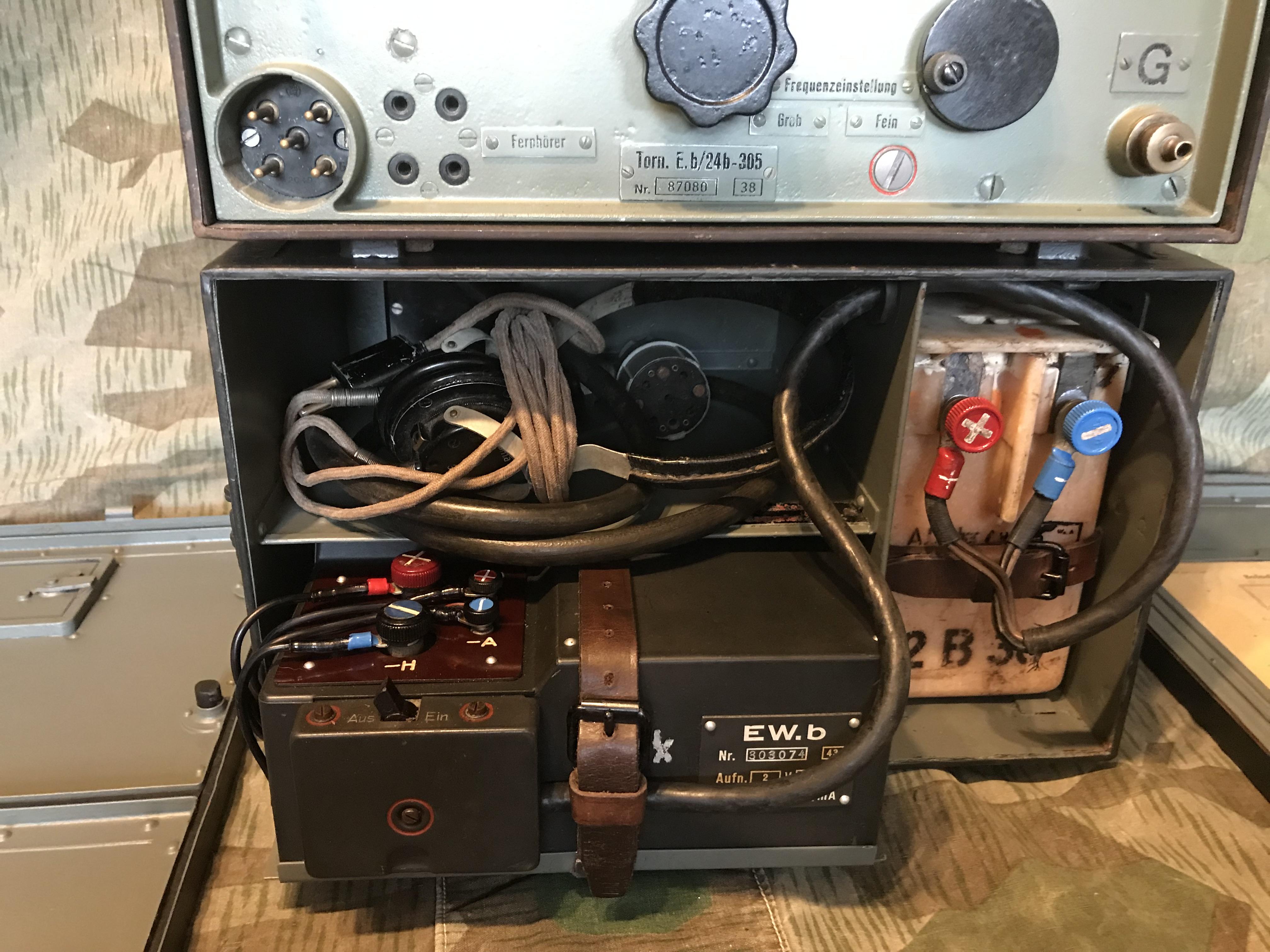

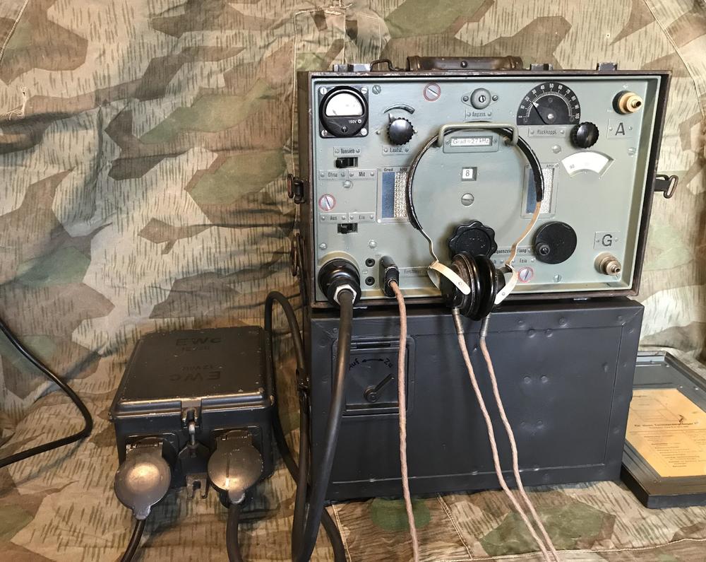

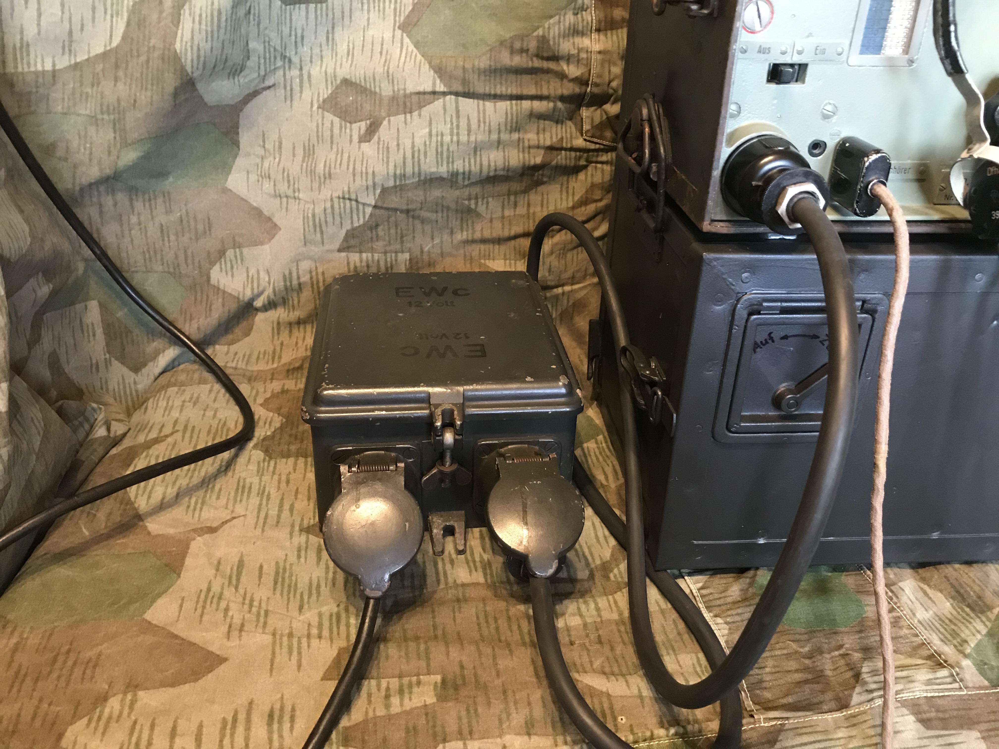

full function with inverter b or c ( Weschselrichter b oder c)IMG_9971.thumb.JPG.91df1b8a4635ba0bdd11c2e2b47d4a61.JPGIMG_9971.thumb.JPG.91df1b8a4635ba0bdd11c2e2b47d4a61.JPG

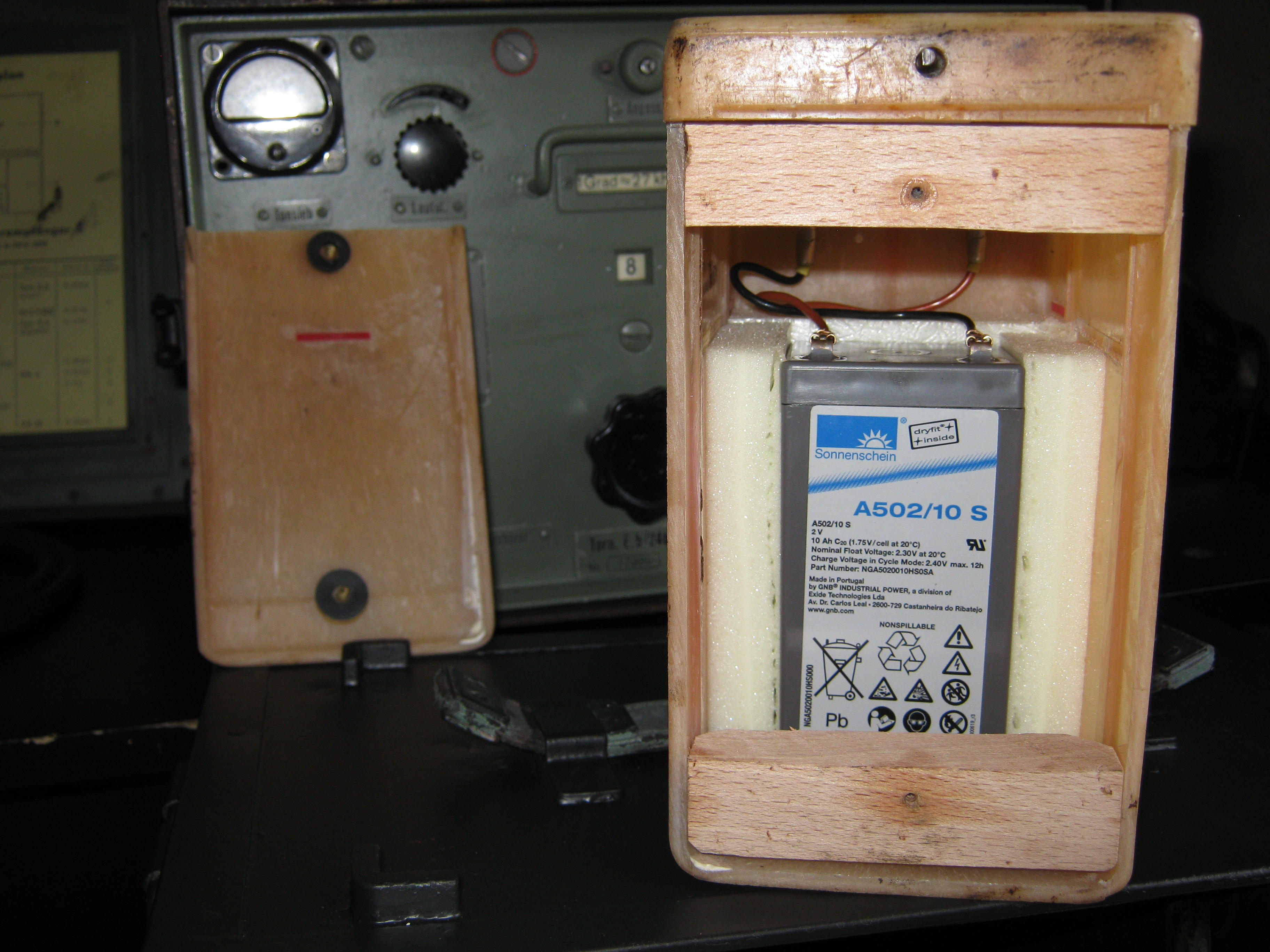

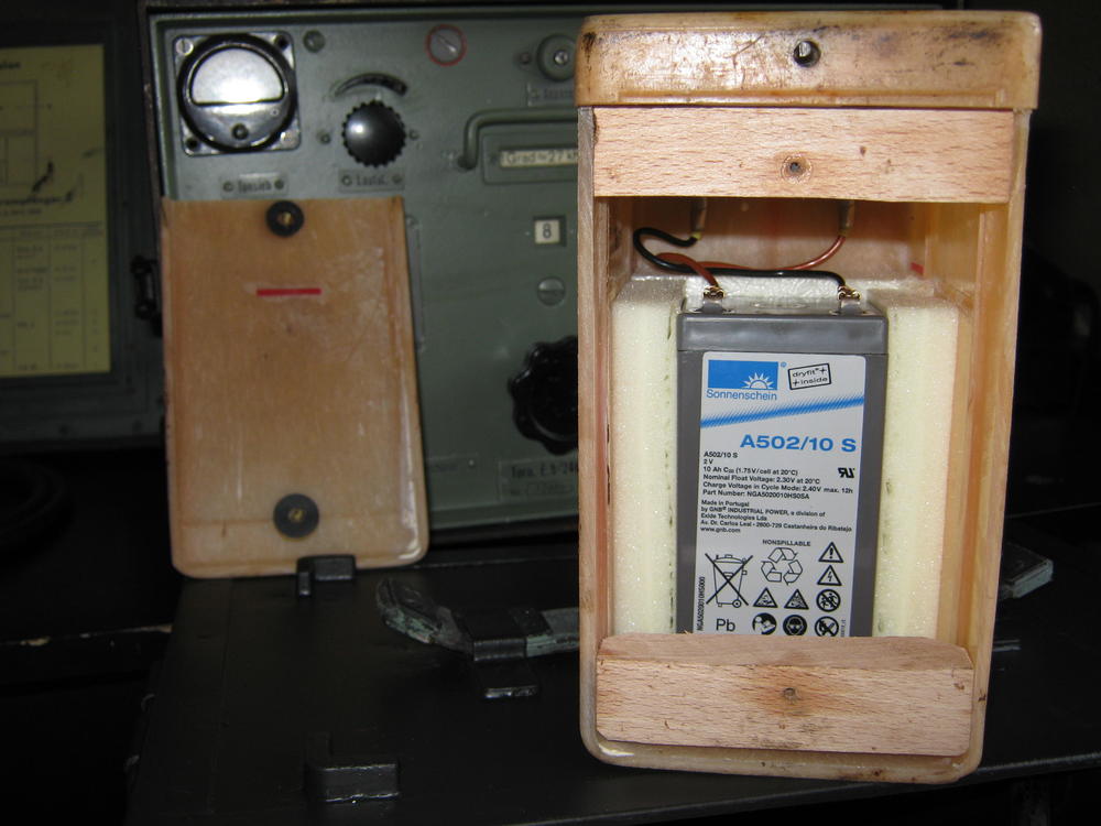

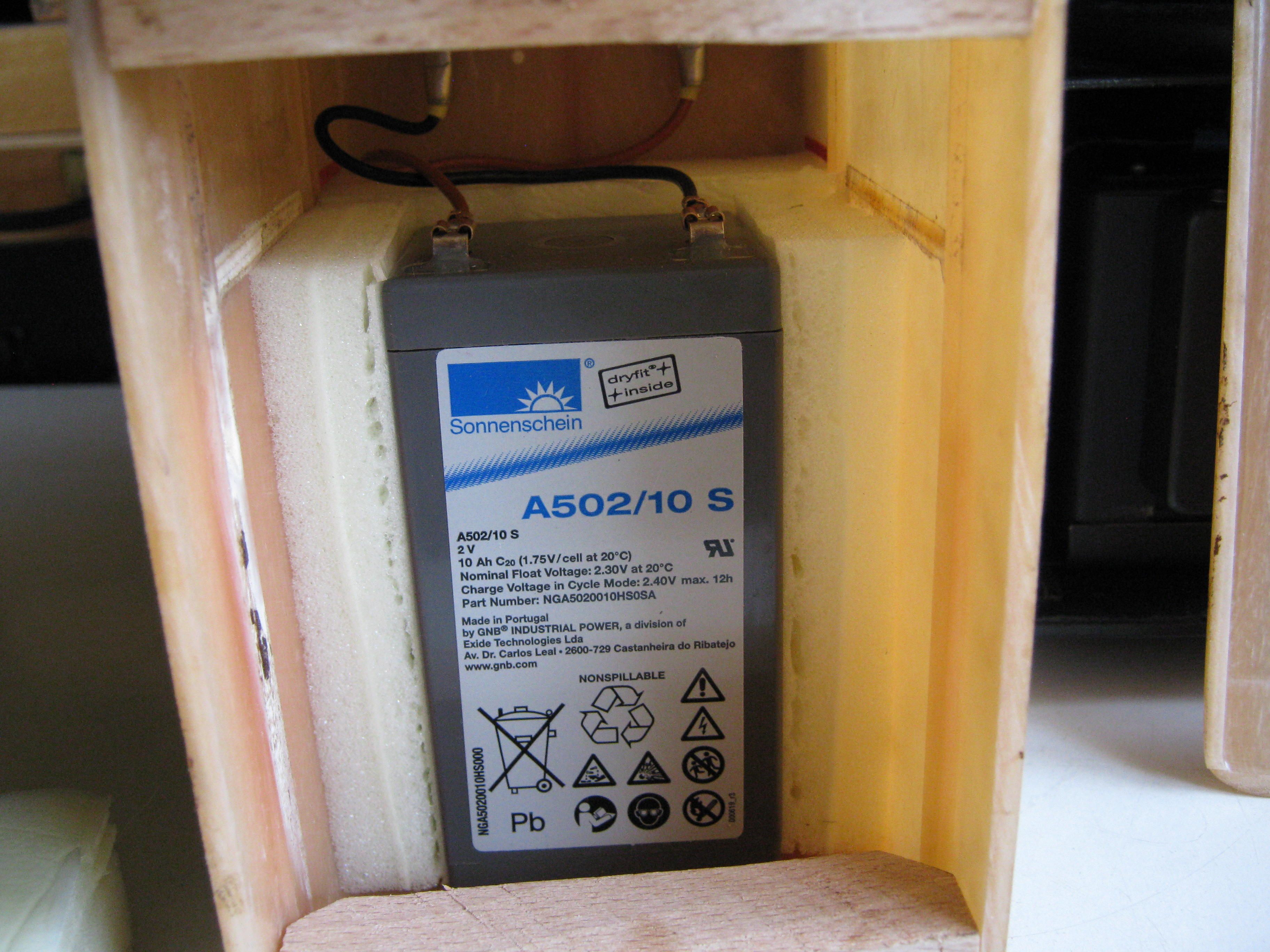

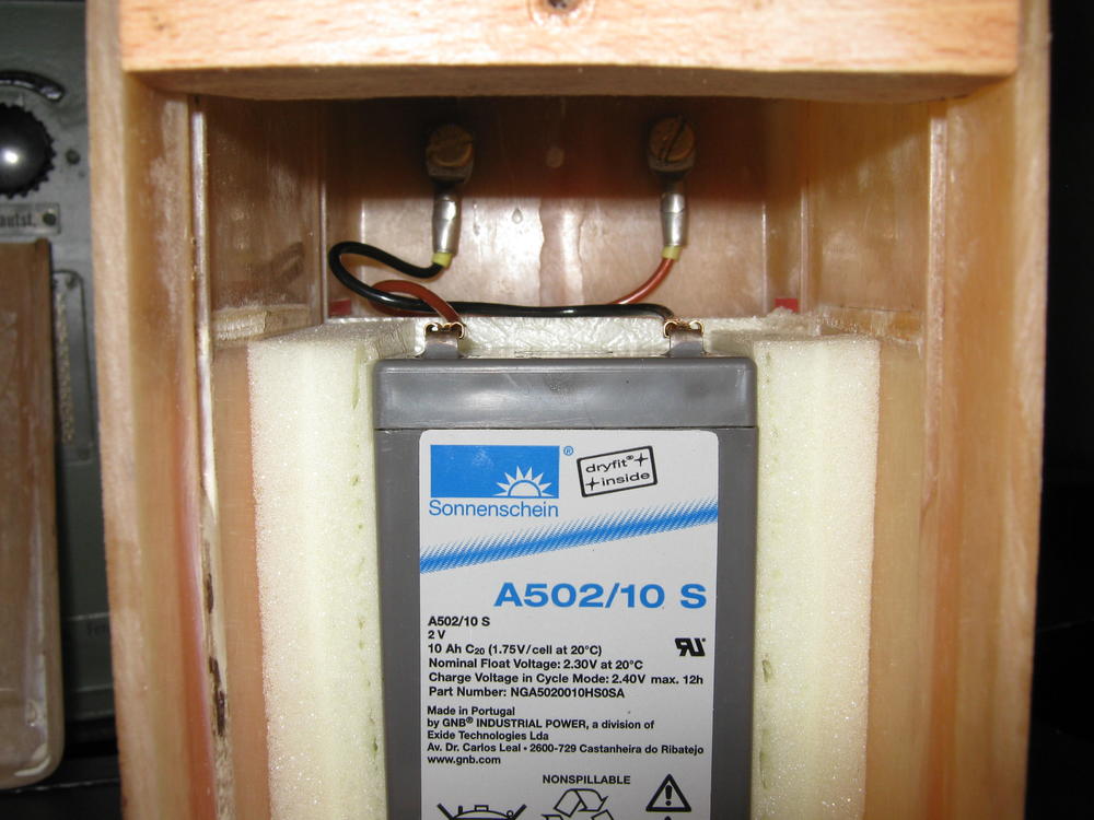

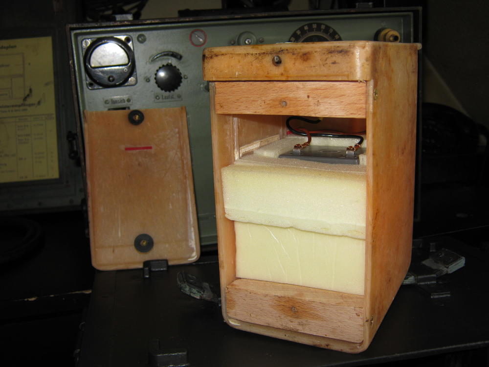

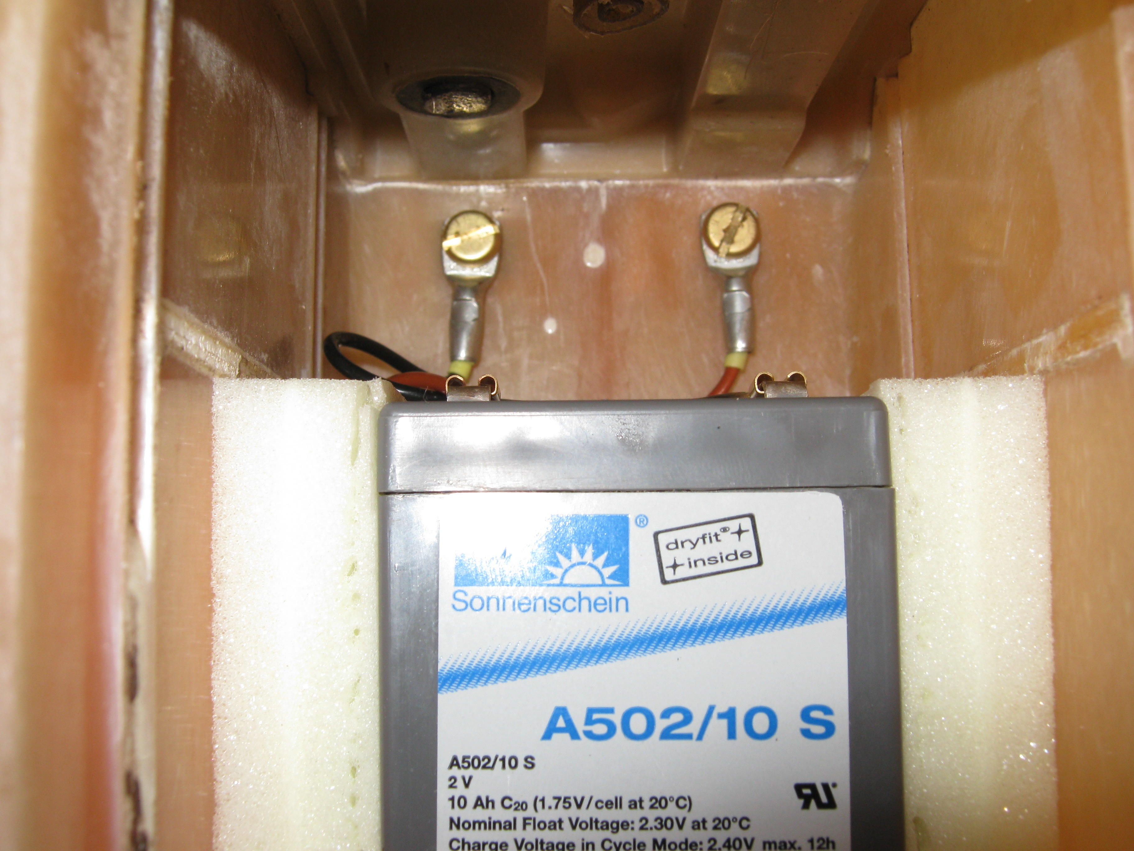

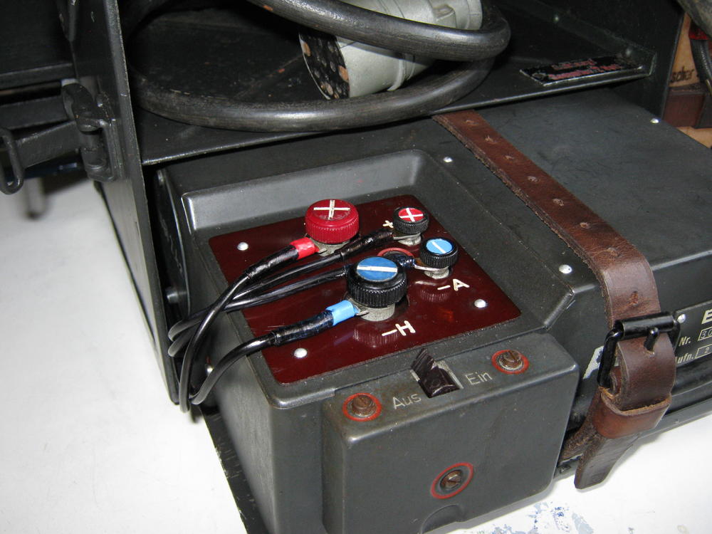

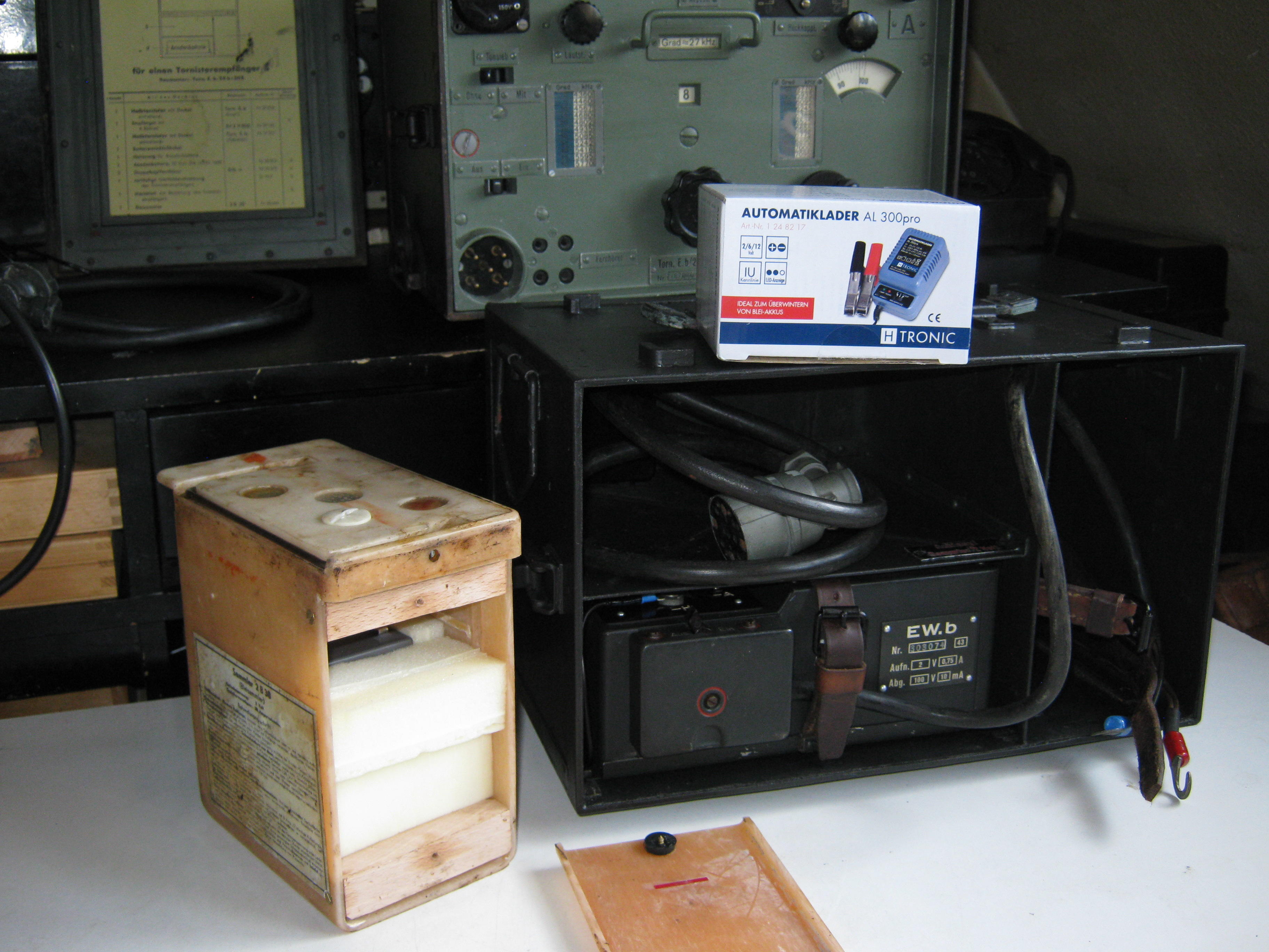

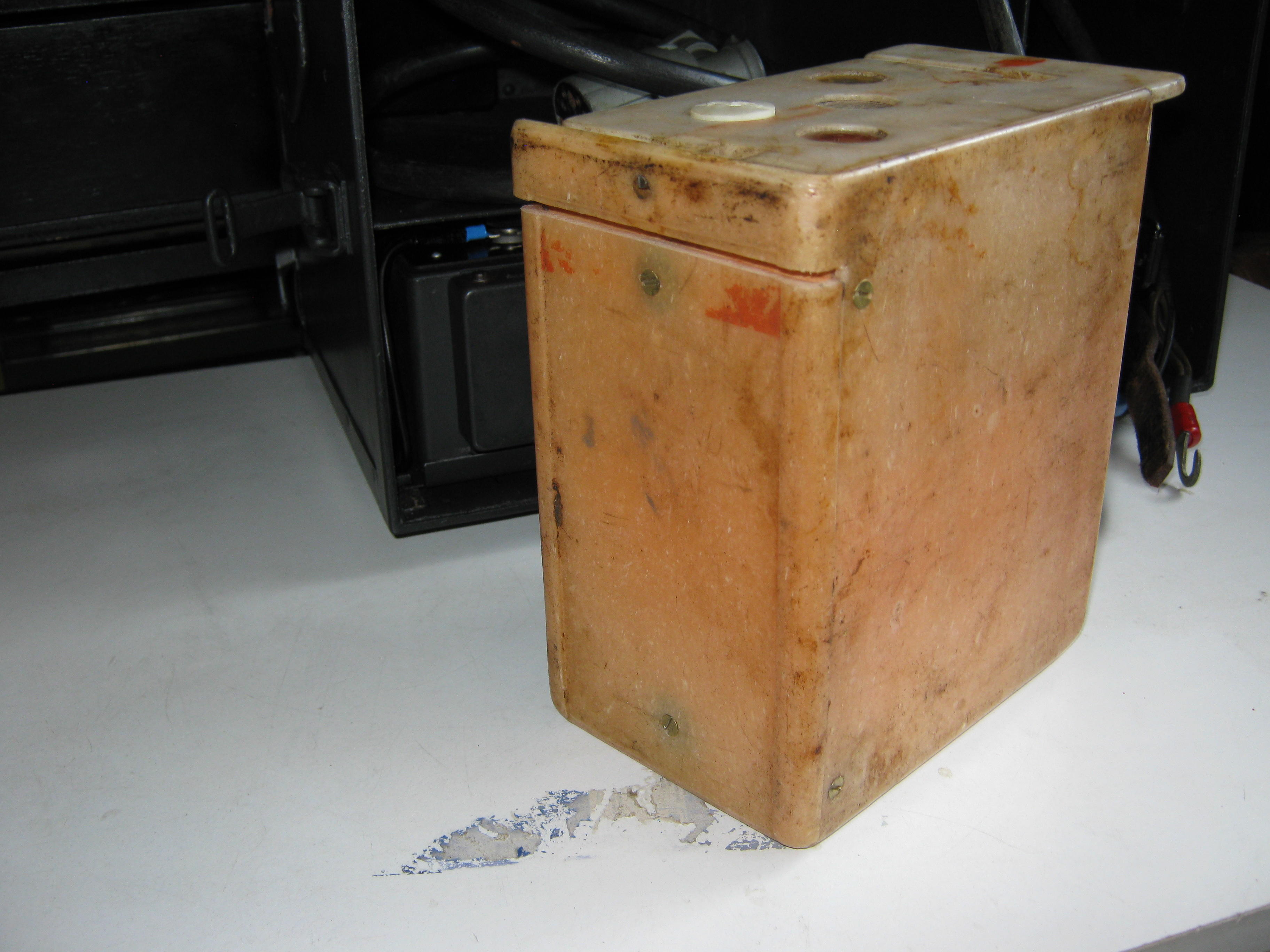

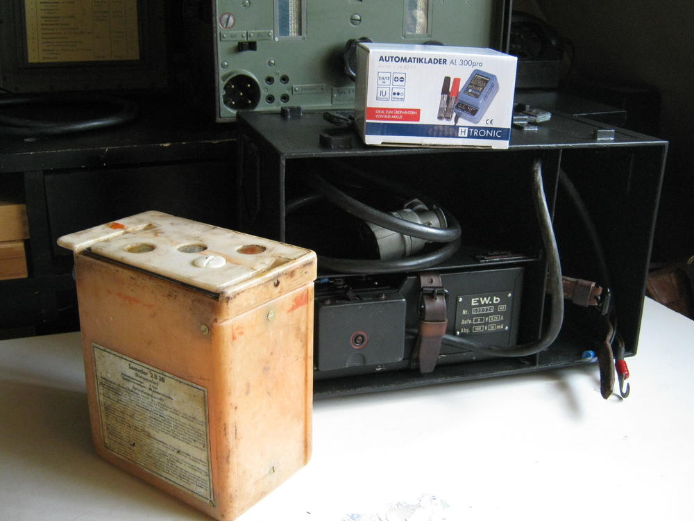

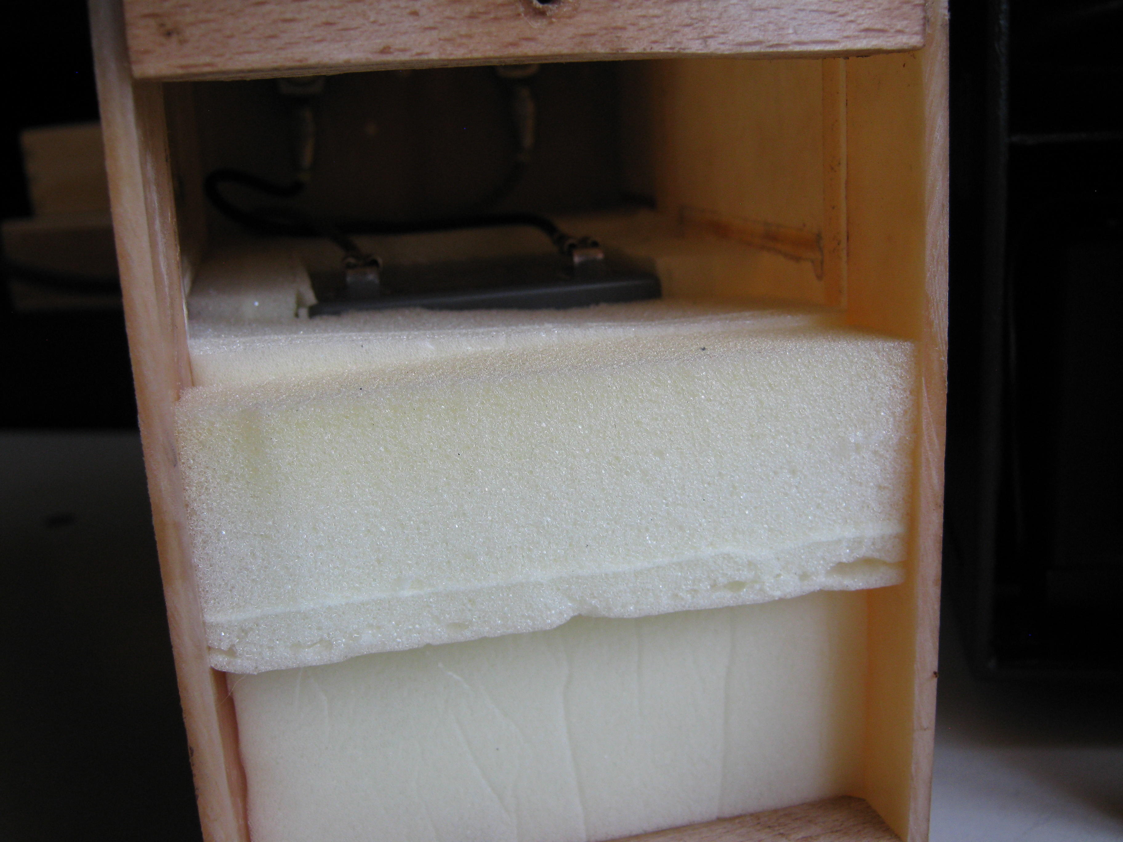

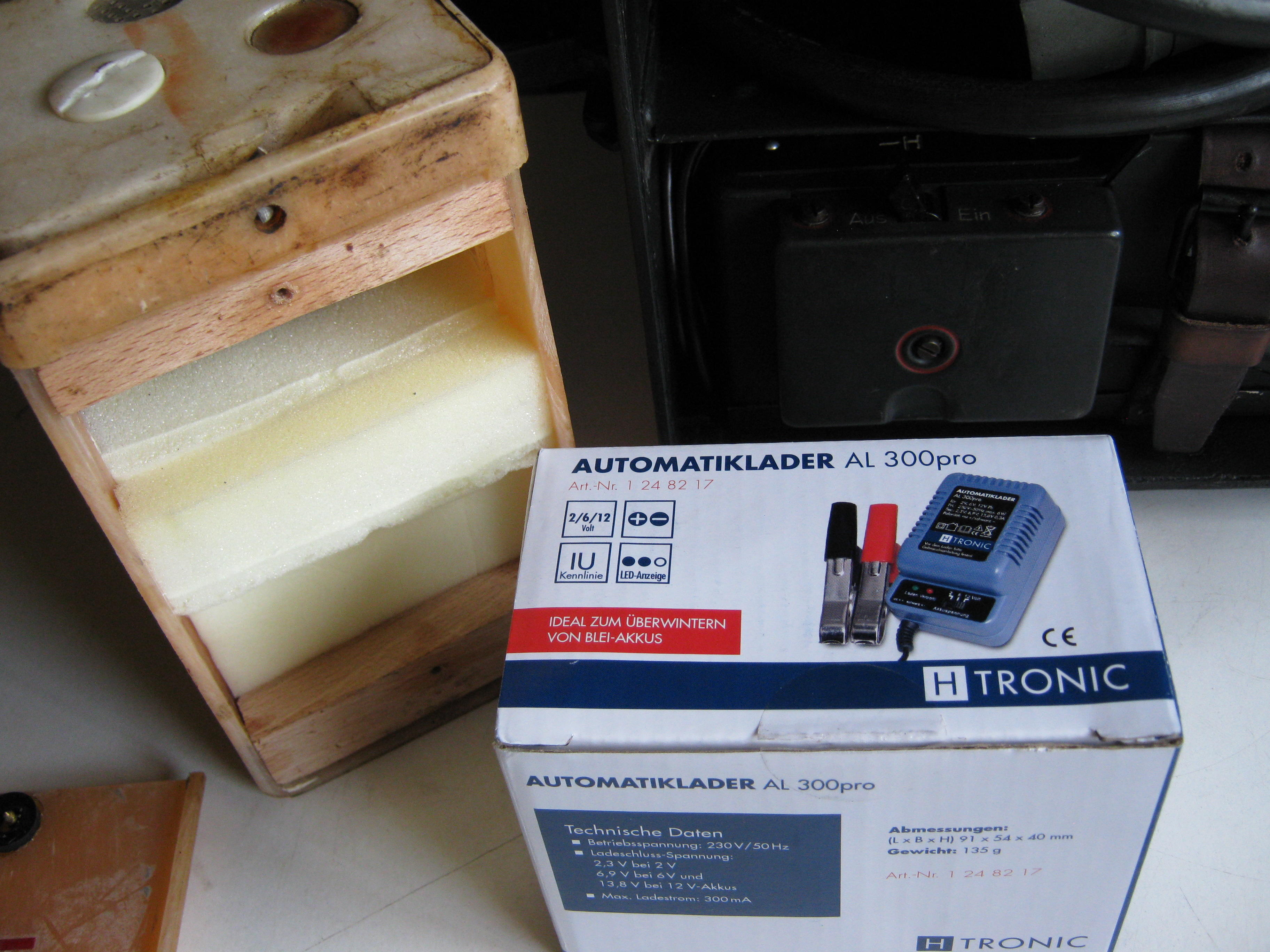

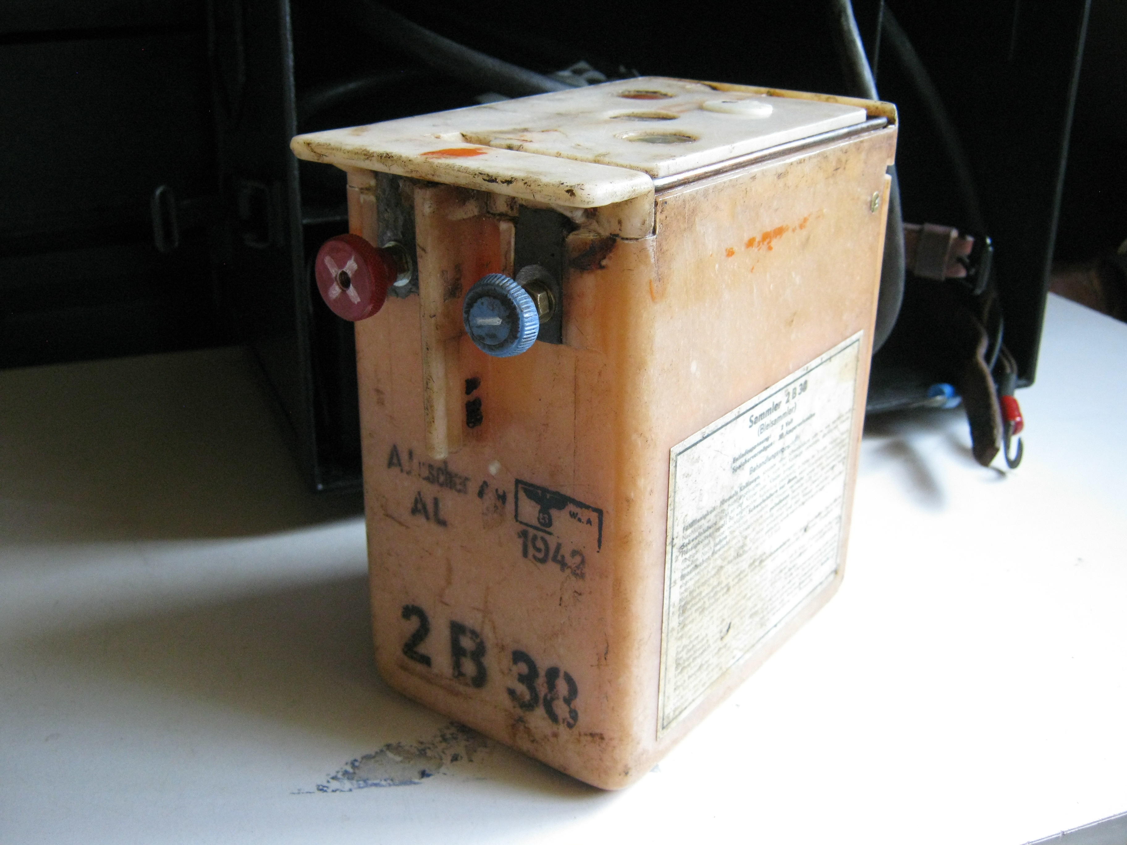

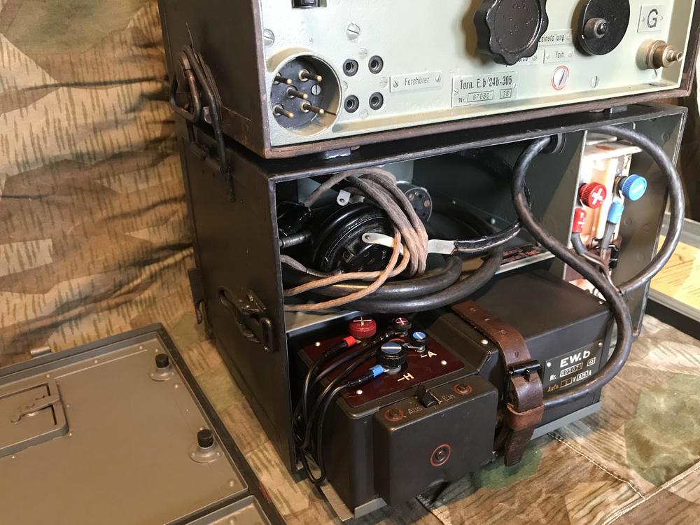

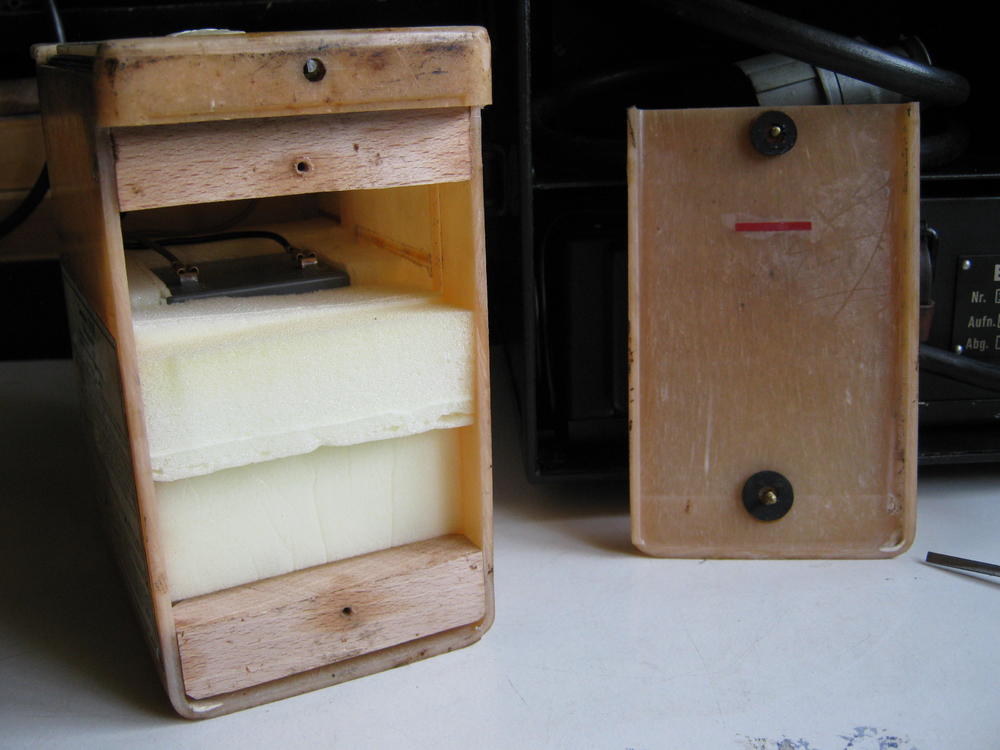

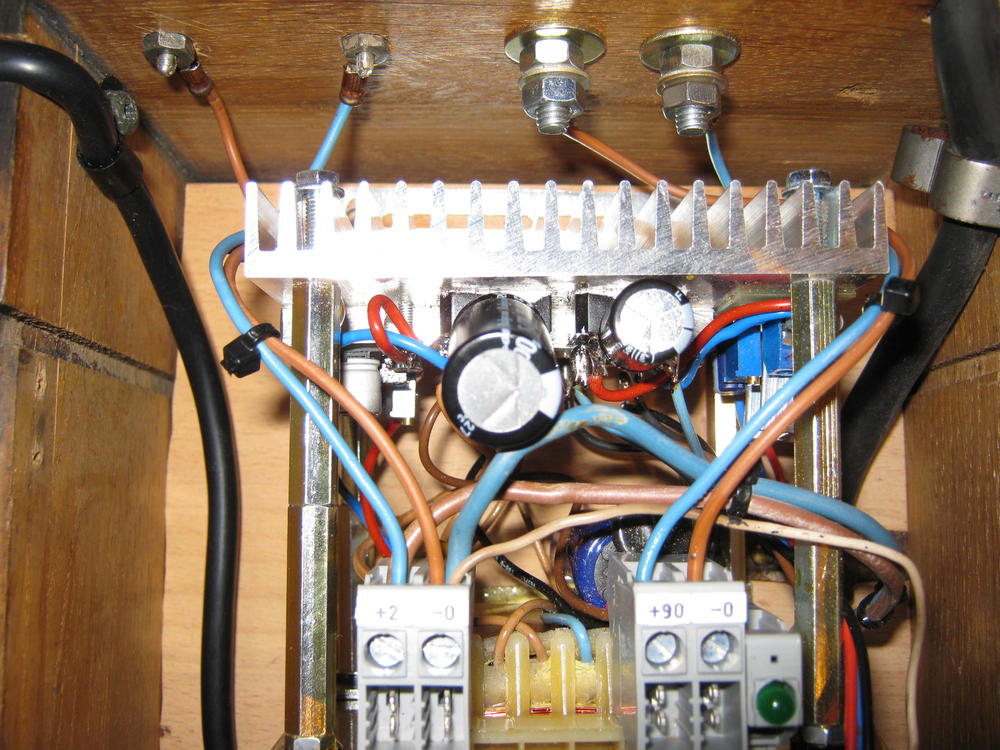

the inverter EW. b is fed by the collector 2 B 38, I converted the 2B38 to a new battery.

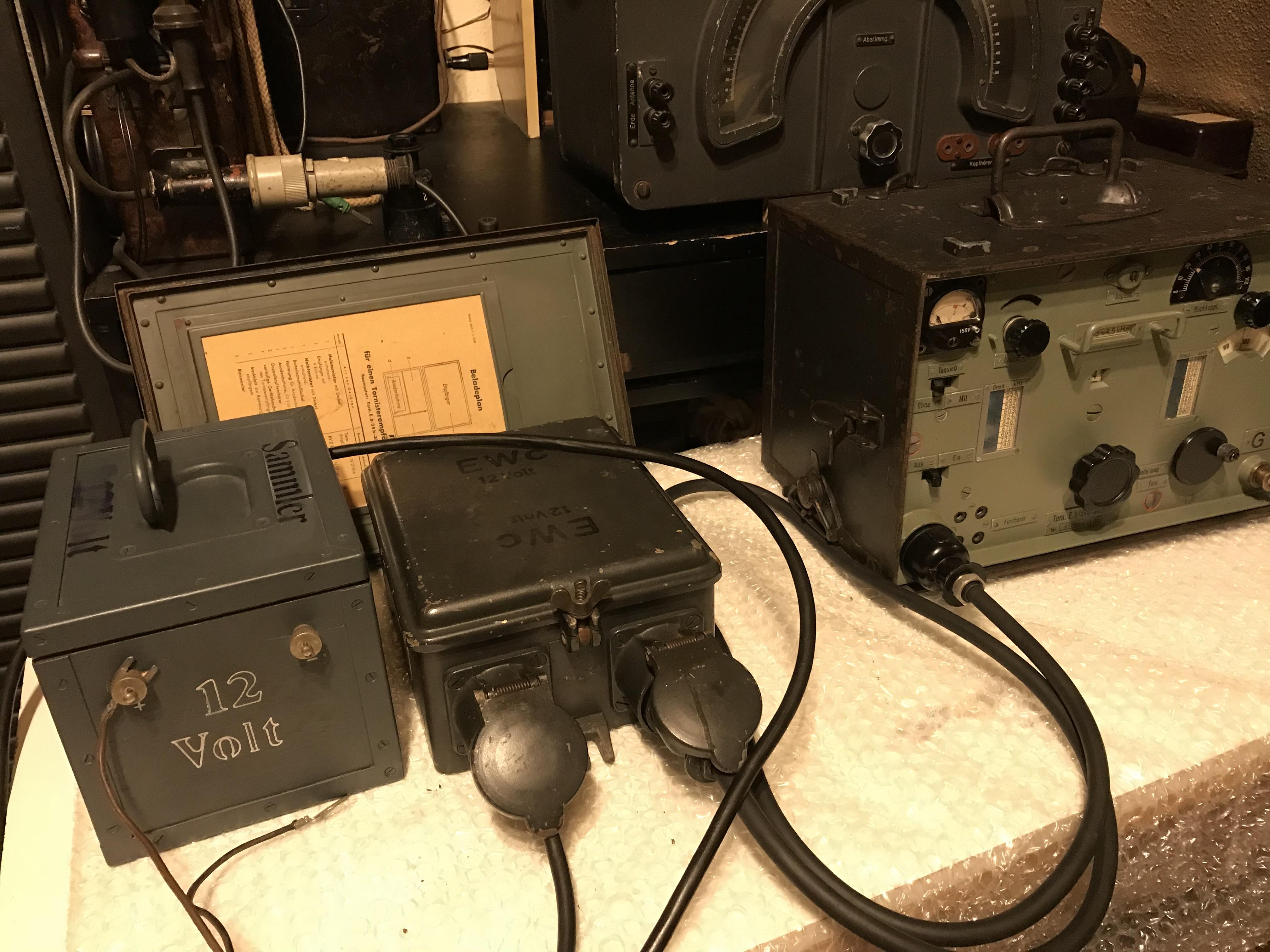

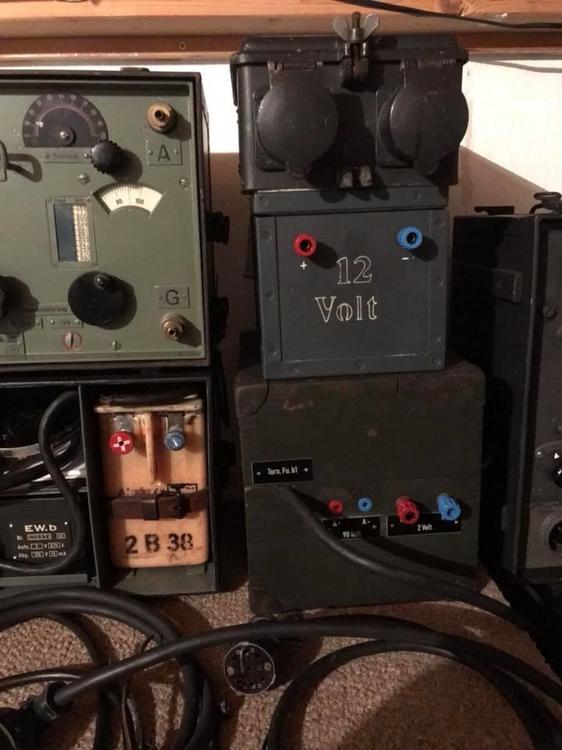

the inverter EW. c is powered by a 12 Volt battery.

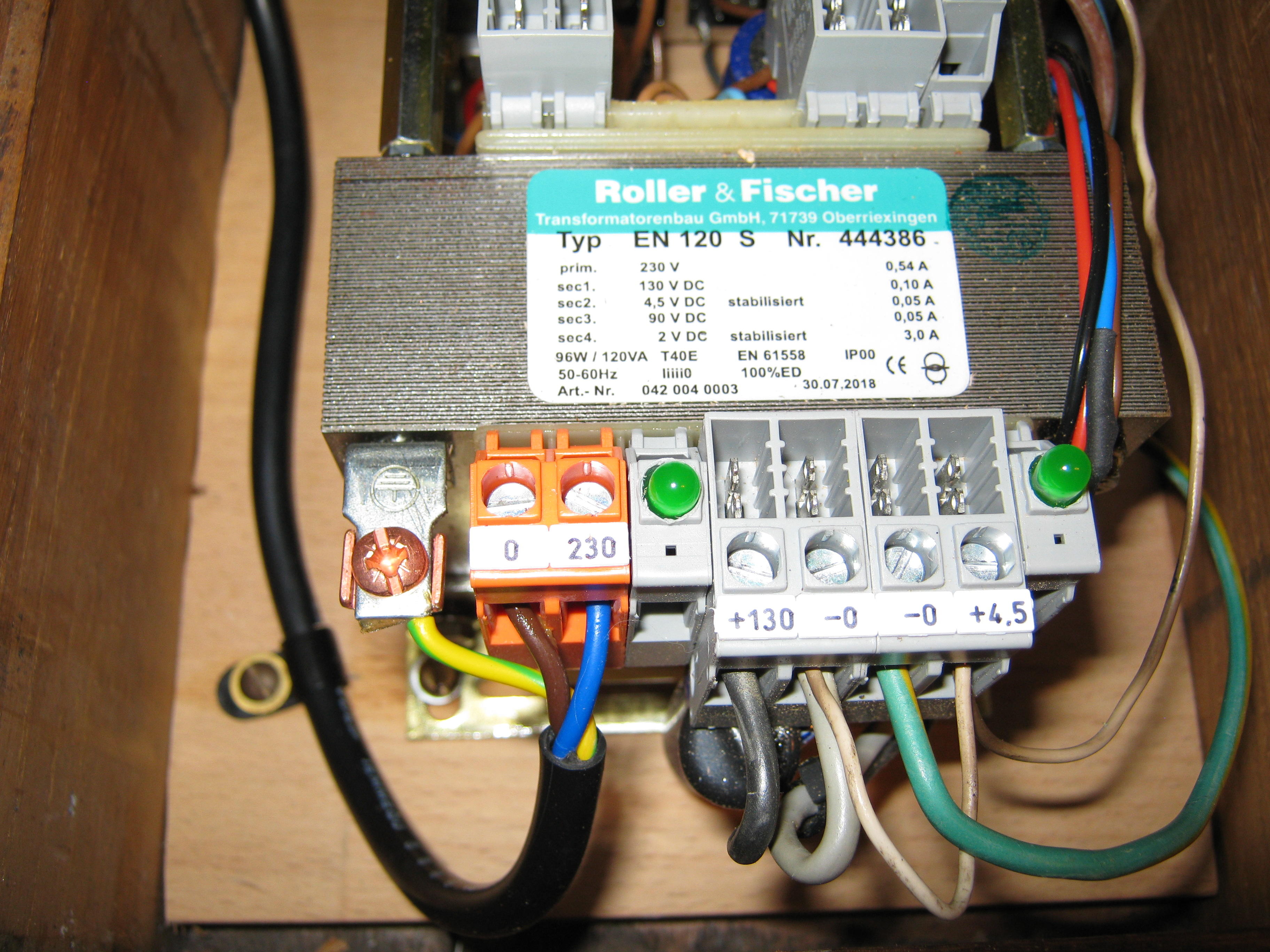

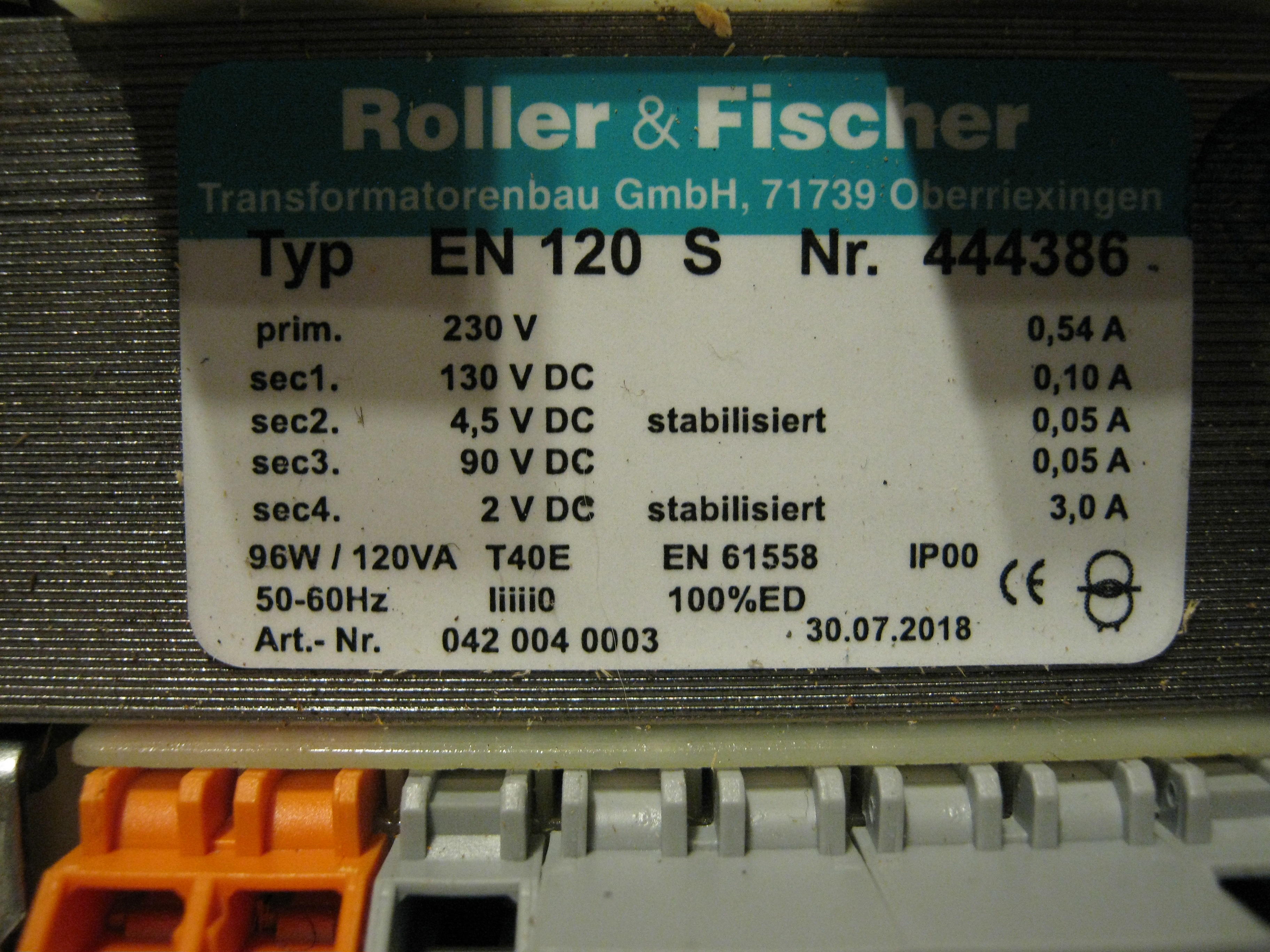

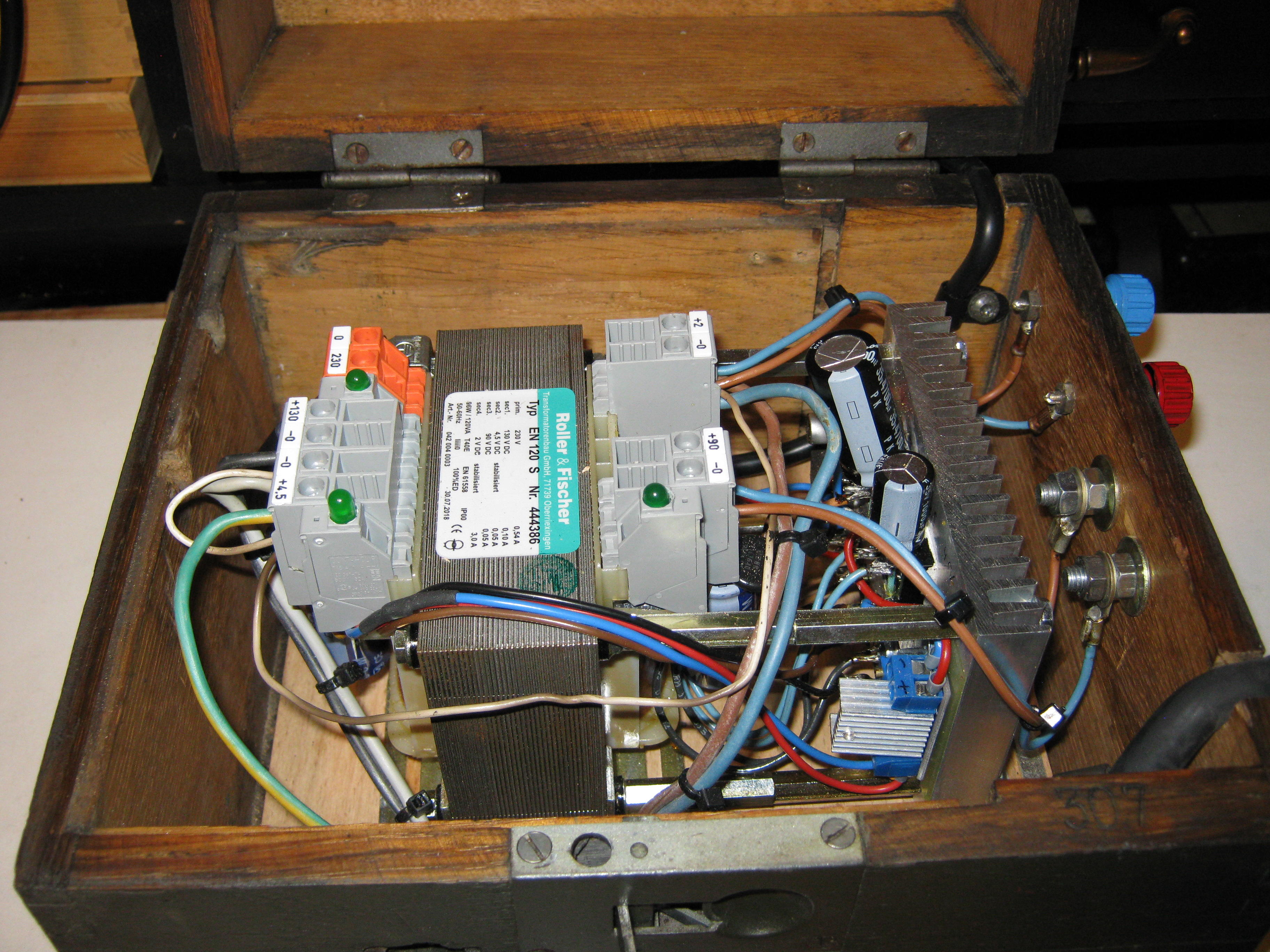

The Torn. E. b I can also operate via transformer.
Greetings Albert

12 Volt Batterie for the EW. c
  • Like 2
Trafo for the Torn. E. b and Torn. Fu. b1

@Alperator- have you measured now how long your Torn.E.b works with that
self-made 2B38 battery (using EW.b)?
Lovely item and you have the original battery...Superb!

@ Val - I operated the EW. b for approx. 1.5 h with the battery 2 V 10 AH, no problem.
Then I switched off, I did not want to load the chopper cartridge (Zerhackerpatrone) too long.
