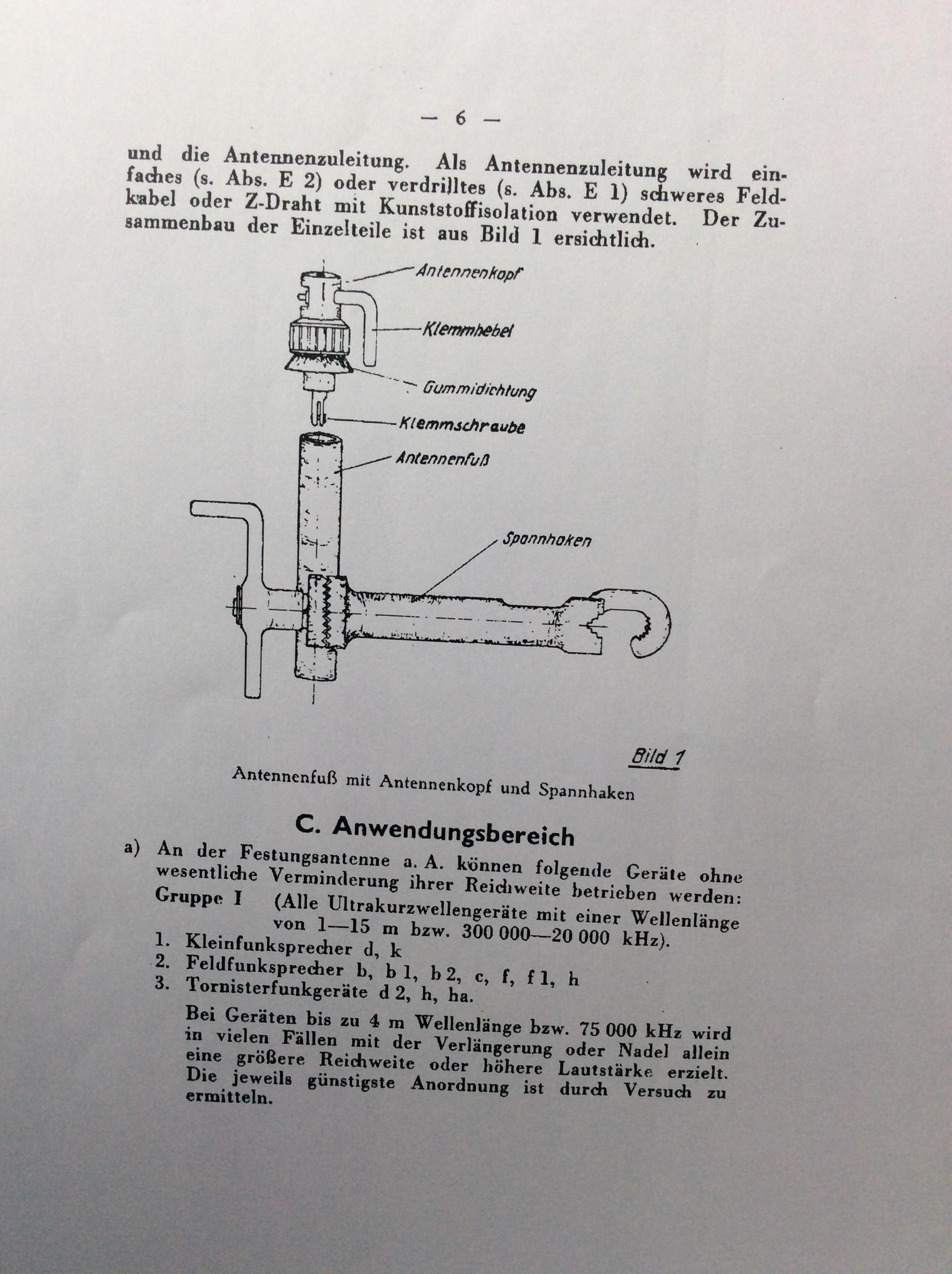

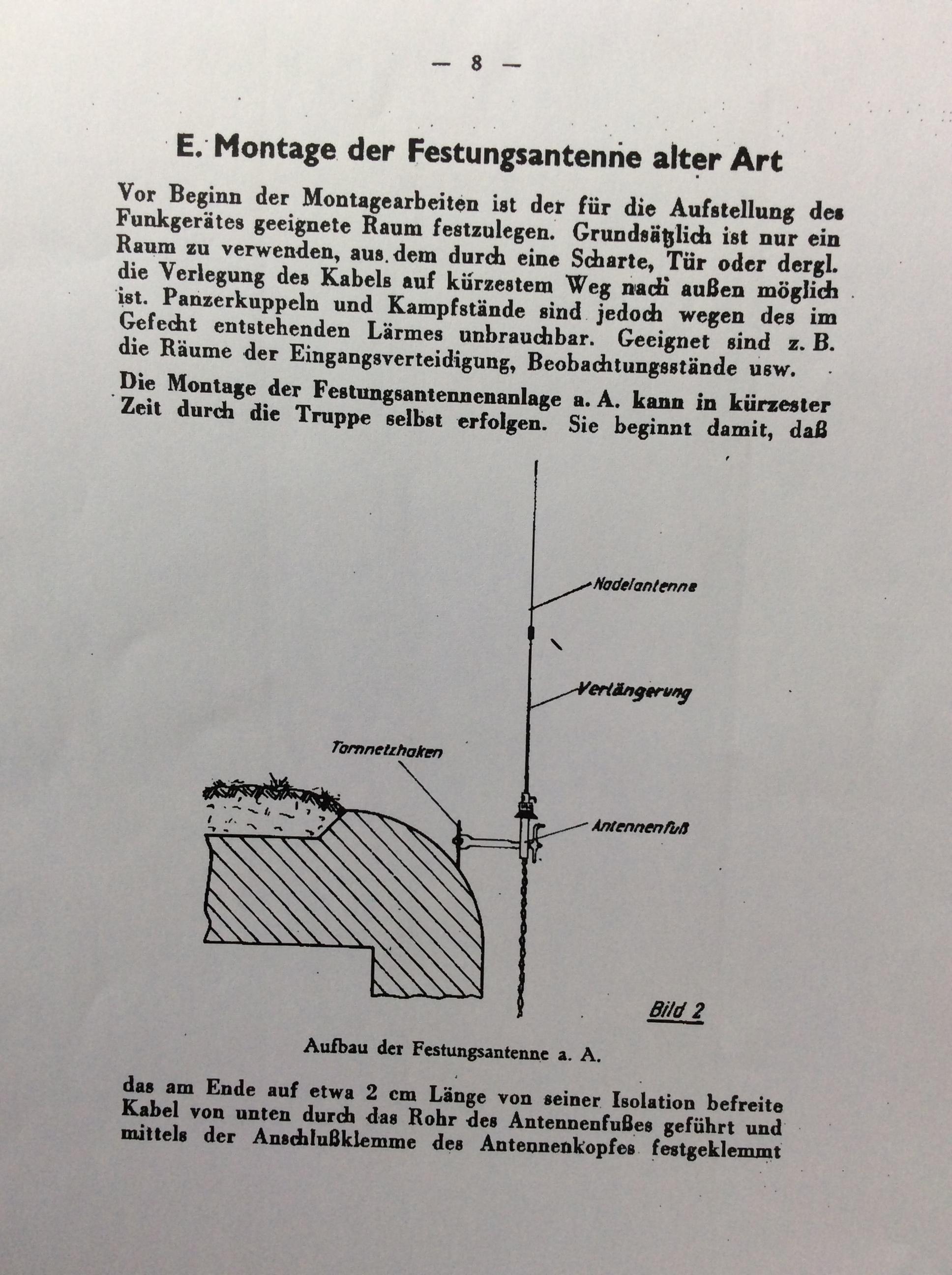

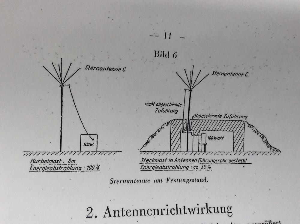

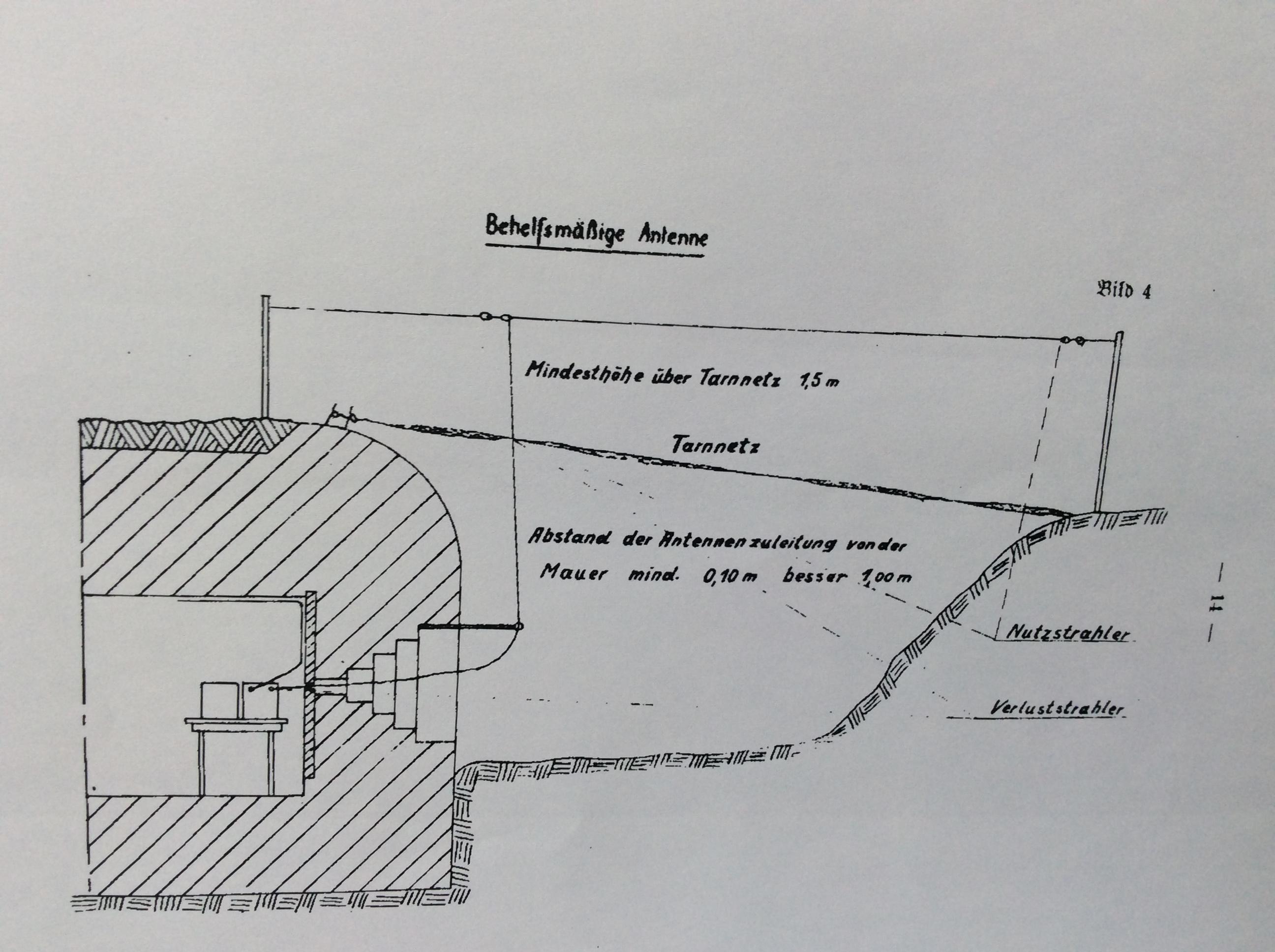

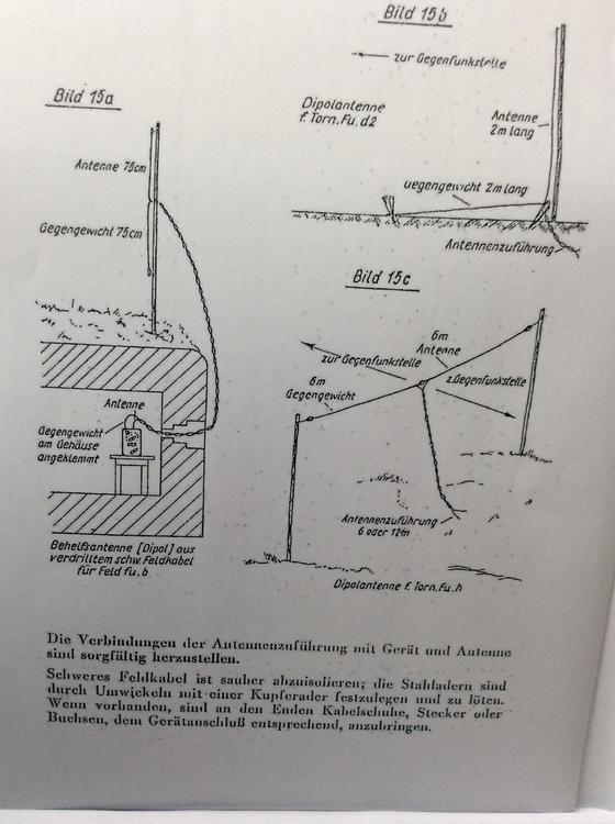

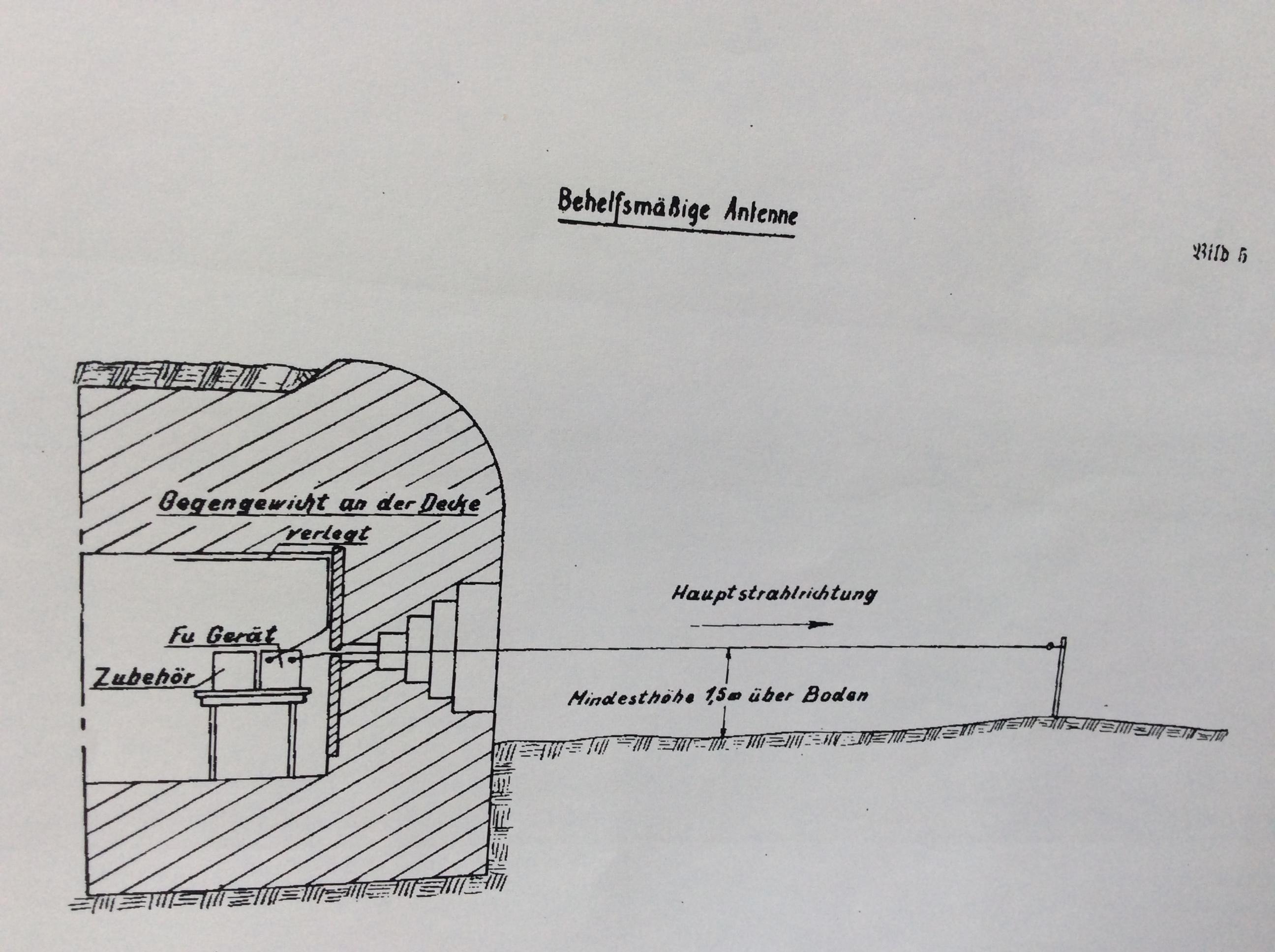

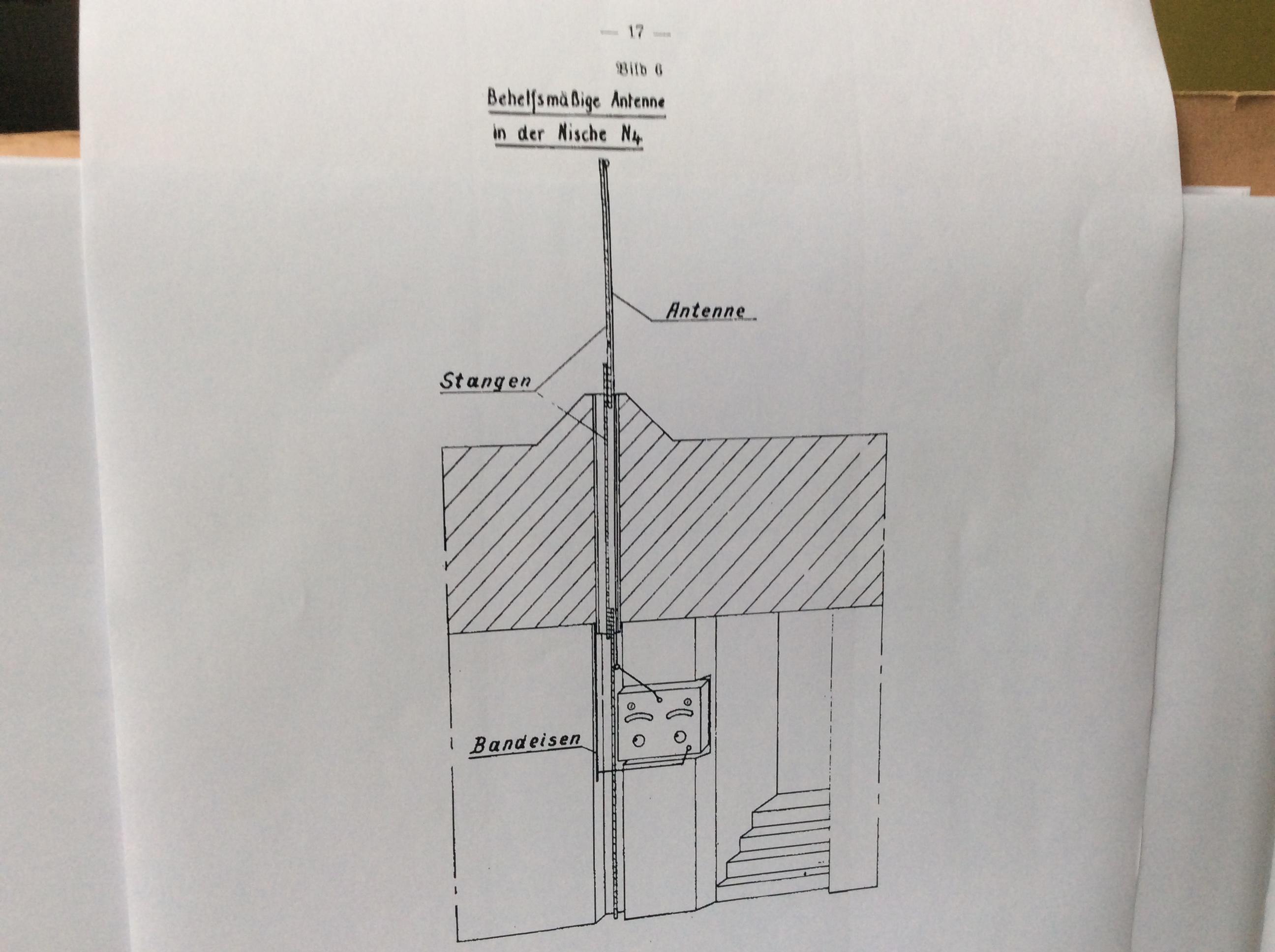

tornfuté Posted March 6, 2019 Posted March 6, 2019 It become more easy to understand thanks FS for picture. i have readen again D1790/1 , 5, 6, i have seen inside those notices that there Is also D1790/2 and D1790/4 has anybody knowledge of D1790/3? i can buy one time copy of D1790/2 but 100€ for copies too expensive we are always speaking about the emergency antenna put in a well or duct but they are others antenna used and connected to set by other way sometimes they use the N4 with a self made support for antenna or they used side of bunker to connect an antenna . i post here some pictures seen in D1790/6 , where we see an antenna base alter art , so meaning that there is also a n A neu art . the funkschrank illustrated in bunkerforum is what i had said in a previous post but i was’nt aware that 2 different type exist. it stand near niche 4 in entry just near N4 it has sense if set ,antenna, are stowed there

val Posted March 6, 2019 Posted March 6, 2019 34 minutes ago, tornfuté said: i can buy one time copy of D1790/2 but 100€ for copies too expensive Yes, i hate that manual selling business where they are making money selling copies of the copies of the copies... This stuff should be free for learning. D1790/6 is luckily available for free : http://www.cdvandt.org/D-1790-6.pdf
tornfuté Posted March 7, 2019 Posted March 7, 2019 Fortunaly cdvandt provide good copies of D1790/1, D1790/5 and 6 for number 5 it’s not in the list but i see it elsewhere on the site 1
val Posted March 7, 2019 Posted March 7, 2019 15 minutes ago, tornfuté said: Fortunaly cdvandt provide good copies of D1790/1, D1790/5 and 6 for number 5 it’s not in the list but i see it elsewhere on the site Pierre, thanks! Now i found it. http://www.cdvandt.org/Exhibits-14-Abst-a-D-1790-5-Behelfsant-Festungsanlagen.pdf

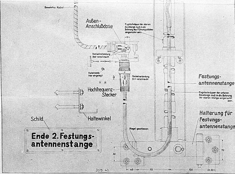

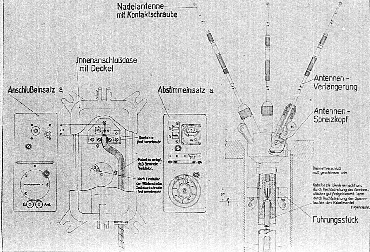

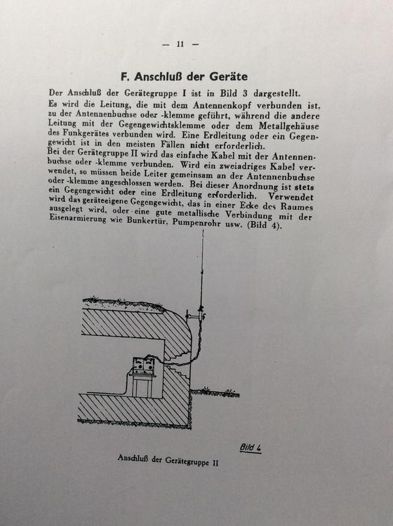

val Posted March 11, 2019 Posted March 11, 2019 On 07/03/2019 at 11:50, tornfuté said: D1790/4 exists , but i haven’t found it , knowing germans , i guess D1790/3 must exists, just waiting it comes out from somewhere Pierre, you are right. Thanks to Werner i know now that those two images (i post them here) are from manual D 1790/3 "Einbauanweisung für die Festungsantennenanlage" vom 1.9.1943 1
Funksammler Posted March 13, 2019 Author Posted March 13, 2019 On 07/03/2019 at 10:50, tornfuté said: D1790/4 exists , but i haven’t found it , knowing germans , i guess D1790/3 must exists, just waiting it comes out from somewhere D1790/3 does indeed exist: https://www.dropbox.com/s/s42dqtc8wk6bgla/D.1790_3 Einbauanweisung für die Festungsantennenanlage (1943).pdf?dl=0 Regards, Funksammler 2

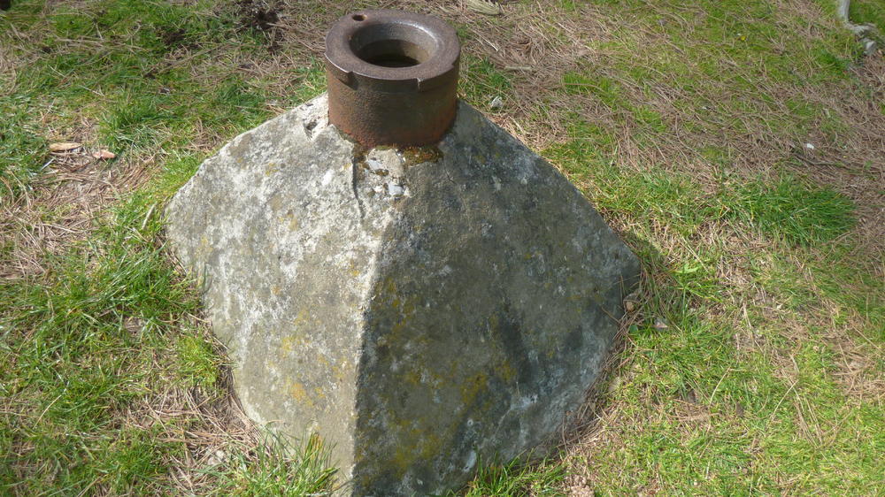

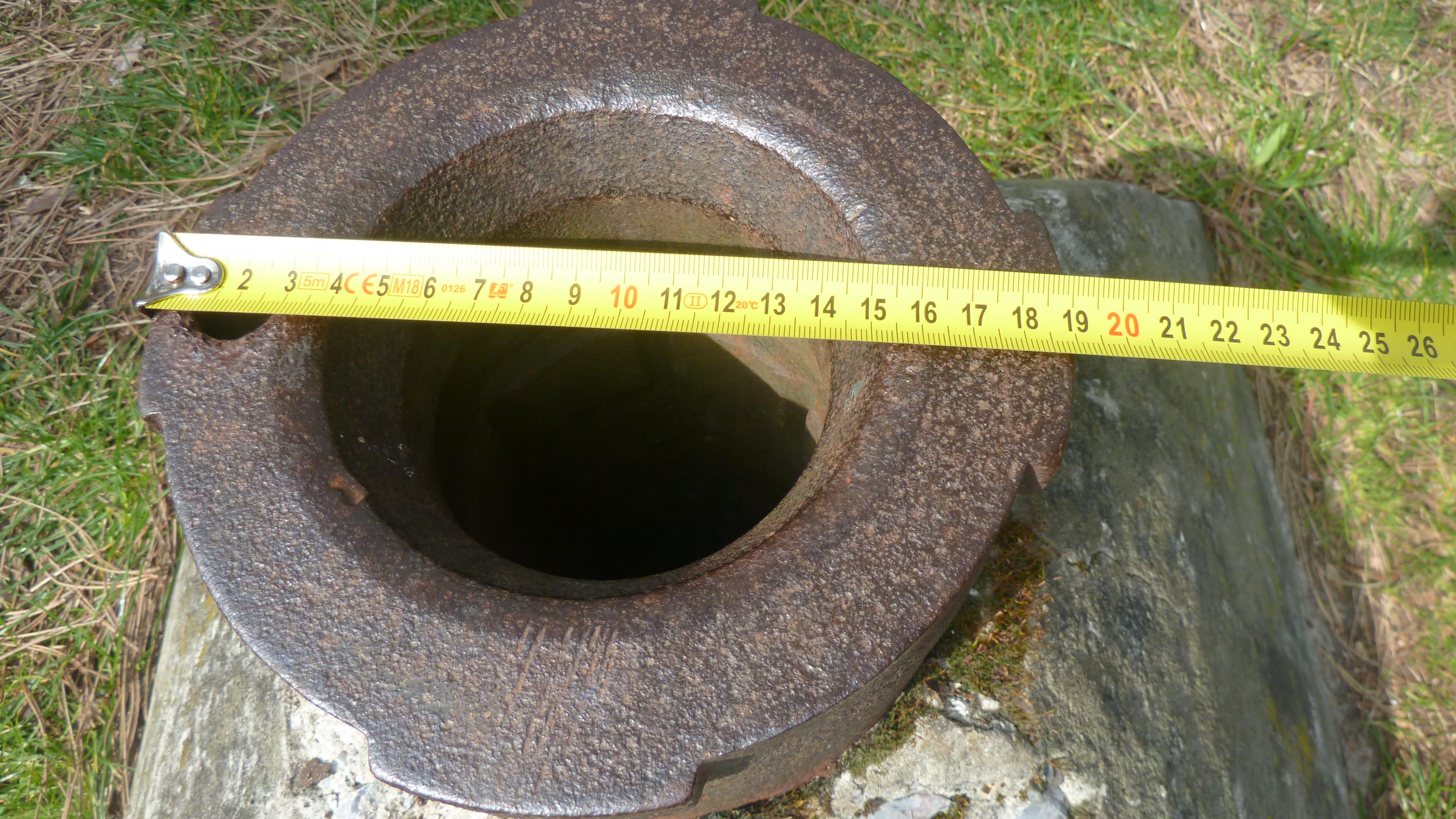

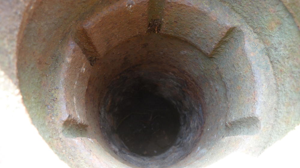

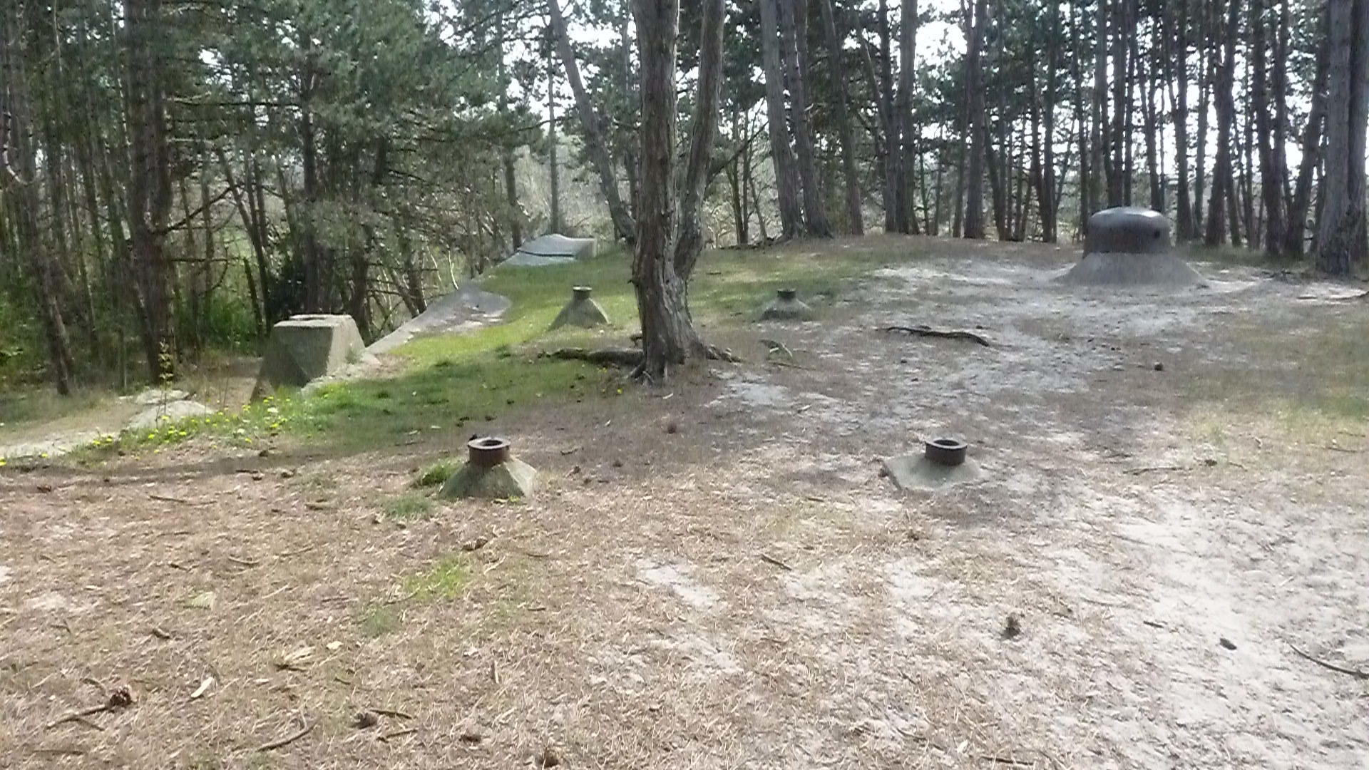

PE1RNL Posted May 29, 2019 Posted May 29, 2019 Hi everyone, I made few pictures of the Verschlußkopf on top of the local Battalions-Gefechtsstand. For displaying the antenna would be nice to have such a part connected to a frame with a clear acrylic tube as Antennenführungsrohr to put the antenna in or maybe even better, make a copy of the Verschlußkopf in plexiglass as well. As we can see in pictures in D-1790-3 This tube is 108 x 3.75 nach Din2448 with a length of 2.3 m. You see the end of this iron Antennenführungsrohr in the Verschlußkopf in the last picture . I never saw a picture in wartime with this antenna, only wire antennas. For HF, wire antennas seem a better option to me also because those can be used with lot more power and low profile and why not use a dipole for VHF? Maybe the 3 whips made it more broadband? Still in the publication "Funker im Bunker!" it says in second line already "Ist eine Festungsantenne eigebaut, dann verwendest Du diese!" What we can see in the placing of the Verschlußköpfe on top of bunkers is that many times 2 are close together and never could not be used at the same time, even for just receiving, because the whips would touch each other. What would be interesting is testing the working of the antenna. I am thinking of trying to make a solid type of the Antennenspreizkopf. What I need to know is the angle of the whips when spread. What I measured in all the drawings that would be around 155° with the vertical axis, so that's about 65° to the horizontal. I hope Funksammler can confirm this. regards, Kees 2
Funksammler Posted May 29, 2019 Author Posted May 29, 2019 Thanks for posting some great photographs of the antenna tubes, they are certainly not lacking on this particular bunker! You will have to remind me about measuring the angle in the couple of weeks, at the moment I am moving around part of the collection, suffering from poor access and lack of time at the moment... regards, Funksammler 2
