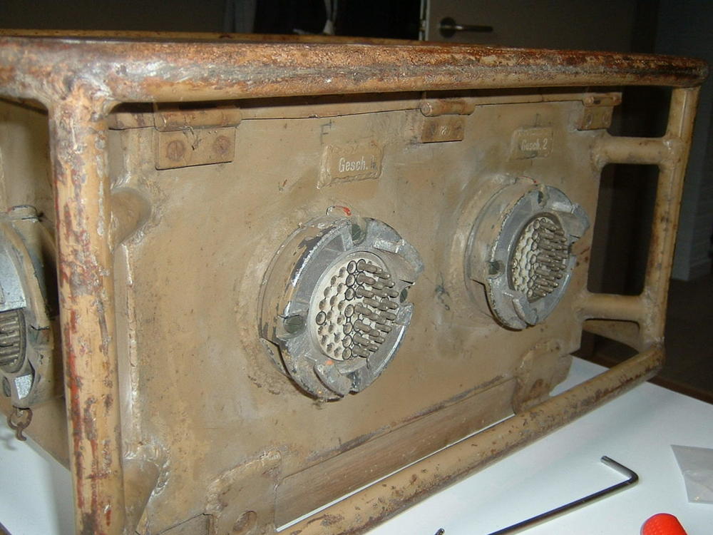

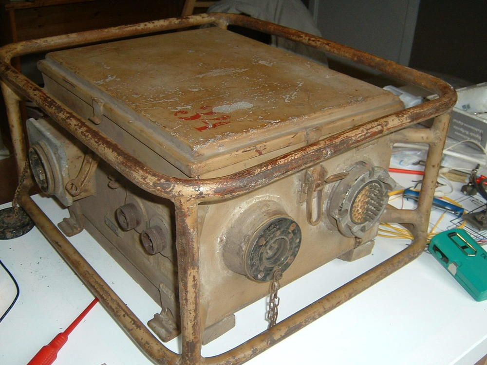

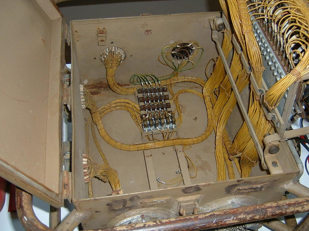

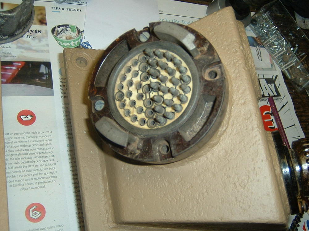

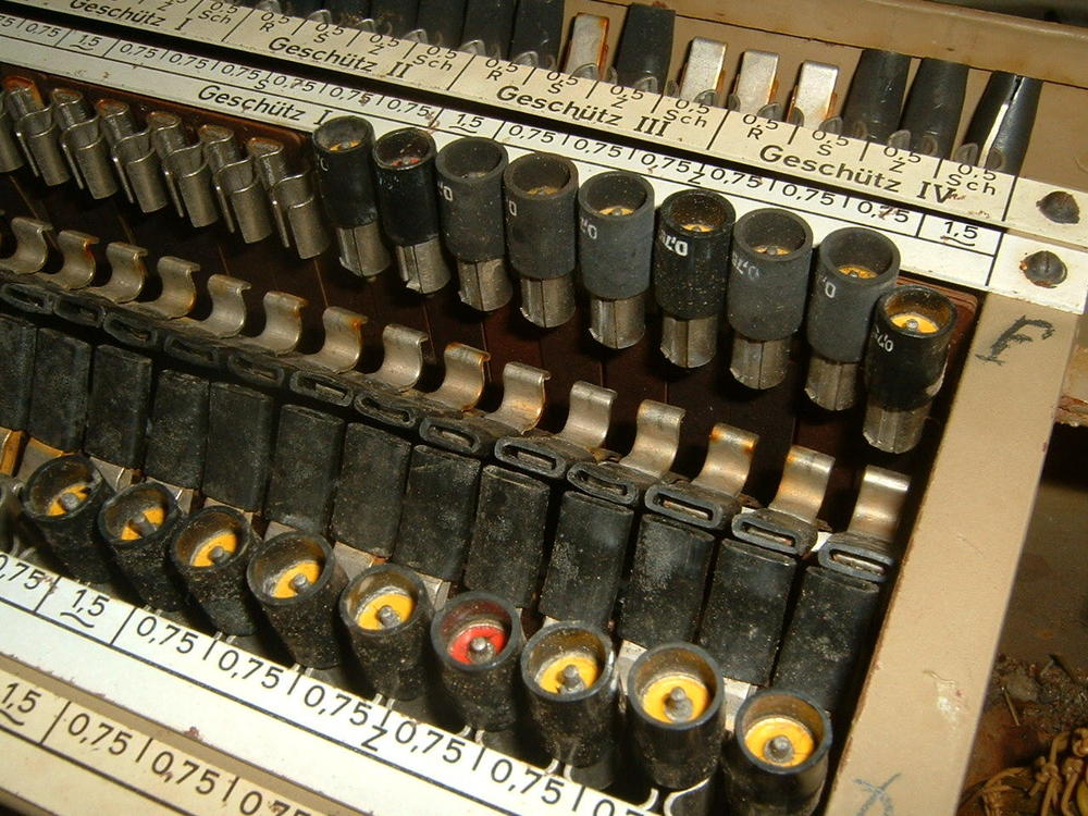

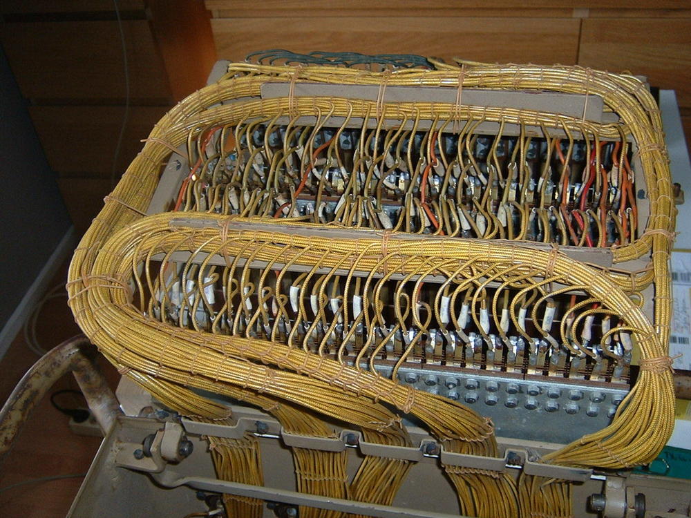

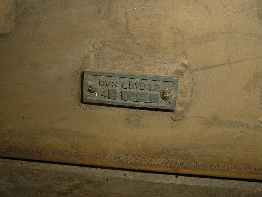

dufleuve Posted July 1, 2019 Posted July 1, 2019 Hello, As Val asked, here are the pictures of the "Verteilerkasten Batterie Mitte" for the "Ubertragungsgerät 37" data transmission system for heavy flak. I will explain usage of the various connections in further posts. 2

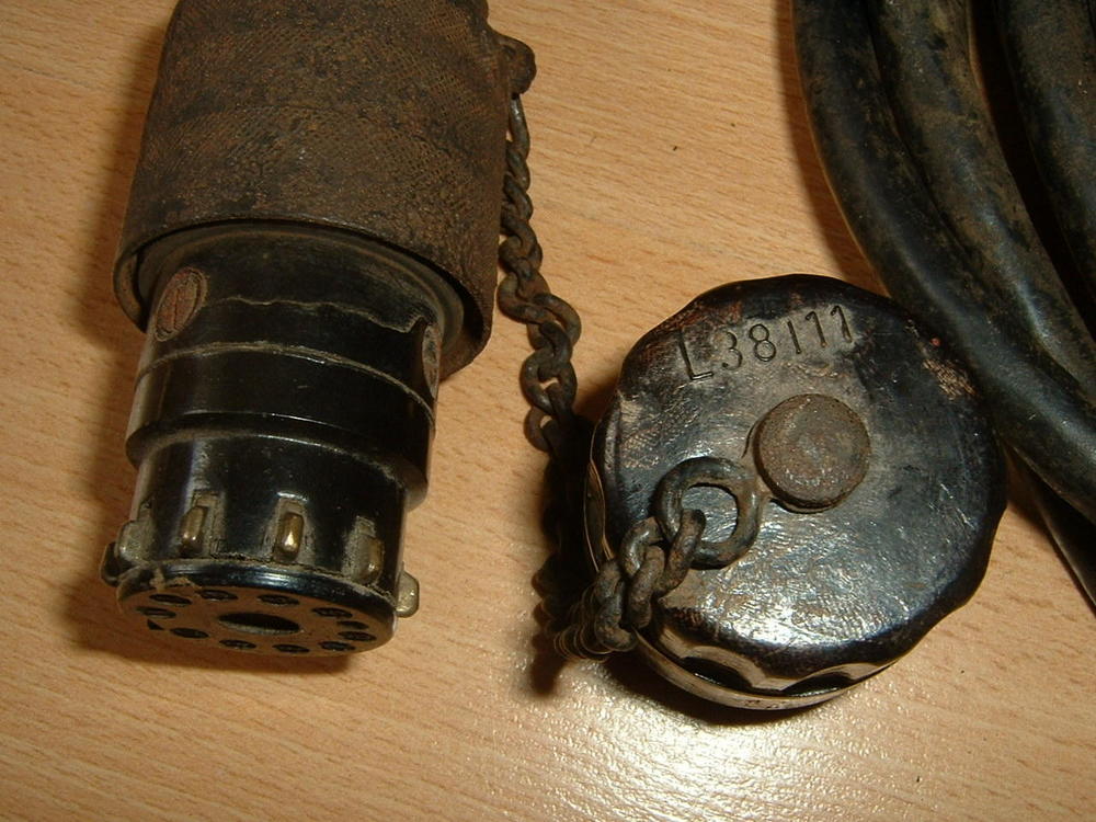

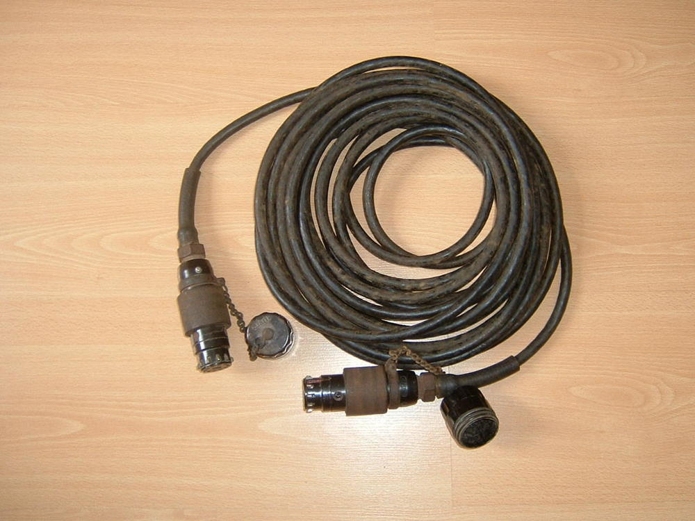

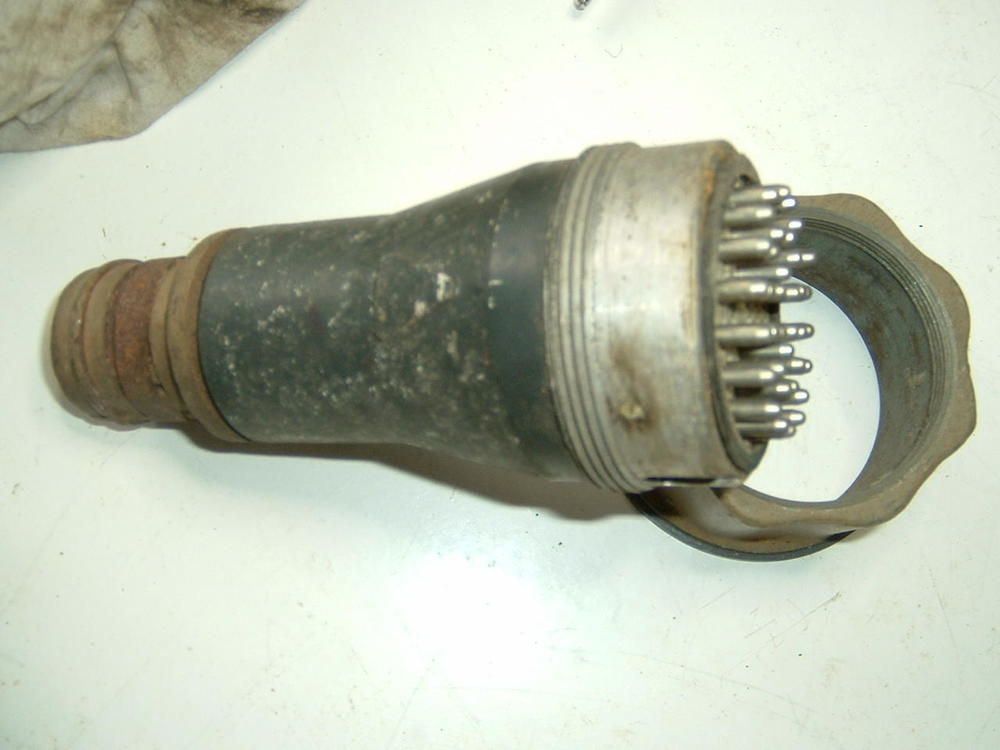

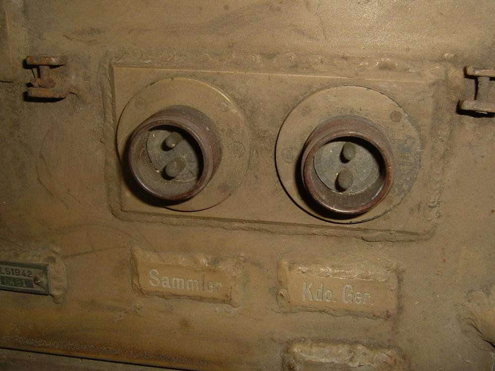

dufleuve Posted July 1, 2019 Author Posted July 1, 2019 Hello Val, Yes I got that one. Pictures of the 10 pins round connectors cable. Connects on the 10 pins female on the verteilerkasten and to the "Fensprechgerät for Kommandozwecke" on the other end. This cable is complete and functional. 1

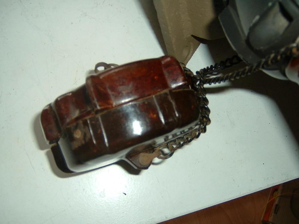

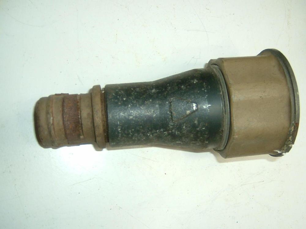

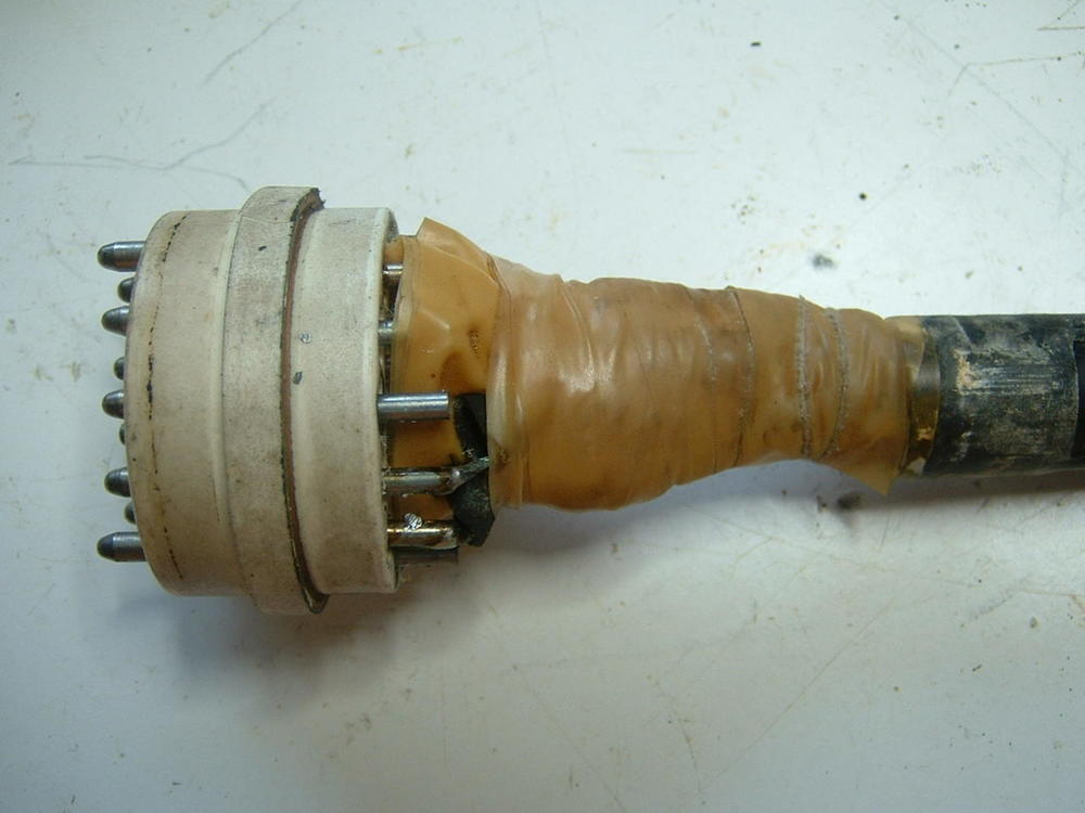

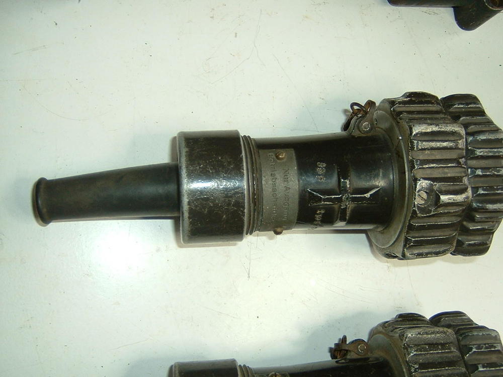

dufleuve Posted July 1, 2019 Author Posted July 1, 2019 (edited) Ubertragungsleitung 37 c (5m). It is the short version of the connecting 46 pins cable that transmits both telephony and kommandogerät data to the guns. The a version is 60m long, the b version 30m. The connectors are of bakelite and metal, I assume the late version. Edited July 1, 2019 by dufleuve 1

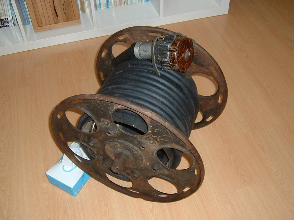

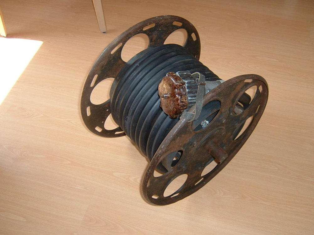

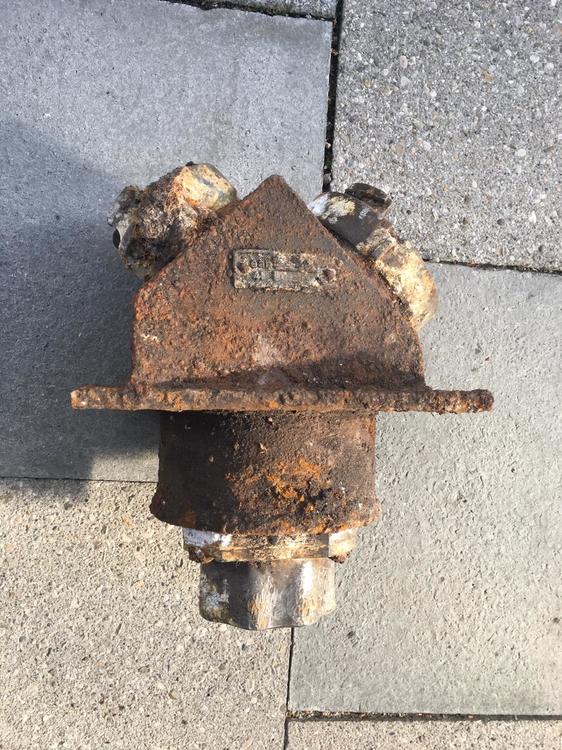

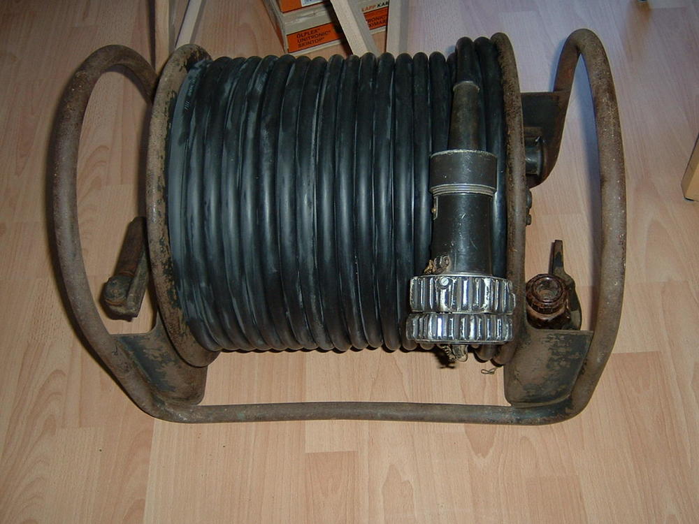

dufleuve Posted July 1, 2019 Author Posted July 1, 2019 Last one for today: the Ubertragungstrommel 37 that you see sitting on the fenders of the Flak guns carriages. The connector is earlier all metal type. Cable is dummy to fill the trommel. 1

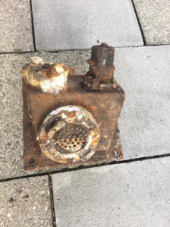

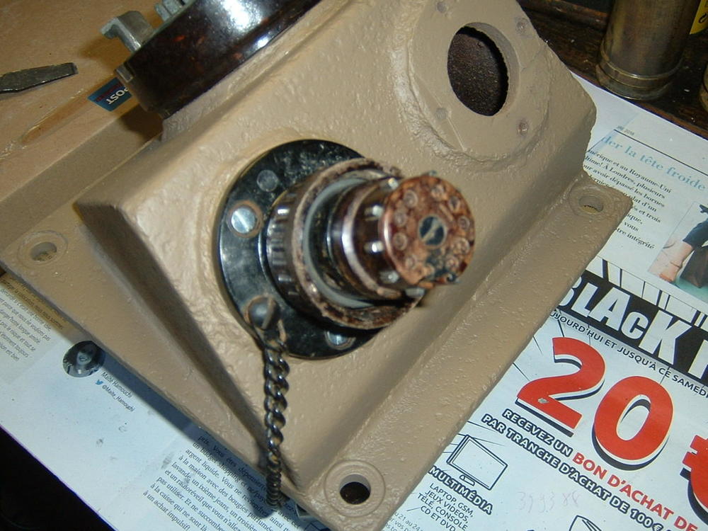

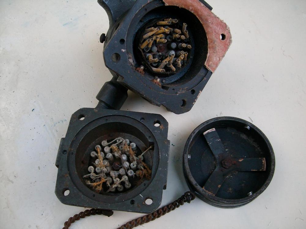

dufleuve Posted July 4, 2019 Author Posted July 4, 2019 Another addition to the system: the connection box from the base of a Flak 88. All connectors far gone, alu and steel do not mix happily. But I have spares to replace them 👍 The special connector at the back I'll try to retrieve. Again the steel screws are completely fused with alu, I'll try to bore them out. After that cleaning, derusting and painting the steel box. Most tricky will be to rebuild the cabling, 46 wires with crossover to 10 and 14 pins connectors... 1

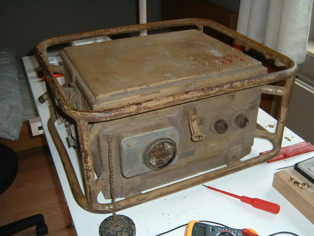

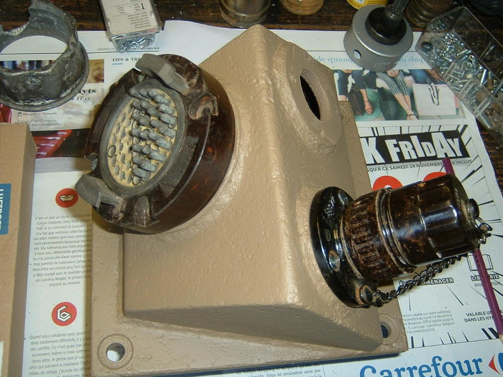

dufleuve Posted July 11, 2019 Author Posted July 11, 2019 Well, Some progress on the steel box and trial of replacement connectors. Don't have a 14 pins connector yet. In any case, not sure of its use and seems deleted on some guns. 1

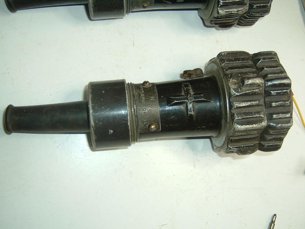

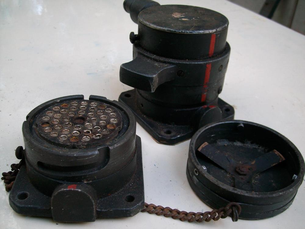

dufleuve Posted July 12, 2019 Author Posted July 12, 2019 To make things clear, I have this type: female built-in Male plug: Male buit-in: I assume there exists a female plug to connect to the male built-in, but never saw one of these.

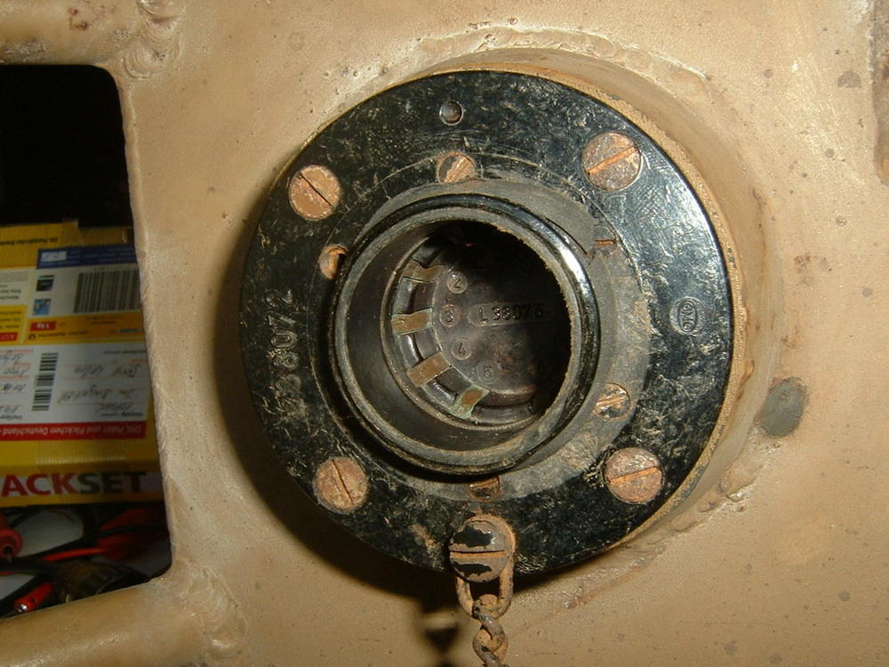

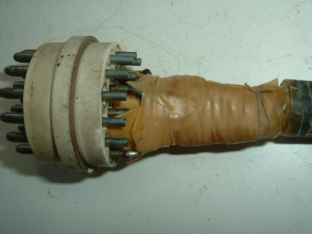

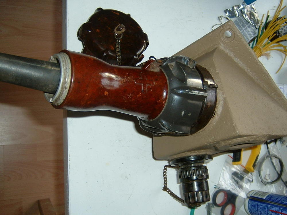

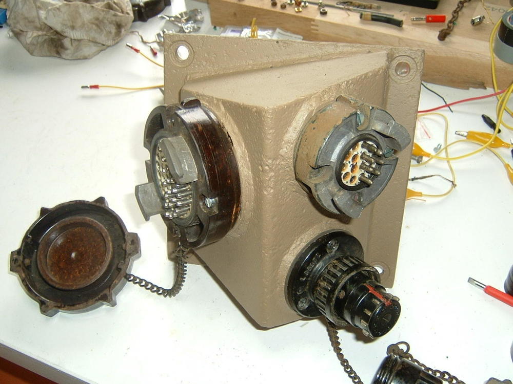

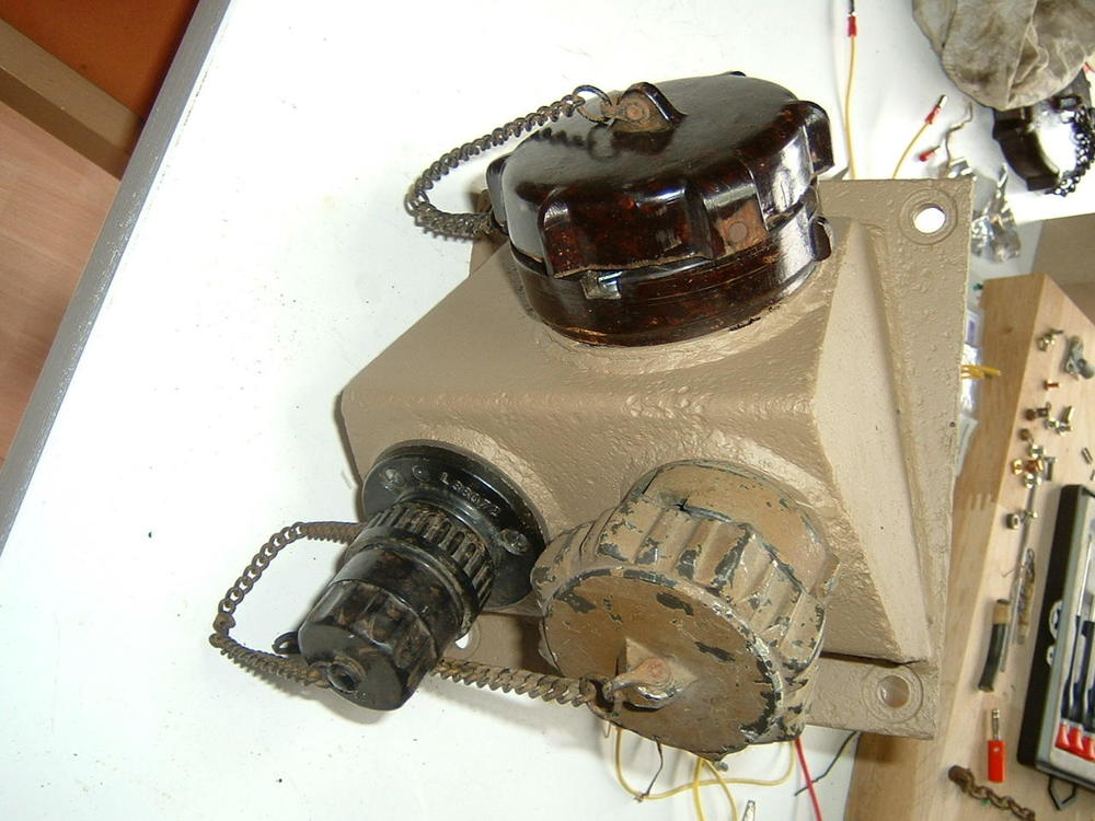

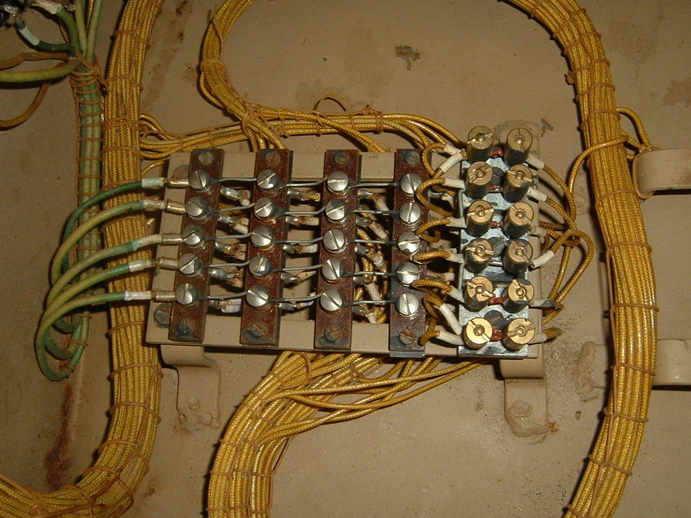

dufleuve Posted July 30, 2019 Author Posted July 30, 2019 Well, Seems the forum is asleep during holidays... Some progress on the flak88 connection. 46 pins Renkdose and 10 pins Hilfsleitung ready with cables soldered. Now the tricky part is to join ubertragungs and hilfsleitung on the back Renkdose and solder these, plus the 36 other cables. The Hilfsleitung (basically the telephony connections) use the central ten pins. The cables are shielded and the shield is connected to ground. Strangely, pin 7 and 8 on Hilfsleistung are not used on this Flak88 connection. Those pins are used for the firing bell. Pins 5 on the Renkdose are well connected ans used for same purpose. Pins 4 on the Renkdose and 9/10 on Hilfsleitung are used for gun leader comms. Pins 1-3 on the Renkdose and 1/6 on Hilfsleitung are used for gun layers and fuze setters voice comms. Other pins on the Renkdose used for Ubertragungsgerät data transmission. The 14 pins connector purpose is still unknown. On the 12;8cm flak gun electrical schema, there is also one referenced as "Anzeigetafeln" connection ?? Some pics of the Ubertragungs 37 Renkstecker connected. Note both covers locked together as recommended in the manual to avoid collecting dirt.👍 1

dufleuve Posted August 8, 2019 Author Posted August 8, 2019 Good week, I was able to buy and trade additional connectors, including a 14 HS renkdose to complete the Anschlusskasten (Ubertragung). 1

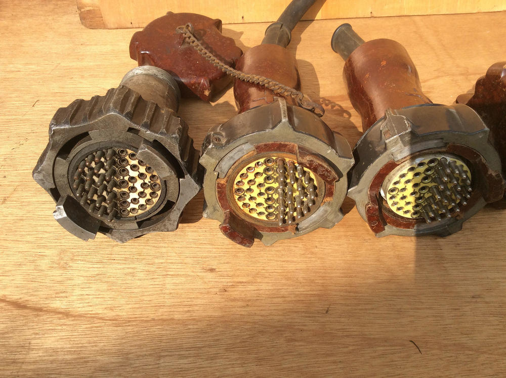

dufleuve Posted August 8, 2019 Author Posted August 8, 2019 The following connectors were included. I knew about those with 108 contacts, used for the Ubertragungsgerät 30 (the one using lamps on a round box). These with 36 contacts, I have no idea yet as to their use. 1

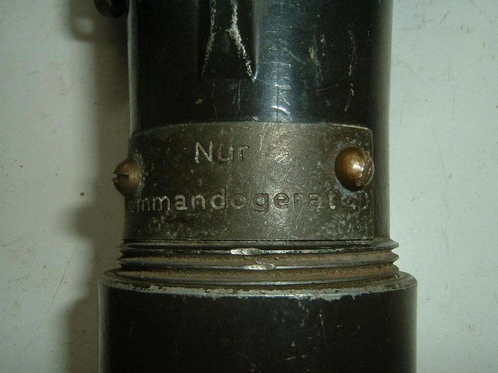

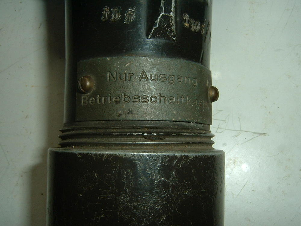

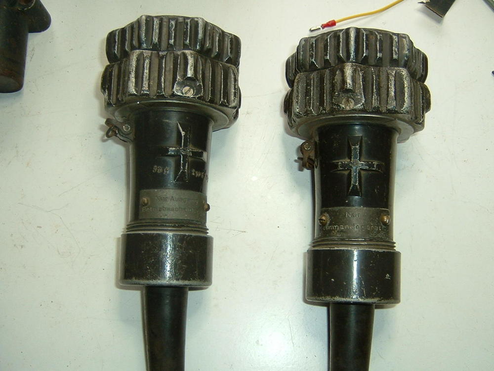

dufleuve Posted August 8, 2019 Author Posted August 8, 2019 Those two renkstecker 24 HS are quite interesting. They have a id plate screwed on. One is "Ausgang Betriebsschaltkaten", the other one "Nur kommandogerät 40". Cable remains are 4x6mm conductors, so obviously a power cable. 1

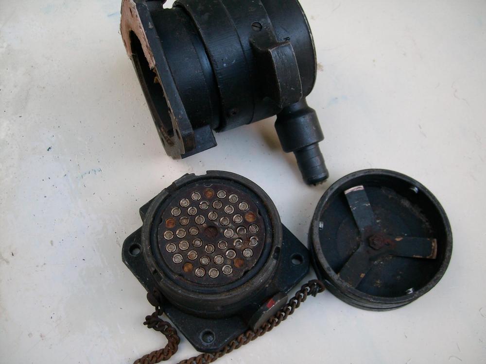

dufleuve Posted August 9, 2019 Author Posted August 9, 2019 And last one: the 36 pins connector between the Anschlusskaten and the Schleifringkorper (collector) on the 10,5cm and 12,8cm flak. The one on the flak 88 is a 46 pins one.

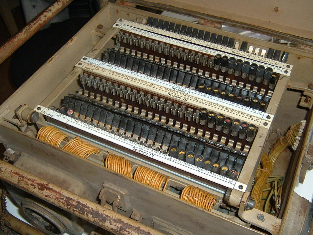

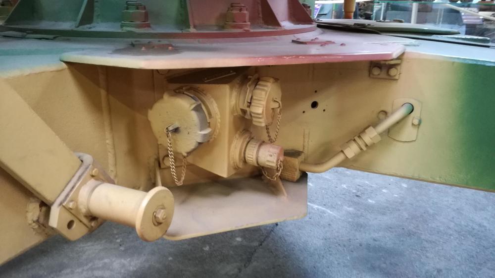

dufleuve Posted August 13, 2019 Author Posted August 13, 2019 The Übertragungsanschluss kasten on a museum Flak88and mine. ✌️ 2

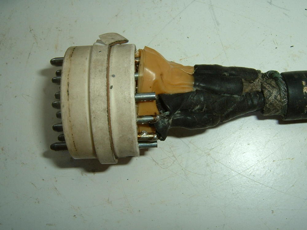

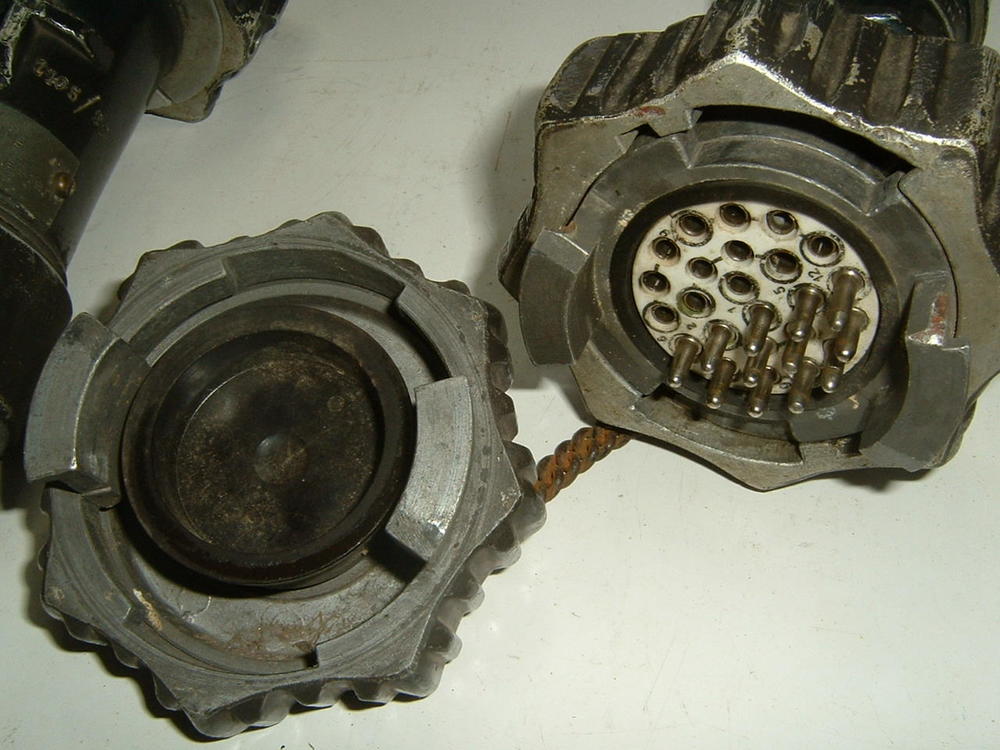

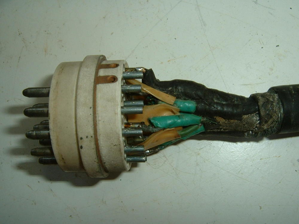

dufleuve Posted September 14, 2019 Author Posted September 14, 2019 Hello folks, Pictures show how the connection is done on 24 HS renkstecker for the KdoG 40. There are 4 conductors (2xapprox. 4mm, 2x approx. 6mm) plus a shield. The 4mm and shield are connected to a single pin, the 6mm to respectively 3 and 4 pins, means their end is soldered to 3-4 short pieces of approx. 2mm cable. The isolation between is a mix of gummi and the strange plastic like band wrapped around. On the second 24 HS renkstecker, the cable end has been entirely removed, but one can still see on which pins soldering has been done. As expected, it is the exact opposite of the first connector. Another cross-cable. I intend now to rebuild the entire cable. I procured 50m of a 7G2,5 with same diameter and flexibility as the original, unfortunately not shielded. The 36v DC will go on 2x2,5 pair, the 110v AC to a 2,5 pair and last conductor for the "shield". Next cable project is to rebuild a 60m Ubertragungsleitung 37, with its two 46 HS renkstecker. But still have to find a suitable 17-19mm diameter cable with about 50 conductors. Anyone has that in storage somewhere ???? 1
dufleuve Posted September 15, 2019 Author Posted September 15, 2019 24 HS renkstecker for the betriebschaltkasten connected to cable. I will do the Kdo40 side tomorrow. I used the newly acquired 1942 kabeltrommel to store the 50m cable. Looks nice, even if it is designed for standard power cables. Will do until I get the correct Leistungtrommel. Cheers PS: seems activity moved from WAF to MCN to FB .... 1 1
