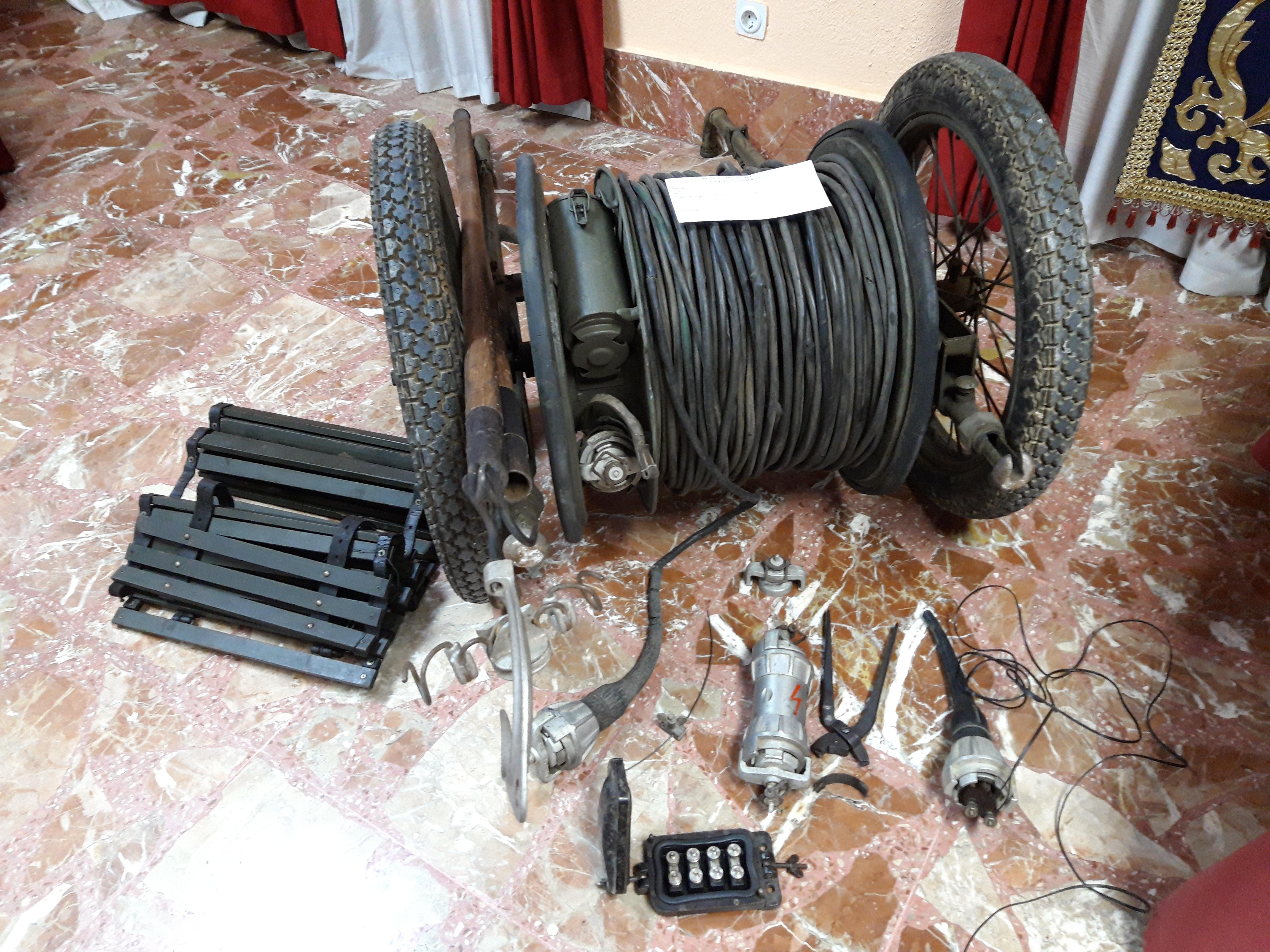

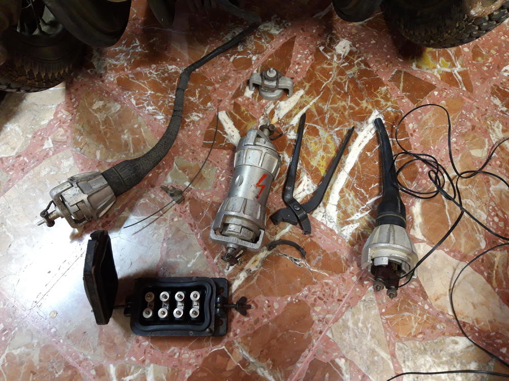

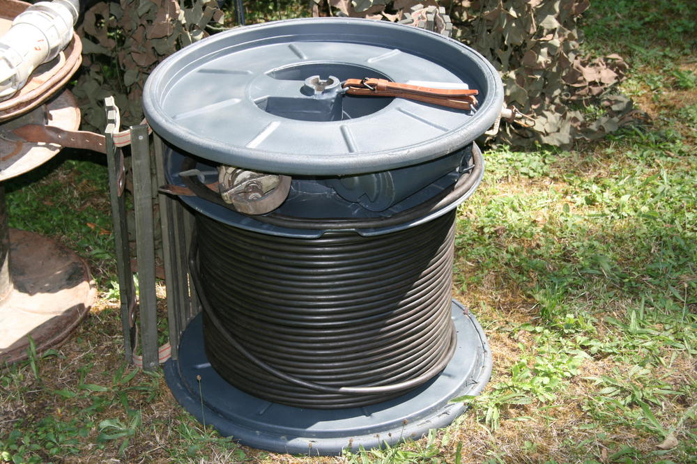

ezesar Posted September 28, 2019 Posted September 28, 2019 (edited) On 10/09/2019 at 22:21, Alperator said: @ezesar: I may see your pictures of the Verlegewagen on my website Publish?, of course with your name and source. Then almost all important information on the topic of Feldfernkabel is summarized. @val, Thanks for the tip. here I would like to insert the pictures: http://der-fernmelder.de/feldfernkabel/ Thank you and have a nice evening. Albert Hi Albert. Here again since a lot of time ago. Sorry. Well, I´d never thought that someday part of my material would be shown in your excellent and didactic page. I´vegot good info a lot of times from there. Feel free to use my images to include them in Der Fernmelder. I will try to add several more from my last exhibition. Some additional info. Those carts were used until beginning of 2000 decade by the Spanish Army to lay heavy two pairs field cable, first FFK from german adquisition in Spanish Civil War (1936-39) and "Plan BÄR" in 1943 and after spanish mfg. cable called AZO after its manufacturer in the town of Zaragoza that at the end, made a new 2 pairs cable under denomination C-1. When digital systems Signal programs were launched those cables and carts were decomissioned holding only US 26 pairs cable for digital systems Signal stations. Regards. César Edited September 28, 2019 by ezesar I´ve forgot to add 1943 year for Plan BÄR 1 1

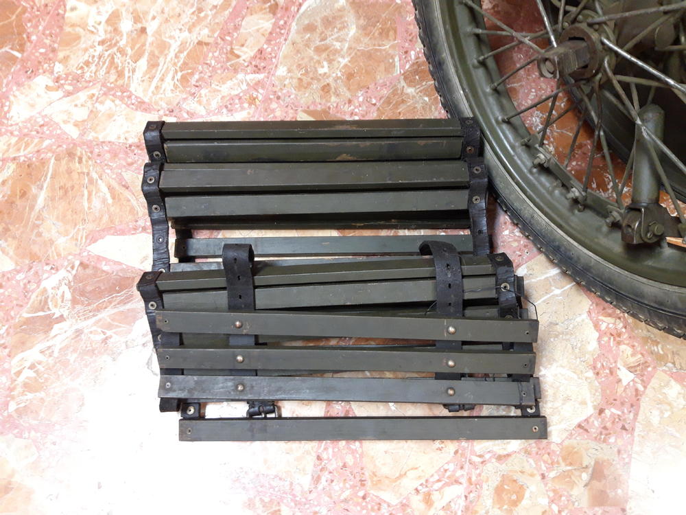

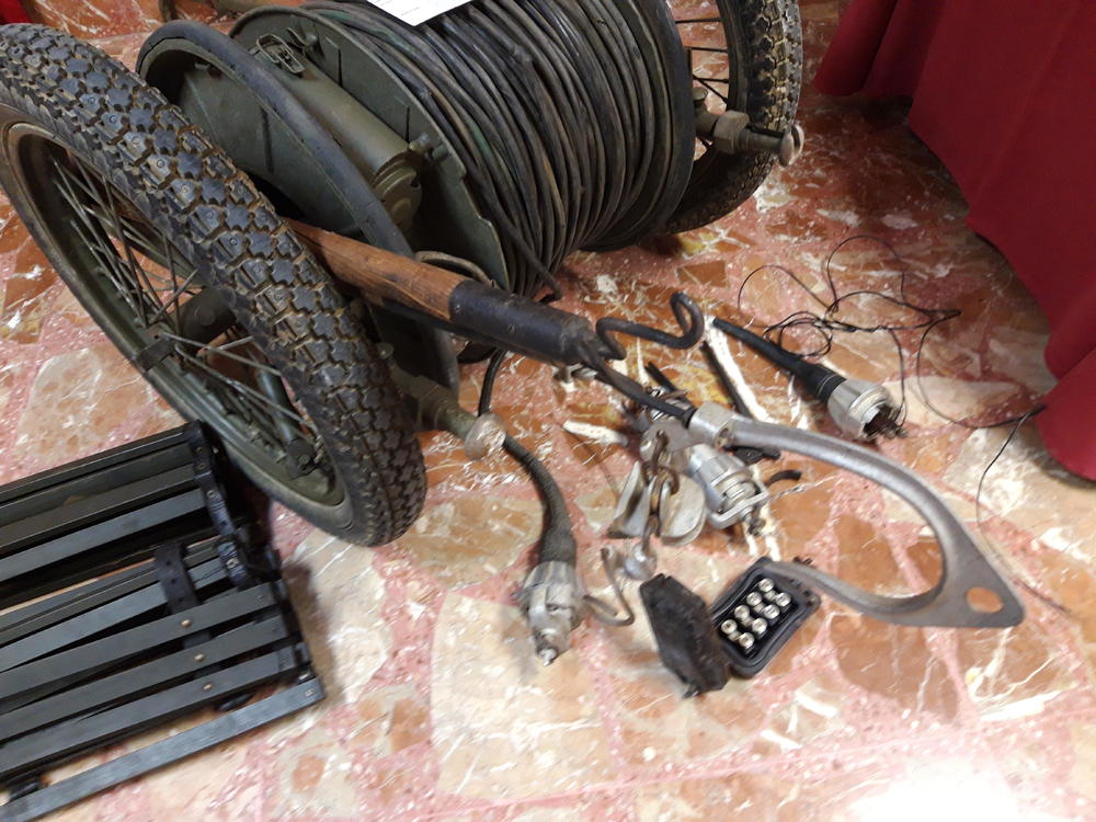

ezesar Posted September 29, 2019 Posted September 29, 2019 Hi again. Images of my sFFK frommy last exhibition. 1
