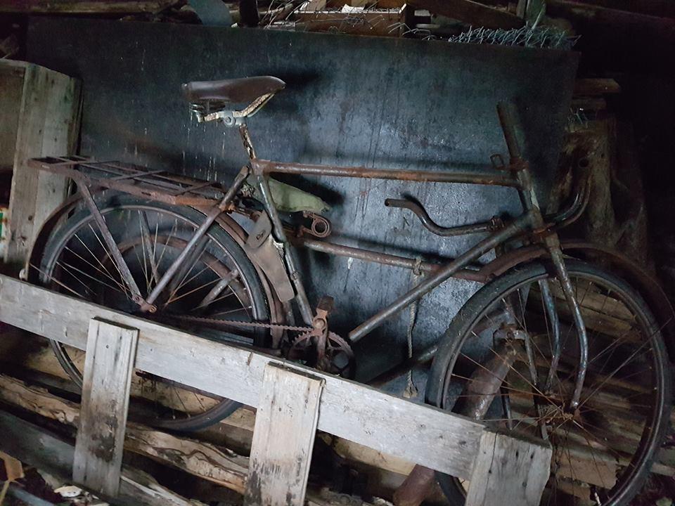

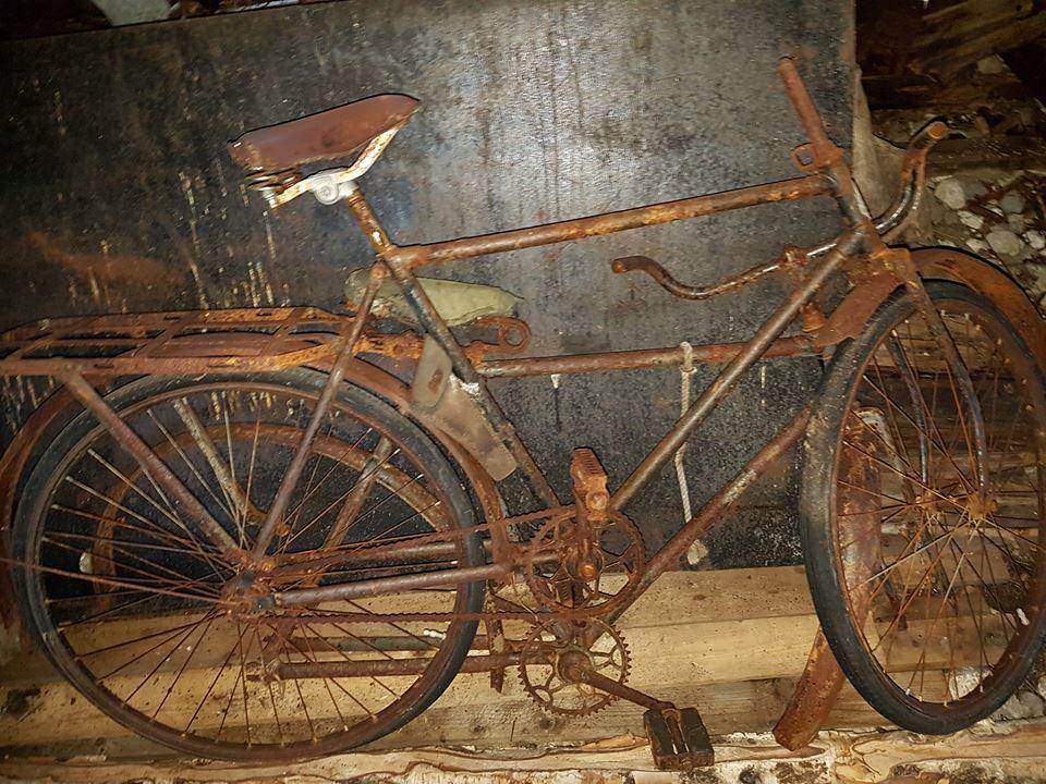

And this is what I found:
I instantly recogniced the characteristic german military luggage-carrier on one of the bicycles, and knew what I had struck. Althou a bit rusty,  this was gold

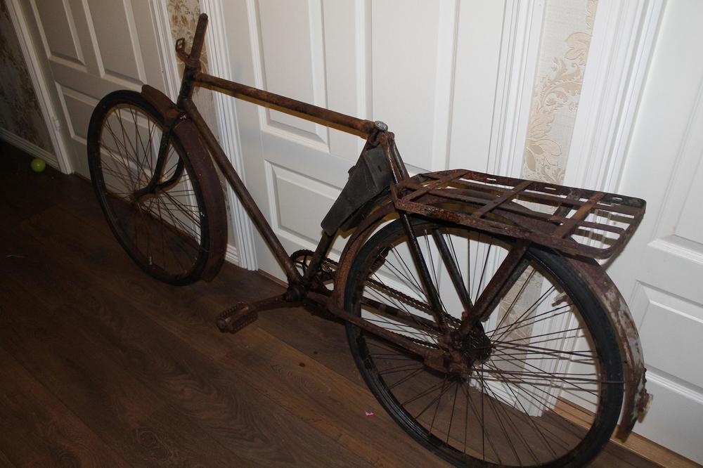

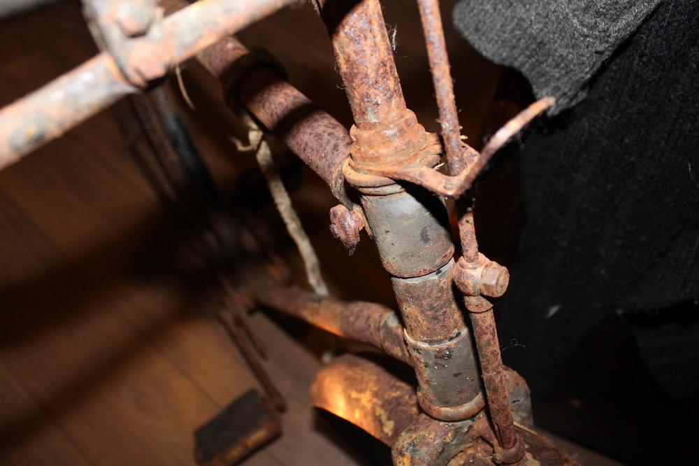

Well, first I had to get them home. Quite a job actually - the lake was not yet frozen, so I had to carry them about one kilometer from the old farm, to the road where I had parked my car.

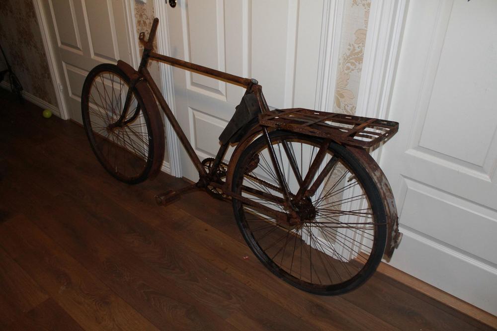

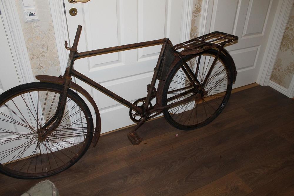

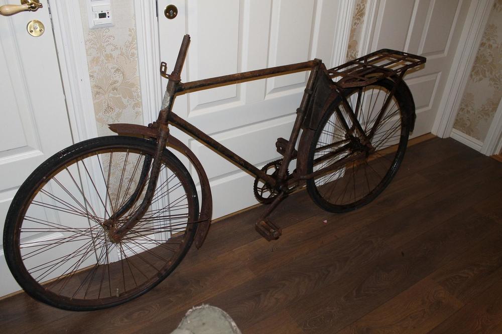

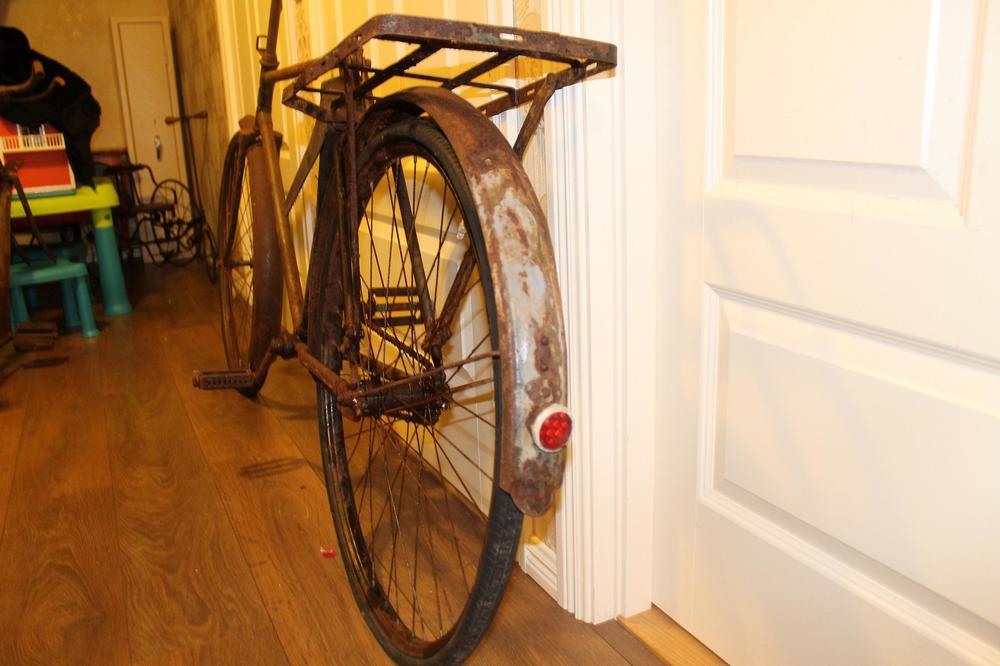

I got them home, brought them inside and took some pictures of them and studied them closer. The bicycles was far from complete, but I soon discovered that they were both of german military issue.

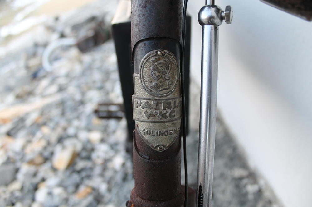

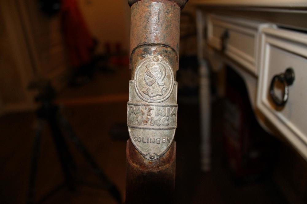

Here is the Patria WKCIMG_8236.thumb.jpg.8a4ff60a95684bf9d94e745b17d48702.jpg

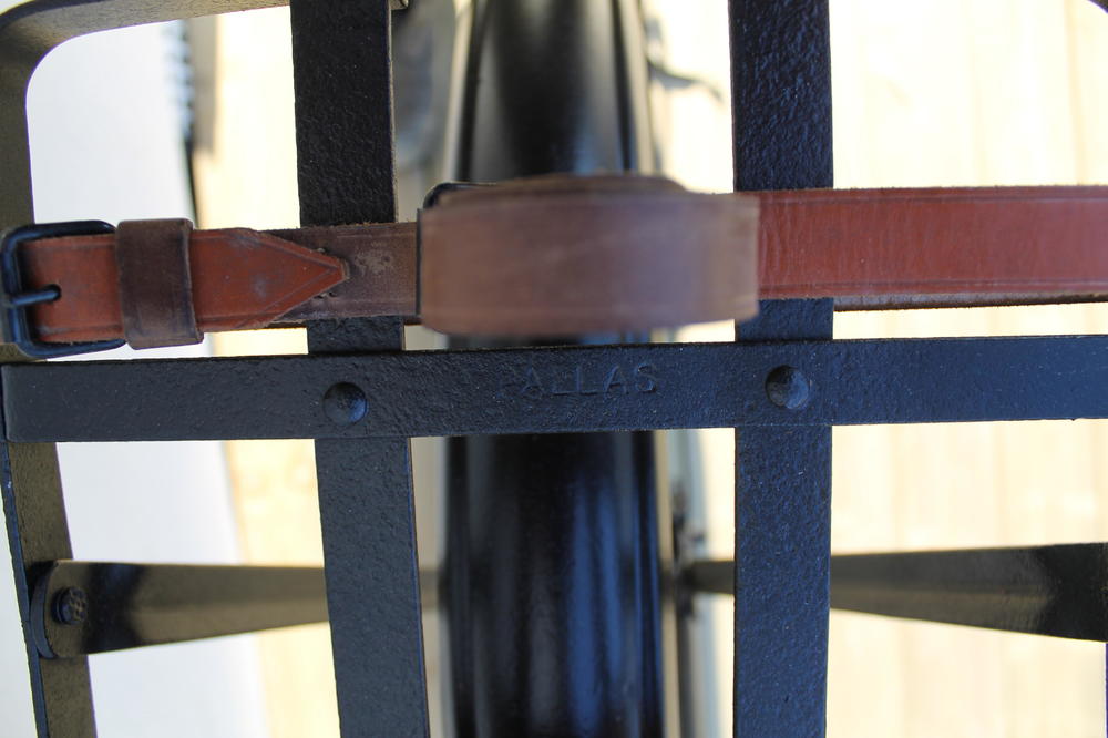

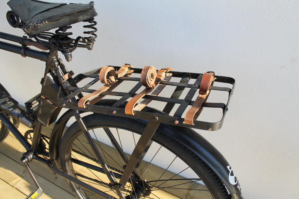

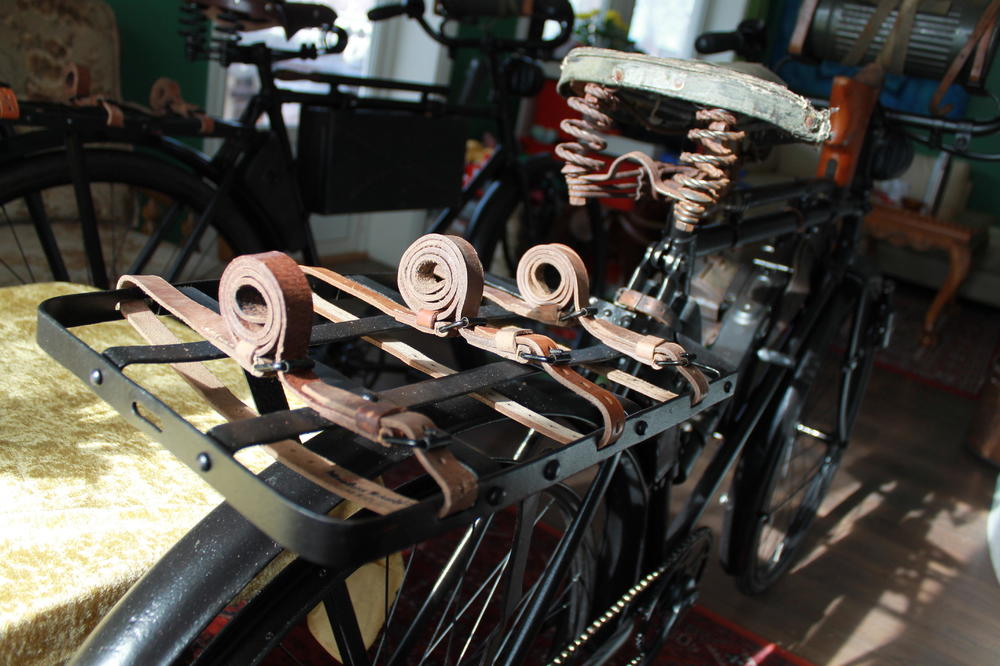

Original Pallas gepäckträger, military issue luggage carrier:

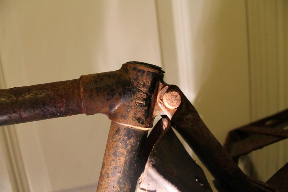

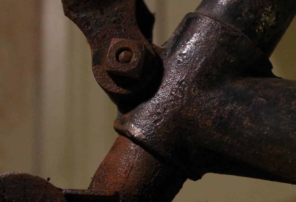

The frame of the bicycle had the WKC symbol embossed, and the year of production. ( ONLY military Truppenfahrräder has got the year of production stamped into the frame. ( The serialnumber of the frame is on the opposite side)
And notice that the original wehrmacht tool bag is sstill clinging on to the frame. These toolbags has got a special construction and shape, and are not found on any civillian bicycles.

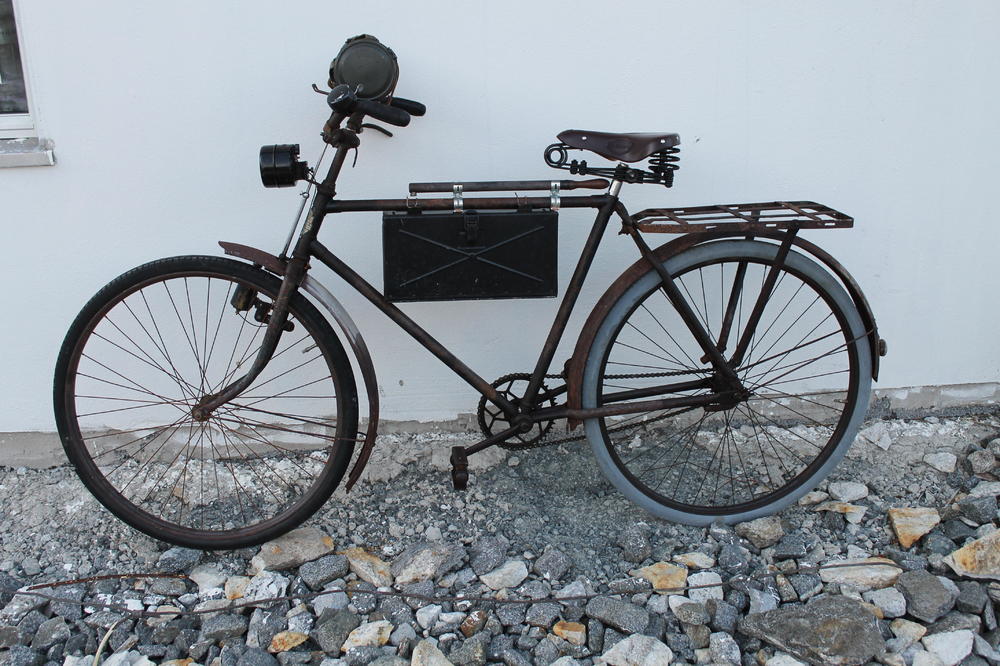

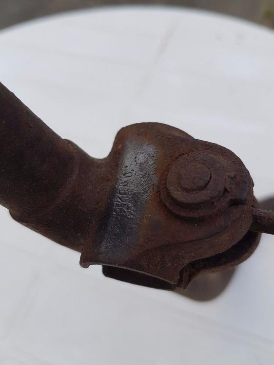

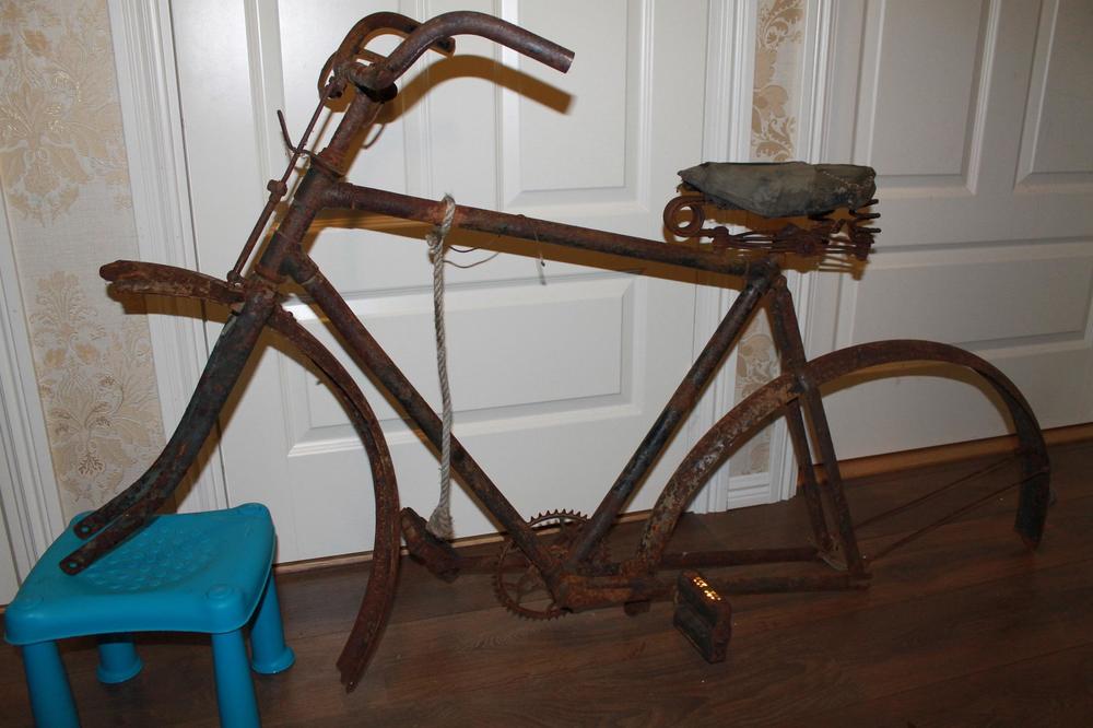

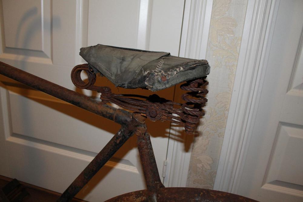

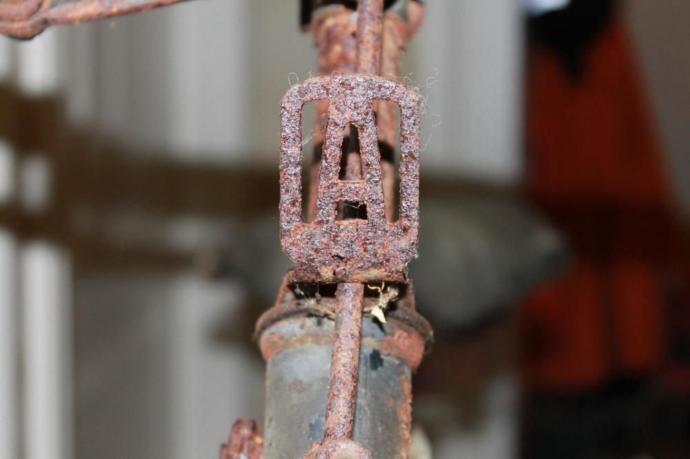

Anyway, the second Bicycle, I had to spend some time searching about, until I found the decicive answer to what type it was, as it was missing it's original emblem.
But the large A in the lantern bracket solcved the mysterie after some time.
It is an Achilles bicycle, made in Ober Politz, Czechoslovakia (annected by Germany in 1938)

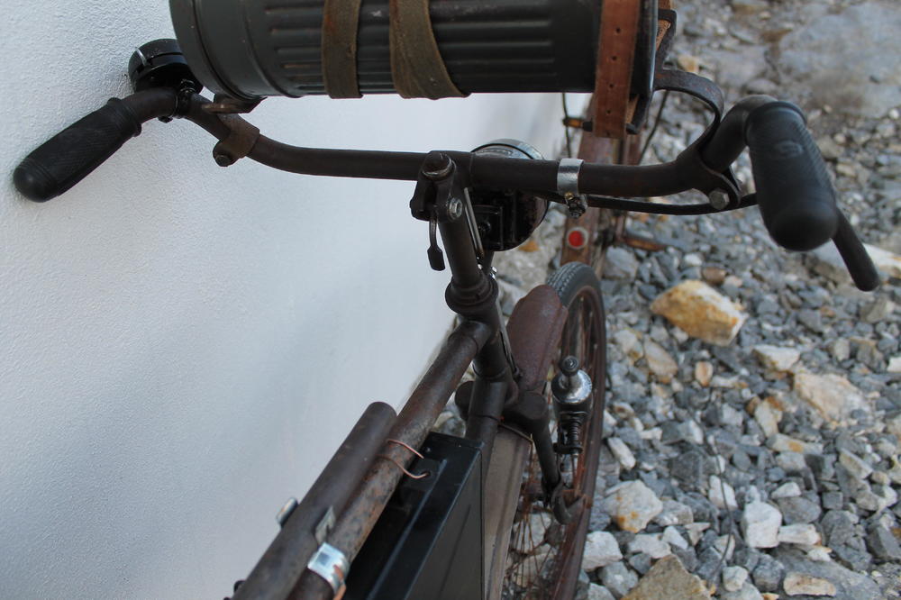

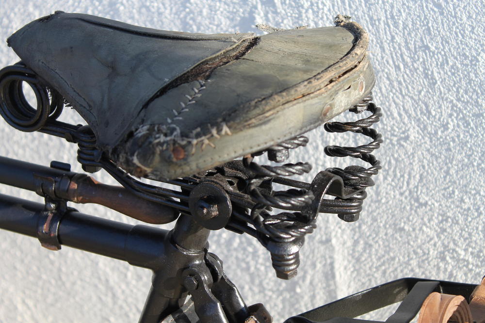

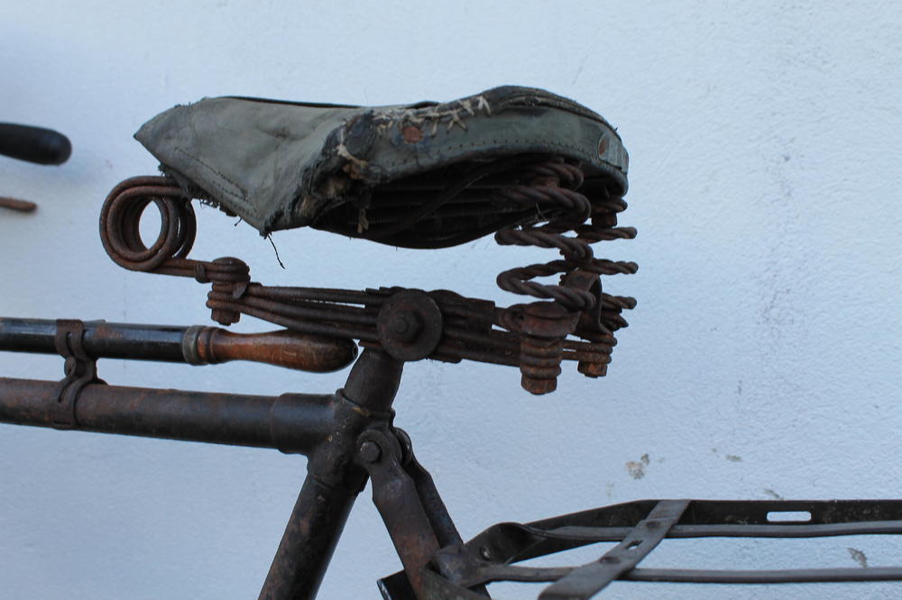

This bicycle had the Wehrmacht type detatchable handlebars, front brake and the original saddle still present.
And it had even more.
After searching and reading just about everywhere about the Truppenfahrrad, I learned that there was no truppenfahrrads wich were delivered trough waffenamt offices, and so there was no original Truppenfahrrad that should have any waffenamt markings.
Well this one does.

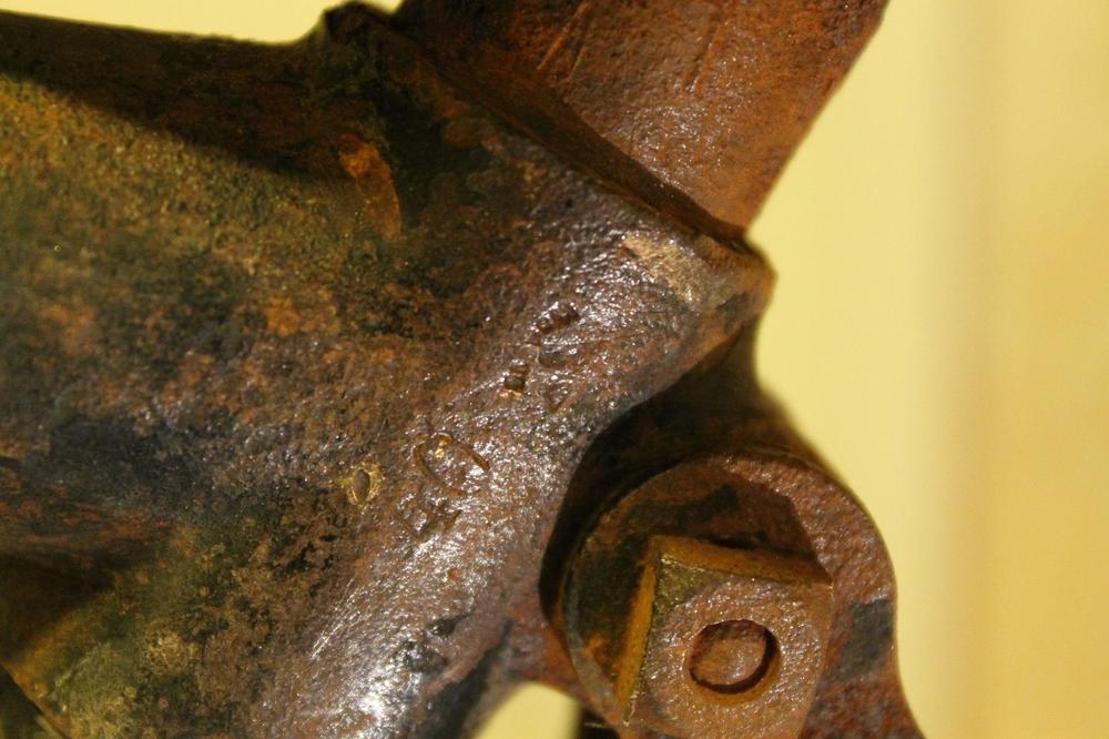

It has the serial number in one side of the frame undernieth the seat, but on the other side, there is a "40" denoting 1940, and a waffenamt mark.

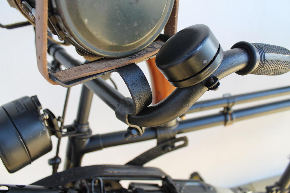

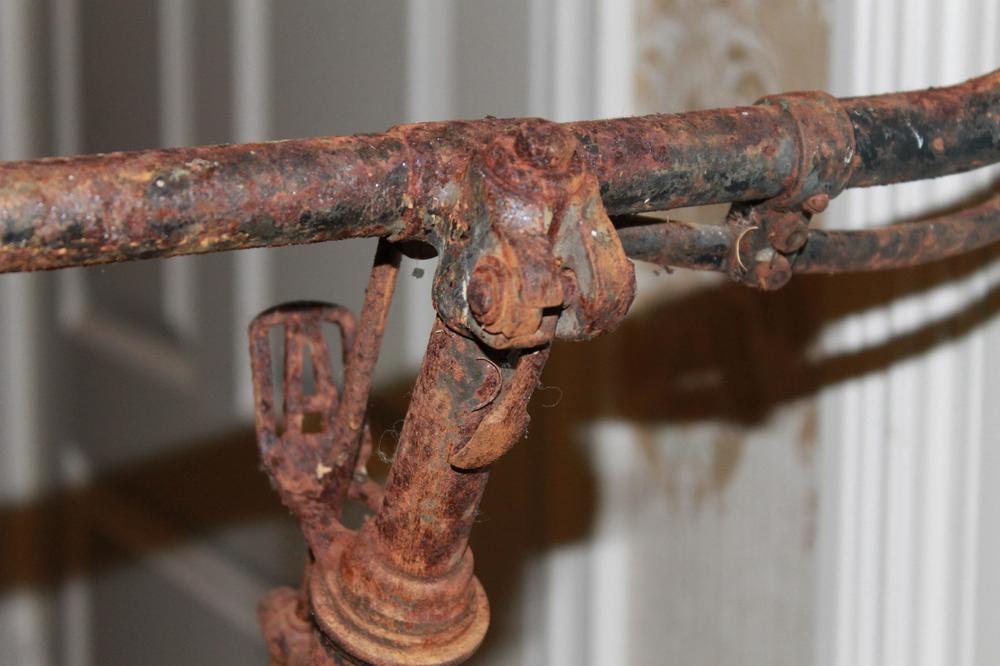

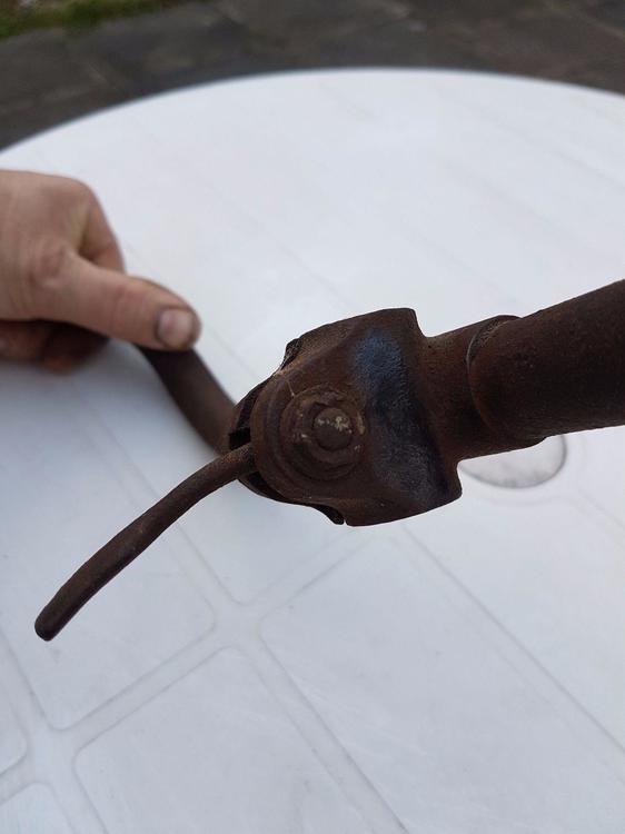

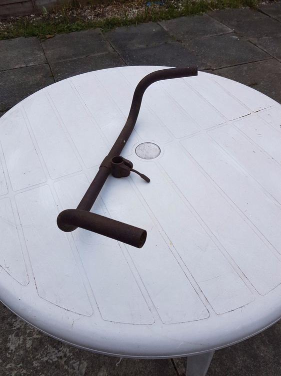

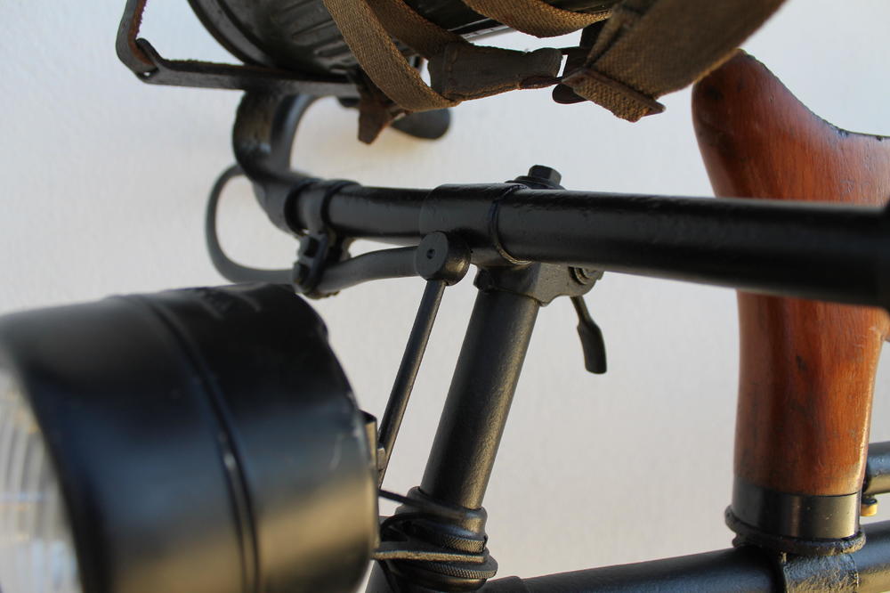

Original handlebars, wehrmacht model Expresswerke I found and bought from a fellow in England.

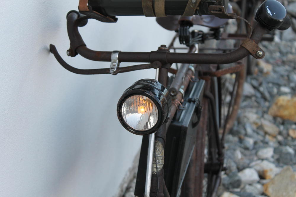

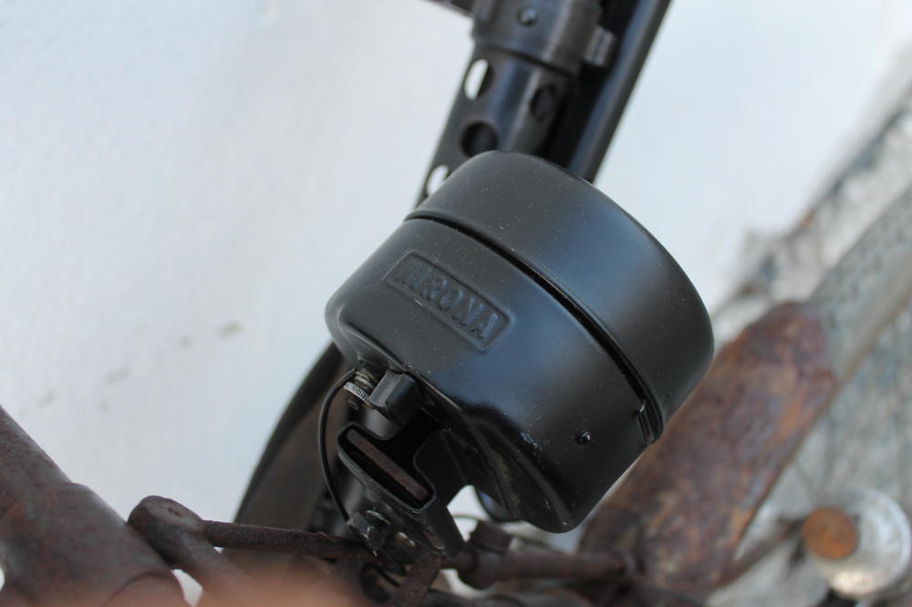

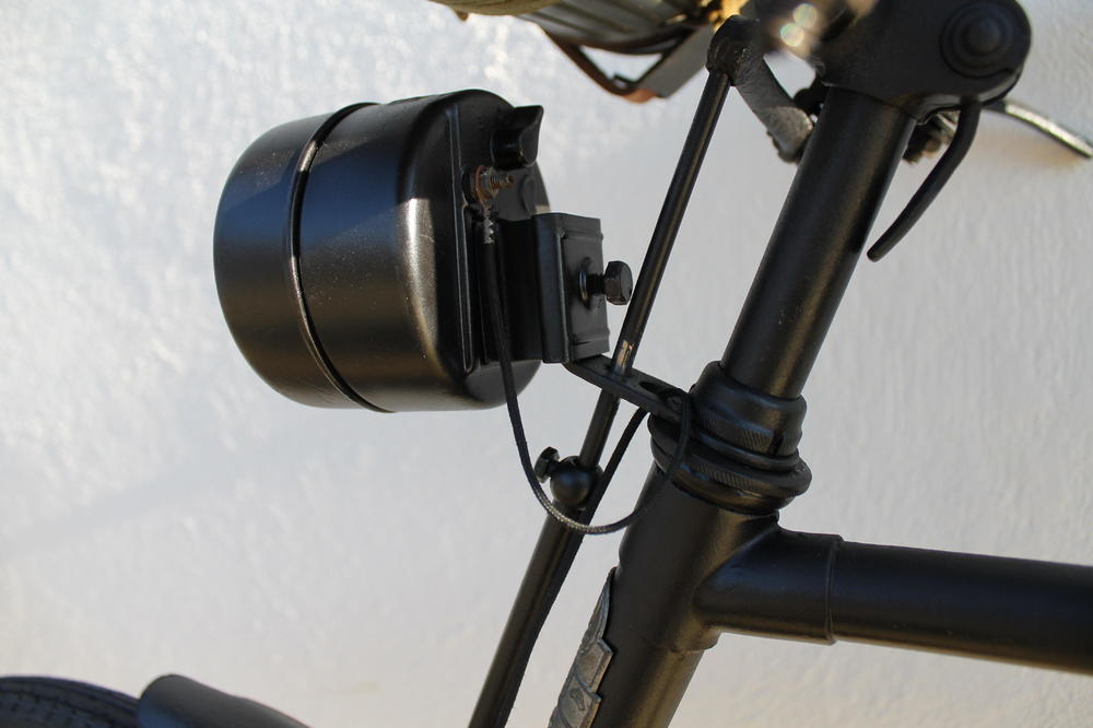

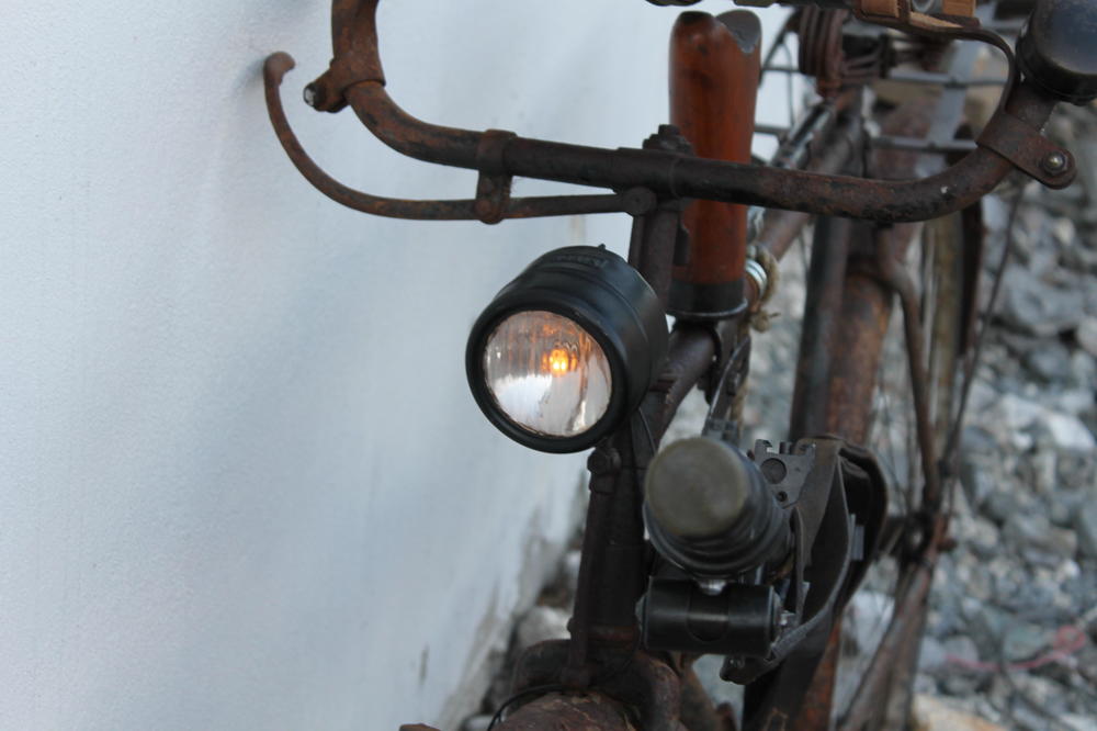

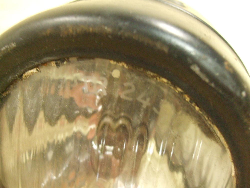

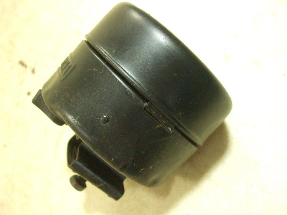

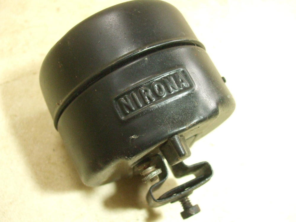

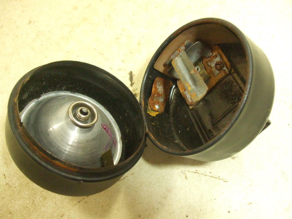

Original Wehrmacht model Nirona bicycle lamps was found in Germany.
Wehrmacht specifications said that the bicycle lamps should be powered by dynamo AND batteries, as they should be able to take them off the bicycles and use them as handheld lanterns.

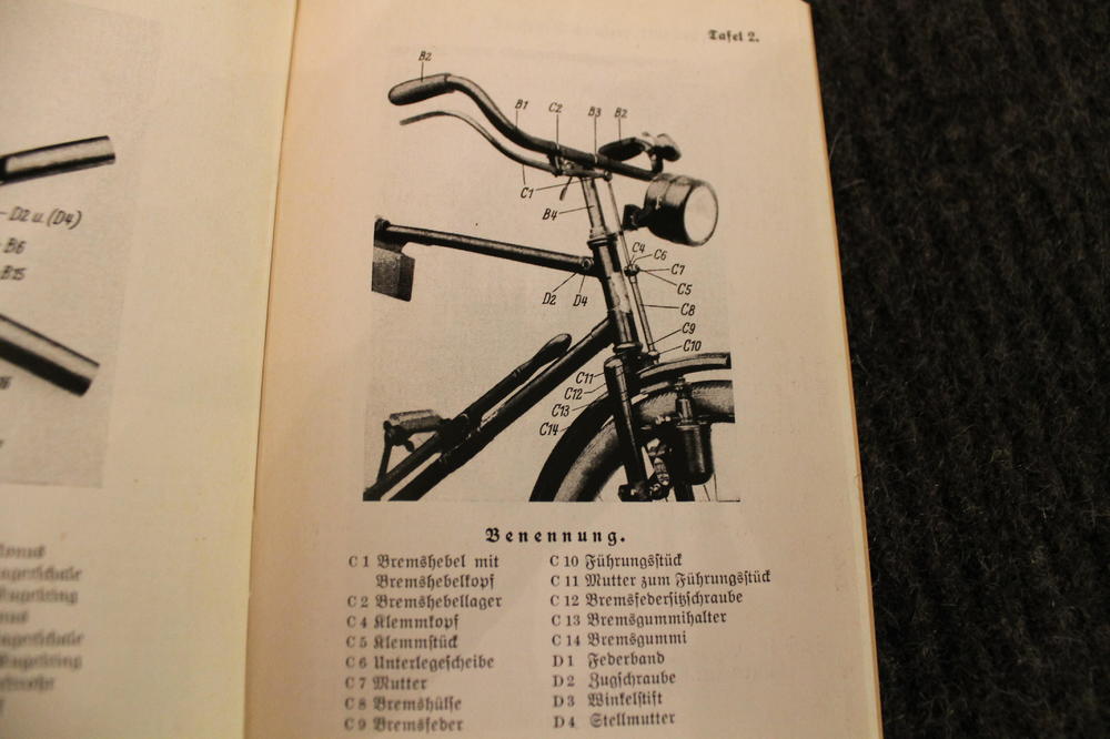

I bought a reprint of the original H.Dv.293 booklet - Das Truppenfahrrad. This booklet is full of information about specifications and importaint information.
A lot has been written in books, forums and communities about the Truppenfahrrad, but along the way of collecting parts for these bicycles, I found that there is a lot of mis-information also. I soon realized, when it comes to finding the right path of how to restore these two properly, I will have to rely on only original sources and photograps.

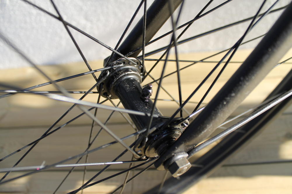

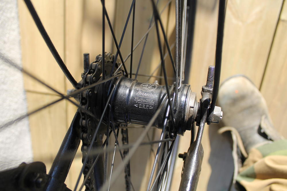

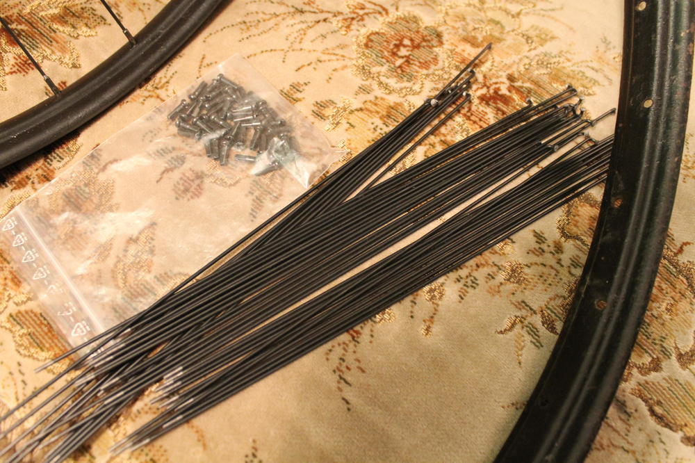

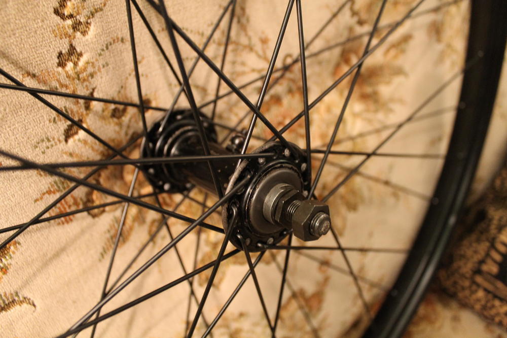

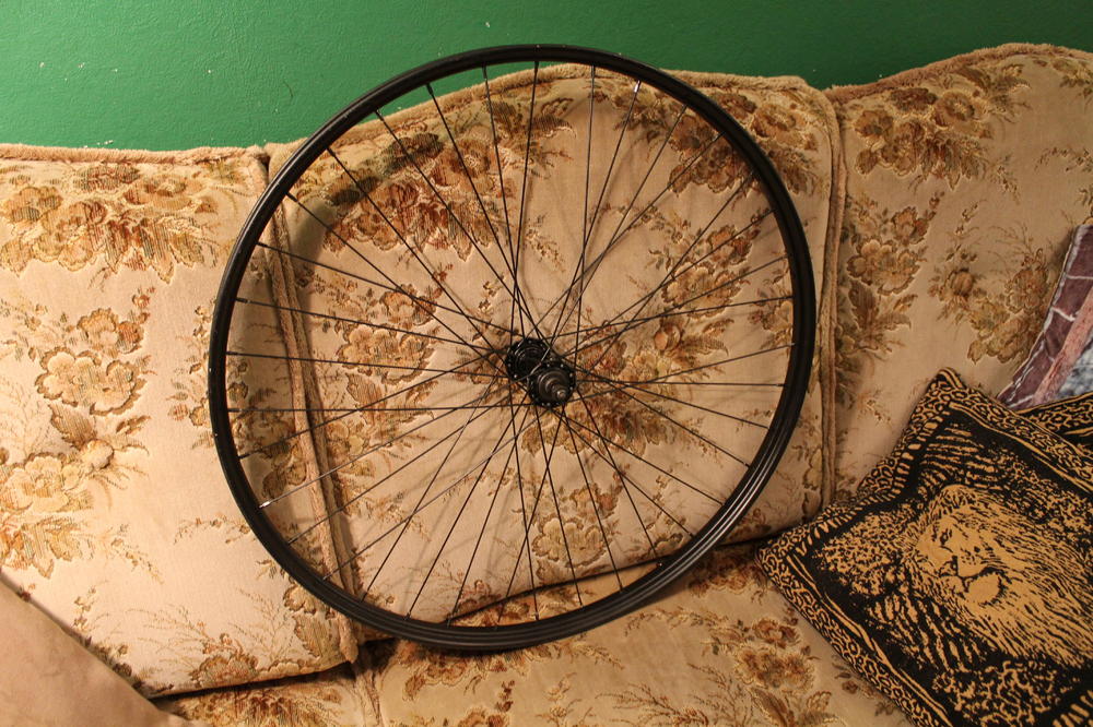

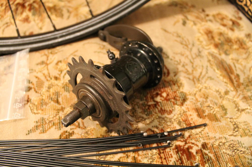

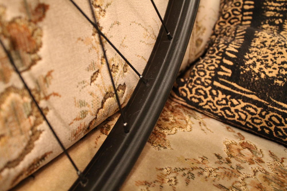

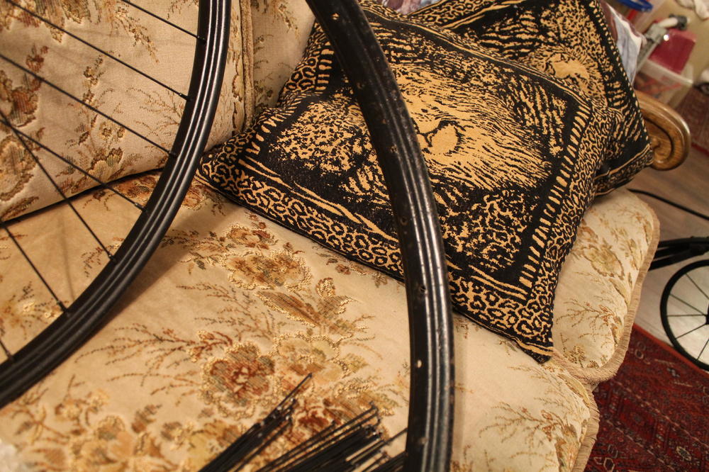

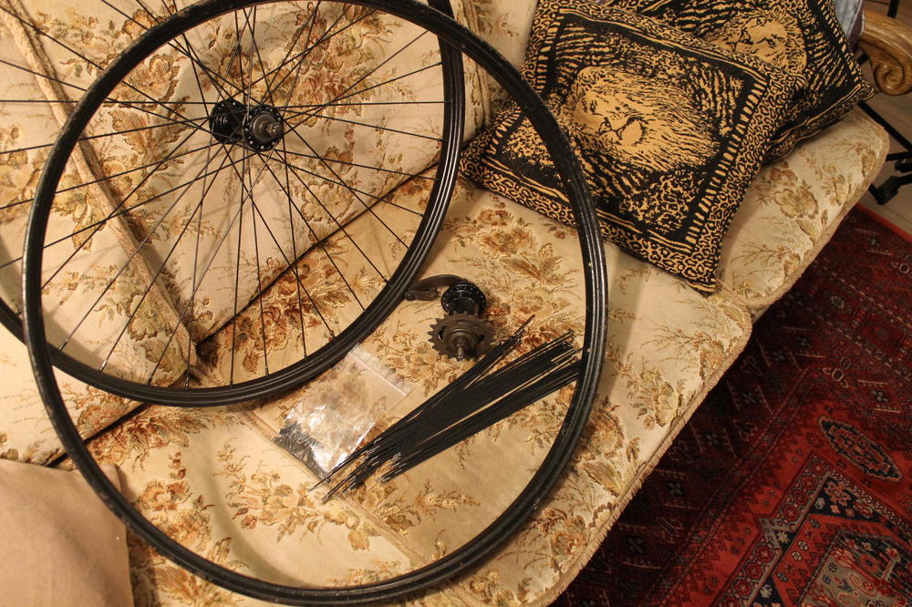

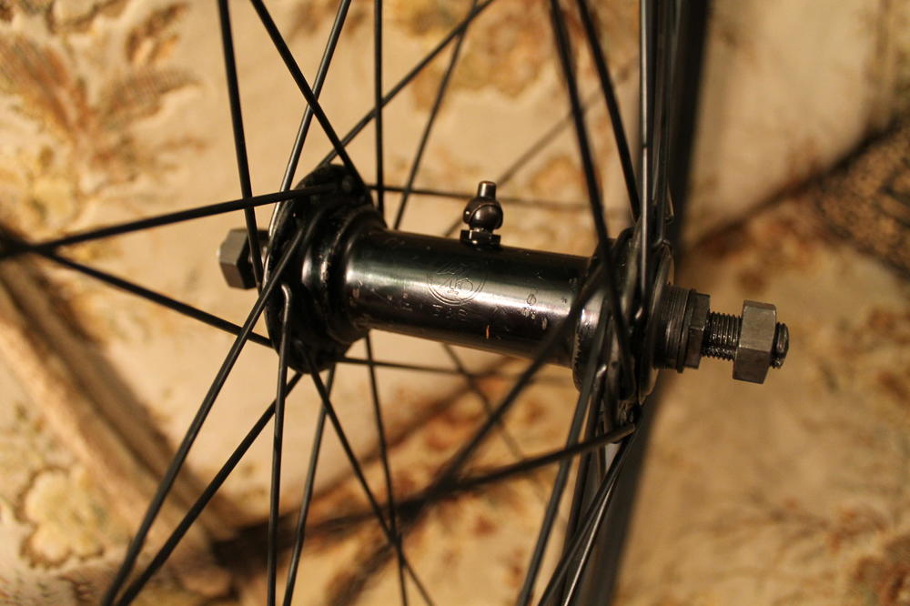

I found a pair of original Wehrmacht reinforced rims for beaded edged tires, new black spokes, both original wehrmacht specification wheelhubs in Germany for the Achilles.
So I have actually learnt how to re-spoke bicyclewheels in the process.

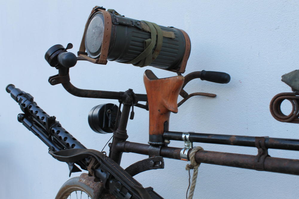

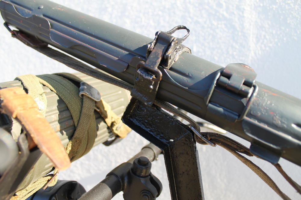

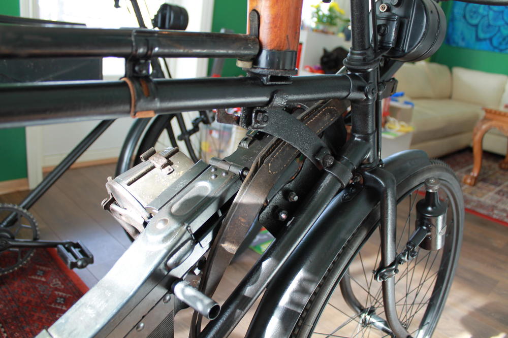

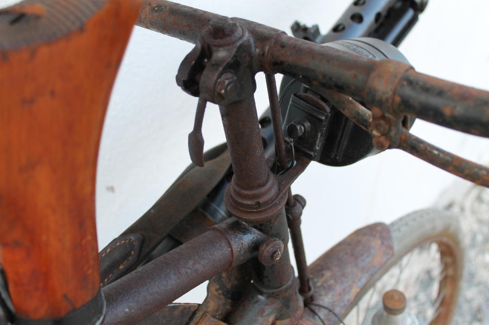

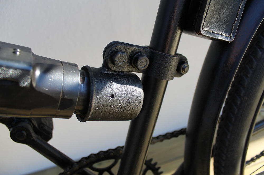

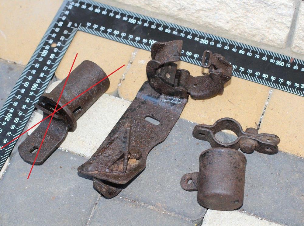

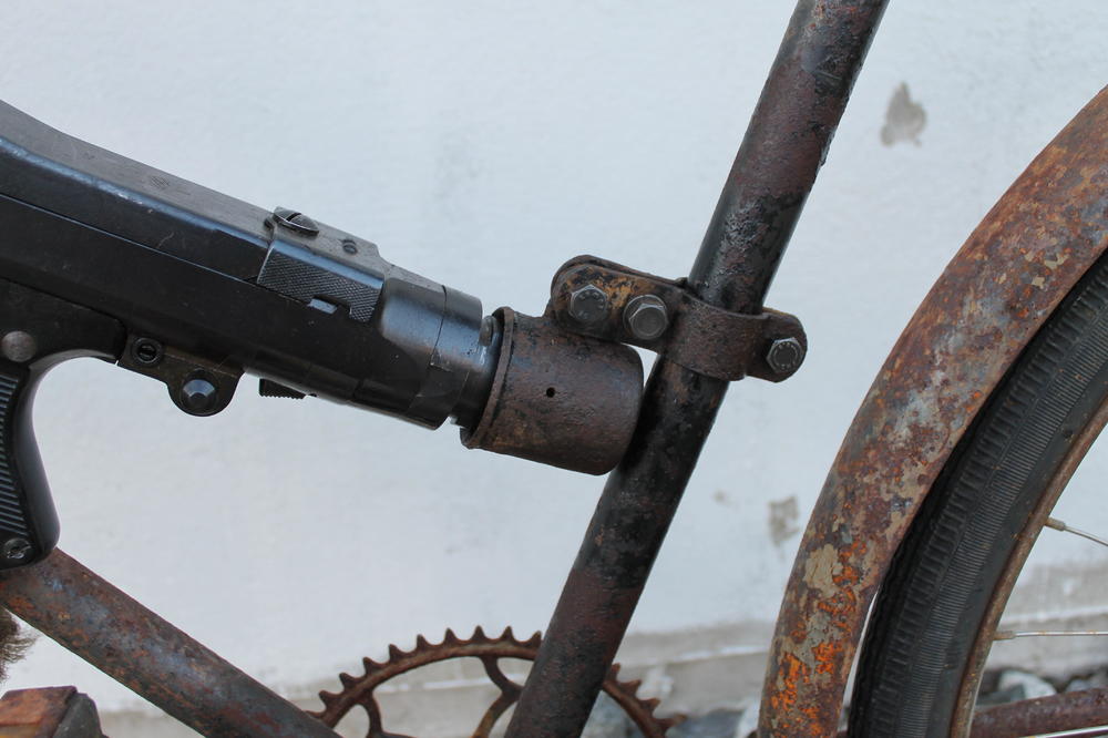

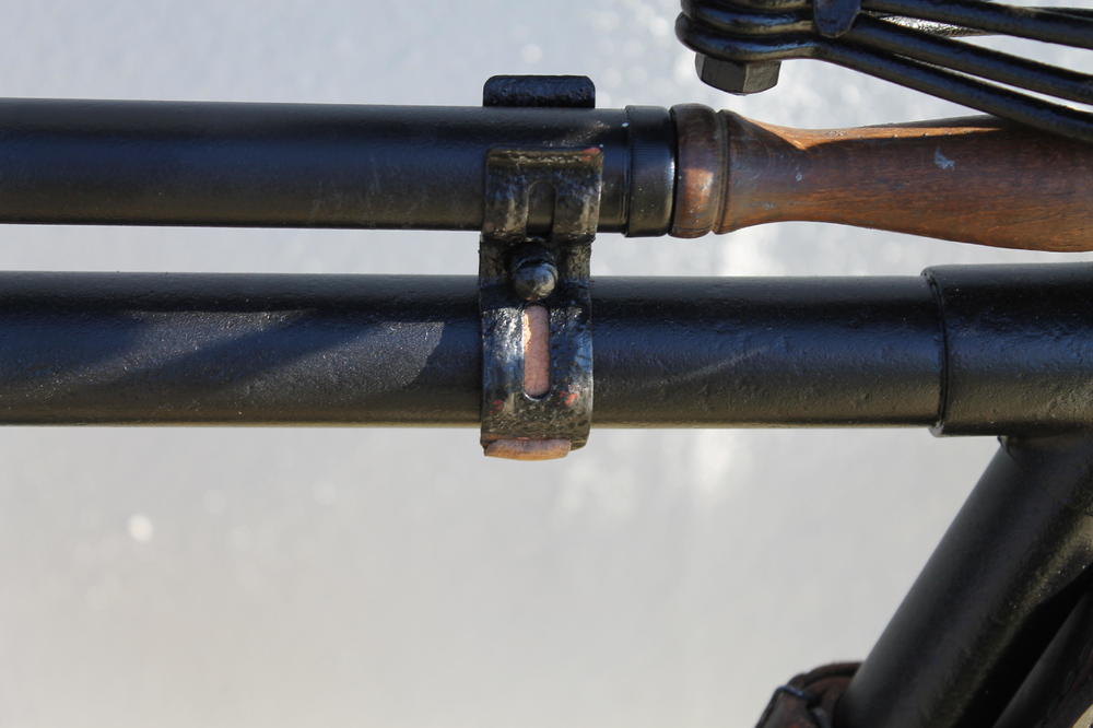

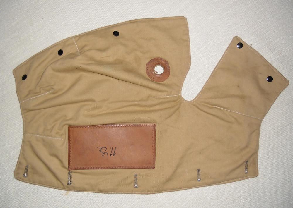

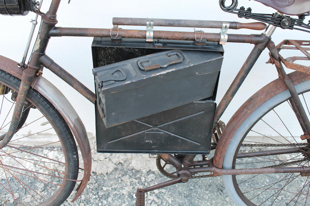

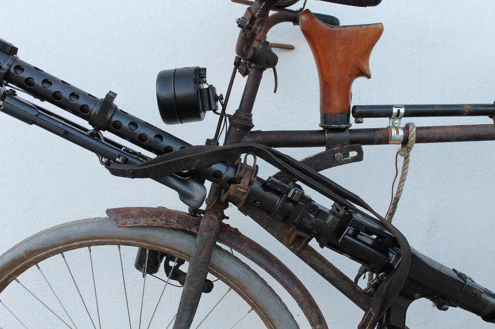

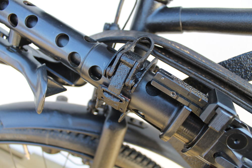

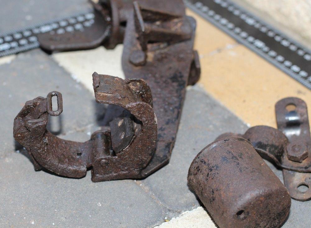

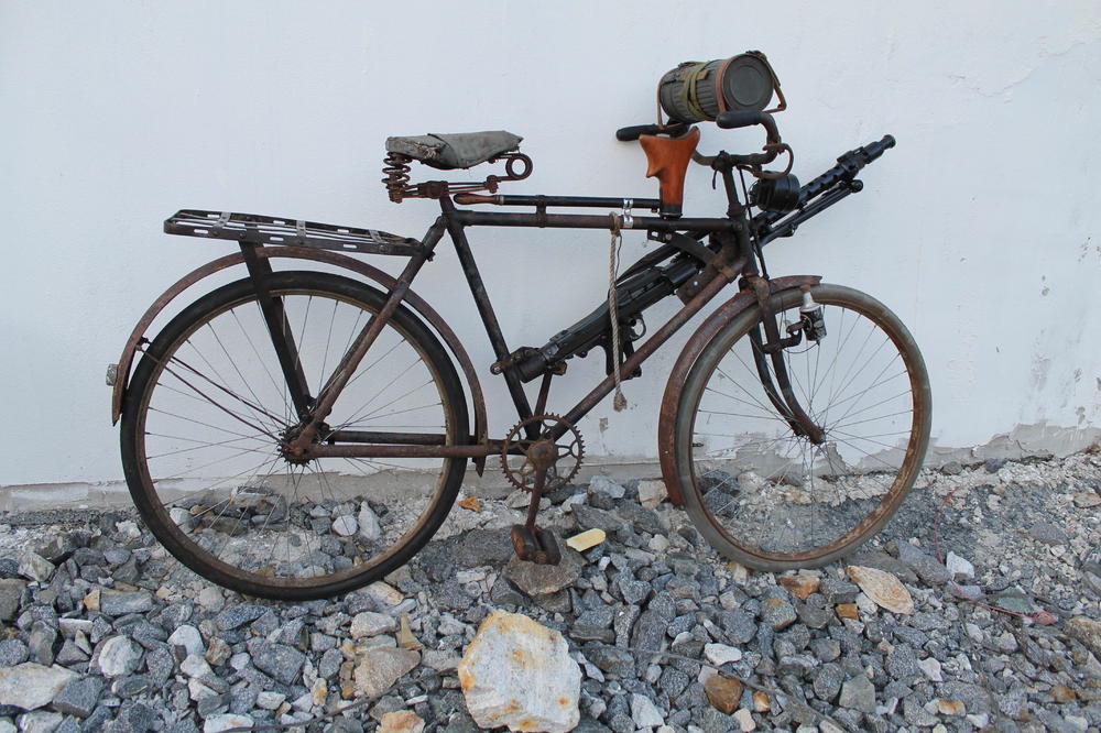

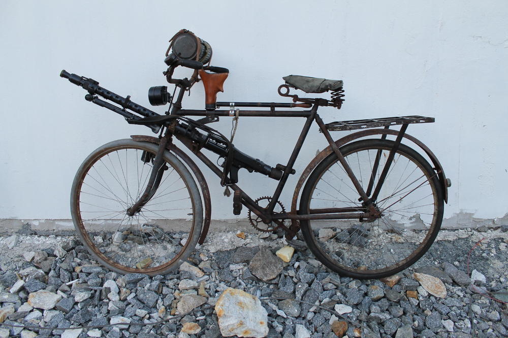

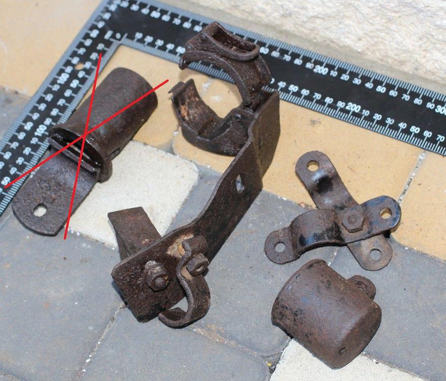

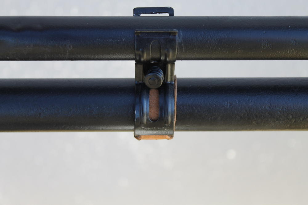

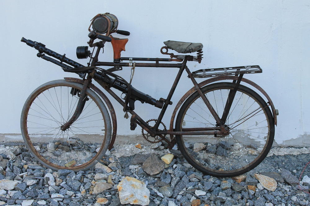

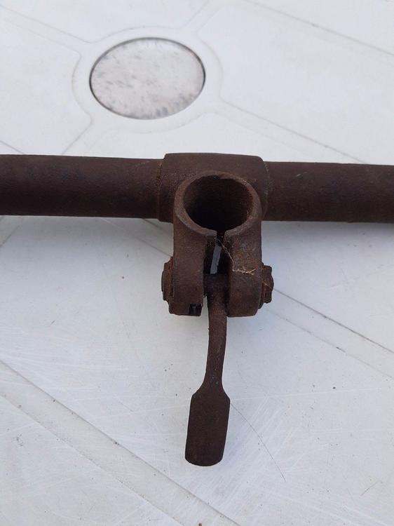

And from the battlefields at the eastern front - and a couple of russian fellows who do metaldetecting in russia, and sell bits and pices on ebay, I got parts for the original bracket system, to mount a MG34 on the bicycle frame.
And I thought What the hell - this can be the coolest thing ever..

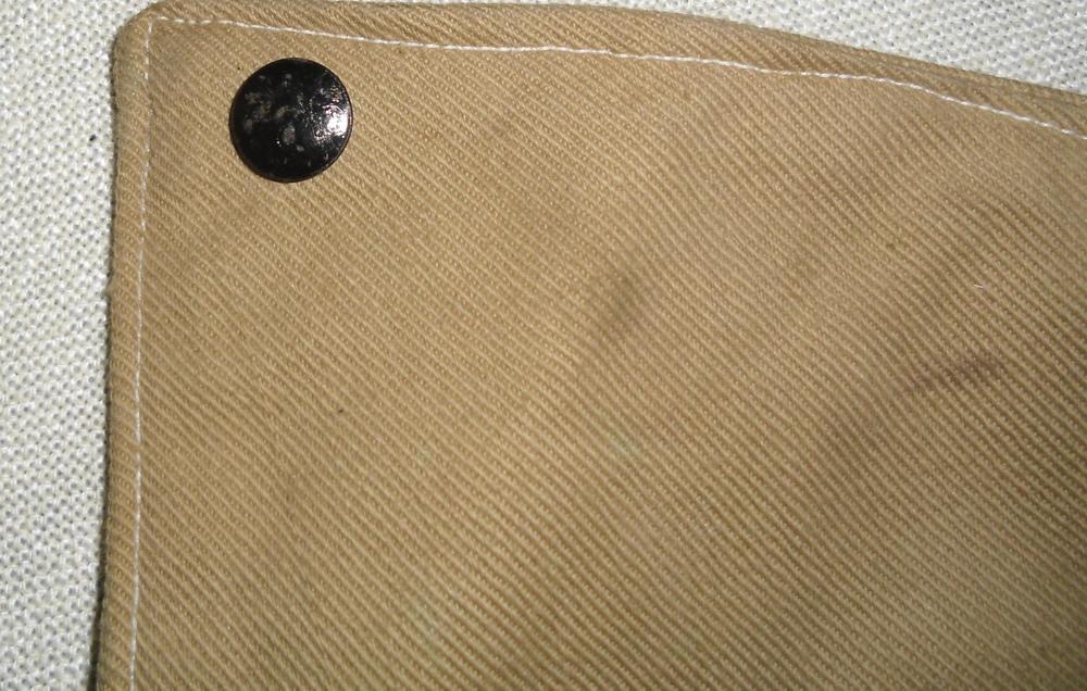

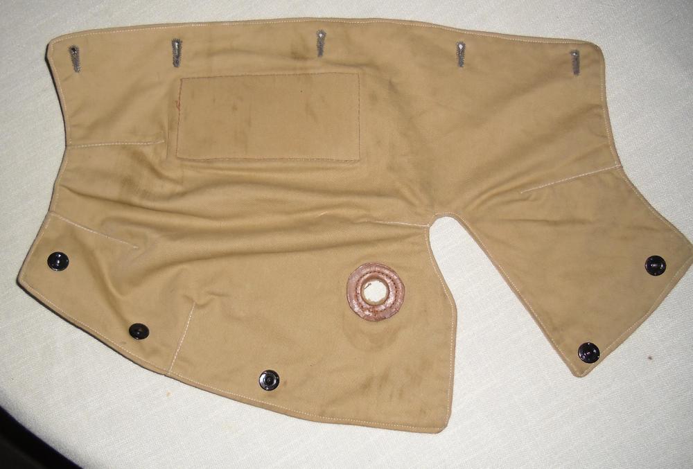

now that is interesting as I have that cover for the MG34/42 and it came from the same barn as the two A frame assault packs i just posted, I will have to dig it out.
Have you restored the clamp part as it looks like that may have been a bit tricky?
  • Like 2
Everything was a bit twisted and bent, But I have straightened everything out.
If you find your systemschütz (mg34 cover) be sure to post pitures of it. These are heavily reproduced, and originals are very few and far between.

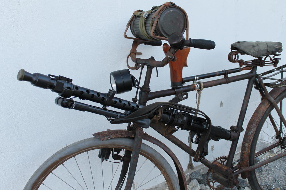

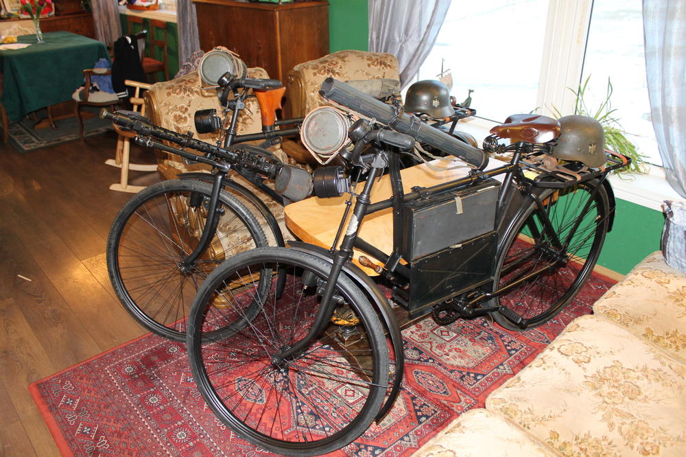

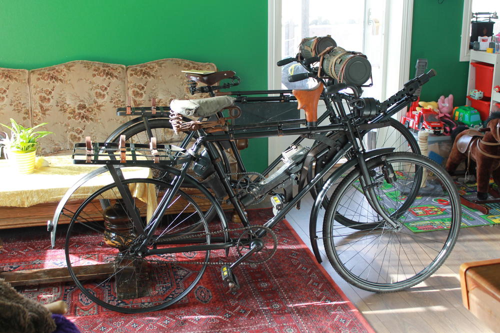

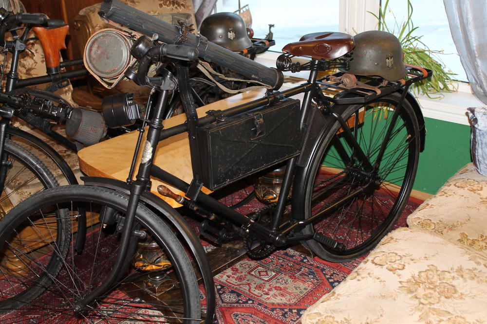

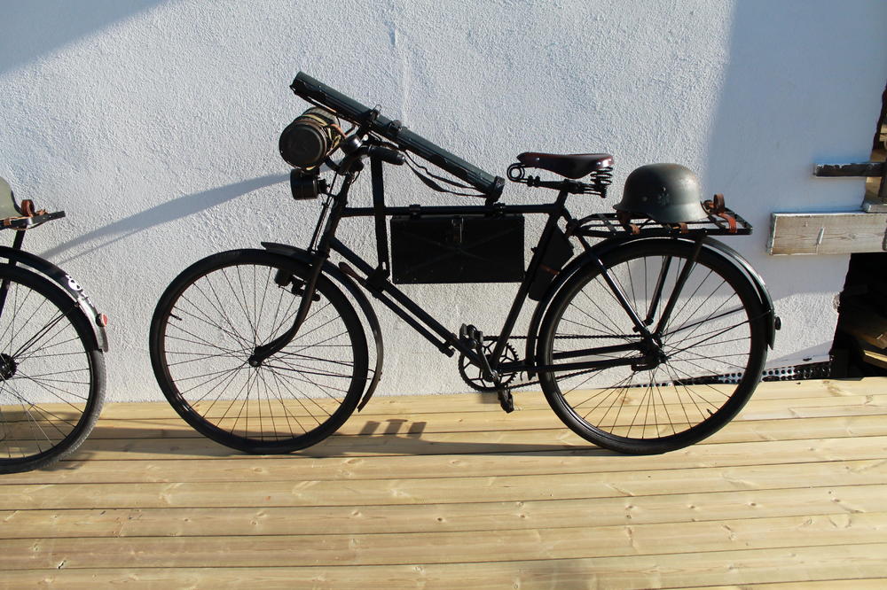

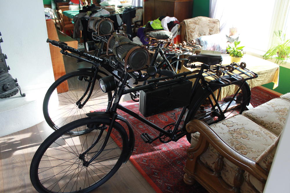

Ok. Fast foreward to February 2018. More original parts has been found.
I just had to try to put these things together before embarking on the taking-everything-apart-and-sandblasting.
The wheels that was being prepared for the Achilles, were not put on, but a pair of other civillian wheels.
Like I said these came out of the same barn as the assault packs in the 80.s -90,s.
I dont doubt they are easily copied. what isn't?
But back then things were not so copied as today.
Bjorn,
here you go, he gave me one of each item the cover the blue assault pack and a grey/green assault pack. They were all together in a barn for a very long time and I think he got about 10 of each, I always remember a pile of them.

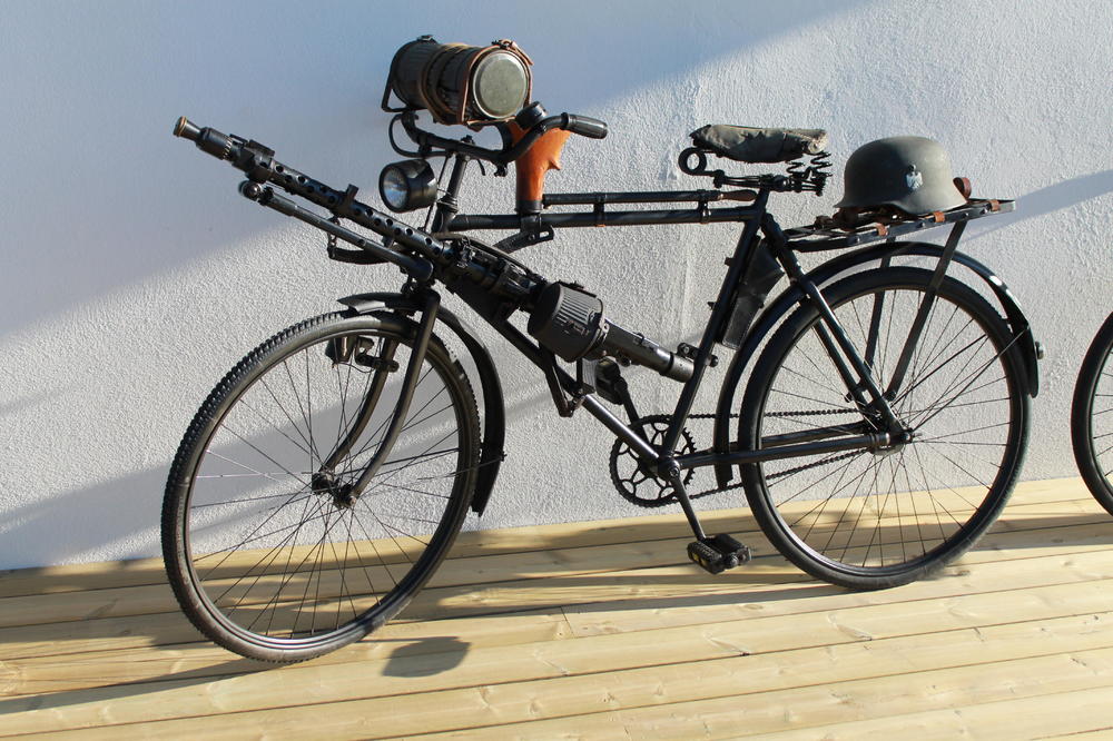

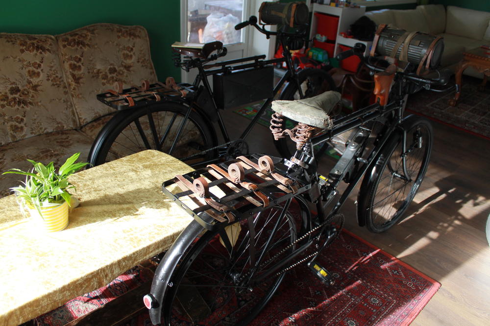

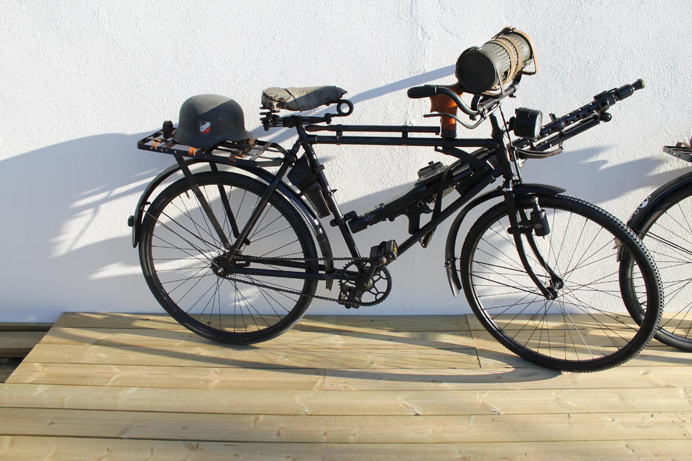

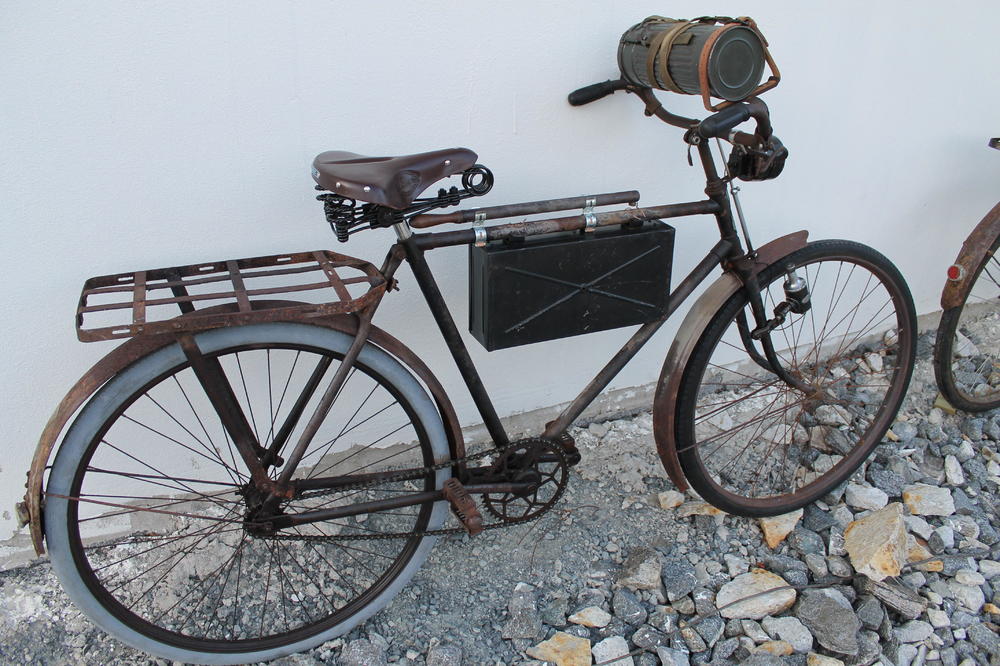

7th of April 2018.

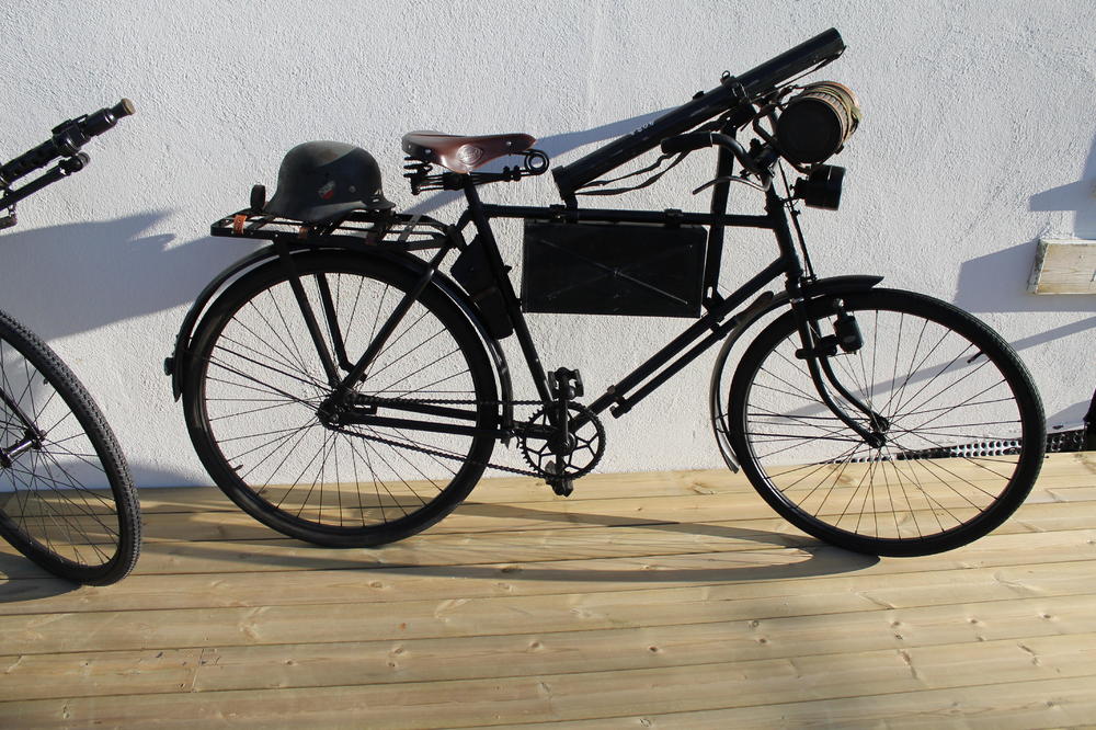

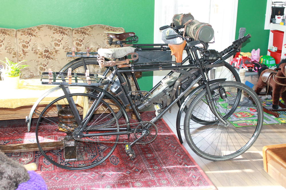

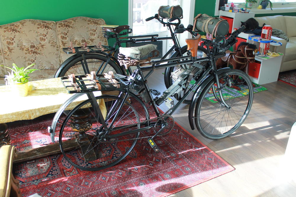

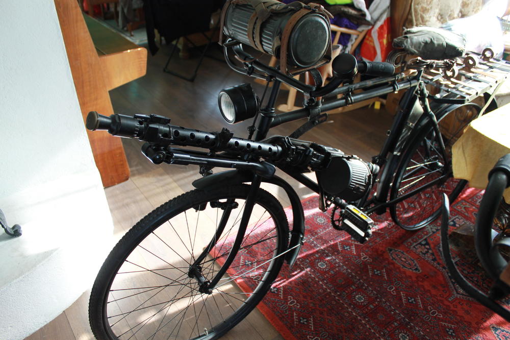

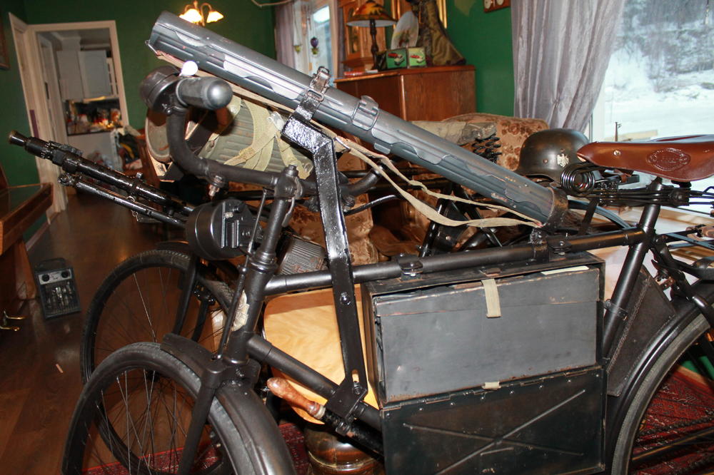

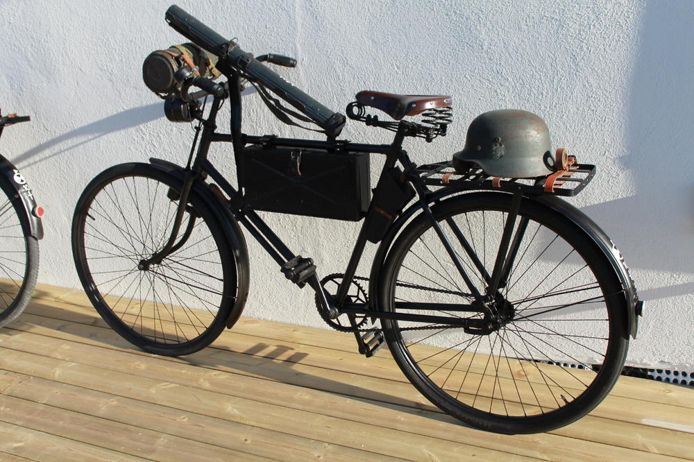

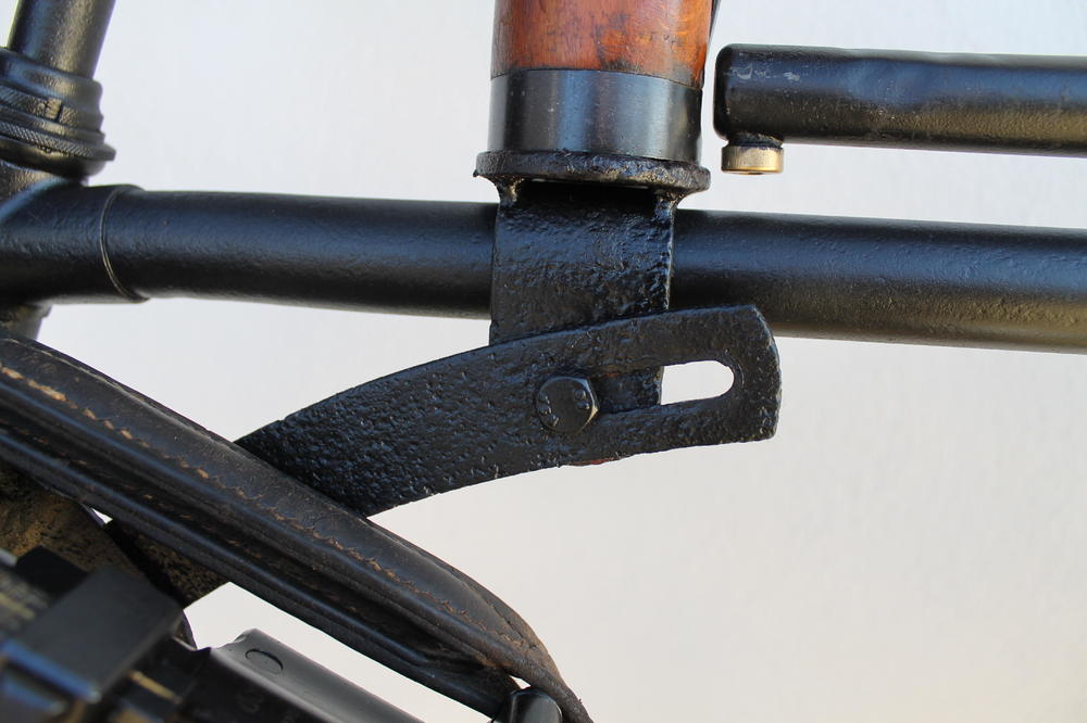

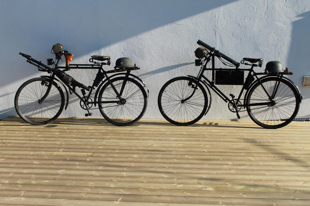

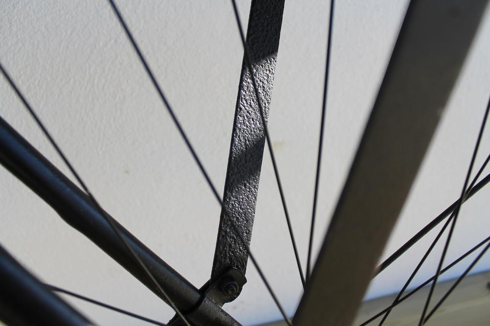

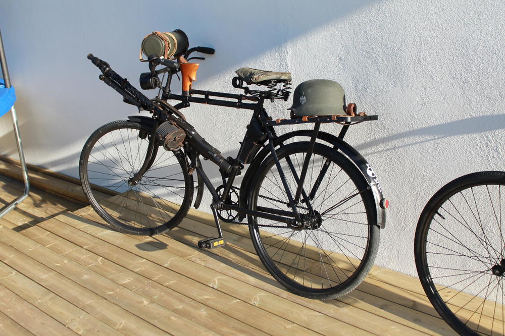

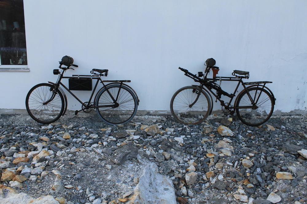

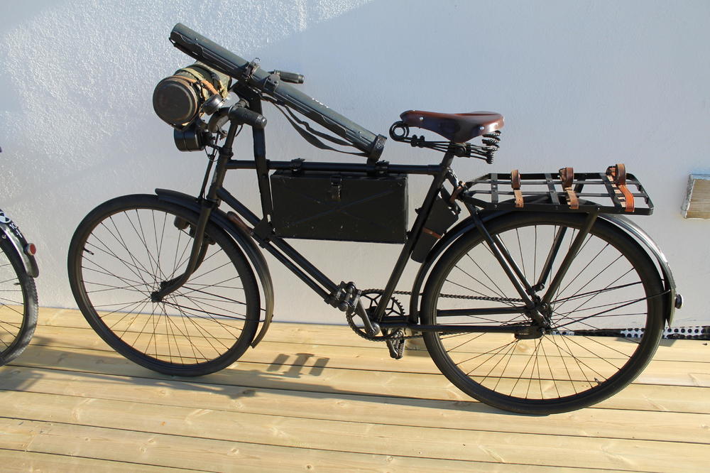

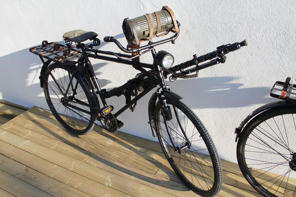

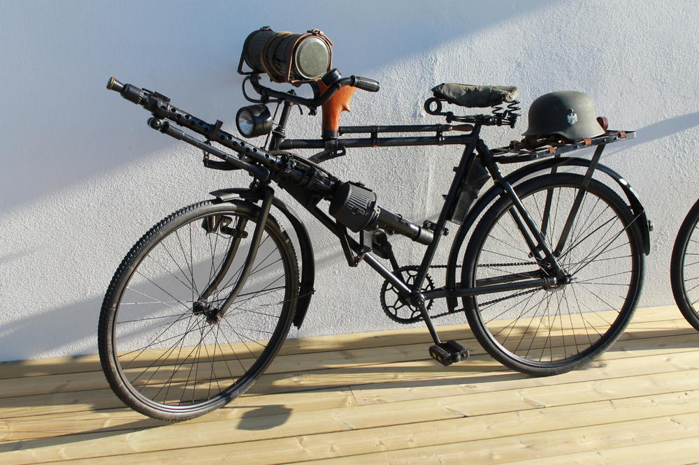

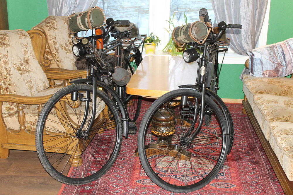

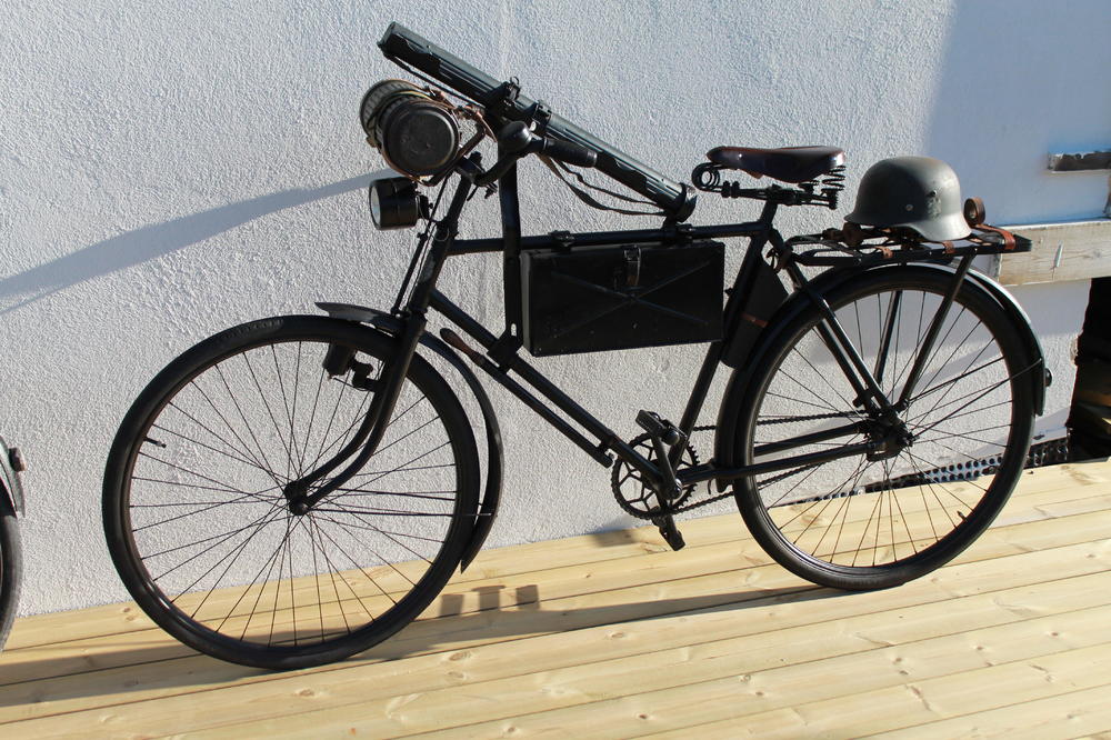

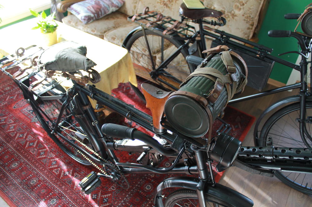

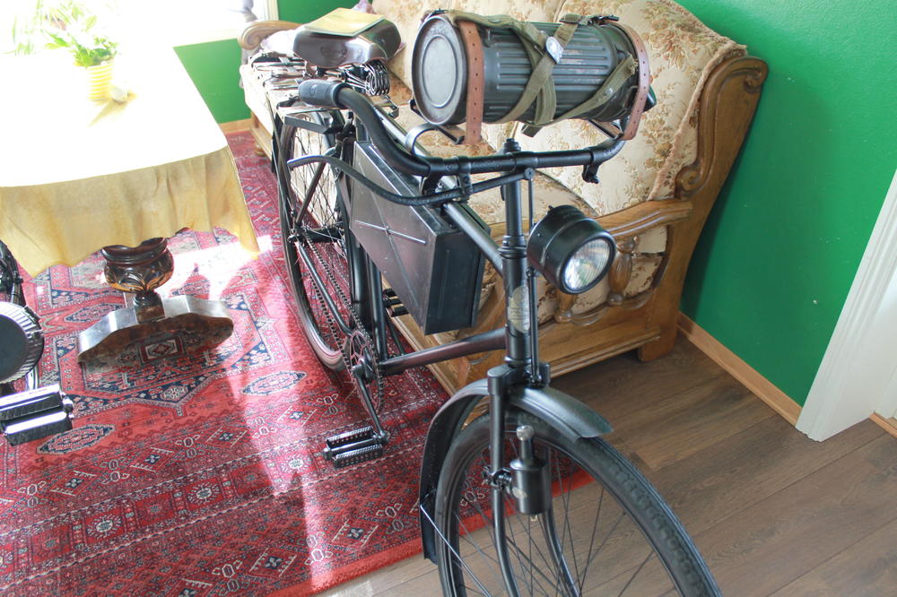

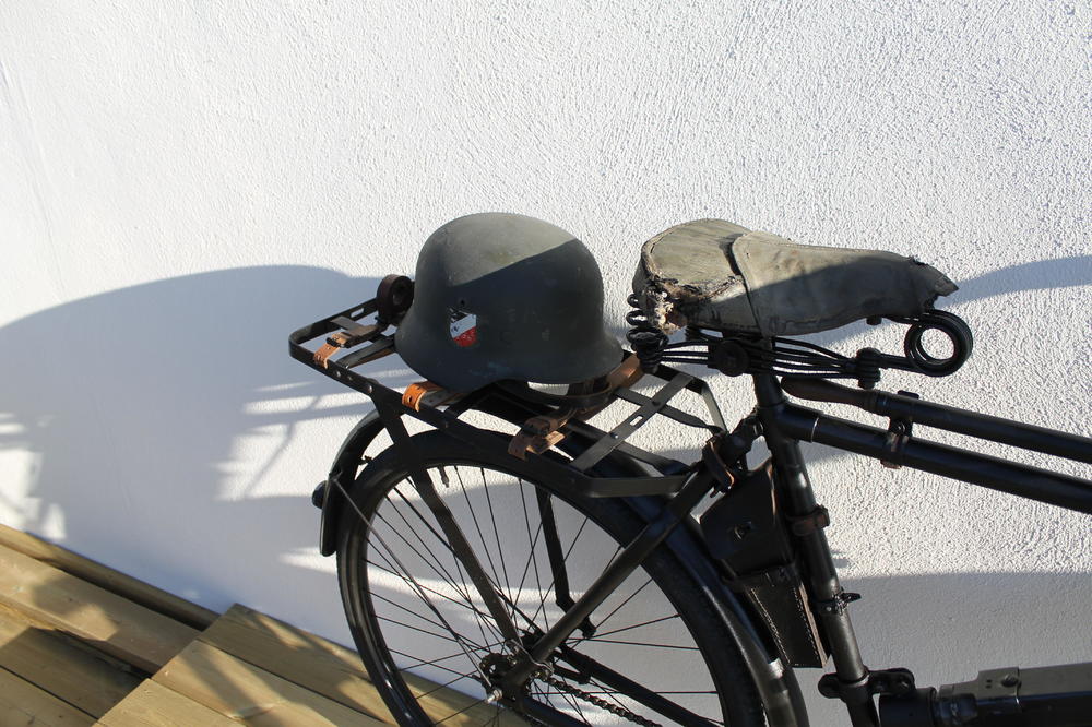

Everything has been taken apart and sandblasted and repainted in a correct low-gloss satin black paint.

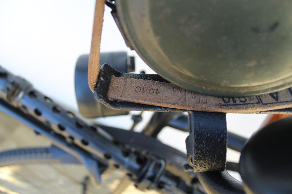

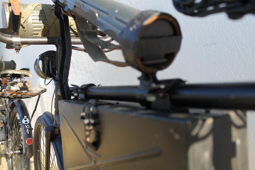

I have found a original bracket and cup for the spare barrelcontainer for the MG34, to put on the Patria WKC bicycle.

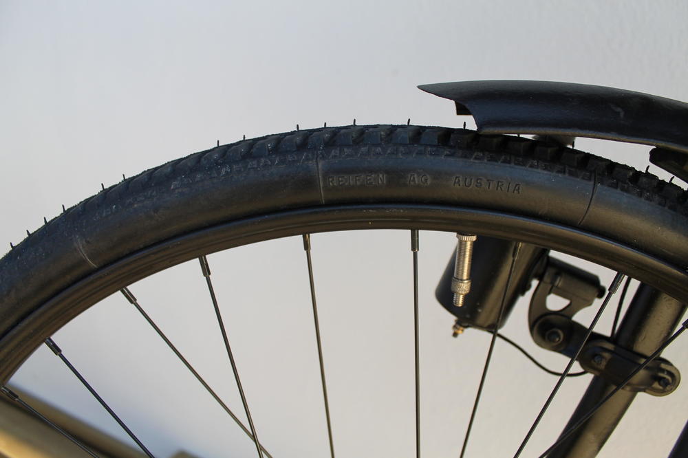

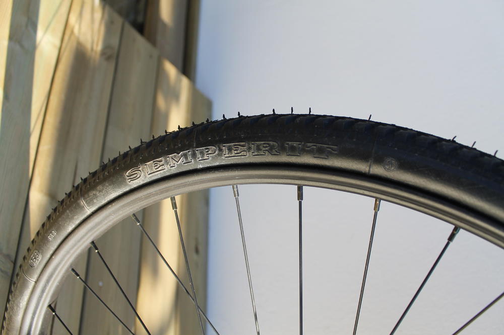

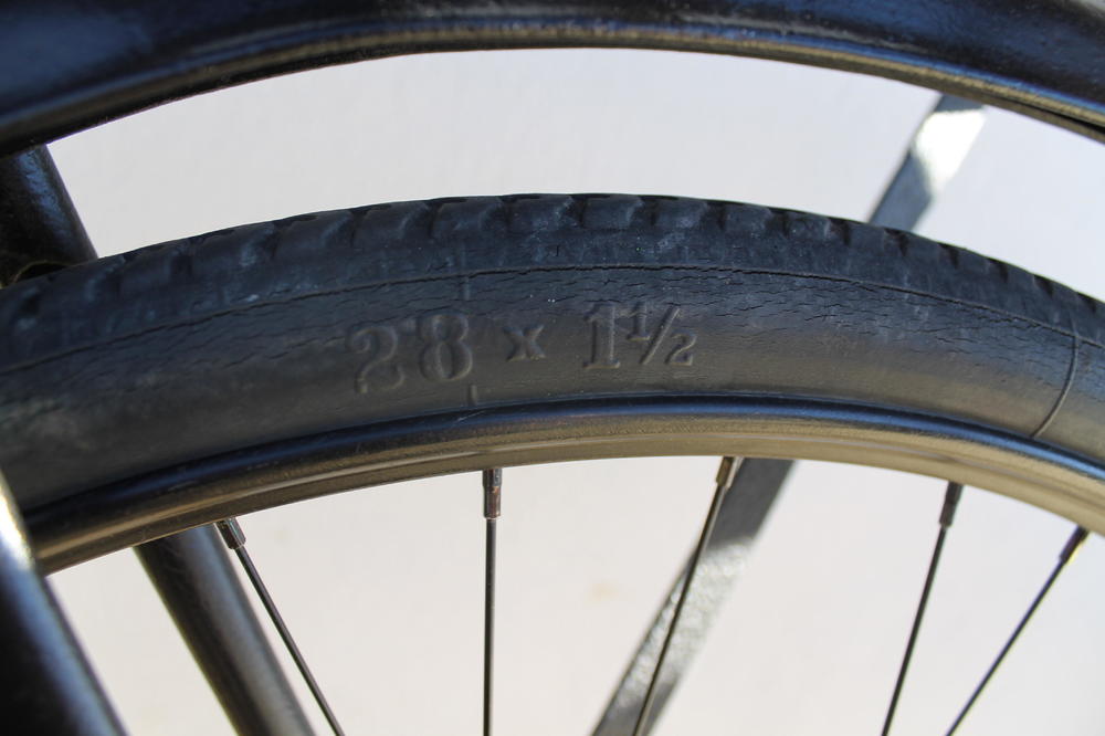

New old stock bicyclechains from the 1930's are mounted. I had a hard time locating original vintage austrian Semperit beaded edge tires. These have not been in production in the last 70 years. At the time that I took these pictures, I had located one new old stock tire, and put on the front wheel.
Thank you so much guys. I really appreciate your comments.
It has really been a costly and time consuming job, getting them to where they are today.
 I'm sorry, but I really dont have the time to take on commision jobs. I have my work, my family and I'm expanding the house as well ( I've built it my self ) And I have a few other ongoing restoration projects that I need to finish.

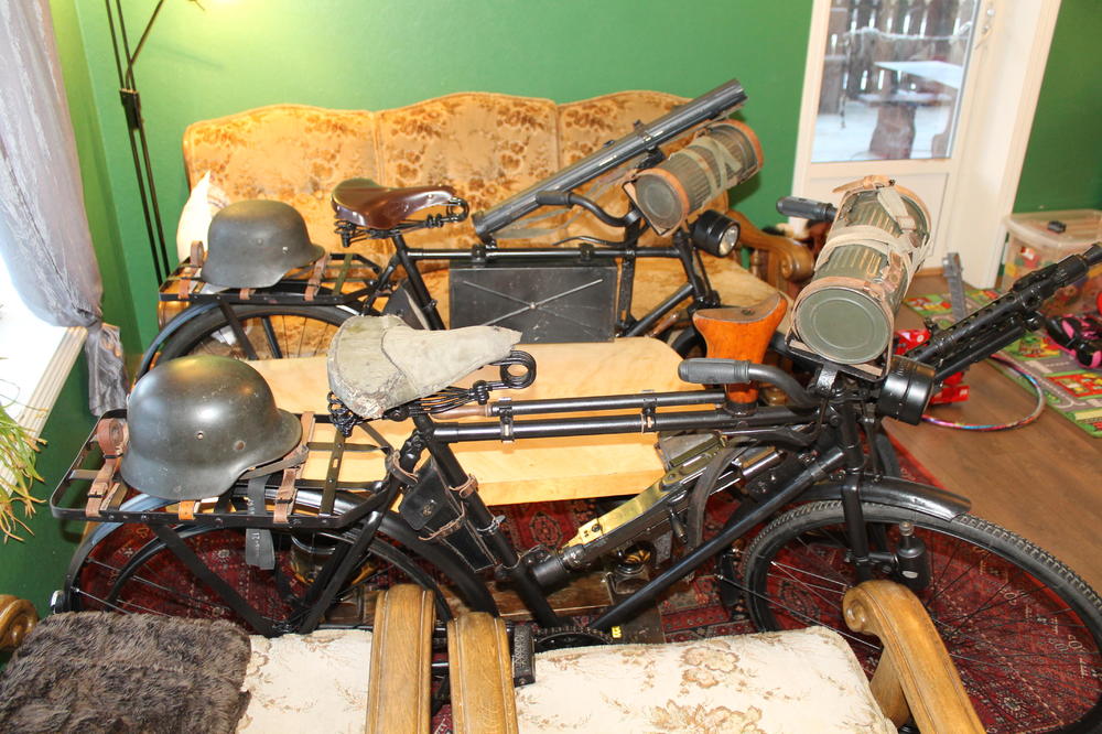

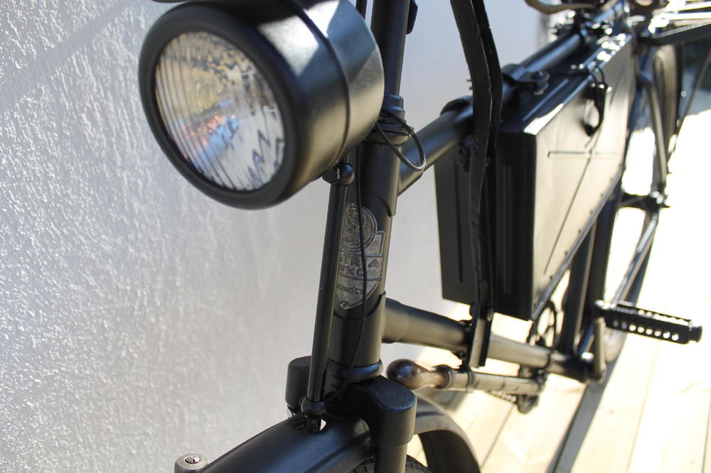

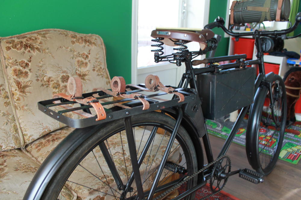

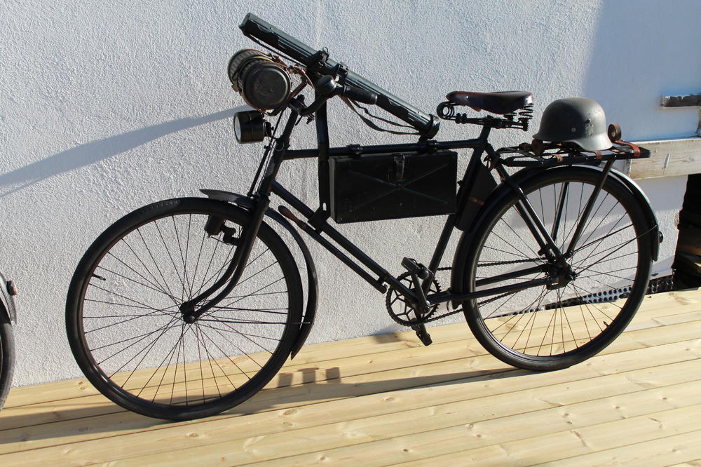

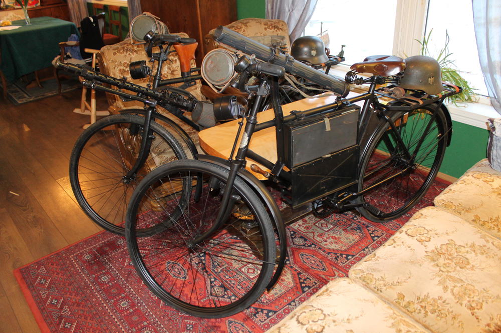

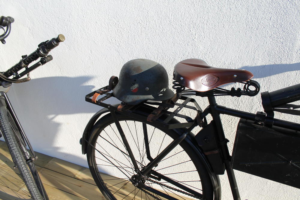

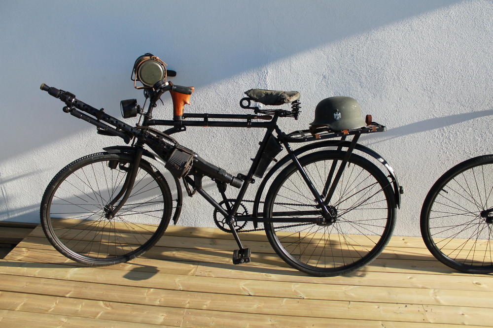

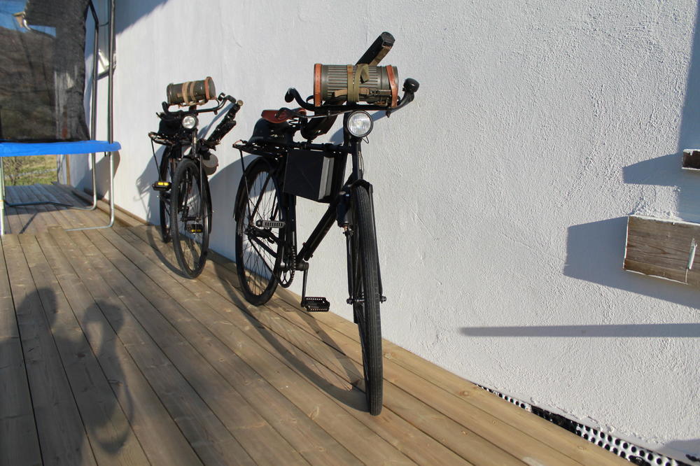

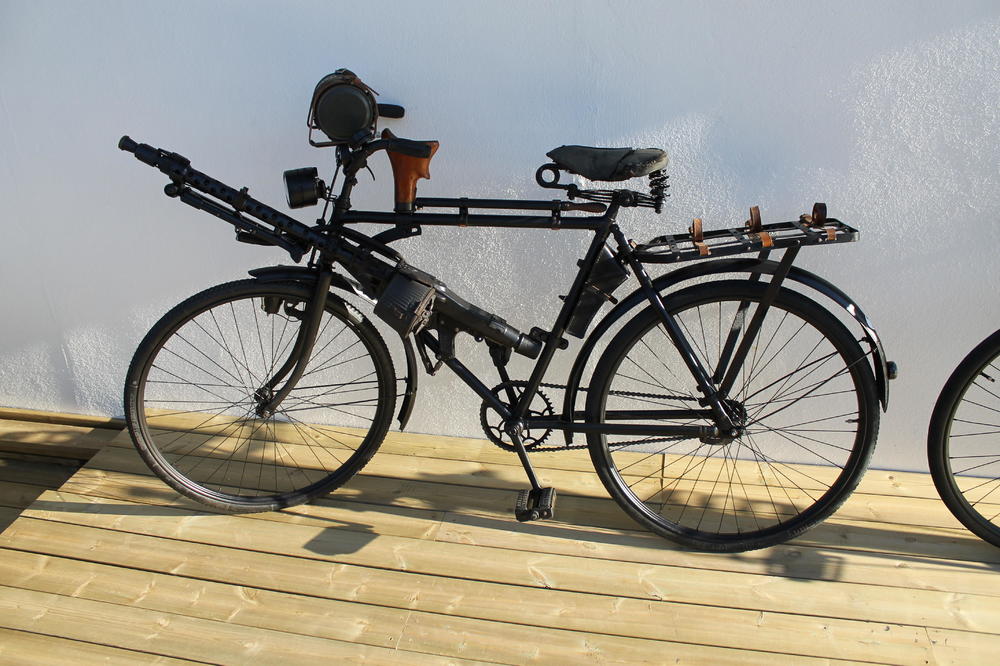

The last couple of series of pictures, taken 10th of May 2018.
I have not used a single grain of filler, when restoring the bicycles. They are old and have survived a world war and decades of neglect in the time after. All the rust have been mechanically removed, but the traces of time should still be showing. I have used original parts as far as I could in the process.

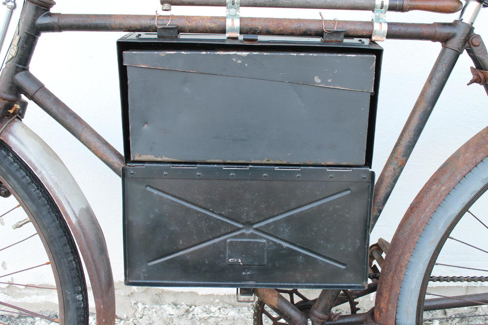

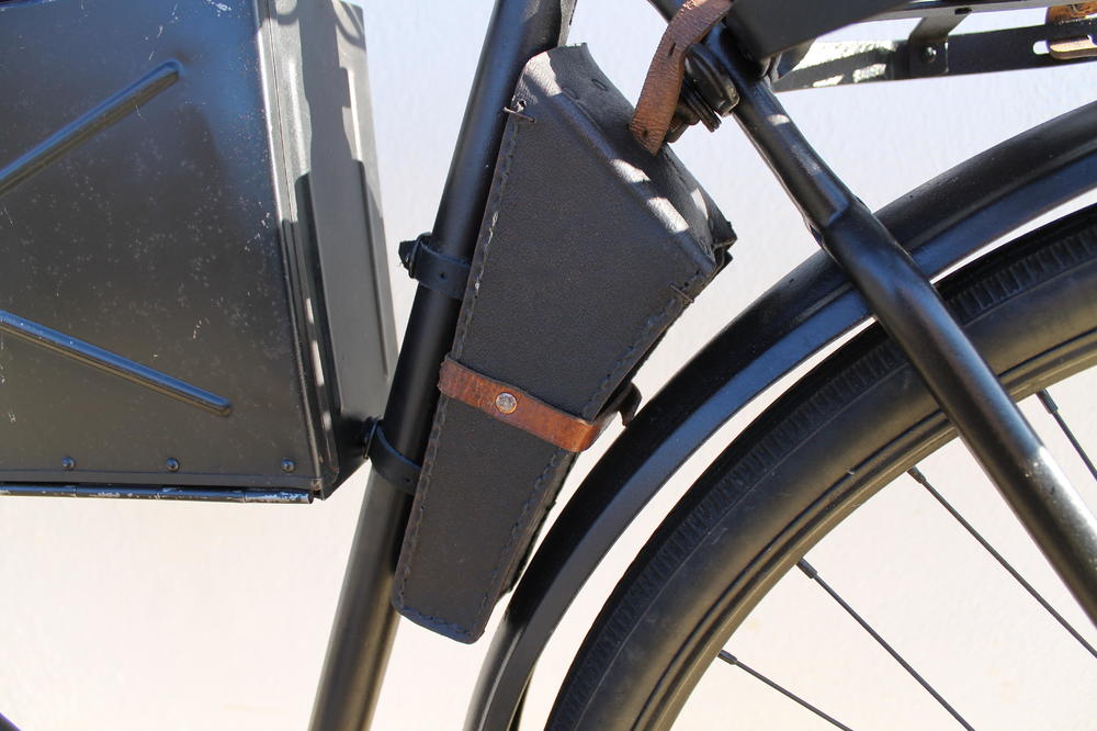

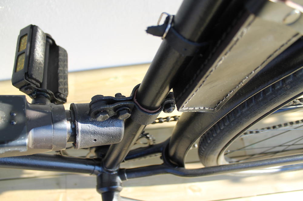

Remember this, from the earlier pictures? It is the very same toolbox that was hanging in the exact same place in the frame when I found it.
All the seams were rotted away, and it was falling apart. The kunstleder has been treated and the everything has been resewn by hand. New straps are added.

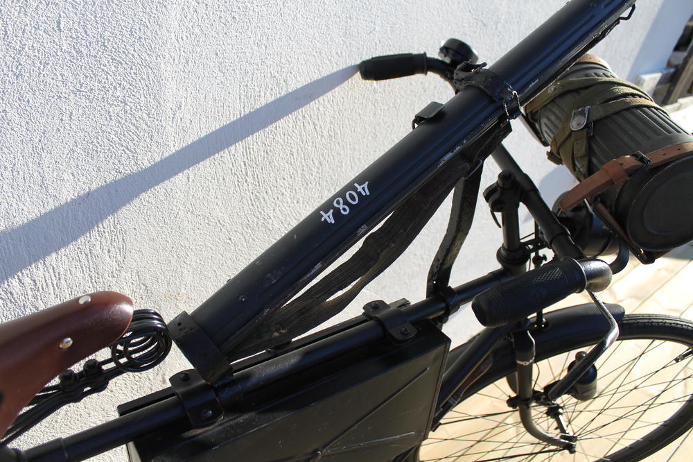

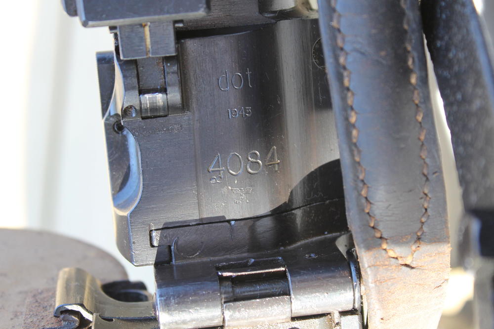

And I have painted matching serial number on the spare barrel container - 4084, same as the Snr. on the MG34

And the last pictures (I think) 🙂

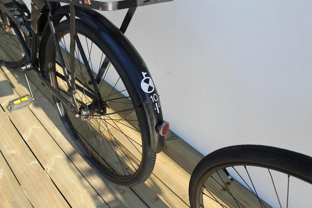

The last series of B/W pictures are taken here in Norway, during the german invasion in April 1940.
I have copied the tactical markings from the bicycles rear mudgards from these pictures. The unit these pictures come from, are of a Radfahr Aufklärungs-Abteilung, belonging to Panzerabwehrabteilung 26 of Infanterie-Regiment 362
