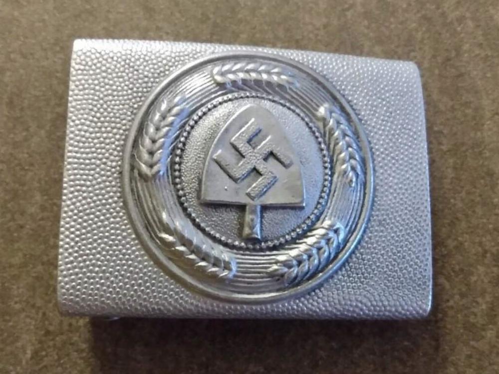

Another member and myself recently had a discussion on RAD buckles and how some are faked. First introduced in early 36' the buckle replaced the old FAD variants and adapted a new uniform look, designed by Ergon Jantke who was already a fixture in Third Reich as the "Technical Advisor" for the RAD high command designing uniforms, insignia and other items. The buckle was described as having the "New" RAD emblem of a pointed shovel surrounded by five ears of corn in a circle with a pebbled field, no lettering was visible. The construction was a one piece die struck aluminum and there were several manufactures, the most prolific being in the Ludenscheid area ie; FW Assman, Richard Sieper & Sohns, Steinhaur & Luck, etc; etc;

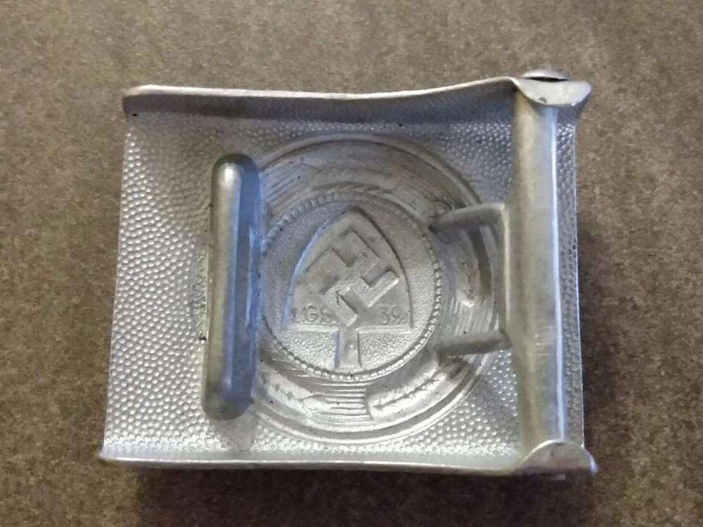

Another bad fake, this one is from Poland. Notice the RZM and M4 designation, first clue to a fake.

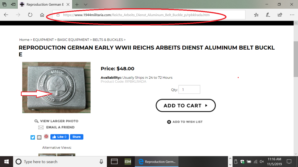

This one catches people out a lot..  A cast Gustave Brehmer, there is a identifier though, a cast "Flaw" under the Spaten, recently though the fakers I believe have corrected this impurity, either way they are still being sold as "Replica" but who is to say they don't fall into the hands of unscrupulous sellers on the internet or dealers asleep at the wheel.
