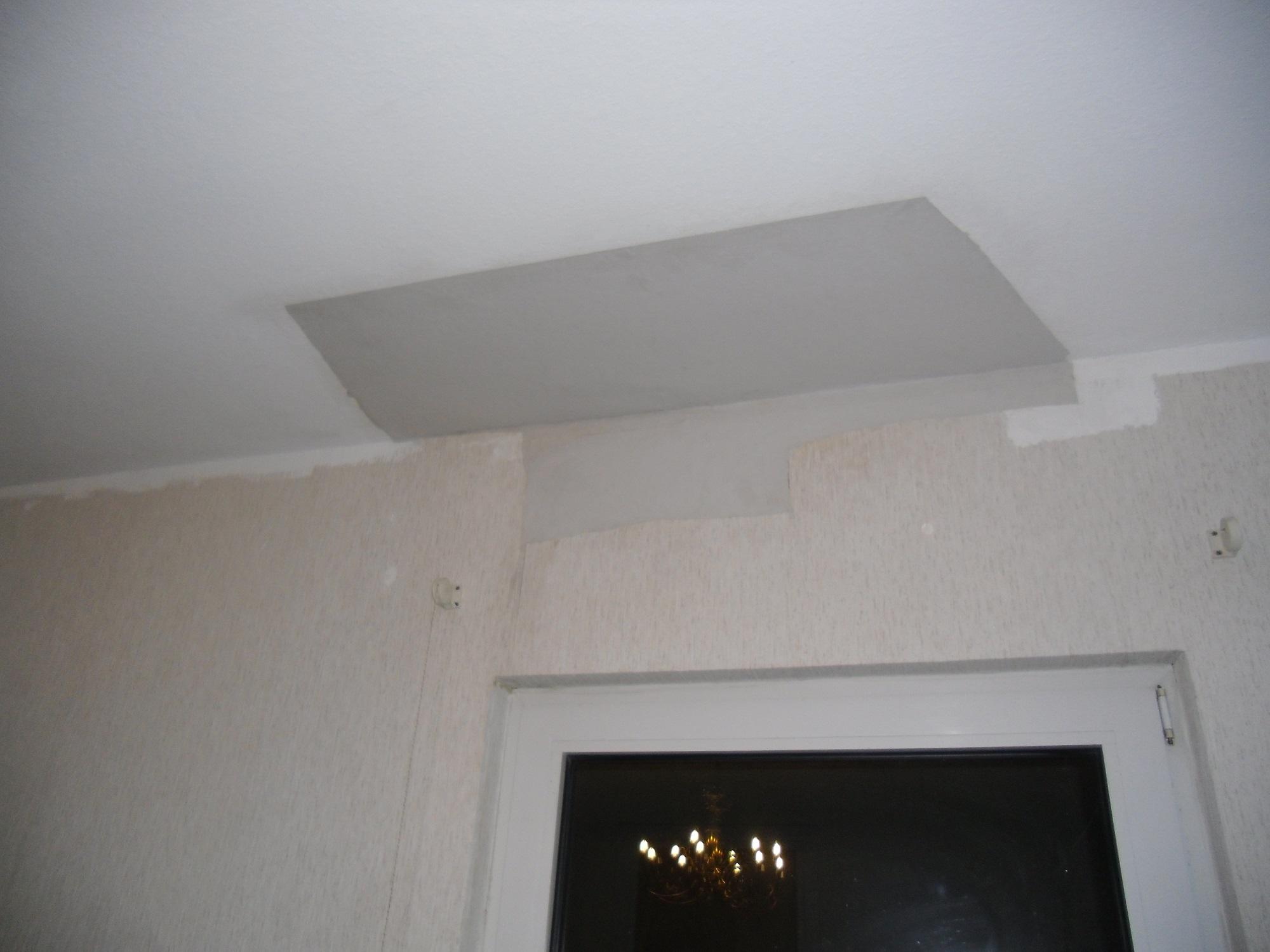

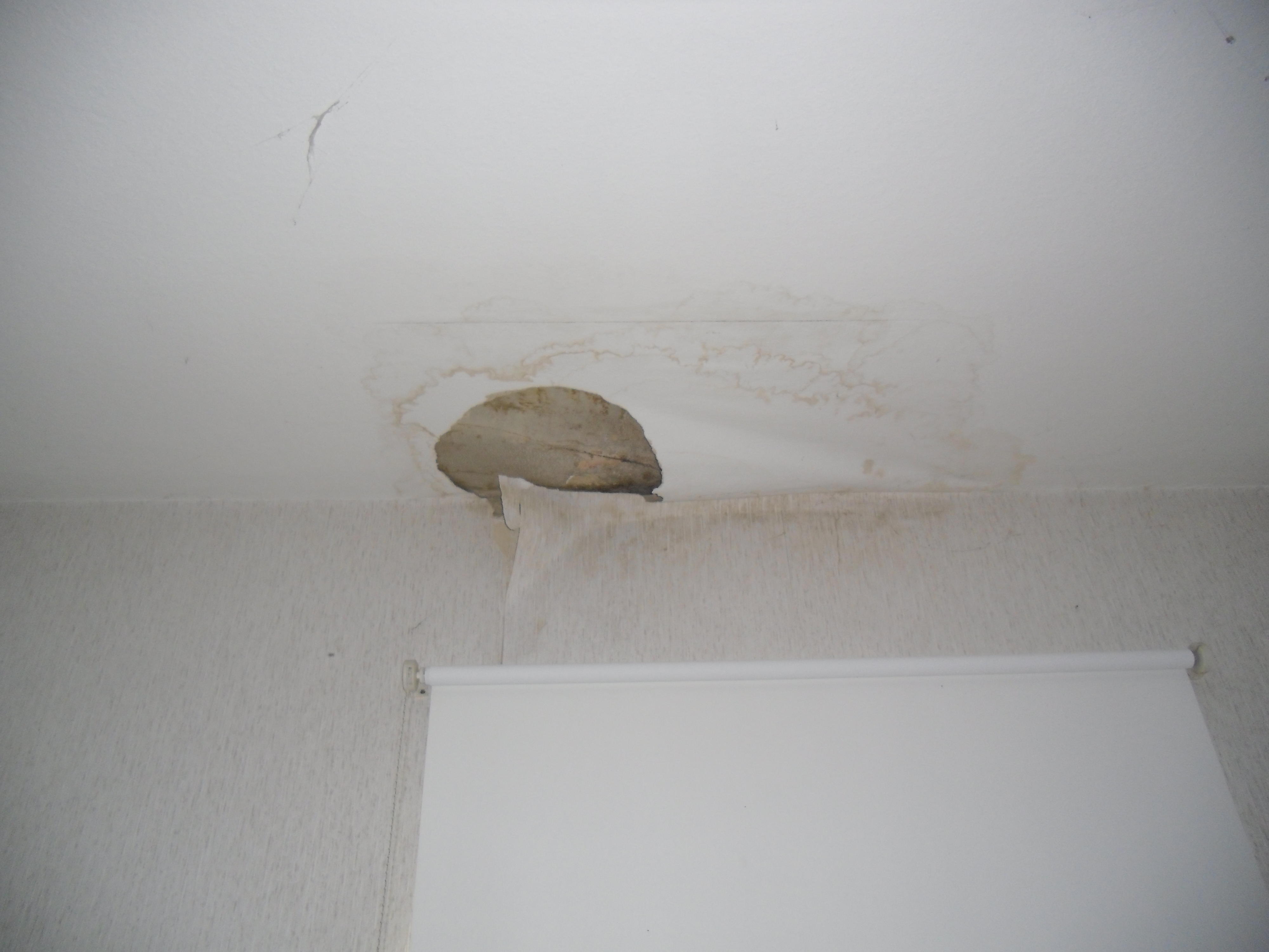

Richard Auld Posted November 27, 2019 Author Posted November 27, 2019 Val, Too dark for pictures outside, been on my arse with my back! This is under it where it is coming through. Finished clearing out the last bits and bobs ready to start painting/repairing. Just found my old note book from 2003 or 2007 in Iraq! Will post it up in the correct section. Rich

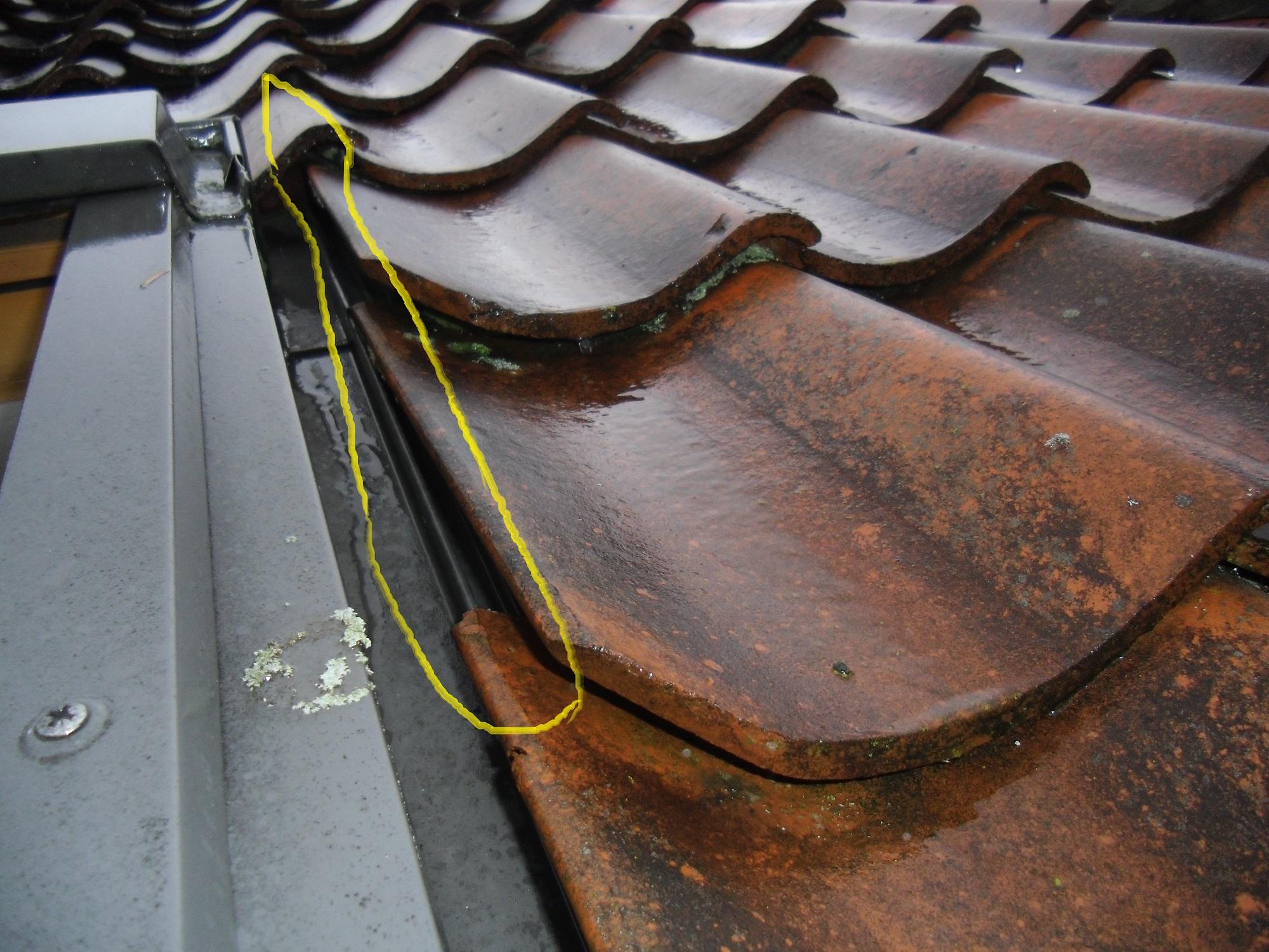

Richard Auld Posted November 28, 2019 Author Posted November 28, 2019 Val, I think with heavy rain it is just comming down like a river so I need to join the frame to the tiles with the foam ? The tile highlighted does not look straight. Rich
val Posted November 28, 2019 Posted November 28, 2019 52 minutes ago, Richard Auld said: Val, I think with heavy rain it is just comming down like a river so I need to join the frame to the tiles with the foam ? The tile highlighted does not look straight. Seems like you found the culprit.
Davejb Posted November 28, 2019 Posted November 28, 2019 I thought the tiles had to cover right up to the window frame and just extend over the lip so that water would rundown the window and not leave an open gap, plus it looks like you have a section of frame that has a gap letting water in 1
Mike H Posted November 29, 2019 Posted November 29, 2019 Yes Richard I would say that's the spot. Tiles should overlap the window frame.

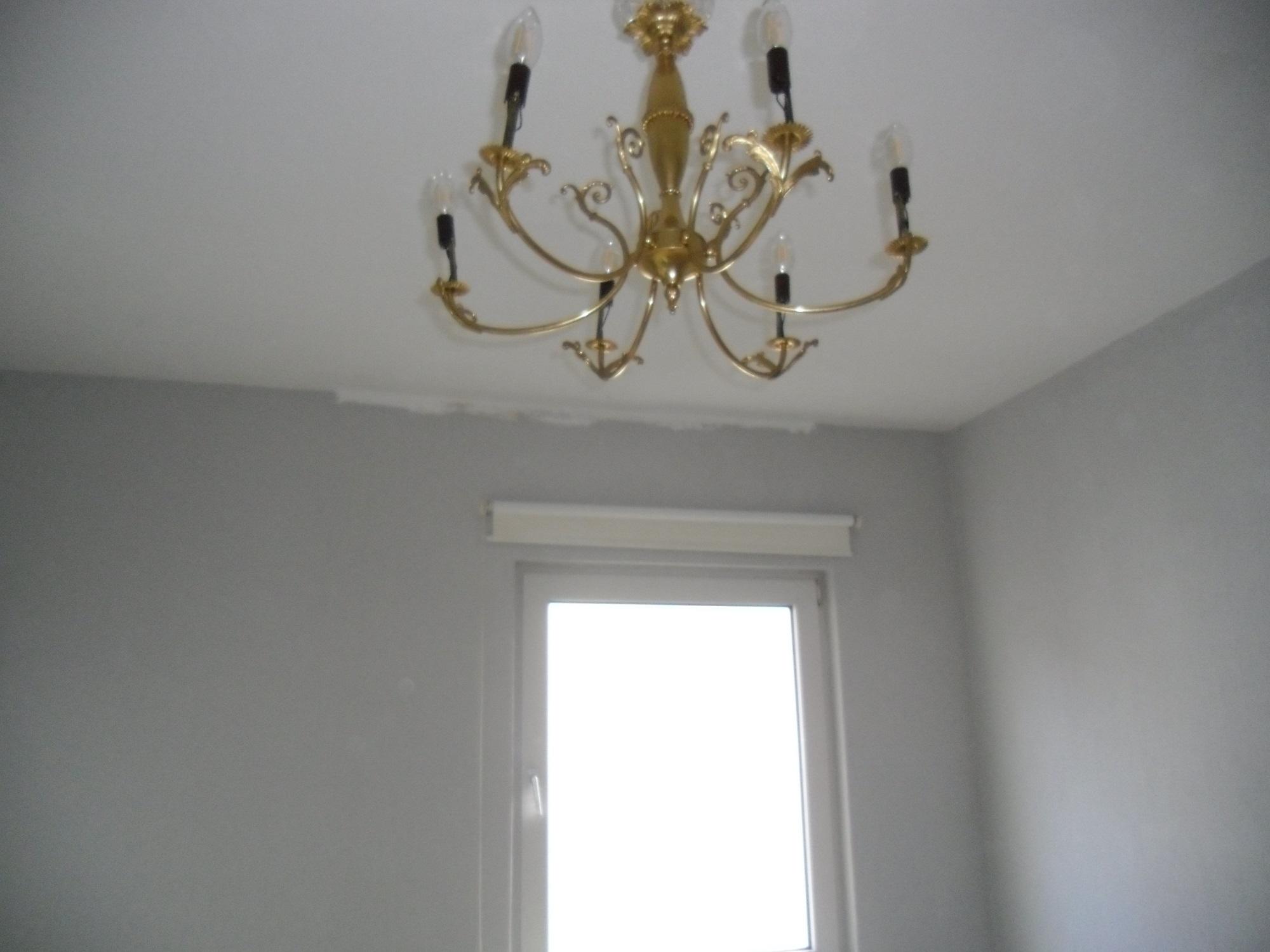

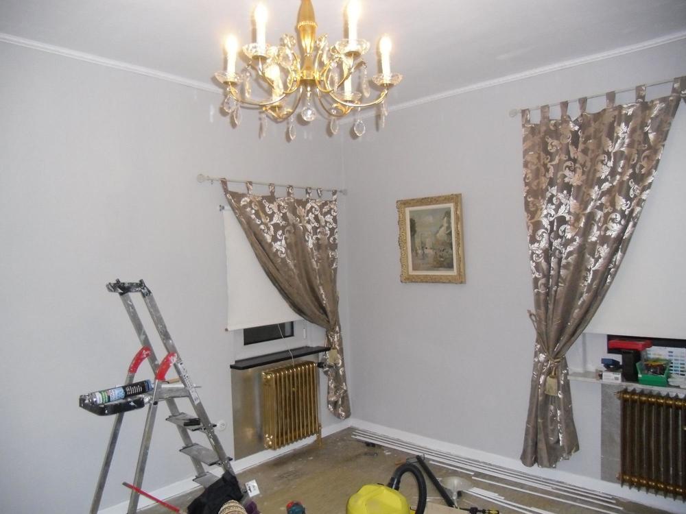

Richard Auld Posted December 1, 2019 Author Posted December 1, 2019 Hoping the weather holds off, still a bit damp over here to be doing the roof, just need a dry day. Have taken a calculated risk due to time constarint and gone ahead with the room repair. Painted through with a bit of grey paint over the 70's wall paper as it is good quality and relatively undamaged. I think it will do for now, a lot of the damaged area of the roof came down and was worse than I thought but I have replastered it and finished witha bit of chipwood. Bobs your uncle! Rich 1

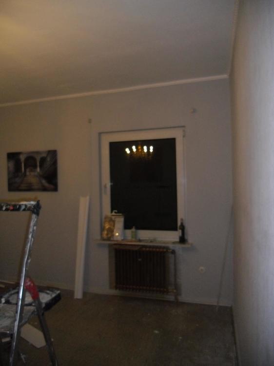

val Posted December 12, 2019 Posted December 12, 2019 @Richard Auld- are this battery made from gold?

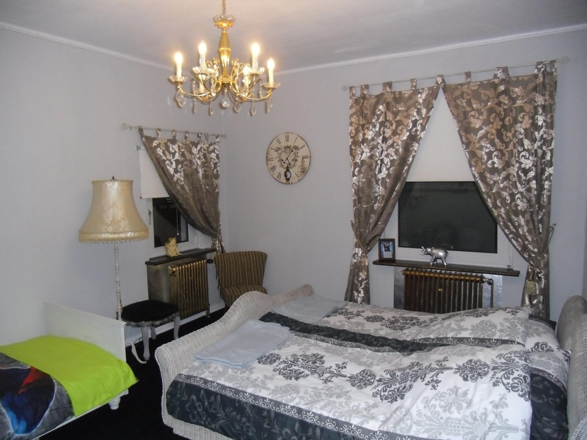

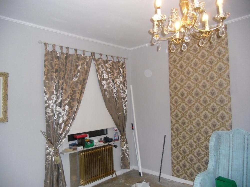

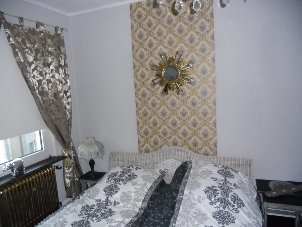

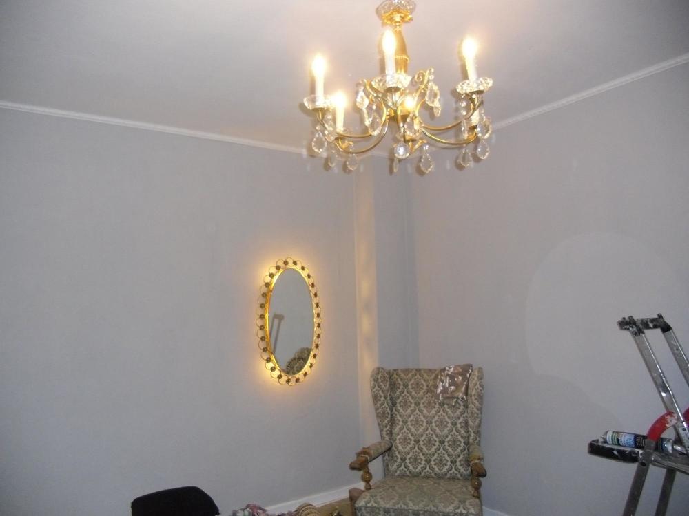

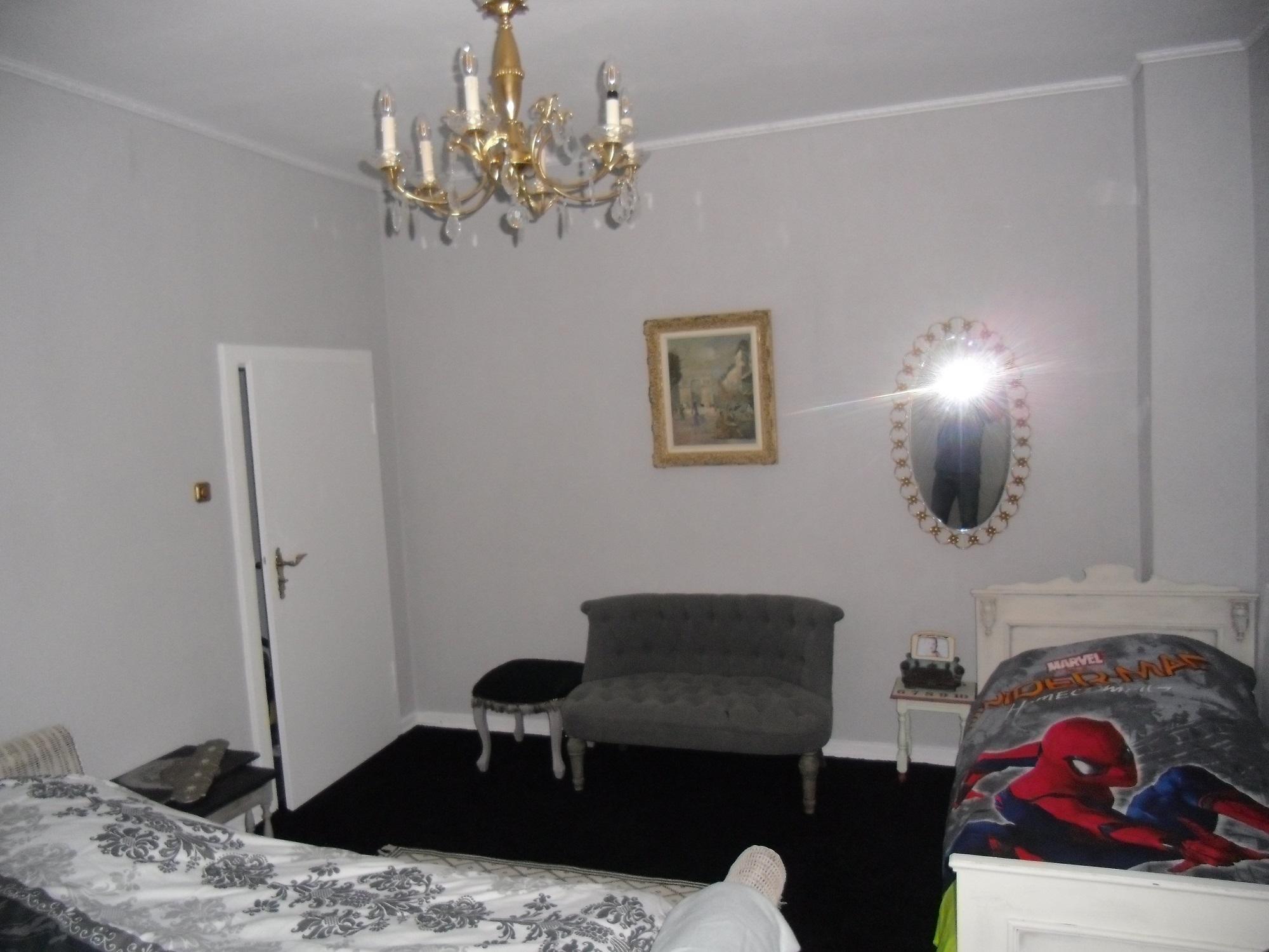

Richard Auld Posted December 16, 2019 Author Posted December 16, 2019 (edited) Hi guys, back now as the room is finished! Not a hernia, just a groin strain and I have 5 discs knackered in my back. @val , I wish the radiators were gold then I would have a Ferrari! I just sprayed them gold to make them fit in a bit with what Liz wanted. Just needs a couple of pictures now and a couple of bed side tables and we are ready for the kids! Rich Edited December 17, 2019 by Richard Auld
