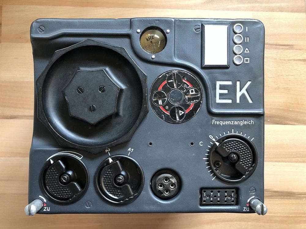

hcs Posted December 10, 2019 Posted December 10, 2019 I just got a E10K, that I want to restore and I have a few questions: It has the round hole for readout of the frequency, inside there is no light bulb for illuminating of the scale, is this normal? At the frame there is the number 16465 stamped in the metal, is tis the serial number? Could someone please give me the sizes of the missing card holder, next to the four rasten window, since I have to make a new one for this? Do you know, where to get the manual? Thank you. Rgds Henrik Sommer 1

Funksammler Posted December 12, 2019 Posted December 12, 2019 The E10K is an early production version and did not have a light fitted. Sometimes lighting was retrofitted to early equipment. On later production examples, the square window and lighting became standard. There is another -more sinister- story to early production FuG10 variations, for a short period the frequency was marked in kPers (kilo persec) instead of kHz. Heinrich Rudolf Hertz was of Jewish decent (even though his family had long been converted to Lutheranism) and some fascist Luftwaffe busybody had decreed that the frequency scale in his name could not be used. Common sense somehow prevailed and the frequency markings in Hertz returned after a short period.... The manual number for the FuG 10 is D(Luft)T4005/2 regards, Funksammler

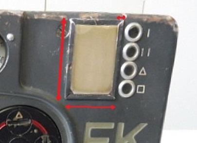

hcs Posted December 13, 2019 Author Posted December 13, 2019 Thank you Funksammler for the, answer and story behind the frequency markings. I need the measurements(height, width and width of the small bending) of the small card holder in the top right corner, since I have to make a new one myself. Anybody with a receiver able to help out? 😊 Rgds Henrik

Funksammler Posted December 13, 2019 Posted December 13, 2019 The card holder is 41 x 25 mm.... regards, Funksammler

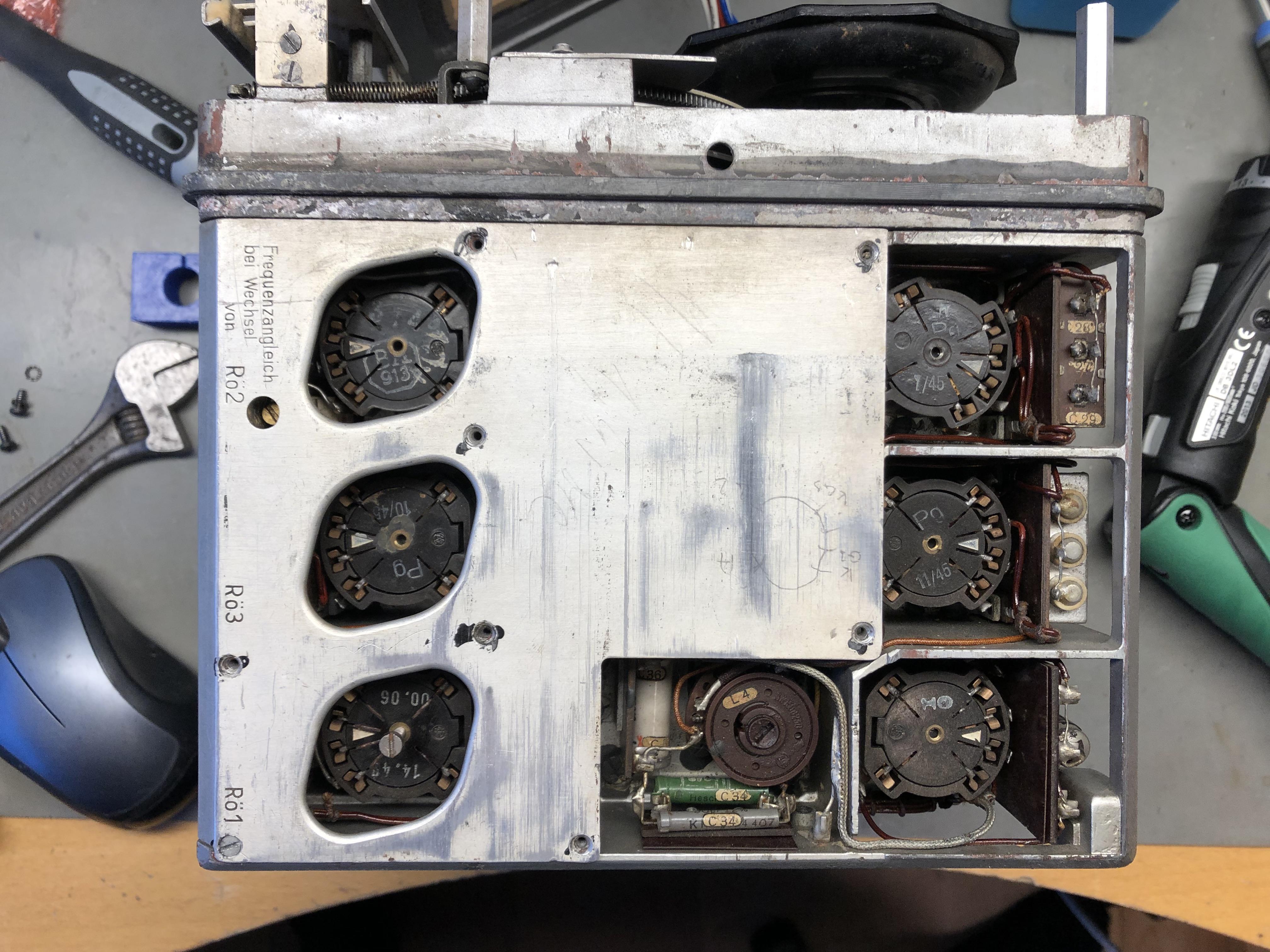

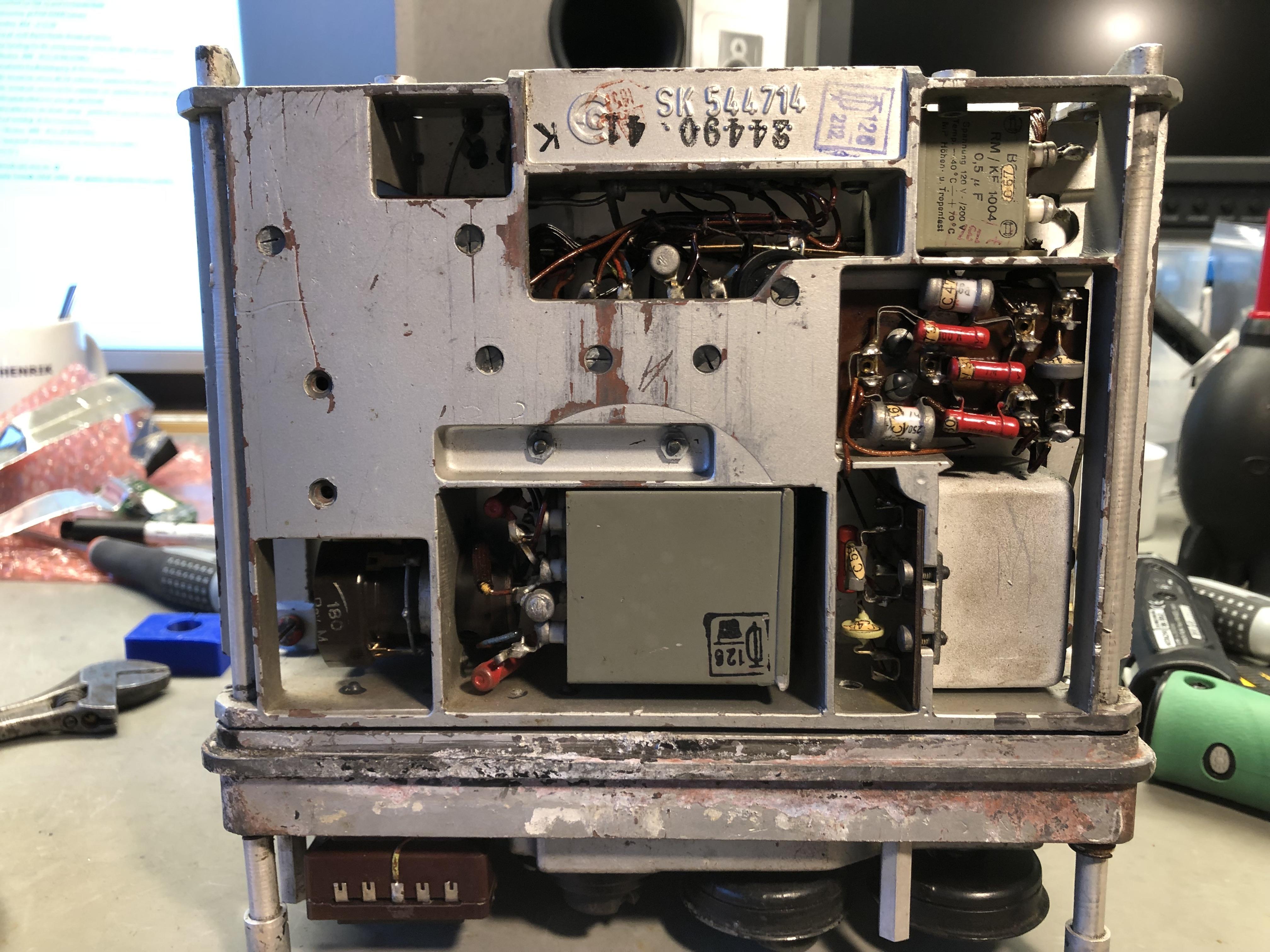

val Posted December 14, 2019 Posted December 14, 2019 @hcs, show also some nice inside images of your E10K.

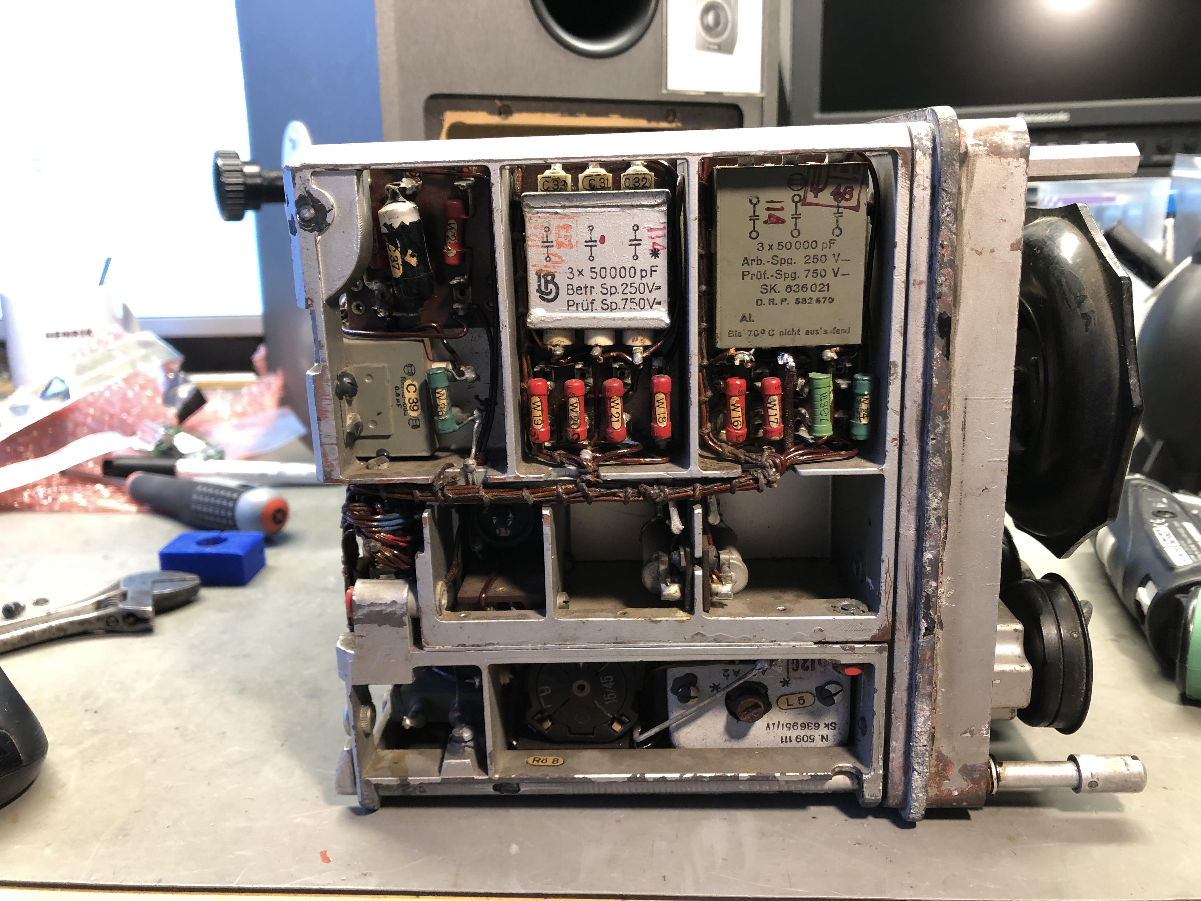

hcs Posted December 16, 2019 Author Posted December 16, 2019 (edited) On 14/12/2019 at 18:14, val said: @hcs, show also some nice inside images of your E10K. Here you go😊 C29 is shortcircuited and need to be replaced inside can(will replace C27, C28 & C29)... Edited December 16, 2019 by hcs 1
hcs Posted January 3, 2020 Author Posted January 3, 2020 I hope you all had a merry christmas and a happy new year.😀 Just before christmas I was able to find a complete reprint of the manual, in very nice quality in germany.😃 Today I managed to replace three 50nf (C27, C28, C29), with 47nf inside the can. I need to do more testing before connecting power to it. Do anybody have the U1 transformer as a spare? The one I have, is replaced with a compatible one, but without any fixing to chassis. otherwise I have to make a new mounting.

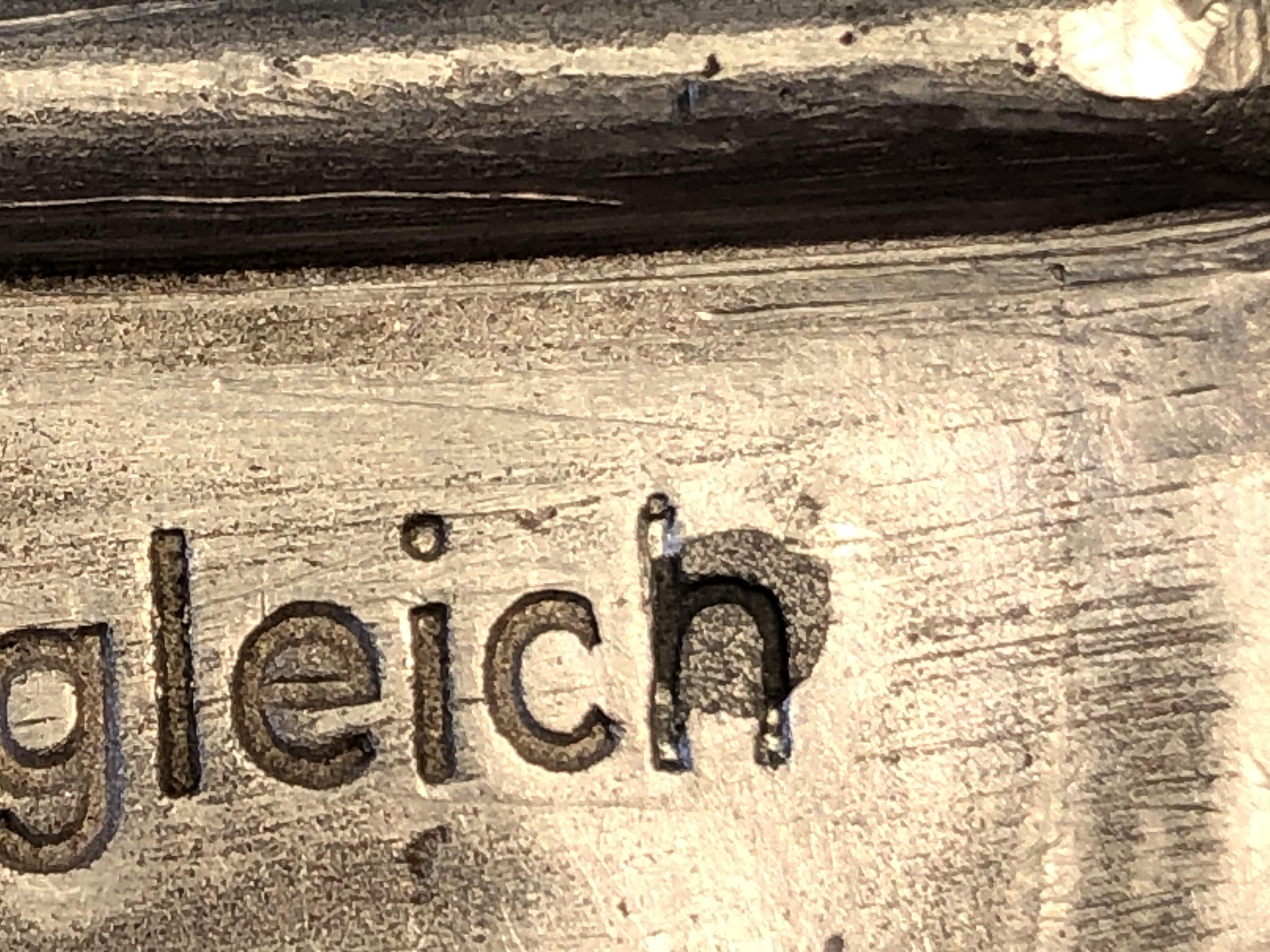

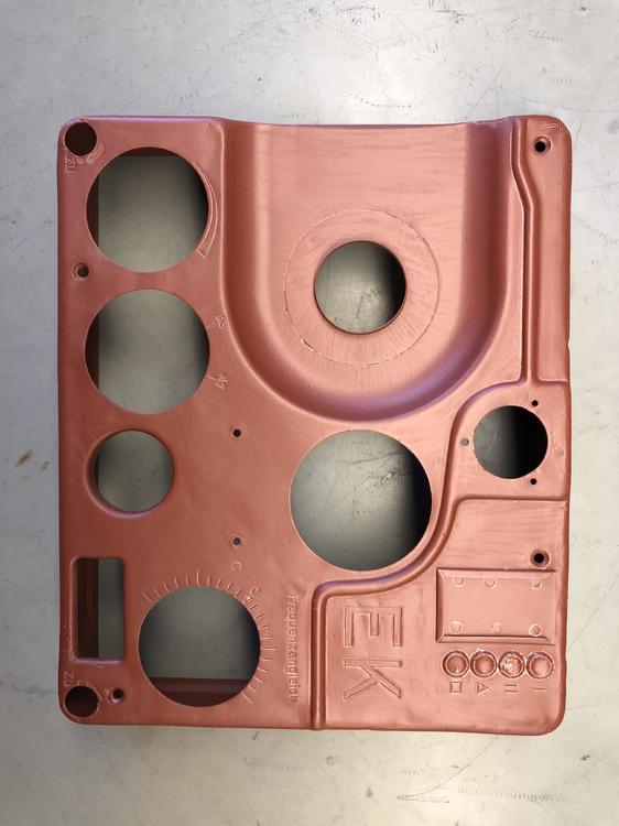

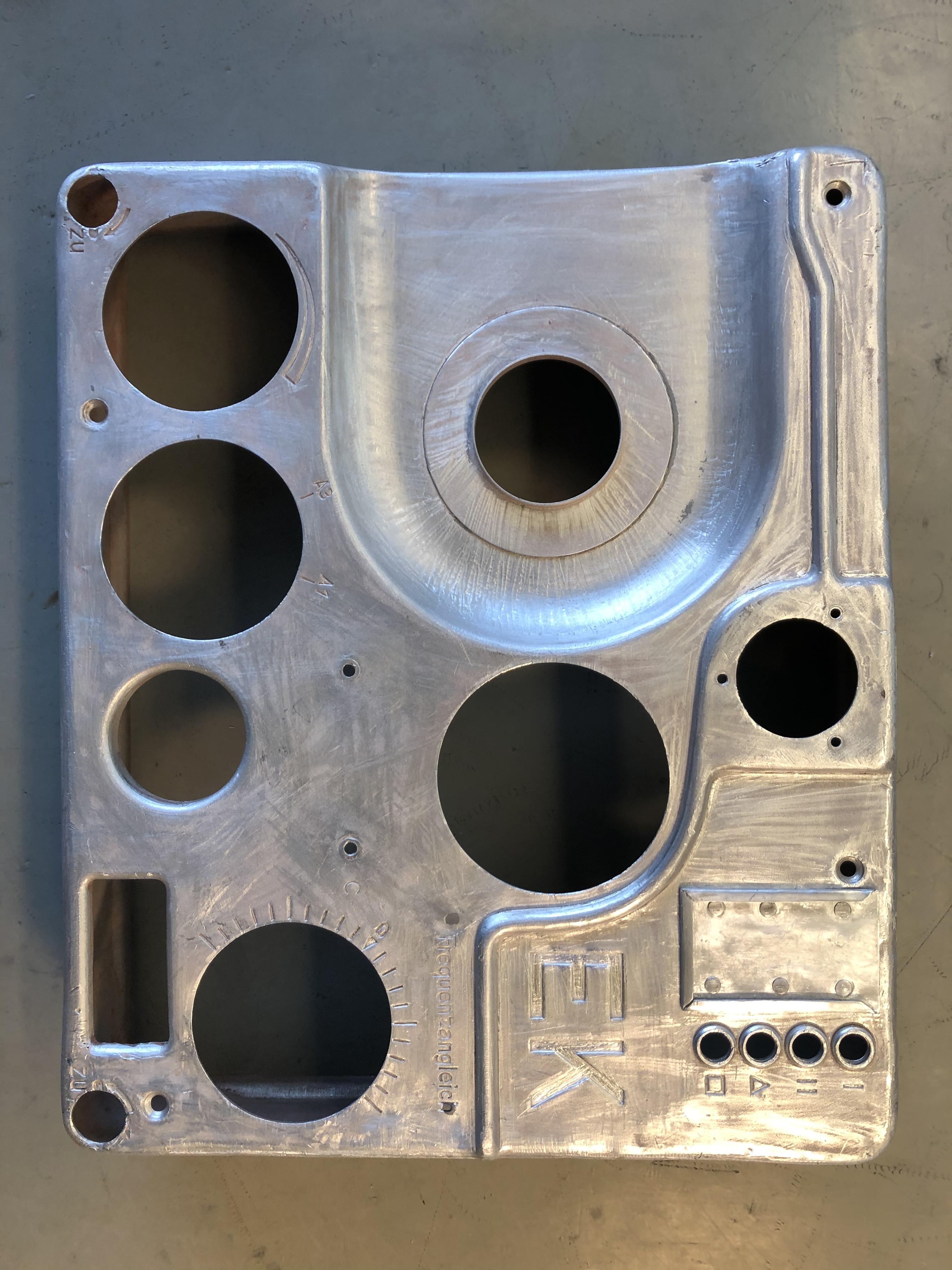

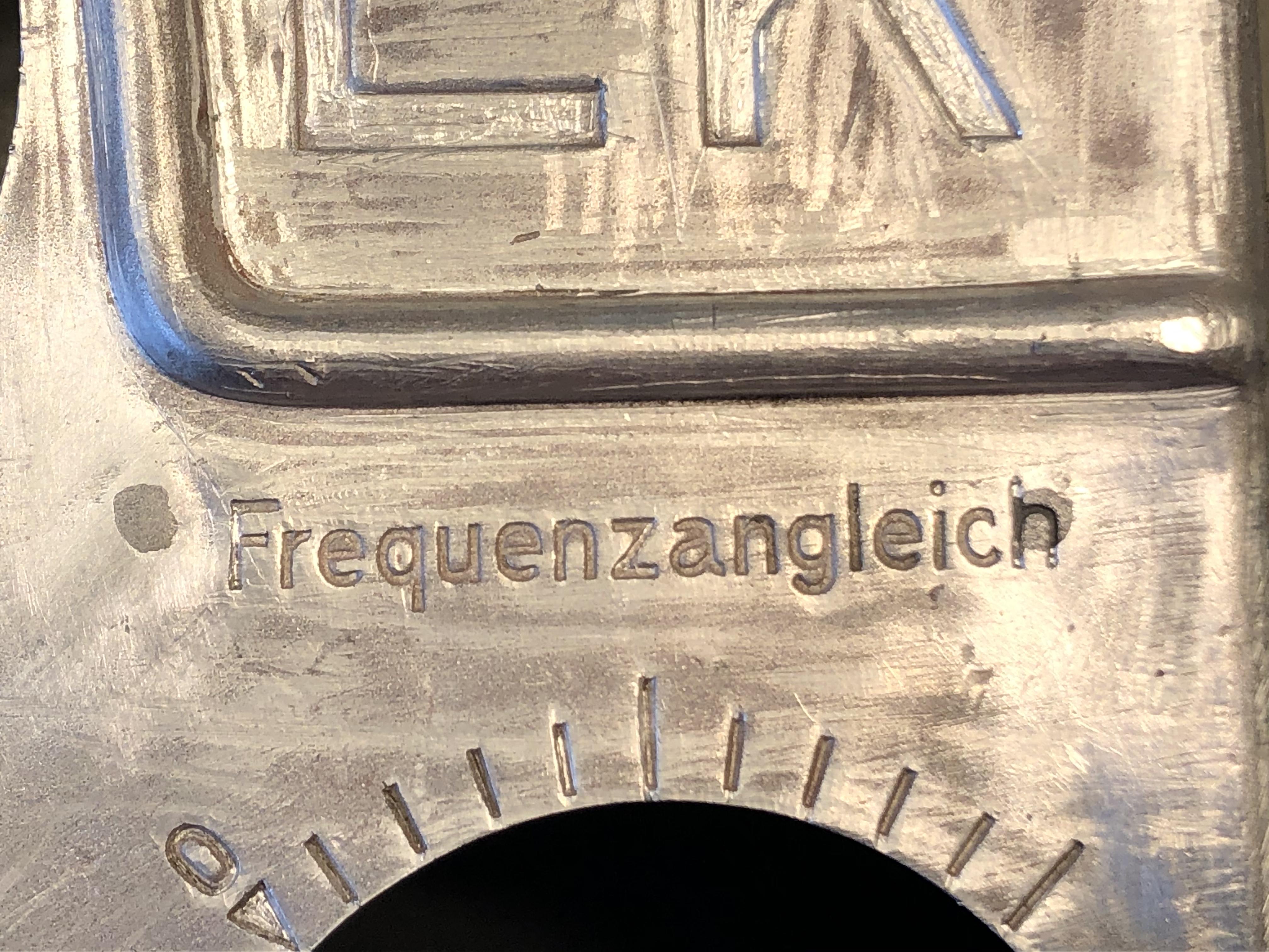

hcs Posted February 8, 2020 Author Posted February 8, 2020 I am now starting to paint the front cover and the case for the E10K. I need to know the original color of the inside of the frontcover, is it the same like outside or another? I managed to restore the last letter in frequensangleich, where someone made a hole. I also made a new holder for the small card. 1 1

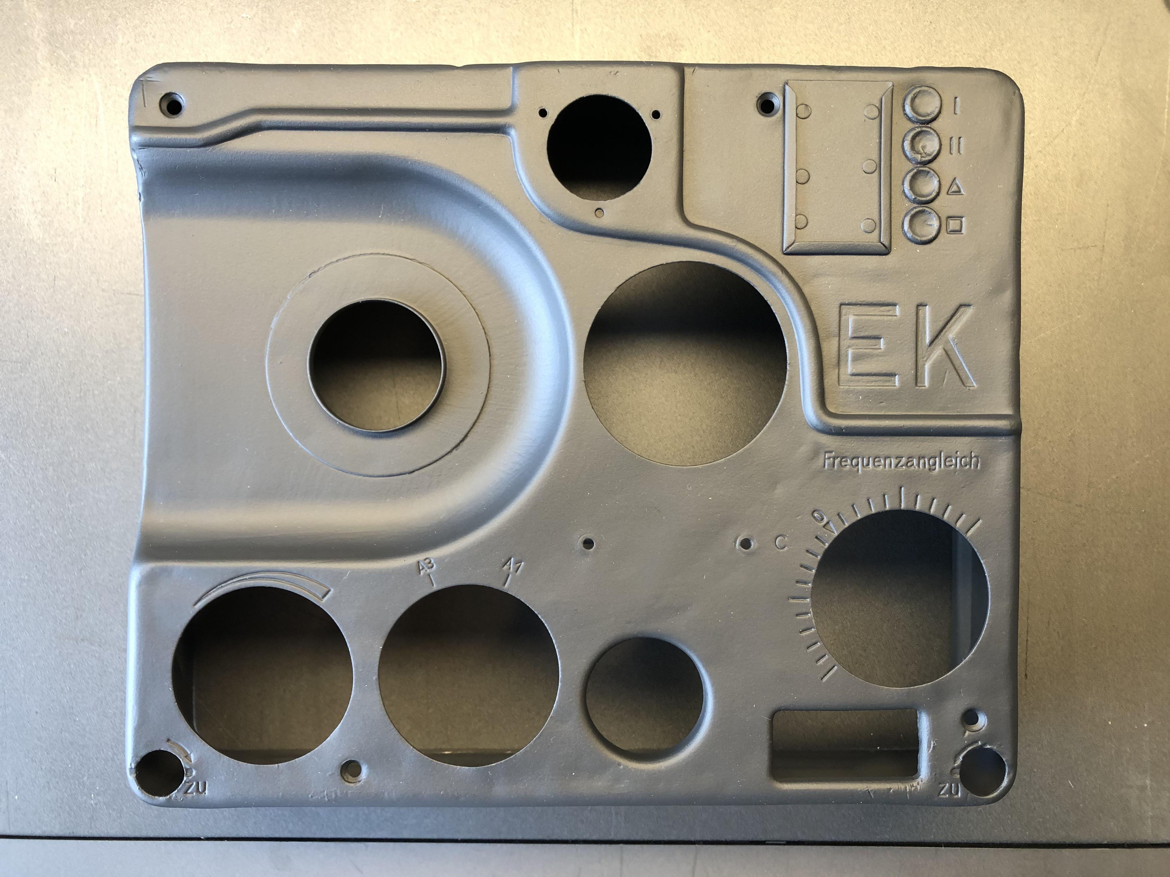

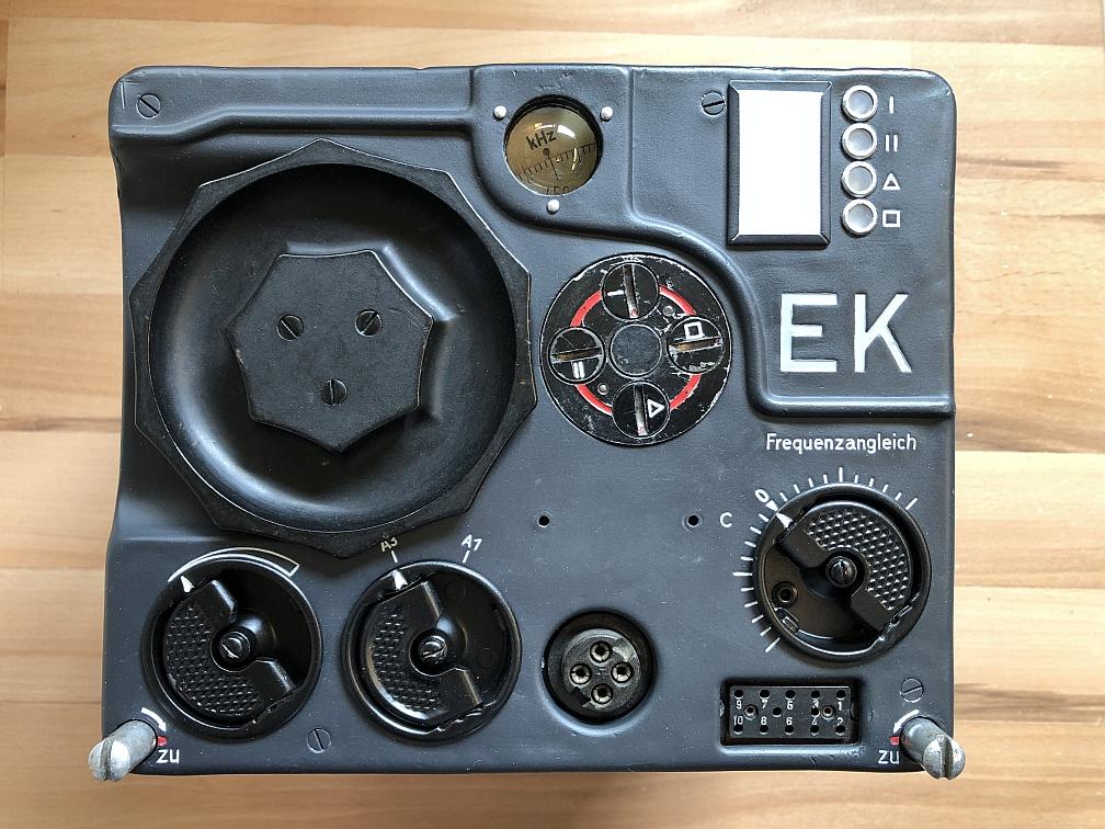

hcs Posted February 8, 2020 Author Posted February 8, 2020 (edited) Grounding color, first layer. Edited February 8, 2020 by hcs 1

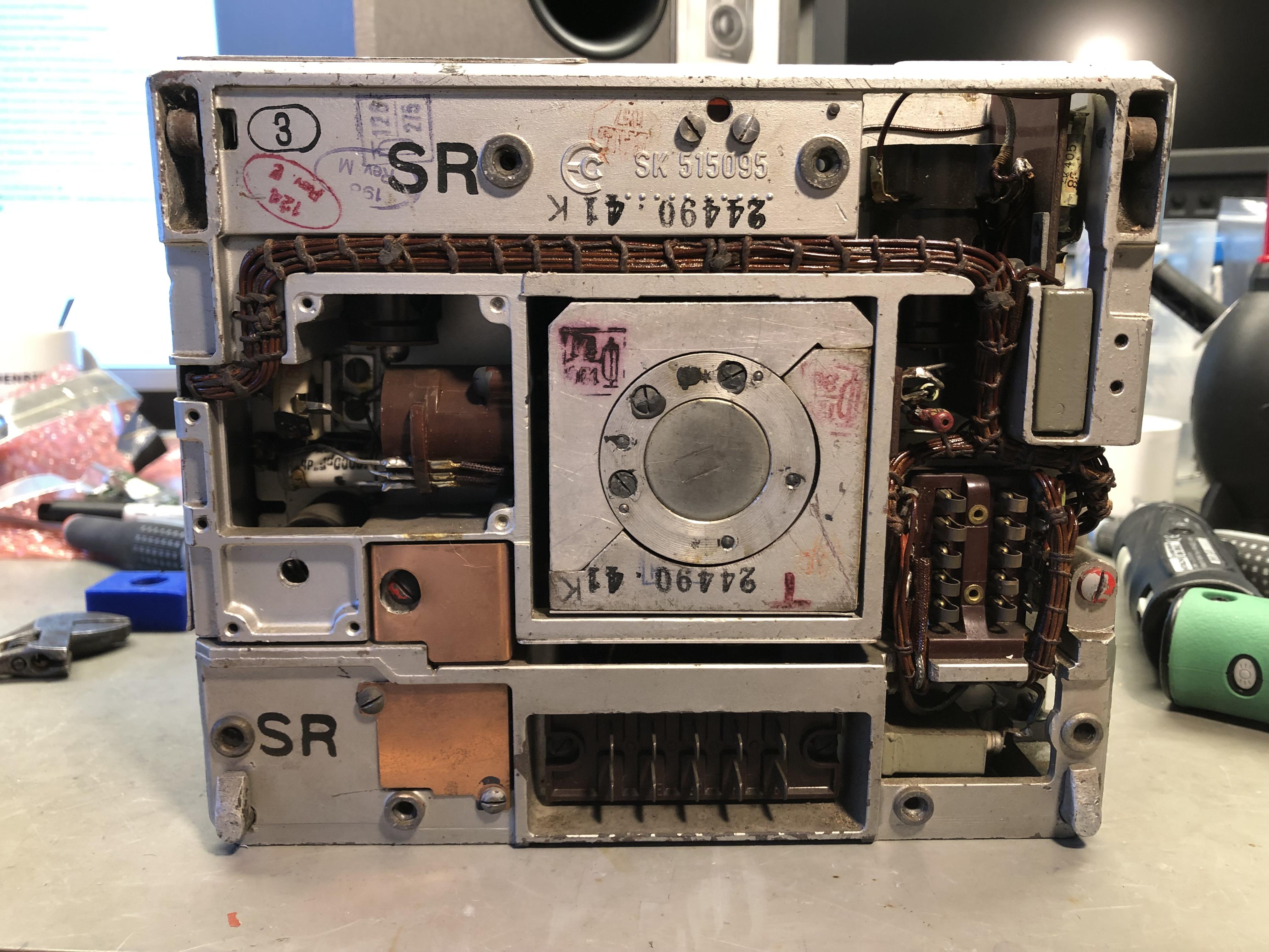

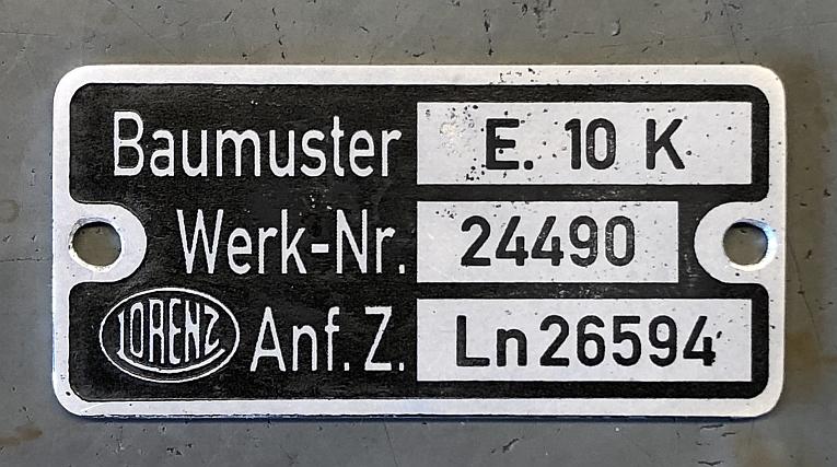

hcs Posted February 10, 2020 Author Posted February 10, 2020 (edited) I am now finish painting the cover and front in grey. I need to make a new shield with the serial number 24490-41, for this I need a closeup photo, in high resolution and in 90 degrees angle, to get the proportions right. I found this shield in the net, I am looking for something like this, because this is close for my serial number and from 1941. I don't know the manuafacturer of my receiver and don't know if it is possible to find out, using the stamps inside receiver? Anybody with a shield like this willing to make a nice photo? Then I'll be very happy Edited February 10, 2020 by hcs 1
hcs Posted March 12, 2020 Author Posted March 12, 2020 (edited) I am now finish with the front of the E10K, but I need to make the serial number plate. I already did make two test versions of the plate, but need to make some small changes, before I'm happy. I found out it was the older more wide version of the plate, that was supposed to be used, because of the length between the holes for the rivets. I have a question about the plate, how thick is the aluminium plate used? I hope one of you can help me out... Edited March 12, 2020 by hcs
Funksammler Posted March 12, 2020 Posted March 12, 2020 I measured a few tag plates, they seem to be around 0.6 - 0.7 mm. regards, Funksammler
