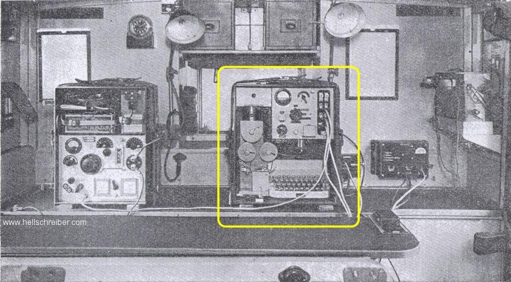

Hello,
Does anybody know what is the devise immediately left of the teleprinter and under the lamp?
Thank you

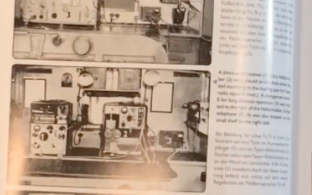

While I was searching for this, I found that the "Nuts & Bolts" Vol 32 has a   better picture of the same  setting with some commentary. I do not have the book and since it does not number the devise, it may not have any relative info. In any case, from a review video in youtube  in low resolution, one can see the same devise

I am not sure what you are refering to, the unit in the yellow square is an early type of Feldfernschreiber. Left of it is a E445Bs Tornister Empfänger.
regards,
Funksammler
regards,
Funksammler
Thank you for the reply!
I will try to  be specific because I think you are talking about the items numbered "1" and "2" at the bottom image  (from Nuts & Bolts" Vol 32 ) in my second post.
Based on your answer and from my very basic understanding of the German communications equipment,  I understand that the unit marked as "2" is a  Feldfernschreiber and the unit  marked as "1" is the E445Bs Tornister Empfänger.
Now, if you notice in the bottom image of my second post , there is a third item  between item "1" and item "2" which is not numbered  and  does not even look like a radio or teletype equipment of any kind.  It is this item which I try to identify. This unidentified item is right below the left desk lamp.
Thank you again  for the reply, and I am sorry for the slow response.
Pamak
I can just see the back wall between the receiver and the Feldfernschreiber. It has a Bosch 12V socket for the Midgard lamp but that is about it...
regards,
FS

Thanks for the reply!
Apparently, because it is a frontal picture and lacks depth perspective, I saw the back wall as an additional instument betweeen the receiver and the Feldfernschreiber. I was especially confused by the white, narrow horizontal stripe which I saw it as some type of a dial display.
