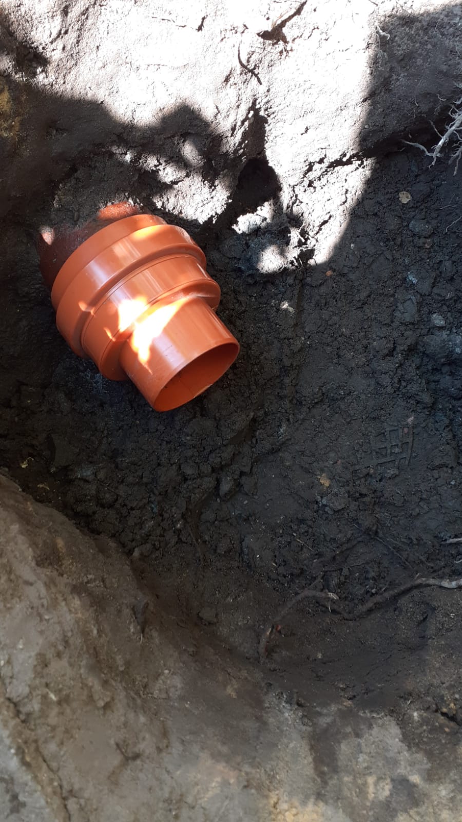

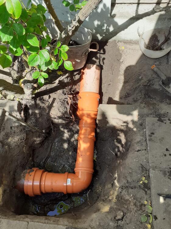

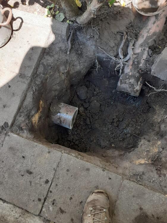

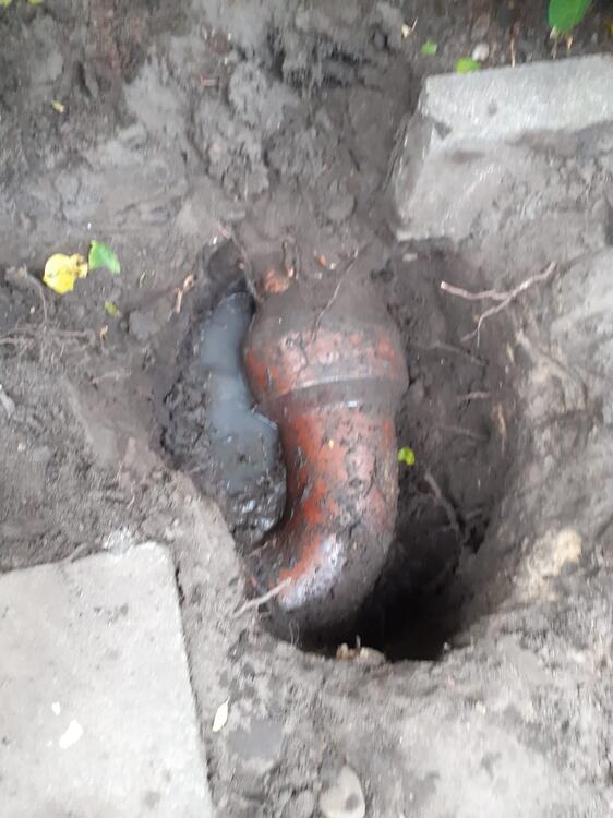

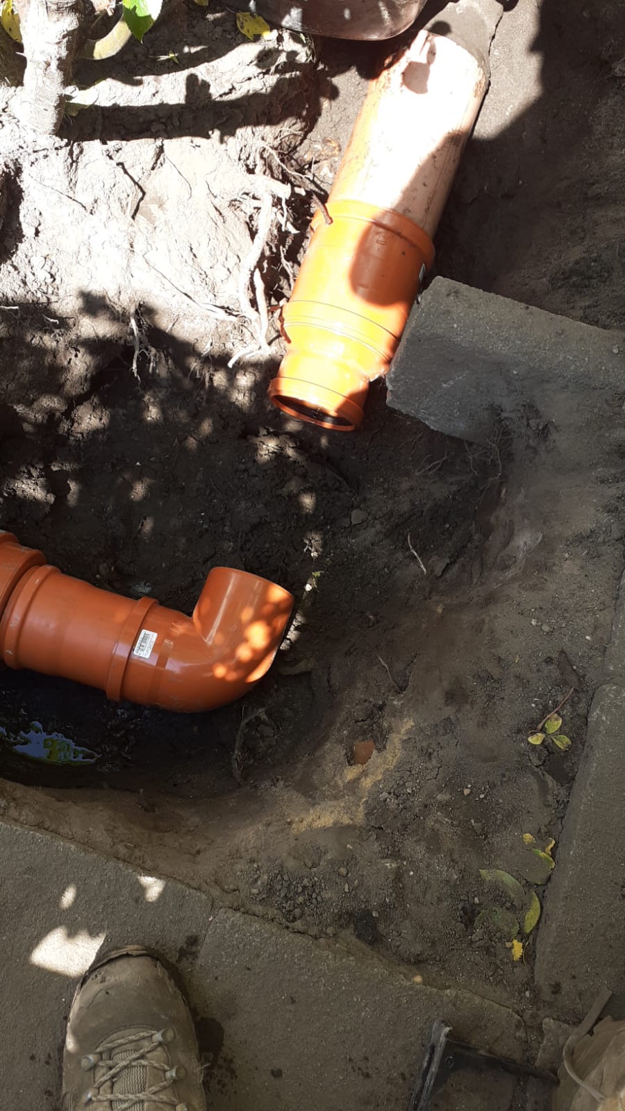

bit of a drama with the old house, these older pot pipes crack with roots penetrating them and this was the case here! I short stretch but complicated to fix in terms of surprises, 110mm original cast iron pipe leaving the building cemented into a 150mm plastic pipe, cemented to the defective 90 degree turn pot pipe! All replaced with modern plastic pipe for the grand sum of €34 and a bit of spade work! Sorted....
