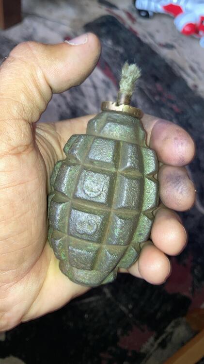

Hello,
I need Help a bit !
I've never seen a grenade like this before… Origin ? Manufacturer ?
Is anyone able to tell me a little about this grenade, it feels like it is from first World War.
Markings: E&S 1915
Thank you in advance ! :)

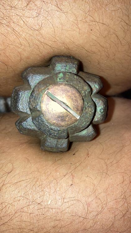

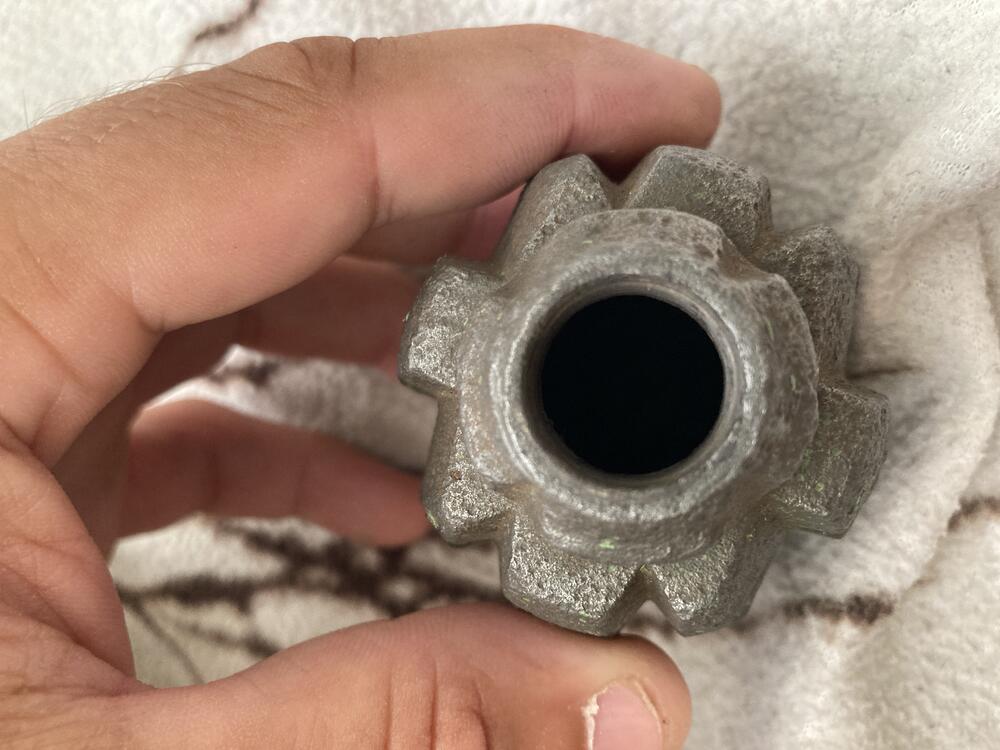

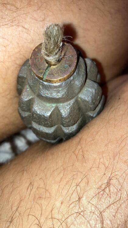

Hi, I cant be 100% but I think this might be a French F! fusante No/ !. However I am not to happy in the fact that this looks as if it still has the wick  in place and the base nut has not been removed, are you sure that this has been de activated , was this from a dealer and if so did he say that if was safe and was it from a good dealer
Many Thanks !
Yes, Grenade is totally inert :)

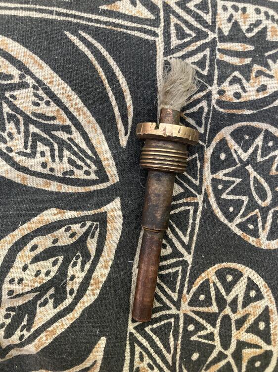

Can't make out anything meaningful.
Early French F1 were wick ignited, however they had totally different
wick holder design (at least those i've seen). Never seen this.

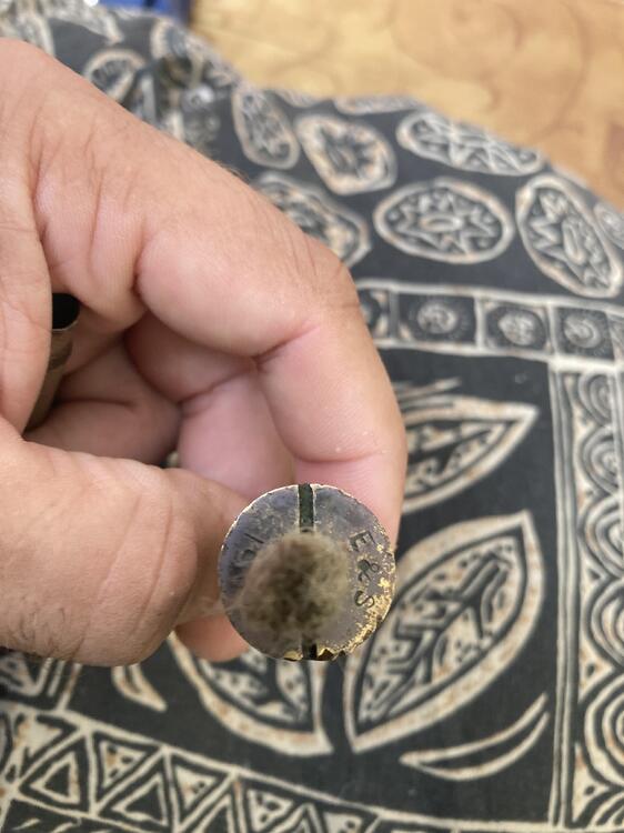

However E & S is known British marking - Edison & Swan Ltd.
http://tgrm.foxed.ca/British Markings.html
Can you make close up pictures of that wick holder separately?
For "E & S" reference see first post here:
https://www.greatwarforum.org/topic/188323-ww1-grenades-both-british-and-enemy/page/24/

Not 100% but I think a lot of these were given to the French and they may have been re worked and the fuses replased and re named,
Very interesting 🤔 French grenade, but English origin fuze.
Maybe some kind of military aid or something like that?
yes, I can take a photo
