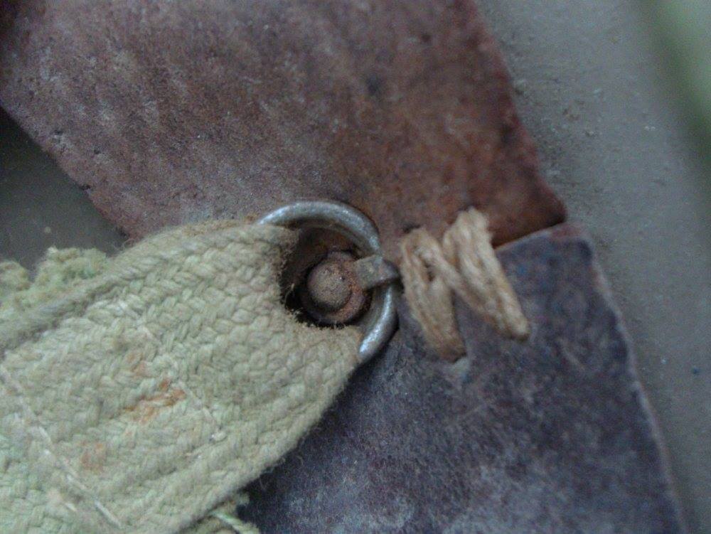

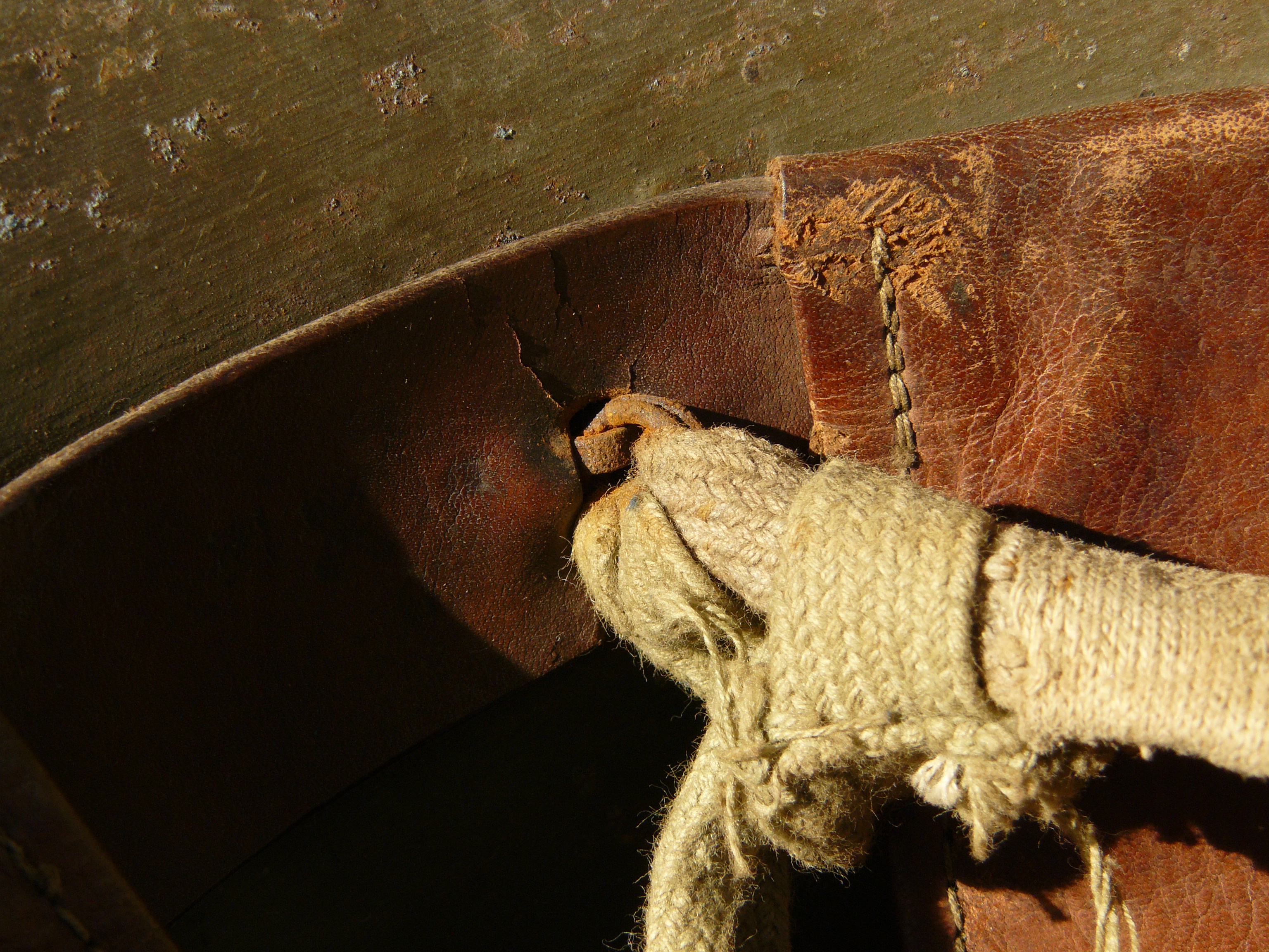

Mark K Posted September 2, 2017 Posted September 2, 2017 Hi Dave I will take some better pics for you this Afternoon of the liner band and fastners of my IJA Type 90 but here is one of the back fastener hope it helps a little

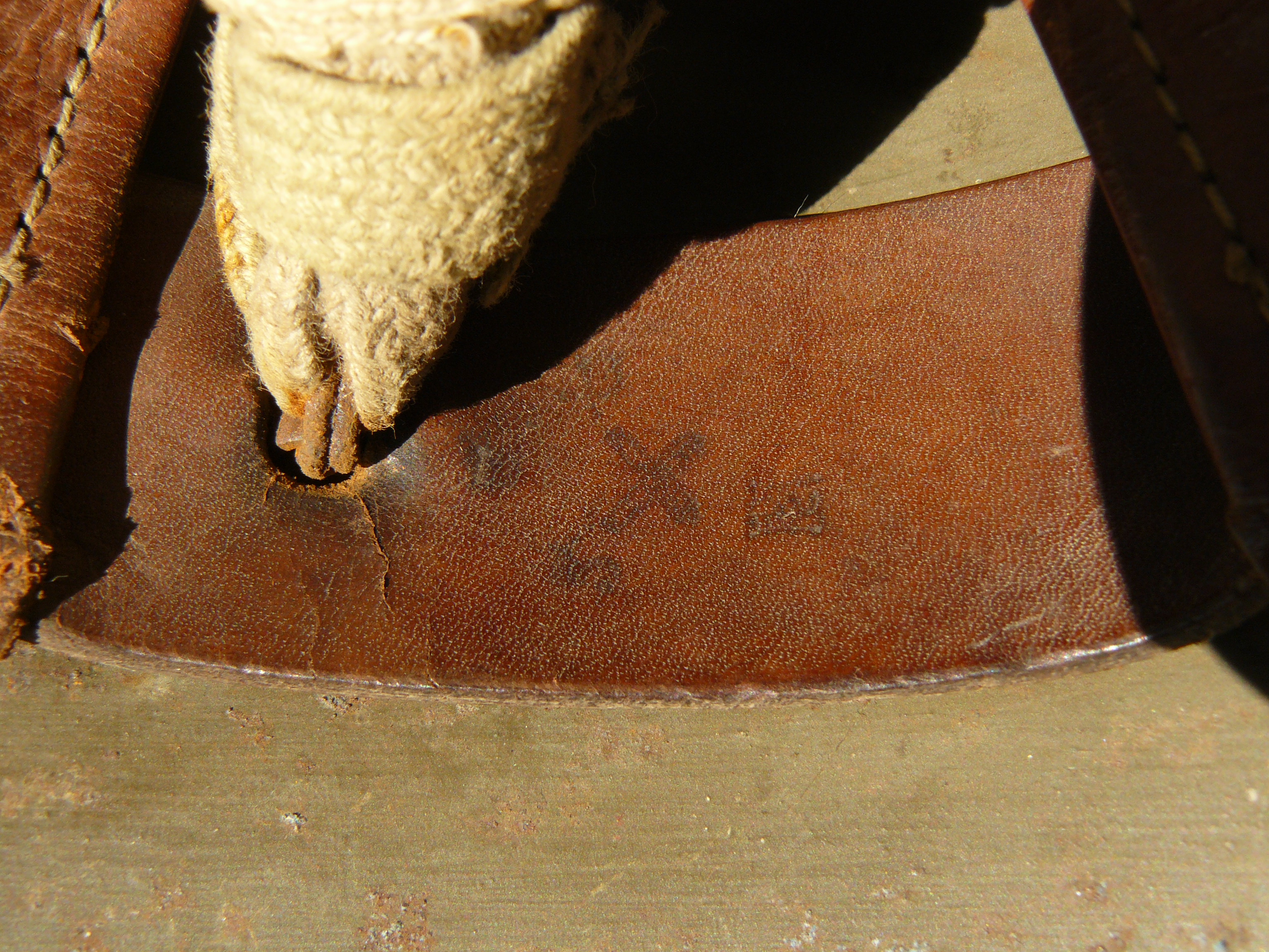

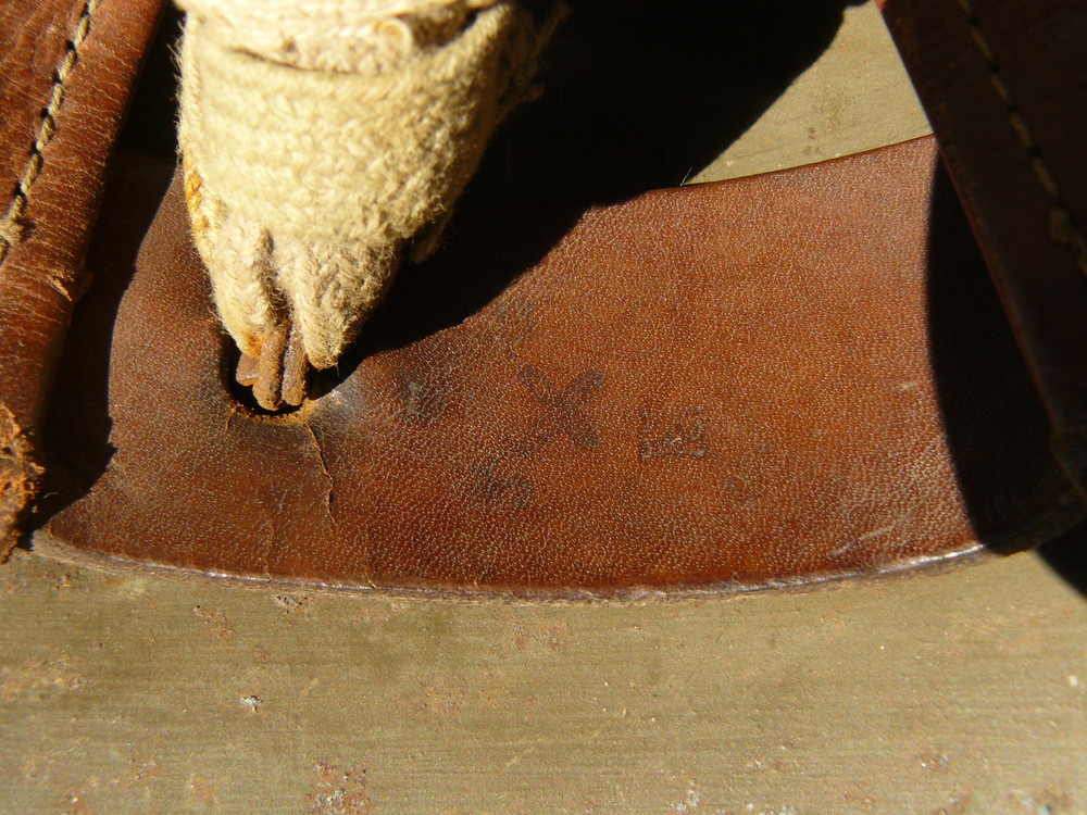

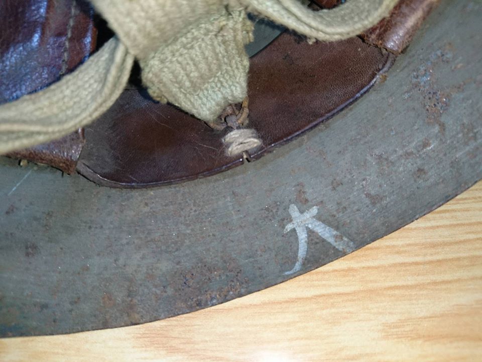

Mark K Posted September 2, 2017 Posted September 2, 2017 (edited) Here is a written comparison between Army and Navy liners upon the type 90 Japanese steel helmet that were shared with me by Oliver lock .the Army issued helmets come in two sizes large and small and thus marked there liners by punching ( kanji characters to the rear left side of the liner joint seam and sewed the joint together using 3 tack stitches . The Navy only issued in general large size helmets and used only 2 tack stitches and formed in an X in thread between the two tacks.. This image below shows the fastener in a little better detail and is from an IJN helmet.. photo credit to Oliver Lock .. Edited September 2, 2017 by Mark K

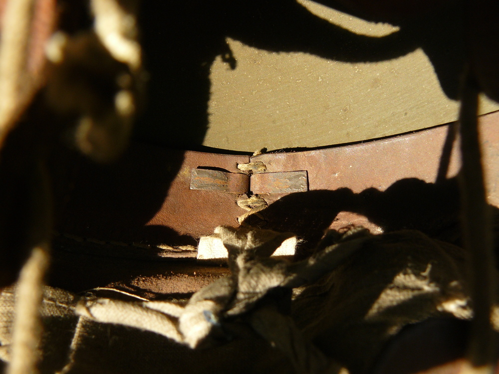

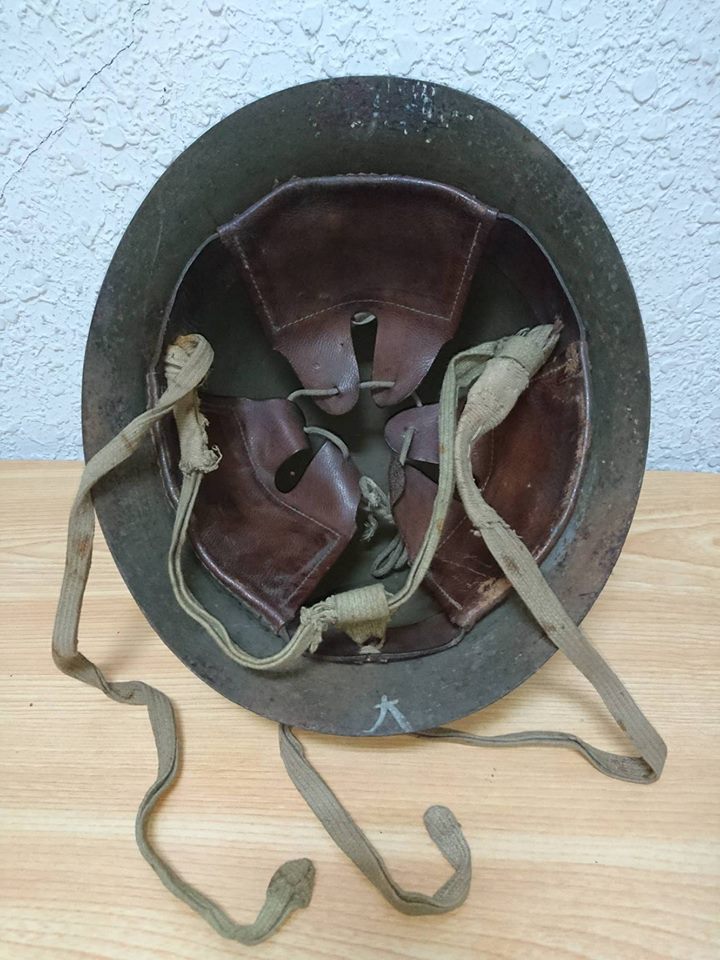

Mark K Posted September 2, 2017 Posted September 2, 2017 (edited) And lastly Dave an over all shot of the liner from my type 90 which is an IJA with an IJN liner that has been period installed..I will take a few more pics later in the day... Edited September 2, 2017 by Mark K

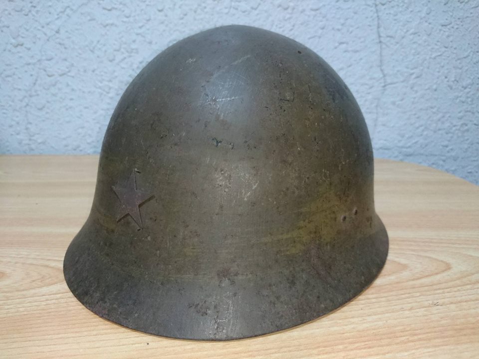

Mark K Posted September 2, 2017 Posted September 2, 2017 And one of the exterior of the helmet body I will as mentioned do a little more investigation for you later in the day.. 1

Davejb Posted September 3, 2017 Author Posted September 3, 2017 Mark ,Thanks so much, thats a great start, its a long lime since I had one which I found on an old bomb site back in the late 60s, what are those very small pairs of rivets actually for and how do they result in the inner liner, is there a securing ring attached to hold the sides of the liner, apart from the three main large rivets, two at the temples and one at the rear, I,ve been trying to find photos of a helmet without liner but one that still shows all the internal rings , plus whats attached to the small pairs of rivets but to date no luck. I notice that your helmet shows the Army star rather than the IJN anchor, were there two types for the Navy 1

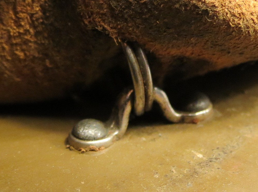

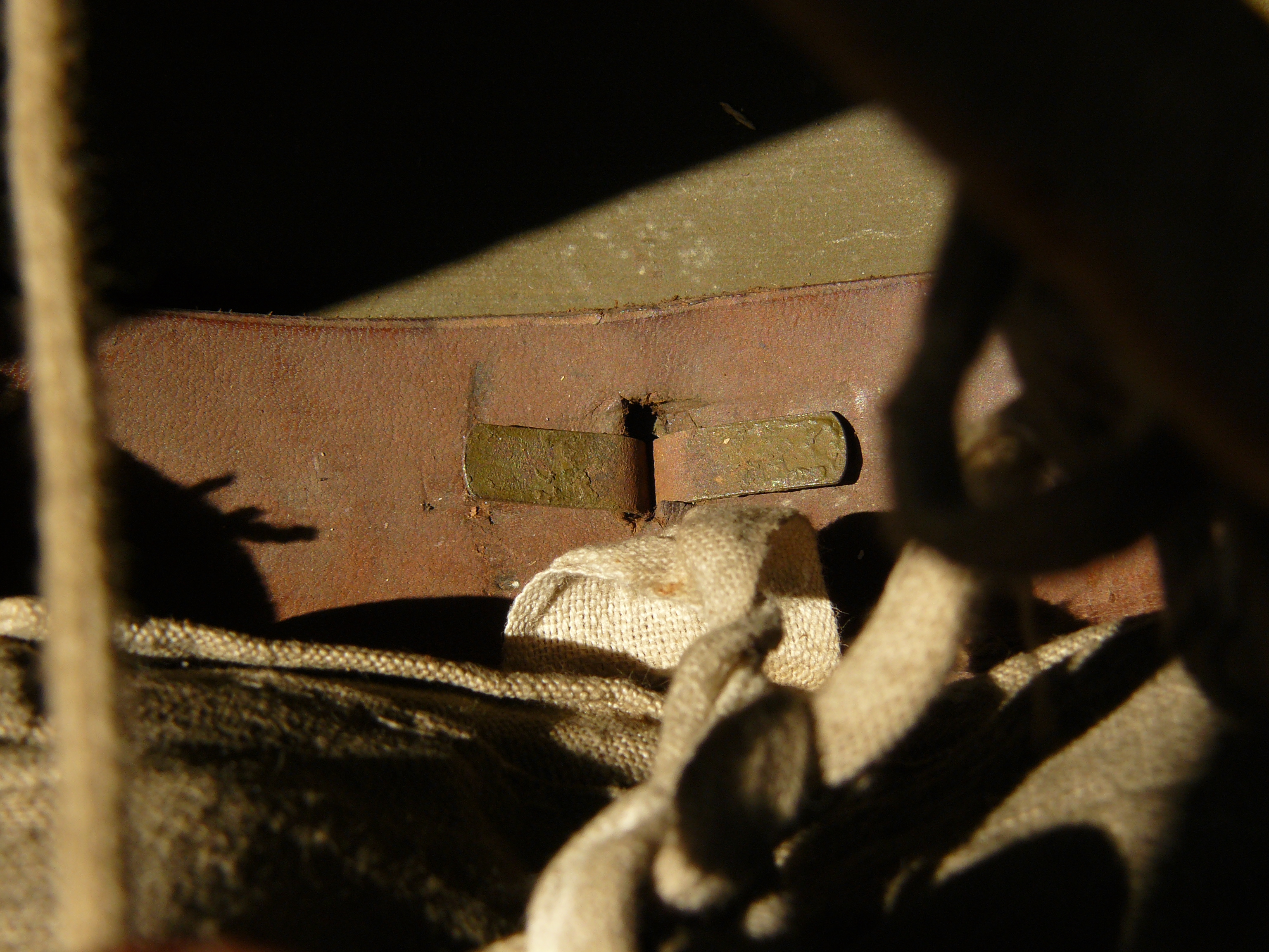

Mark K Posted September 3, 2017 Posted September 3, 2017 Dave my type 90 is a bit odd for some reason my IJA helmet had an IJN liner installed it is thought to have been period done as nothing appears to be messed with and the liner has been in it for eons and the liner is attributed to a IJA soldier his name was Fujisawa and he served with the 1st Calvary .. Now as to those those very small pairs of rivets that you see around the circumference of the helmet body there sole purpose was to attach a small bracket to hold the rings for the chinstrap to pass through here is an example below of said bracket ..

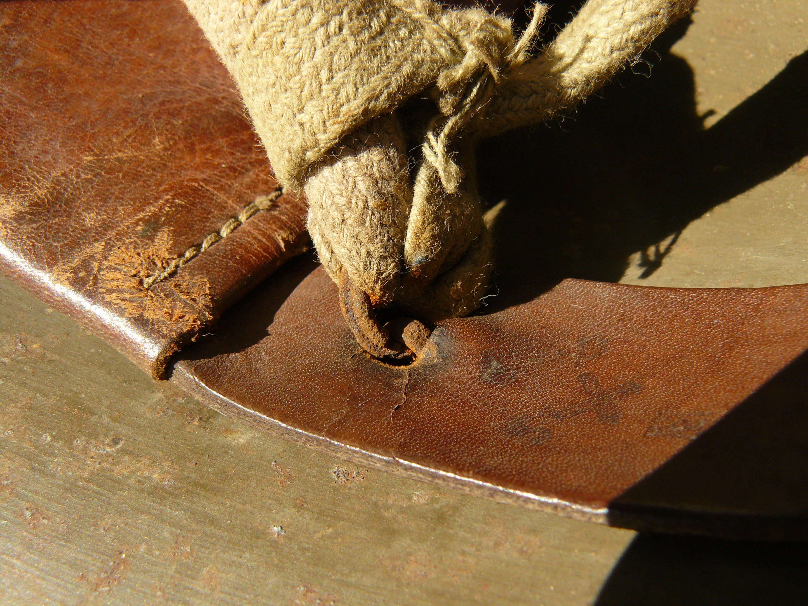

Mark K Posted September 3, 2017 Posted September 3, 2017 A bit hard to make out Dave but you can just make out how the leather has been cut away to slip by the bracket for the chinstrap rings...
Mark K Posted September 3, 2017 Posted September 3, 2017 (edited) The leather liner is held directly in place by the three larger rivets and the tabs are just plainly folded over as can be seen in the images below Edited September 3, 2017 by Mark K
Mark K Posted September 3, 2017 Posted September 3, 2017 The IJA and or IJN insignia being one of them as seen below

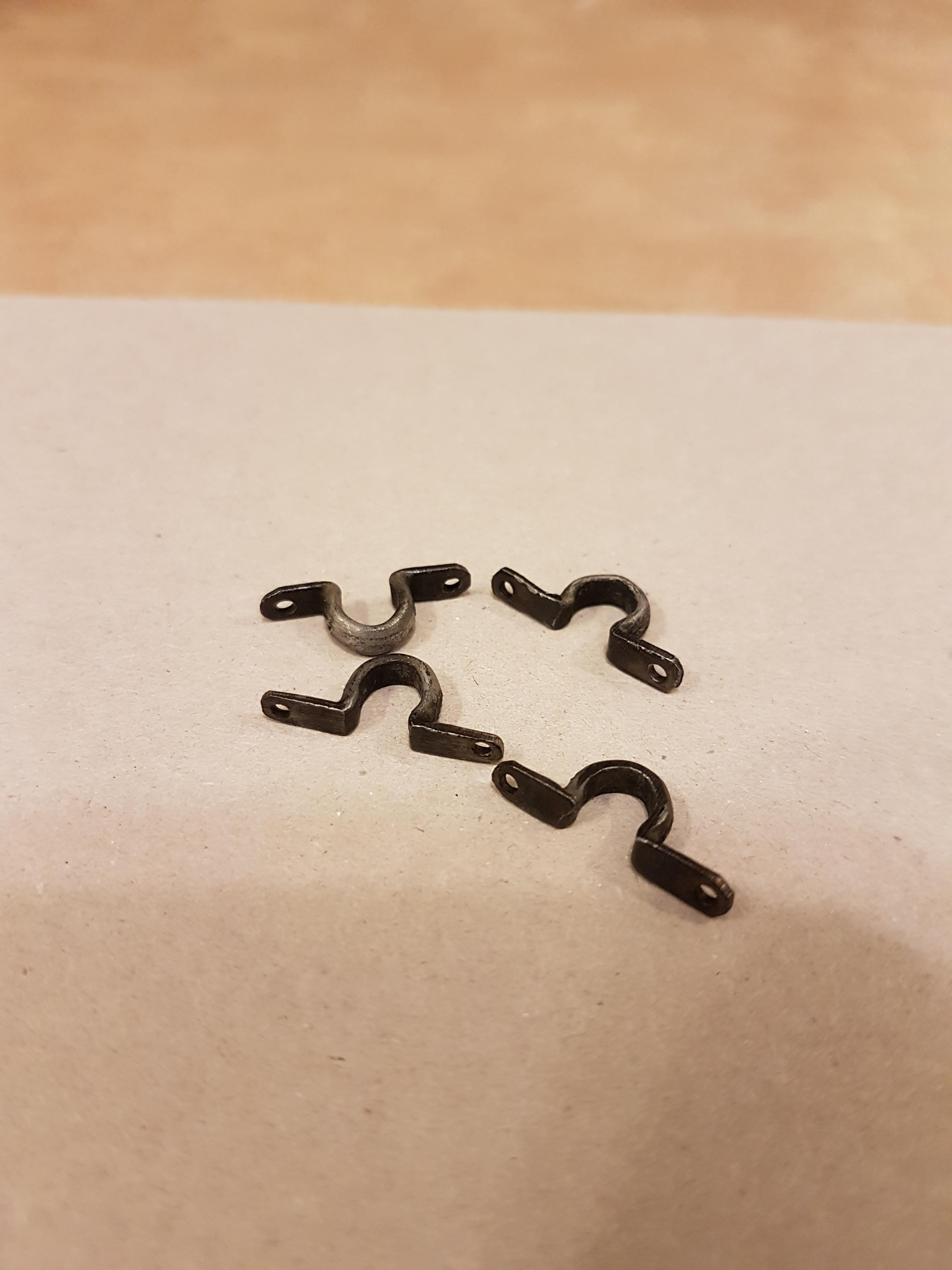

Mark K Posted September 26, 2017 Posted September 26, 2017 Evening @Davejb sorry for the late reply to this post but just wanted to share a little update with you .My apauligies I have just managed to finish the liner retention staples last night and they will be in the mail tomorrow the task was a bit more daunting than I first thought the challenge was drilling 1.5 mm holes for the rivets and I went through a few samples till I could get it right they have been heated and quenched in high carbon oil so in essance the steel should be case hardened.. 2 1
Davejb Posted September 26, 2017 Author Posted September 26, 2017 Mark, thats fantastic, they look great, Cant wait to get them , Thanks so much, a real professional job 2
Mark K Posted September 26, 2017 Posted September 26, 2017 You are more than welcome @Davejb sorry for the delay mate there is one spare in there that is a bit off for you to experiment with you will be able to tell because one hole is slightly drilled off centre.. Give them a good wipe down when you get them as there is still a bit of carbon/ oil residue left on them from the quench... 2 1
