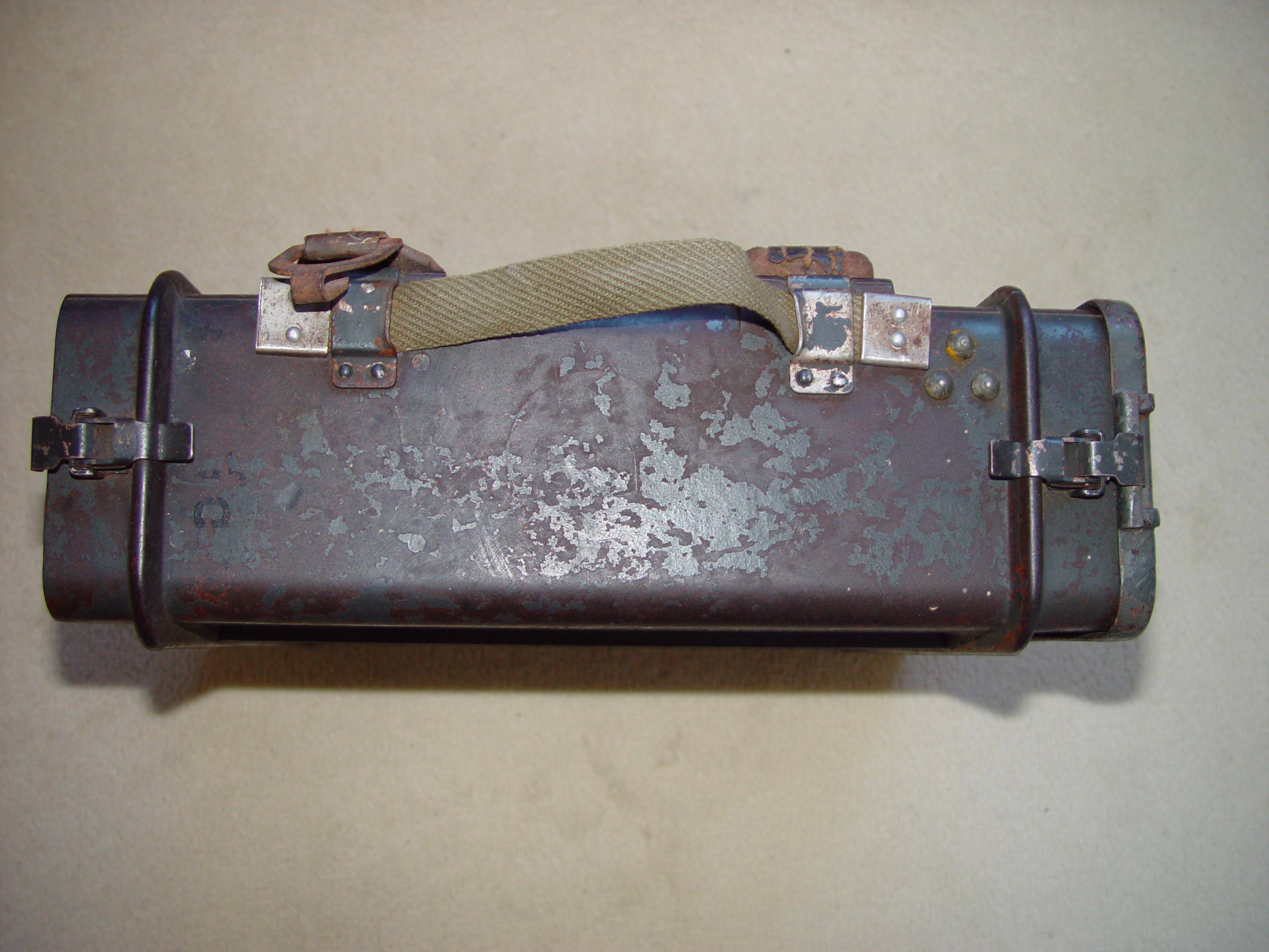

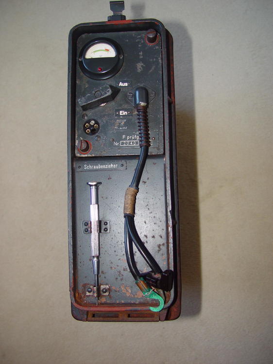

The Frequenzprüfer f (Fprüf.f) came in the same bakelite box as the Feldfunksprechers so it could be carried to the frontline units if required.
The top of the Fprüf.f was devoid of an antenna connection and had three round feeler shapes painted yellow. This allowed it to be distinguished in the dark from the Feldfu.b (one dot) and Feldfu.c (two dots)
The yellow theme was carrying over to the rear lid, which had a yellow circle painted on it to provide easy visual recognition:
The front panel held the frequency calibration unit at the top. There was no internal battery, so a battery cable allows the calibrator to be connected to a 2.4 NC 28 battery placed next to the unit. A calibration screwdriver on the bottom section completes the front panel:

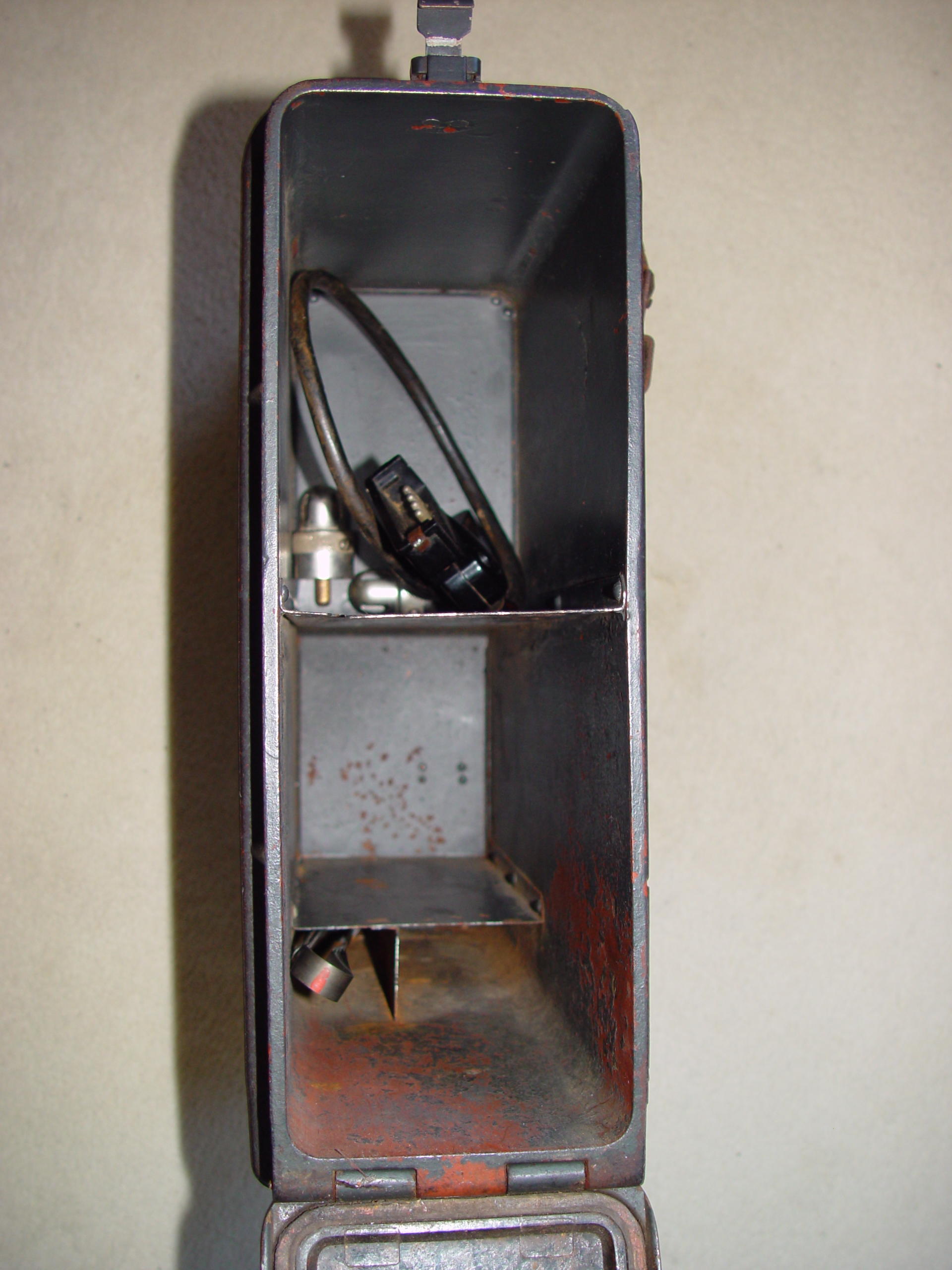

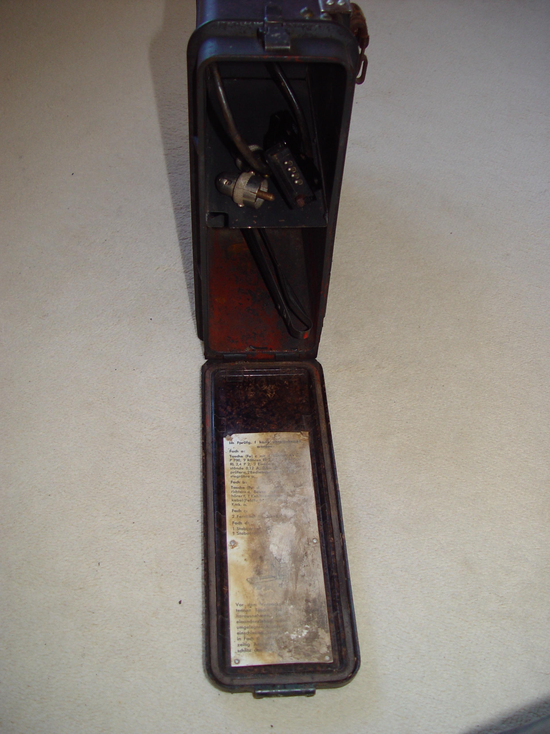

The Frequenzprüfer was a essentially a first line maintenance kit carrying spares and tools to test the Feldfunkprecher b and c models. Most of the space inside the box was reserved for spare valves and other bits of test equipment. The top compartment held a "Tasche (Fu) c" with spare valves, iron-hydrogen resistors, voltage indicator lamps, spare remote control units and test dummy load. The bottom compartment held a "Tasche (Fu) d" with spare vibrator units, Dfh.f, Kmf.c, test cable and microphone elements.
The two small bottom compartments were for two spare antennas (one Feldfu b and one Feldfu c) and two spare remote control cables.

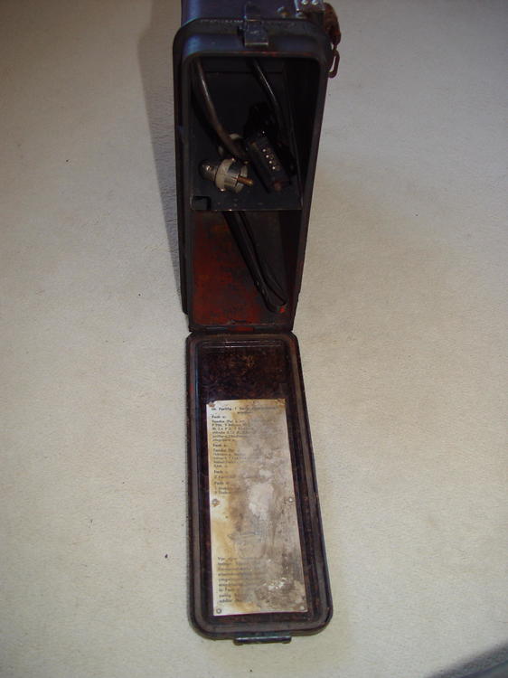

The inside of the rear lid contains a list of it's contents (not in such good condition in this example):
The frequency tester itself contained a crystal oscillator that generates a very accurate frequency on 26 Mhz. It was to be placed one meter away from the Feldfunksprecher being tested and both units were switched on to warm up. The small amount of HF energy radiated by the battery cable would be enough to reach Feldfunksprecher:

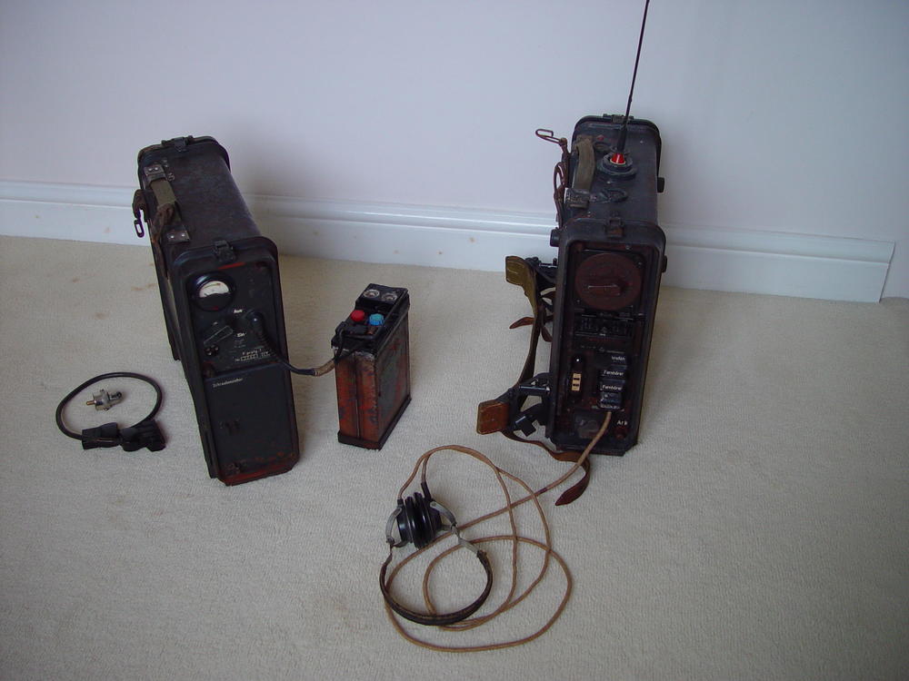

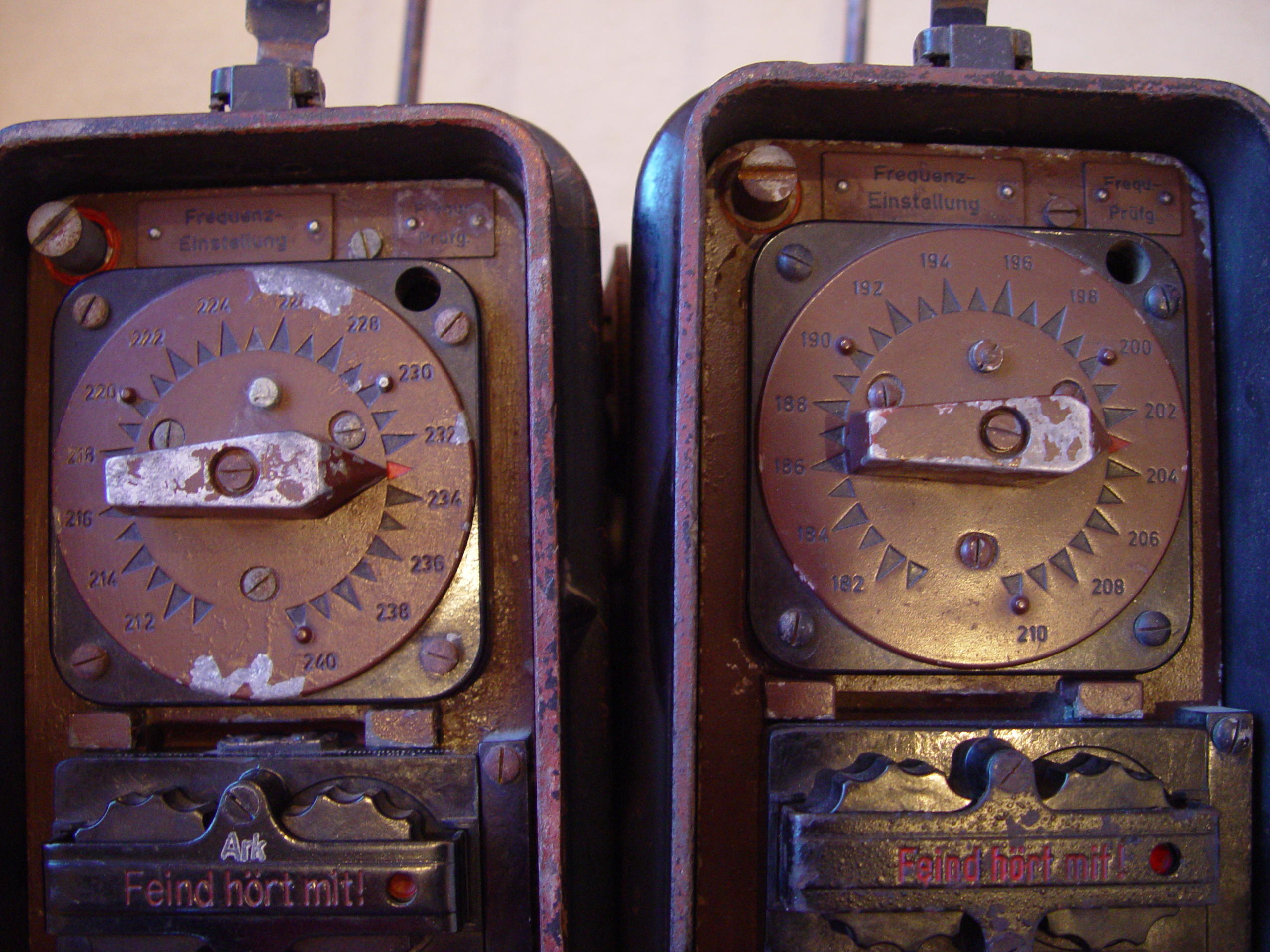

The Feldfunksprecher had to be tuned to the red channel (233 for the Feldfu.b and 203 for the Feldfu.c) with the receiver fine tuning set to the central position (so that the red dot is visible through the hole of the remote control unit). The Feldfu.b would pick up the fourth harmonic at 104 MHz while the Feldfu.c would use the sixth harmonic at 156 MHz.
After warming up for about ten minutes the static noise in the headphones of the Feldfunksprecher was checked. If a loud static could be heard, the tuning screwdriver was used to open the calibration opening (by turning the little screw on the top right of the Feldfunksprecher front panel) after which the trimmer behind the calibration opening could be reached with the screwdriver. The trimmer was now turned left and right until the static noise was at it's minimum.
The Fprüf.f could only be used to calibrate the receiver of the Feldfunksprecher, to test the transmitter a second calibrated Feldfunksprecher would be required. Typically this would not be required as the transmitter largely uses the same oscillating circuit as the receiver.
For transmitter testing, first the power output of the transmitter could be checked however using the "Senderprüfer a", a small dummyload fitted to the antenna socket of the Feldfunksprecher:
The "Senderprüfer a" should light up when the transmit button is pushed on the switchbox of the Kmf.c. Talking into the microphone should show a small variation in the strength of the light.

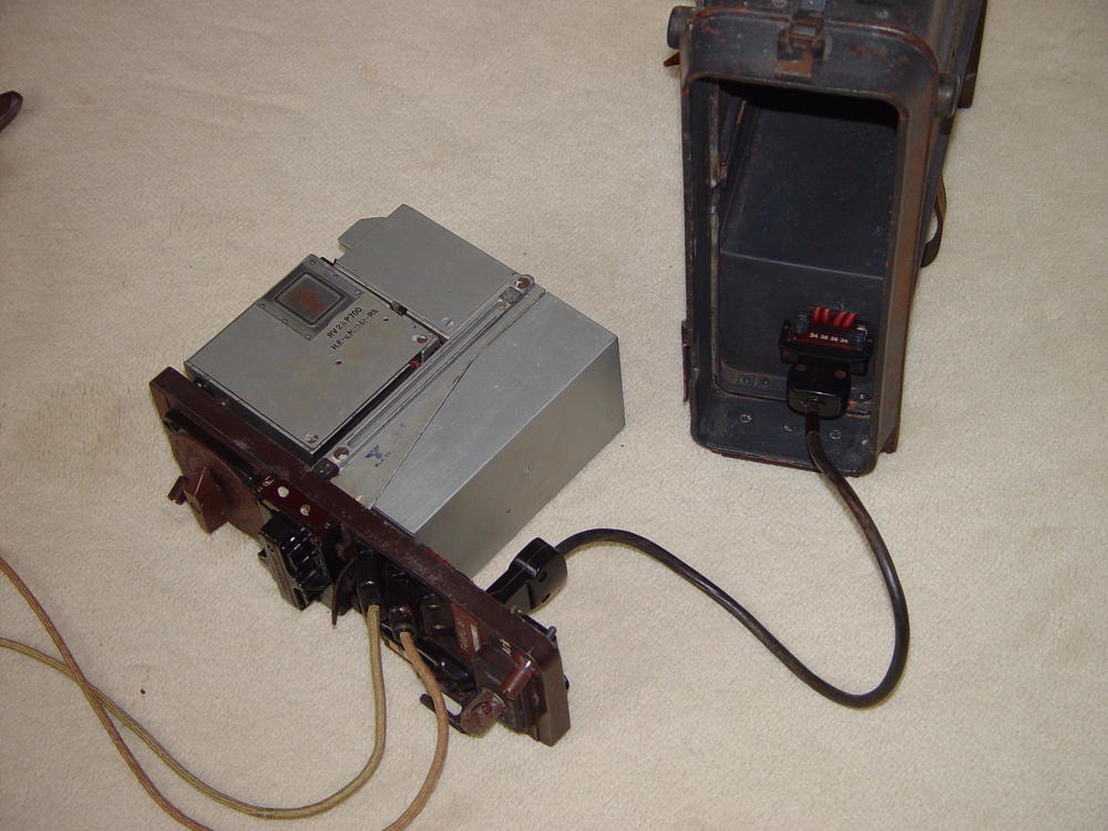

Because the transmitter calibration could not be done with the Feldfunksprecher fitted in its case, a "Prüfkabel" was used so that the Feldfunksprecher could be operated outside it's box:
With the "Prüfkabel" fitted, all the calibration controls inside the transceiver could be reached:
Note that the antenna is no longer connected in this configuration but the short antenna contacts on the internal unit would radiate enough energy to be picked up by a second Feldfunksprecher placed some meters away. Both Feldfunksprechers would be adjusted to the red calibration channel with the receiver fine tuning set to the central position.
The transmitter switch on the Feldfunksprecher under test would be pressed and the signal would be checked on the second Feldfunksprecher. If the strongest signal should be achieved well within the range of the receiver fine tuning control. If this was not the case, the transmitter calibration trimmer (C9 in the schematic) had to be adjusted.
With these tests and calibrations done, the Feldfunksprecher would be once again ready for operation.

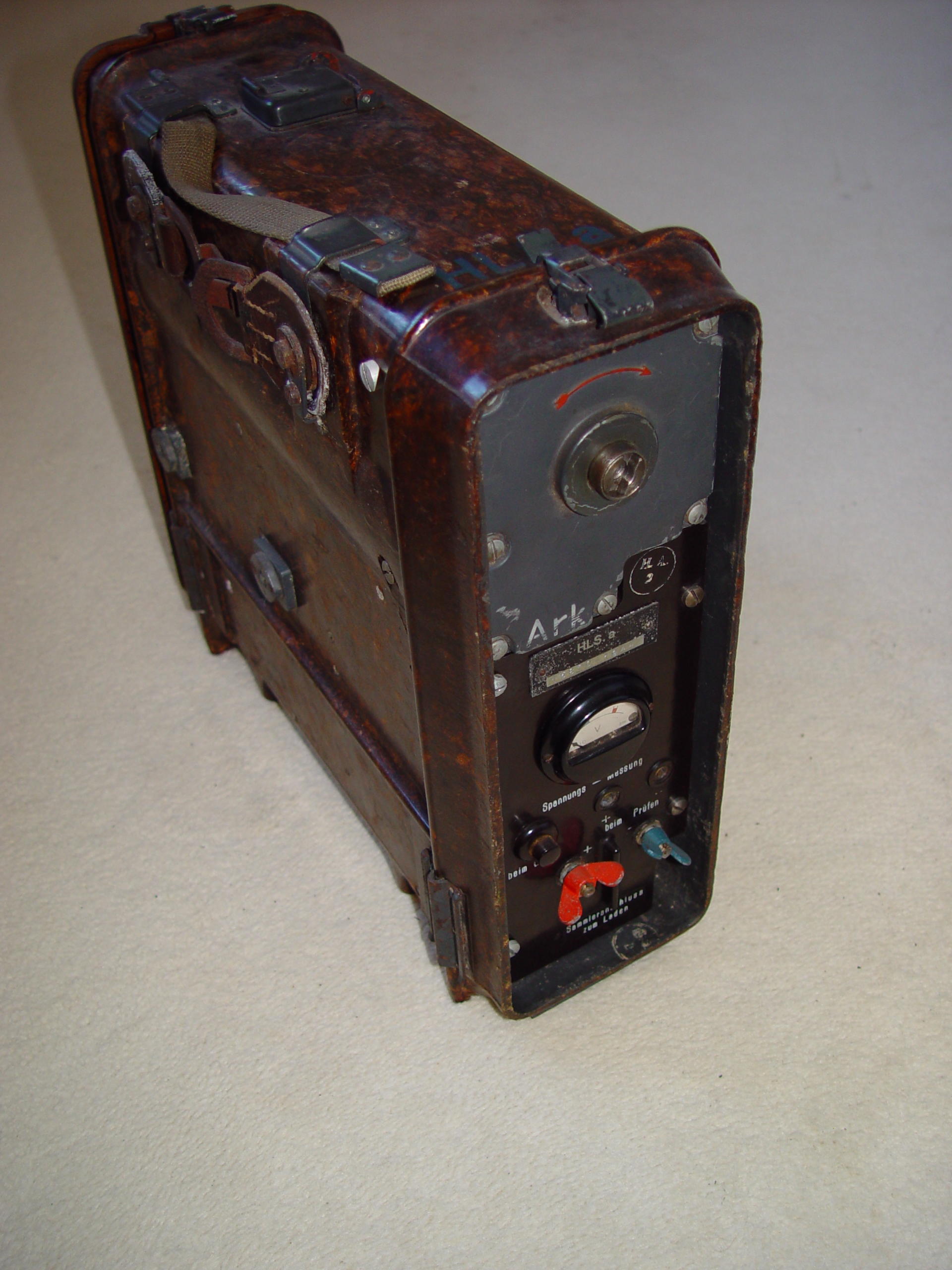

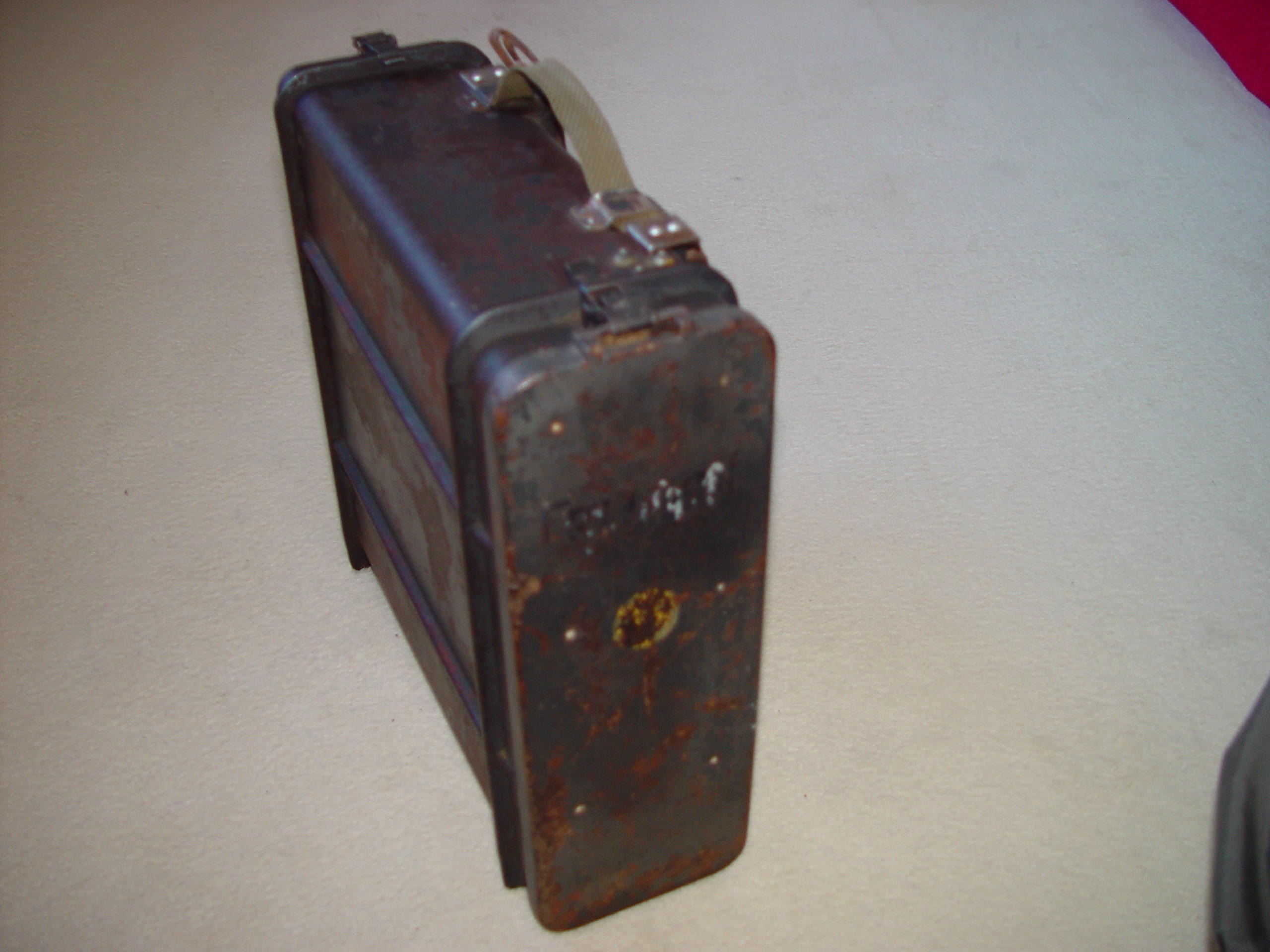

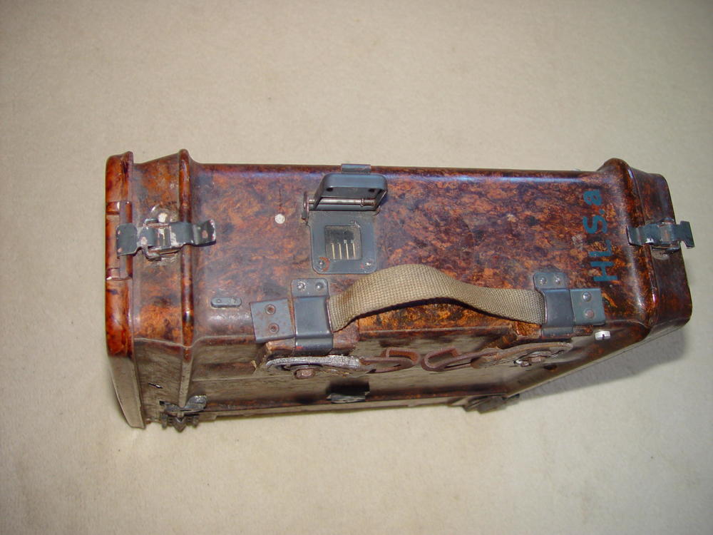

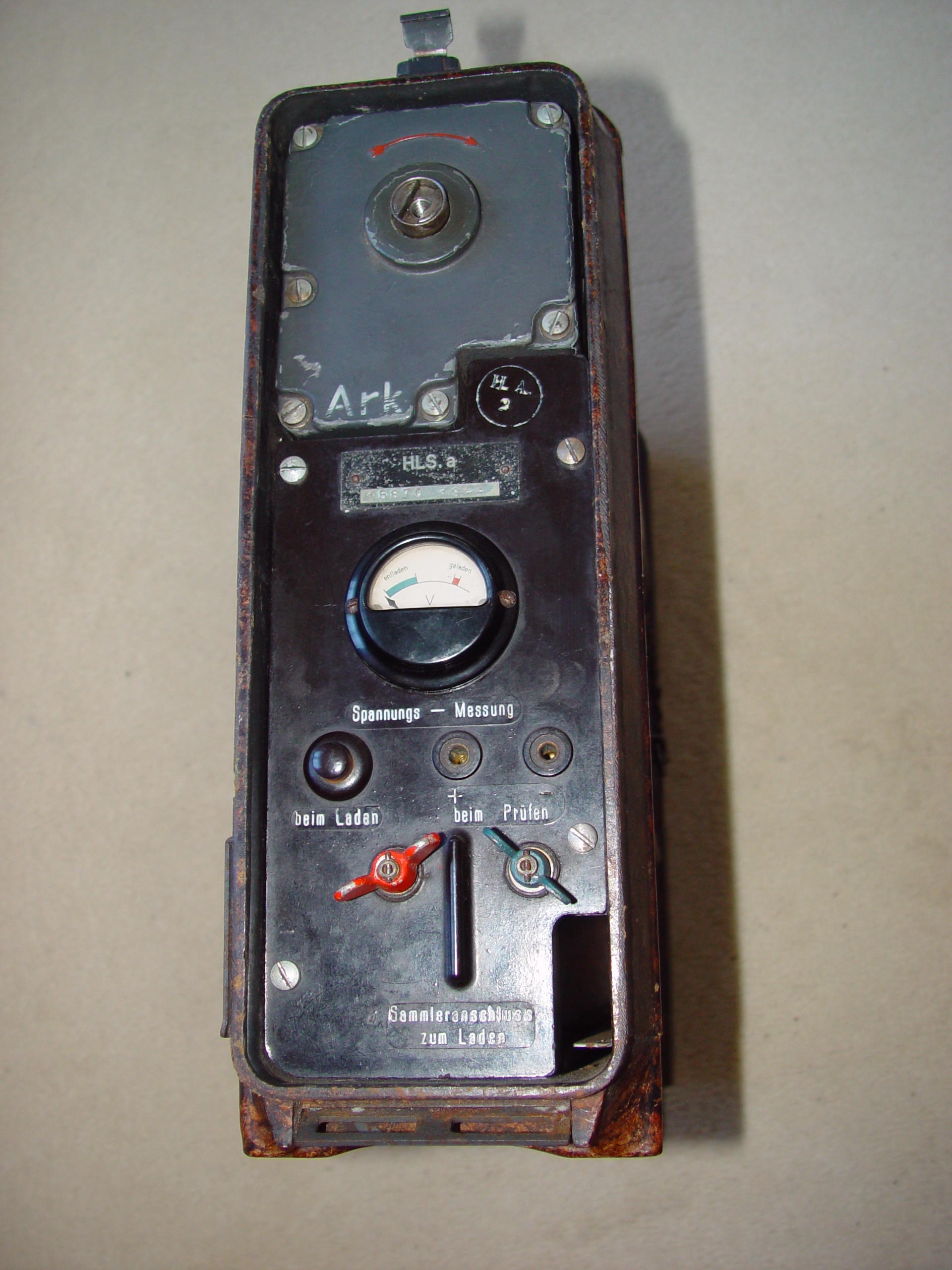

A second auxiliary unit required to keep the Feldfunksprechers operational would be the "Handlasesatz a" (HLS a), a hand operated battery charger. Again the bakelite housing of the Feldfunksprechers was used to house the charger so that it could easily to carried in the field to wherever the Feldfunksprechers were used:

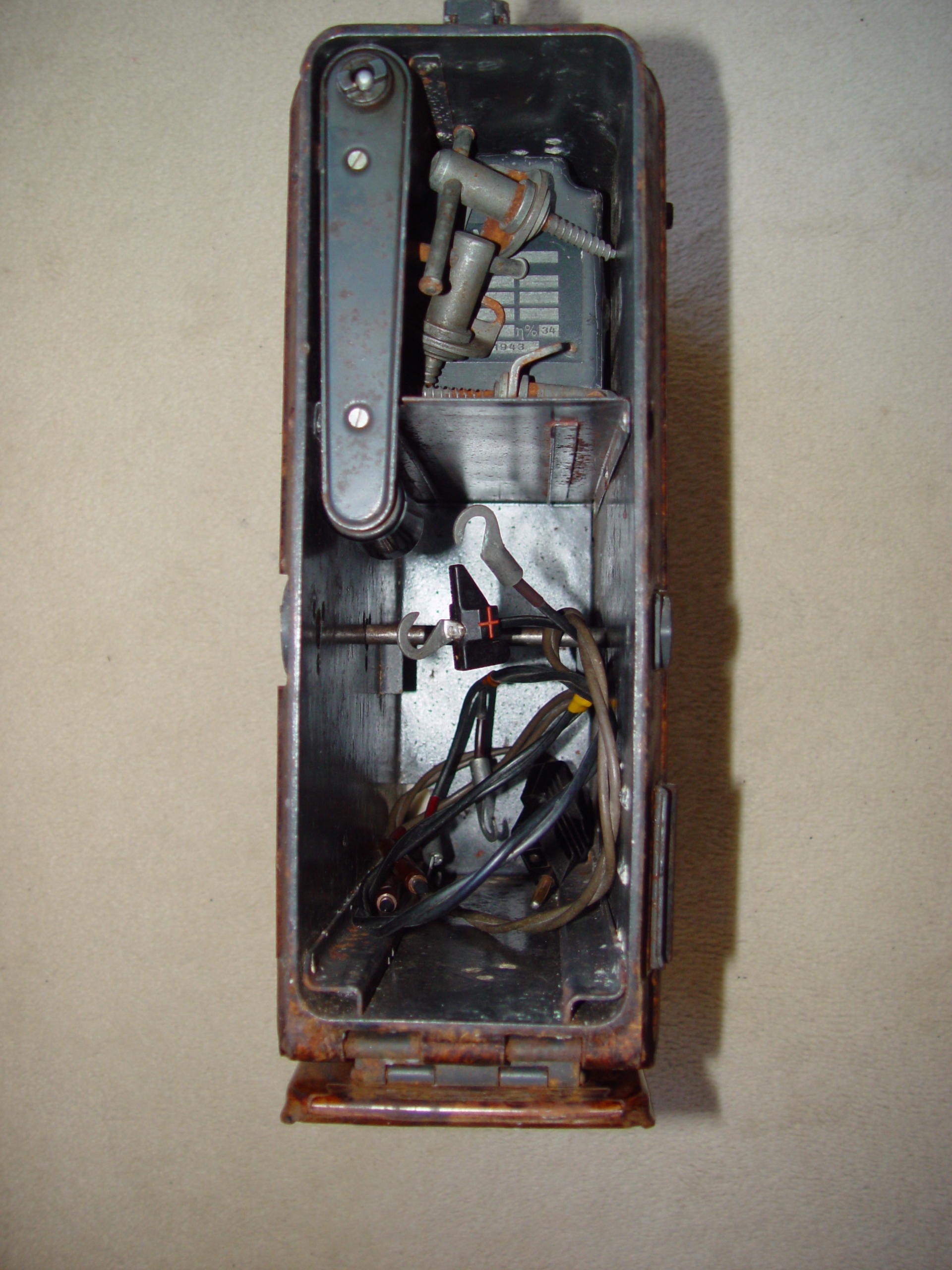

The bakelite housing the the HLS.a was left unpainted, strangely the inside of the housing did receive a coat of paint. The front panel contains the generator at the top and a battery tester plus connections at the bottom.
The back of the HLS.a contains a storage space for up to two 2.4 NC 28 batteries, hand crank, loading cable, test cable and tree anchor:
The top of the box shows a small window under a cover. The HLS.a legend is painted in blue paint and a blue elongated feeler shape tells the HLS/a apart from all other versions:

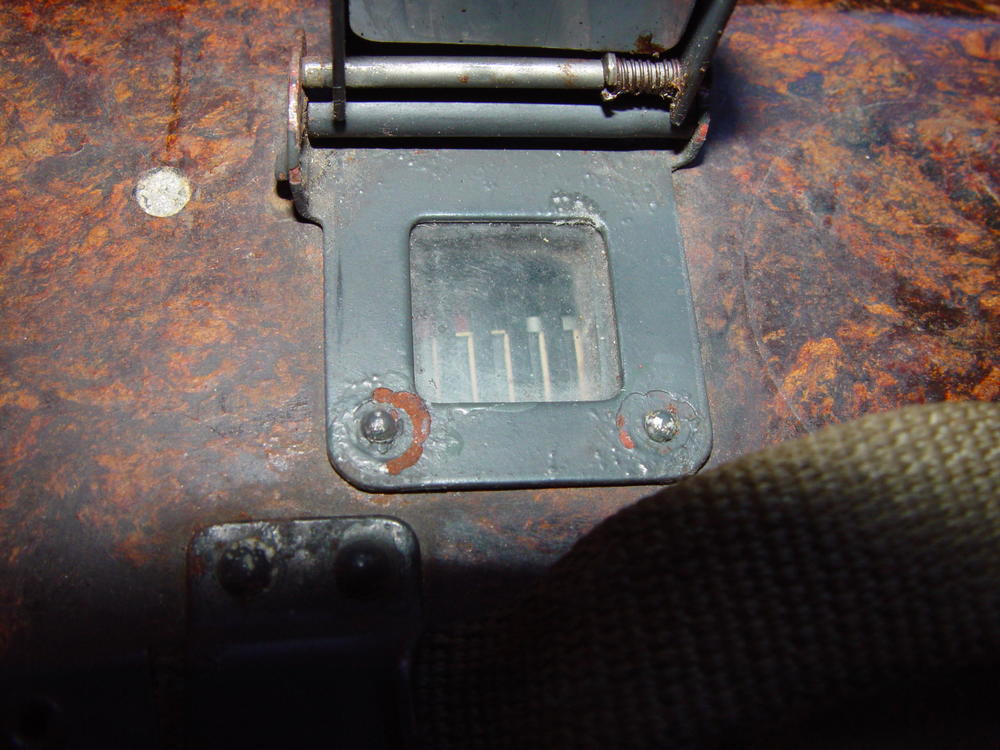

The small window allows the speed indicator of the generator to be observed. A mirror inside the protective lid could be adjusted so that the indicator can be obverse while cranking the handle. This allows the user to keep the generator turning at the right speed for loading the batteries:

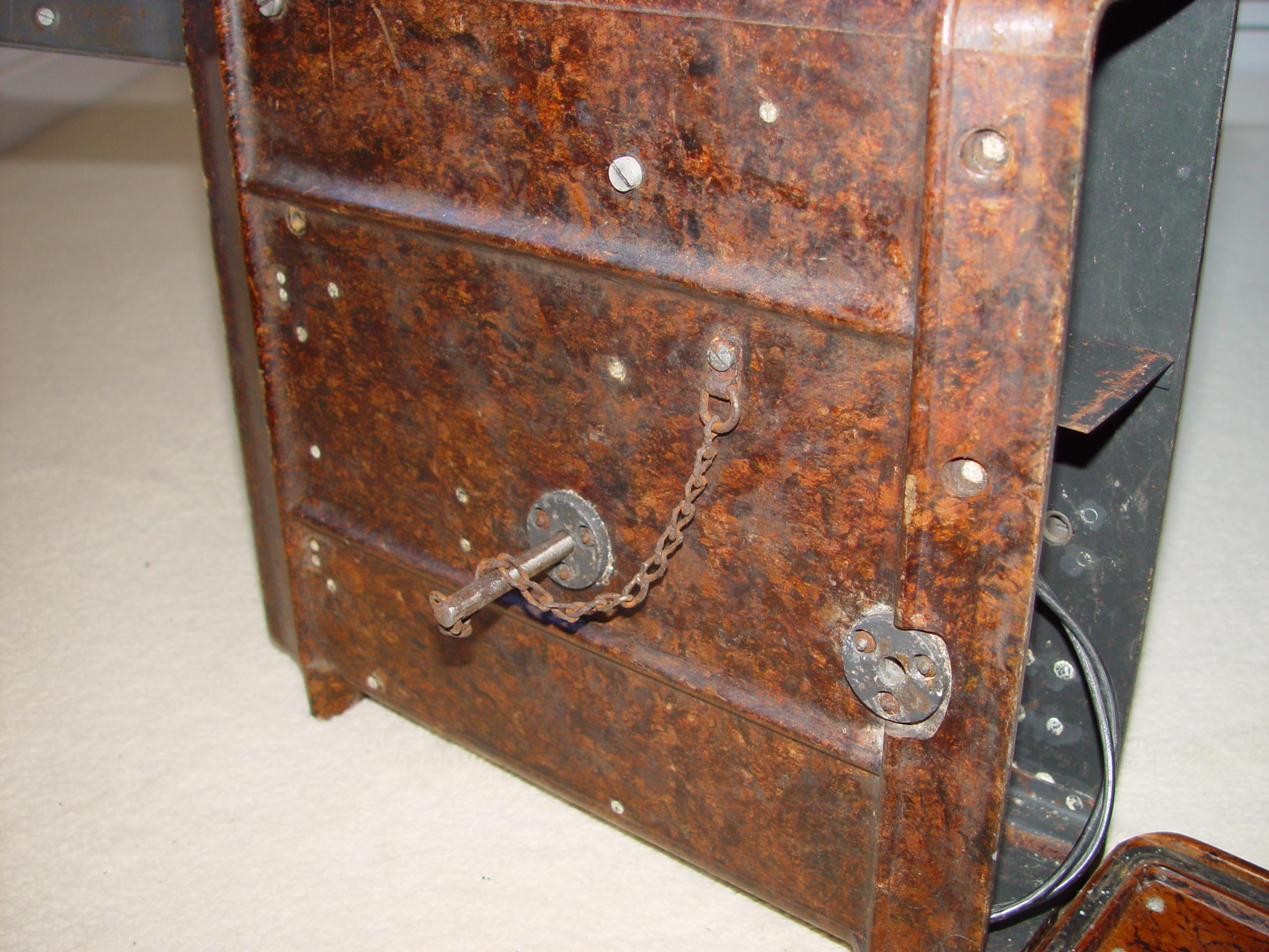

the back of the panel shows a chained pin which can be secured in one of two holes. This allows either one or two 2.4 NC 28 batteries to be locked in place inside the box:

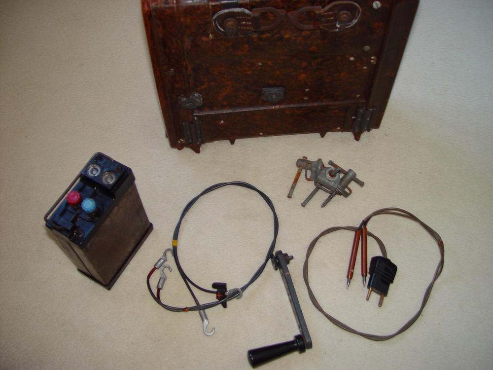

The accessories and cables are shown separately, the strap of the tree anchor is missing here. The metal brackets could be screwed into a tree so that the HLS.a could be securely tied to the tree at a convenient height.

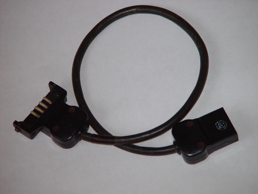

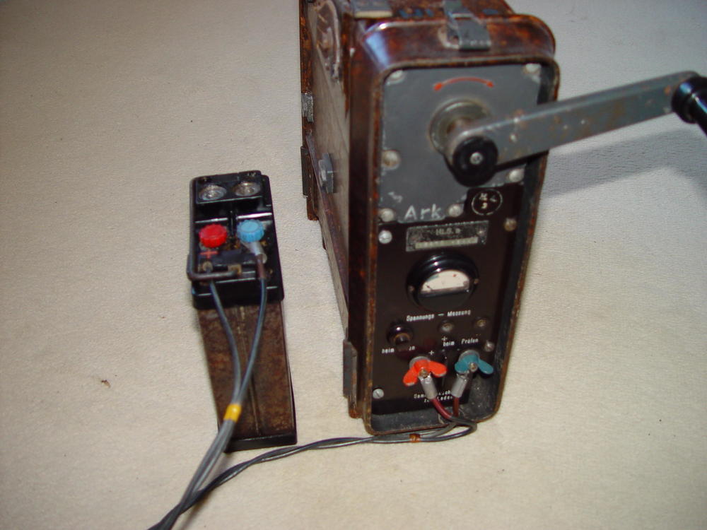

The 2.4 NC 28 could be tested with the test cable and the battery tester:

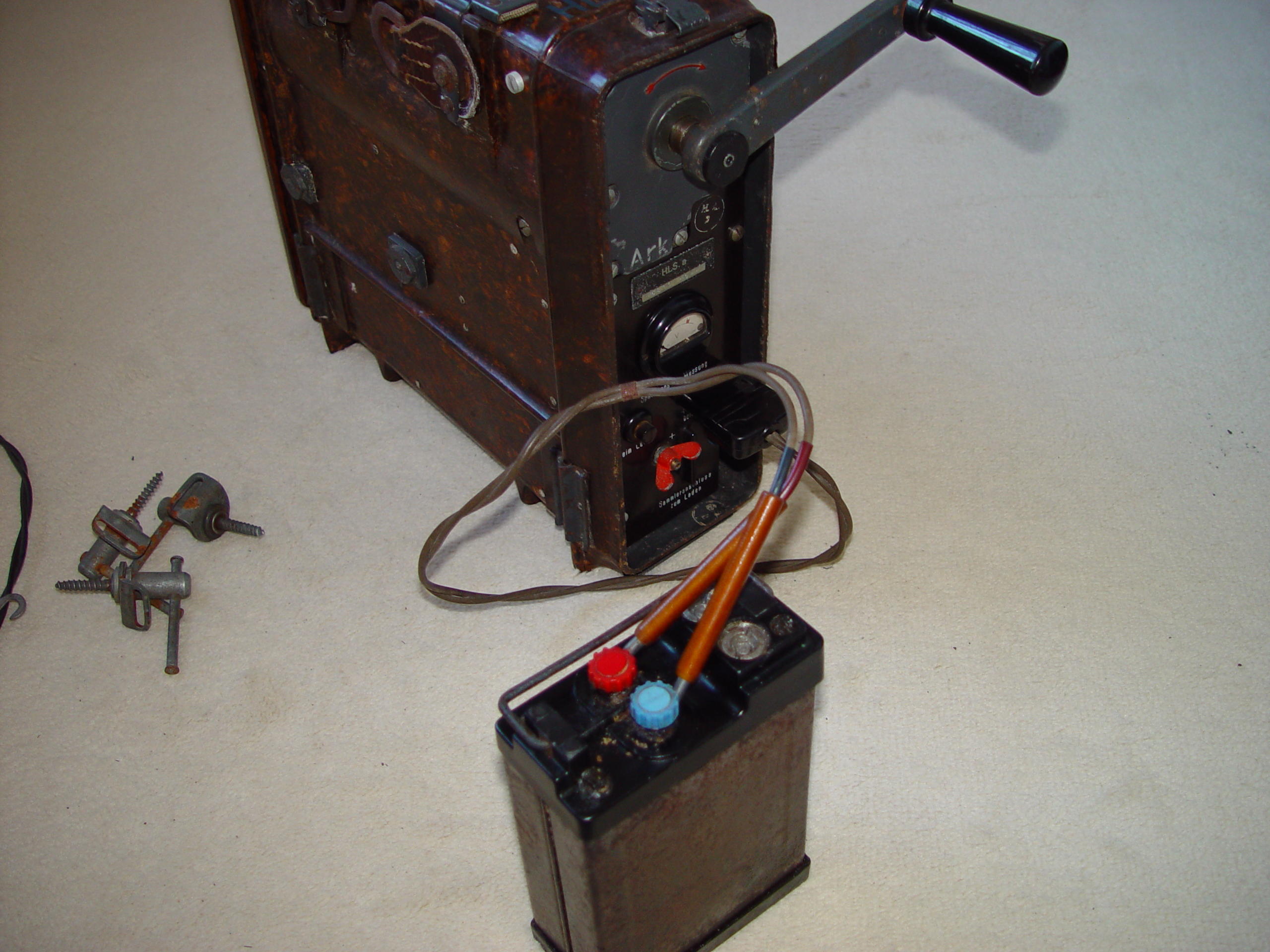

If the battery required charging, it would be connected to the charging cable. If the battery was connected via the charging cable, it could also be tested by pushing the test button on the battery tester. With the crank handle fitted to the generator, the HLS.a is ready for charging:
Charging the battery with the HLS.a was a lengthy business. The HLS.a could supply a maximum loading current of 4 A, meaning that a full charge of a 2,4 NC 28 battery would take seven hours!
Normally, the battery under charge was placed inside the HLS.a, the charging cable was fed through a hole on the right bottom to the interior of the charger. The battery would be secured using the pin on the side:
I can imagine that "charging duty" was not very popular with the soldiers. It is likely that turns were taken to operate the HLS.a. This also explains why the tree anchor was such an essential accessory, as he HLS.a had to be fixed in the most comfortable position for the lengthy charging process. It would probably have been a 24/7 job to keep a Company's four Feldfunksprechers up to charge....

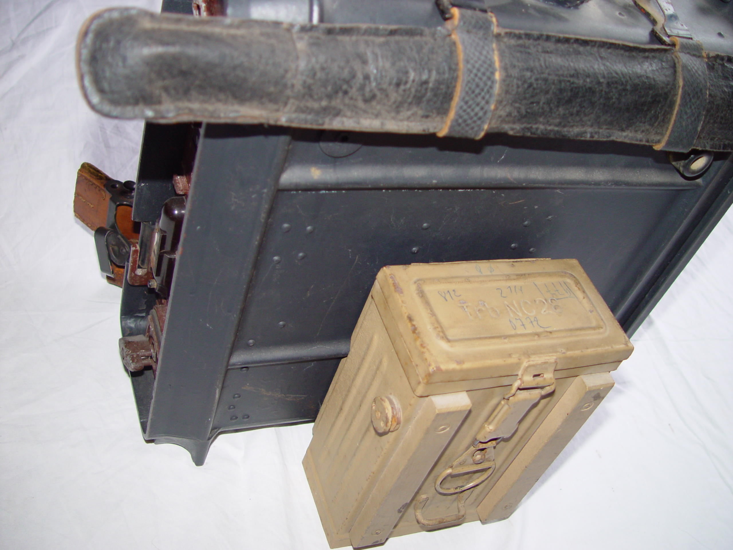

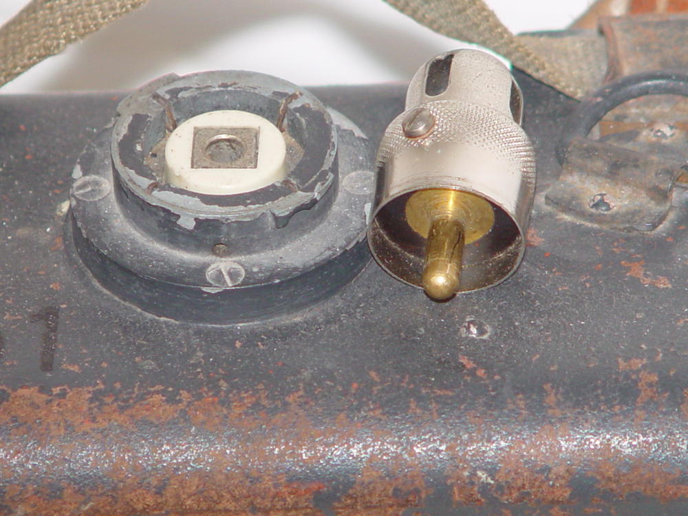

Another late war accessory developed to extend the autonomy of the Feldfunksprechers was the Trb NC 28 (Trageblech NC 28) battery case for an extra 2.4 NC 28 battery. The 2,4 NC 28 battery fits snugly into the box:
The Trb NC 28 was designed to fit against the back of the Feldfunksprecher; it was supposed to be connected by some leather straps and hooks to the D-rings of the Feldfunksprecher.
However no Trb NC 28 has ever been found with the original straps attached, all boxes found today appear to be unfinished products recovered from factory stores (and judging from the writing on their lids, used postwar as storage containers for nuts and bolts etc.)

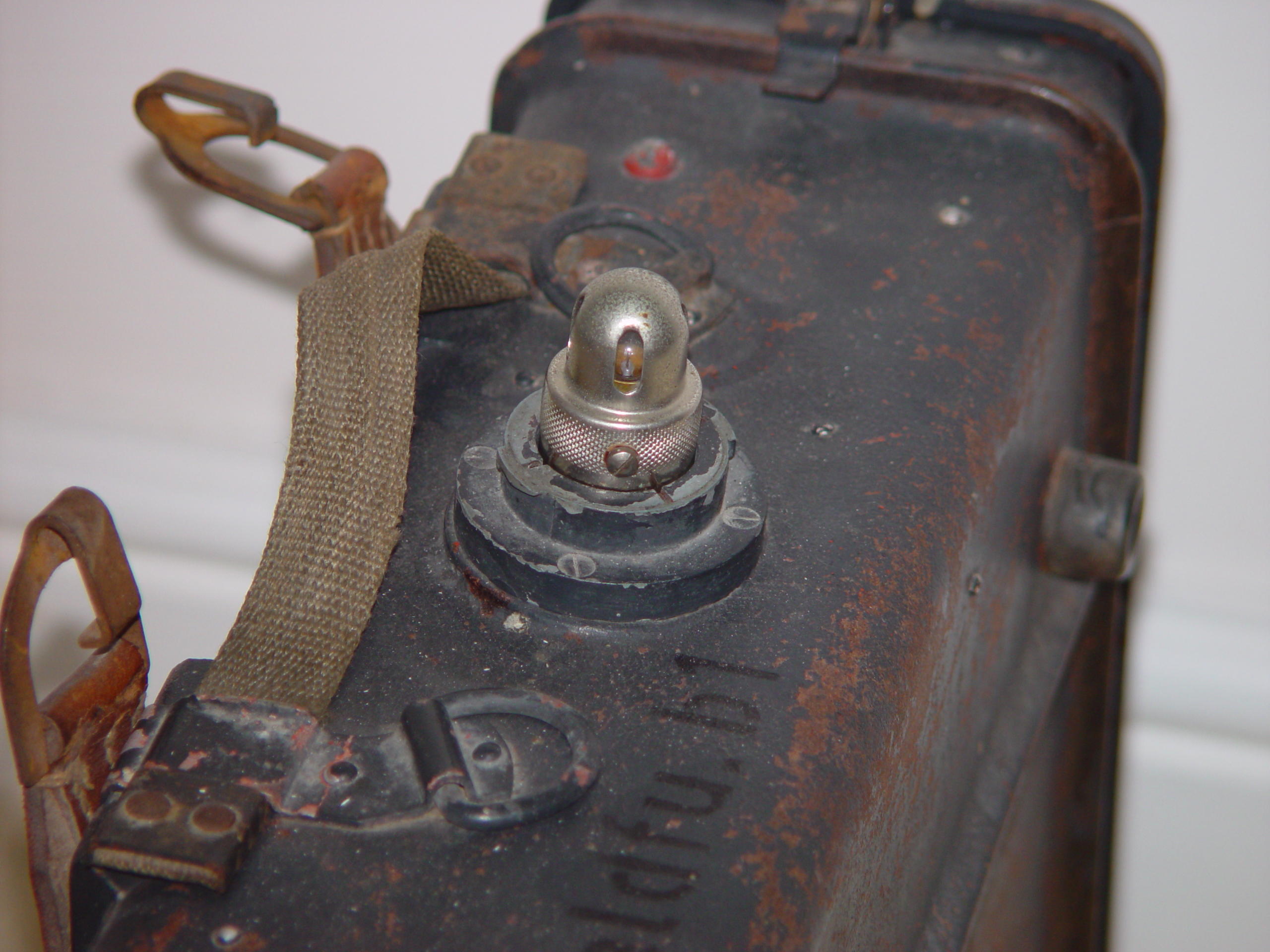

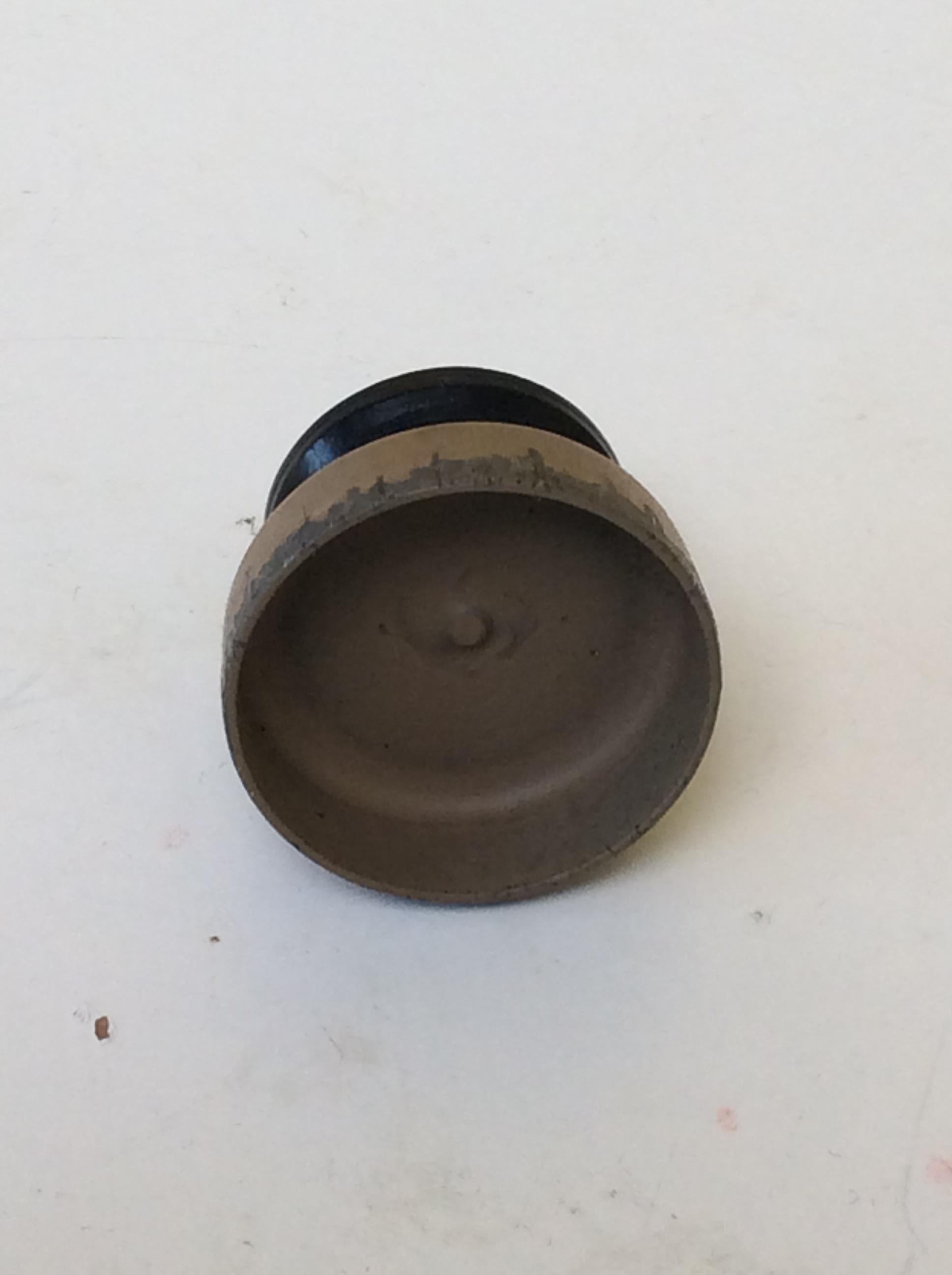

 interesting  item , there was a rain cover  that plug in antenna base
when antenna is stowed inside the  box
Do have any pictures of that rain cover?
Thank you for the numbers, @tornfuté
Val first i have to find in which feldfu i have put it , it’s a replica made by Hutter
like the original one .

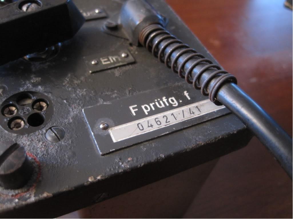

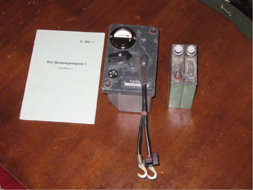

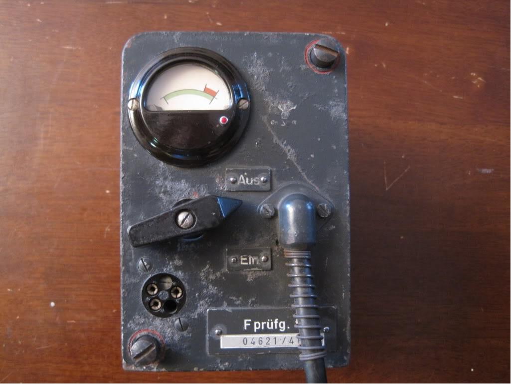

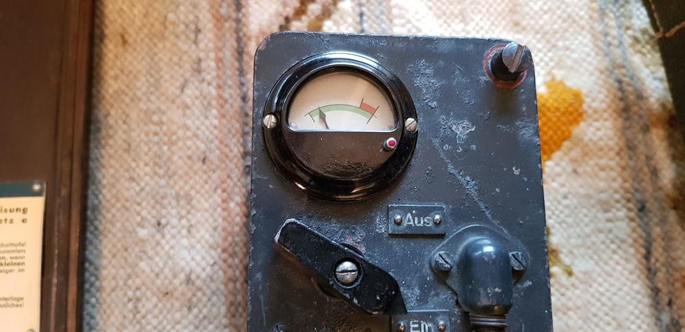

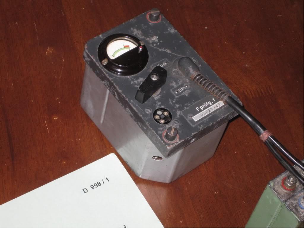

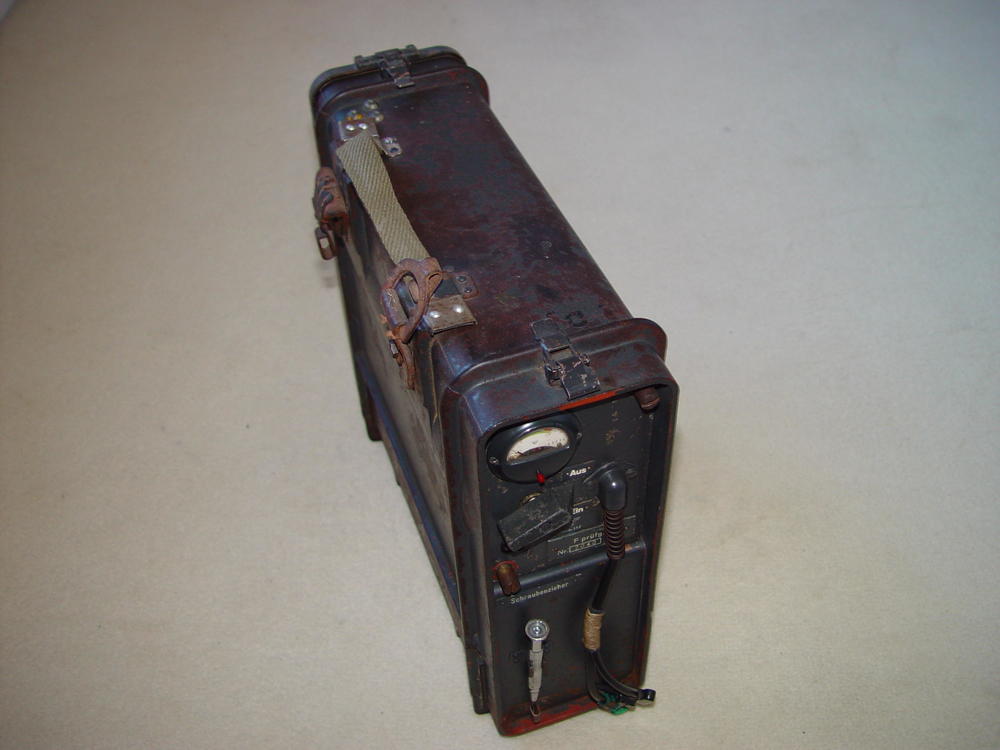

I do have a Frequenzprüfgerät f in my collection, but unfortinently without it's bakelite casing. However it is in working condition, and I have been using it to calibrate my radios.
It's a early apparatus, 1941 dated.

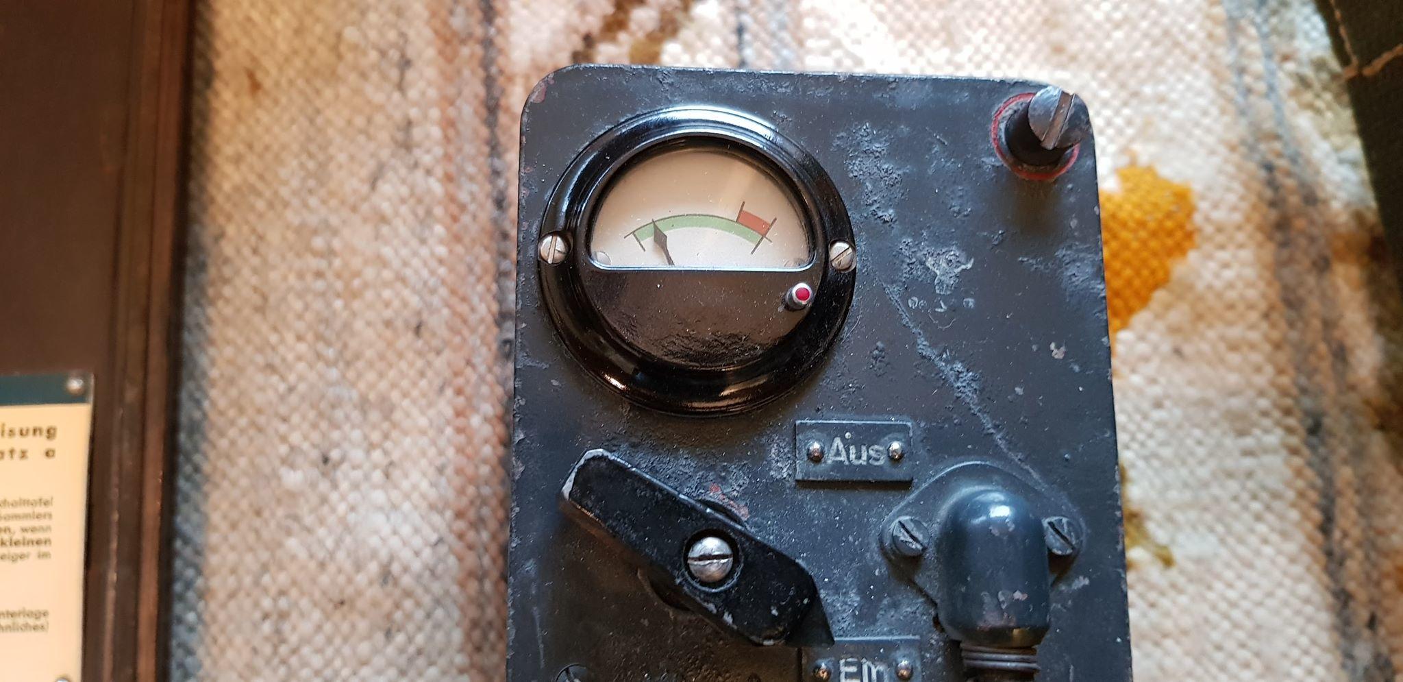

Frequenzprufgeratf074.thumb.jpg.3532b398a42d2ccfdf69e8a862230c72.jpgFrequenzprufgeratf012.thumb.jpg.4ce0e9ac793a1d386b4bdf569e5b69be.jpgFrequenzprufgeratf070.thumb.jpg.cfdbbfff572cac455d19a4351f961b55.jpgFrequenzprufgeratf006.thumb.jpg.9ecf1ffdf0ec8c442c23f29fa5ba65c1.jpg

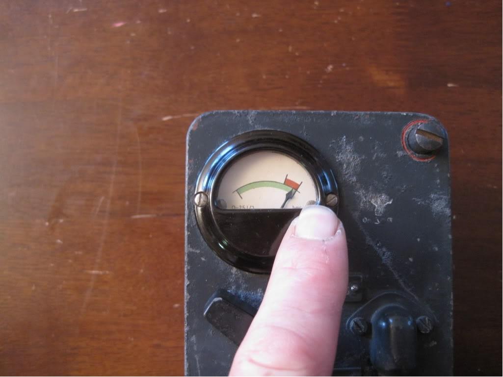

When the needle is within the green area, the frequensprüfgerät f is sending a signal that can be detected on the Feldfunksprecher radios.
According to the users manual the Frequenzprüfer should be situated around one meter from the radio, when calibrating. But I've found that the Feldfunksprechers can recive the signal from 10 to 20 meters away without problem.

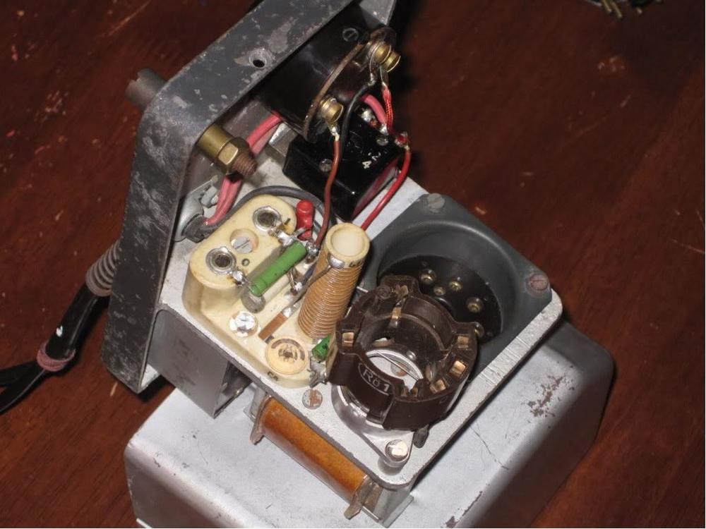

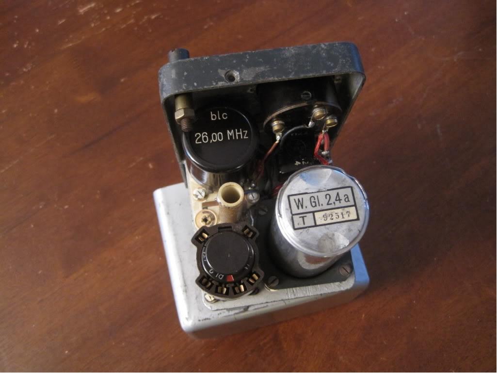

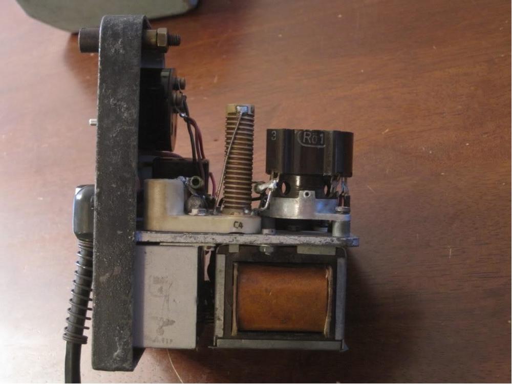

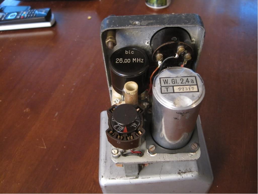

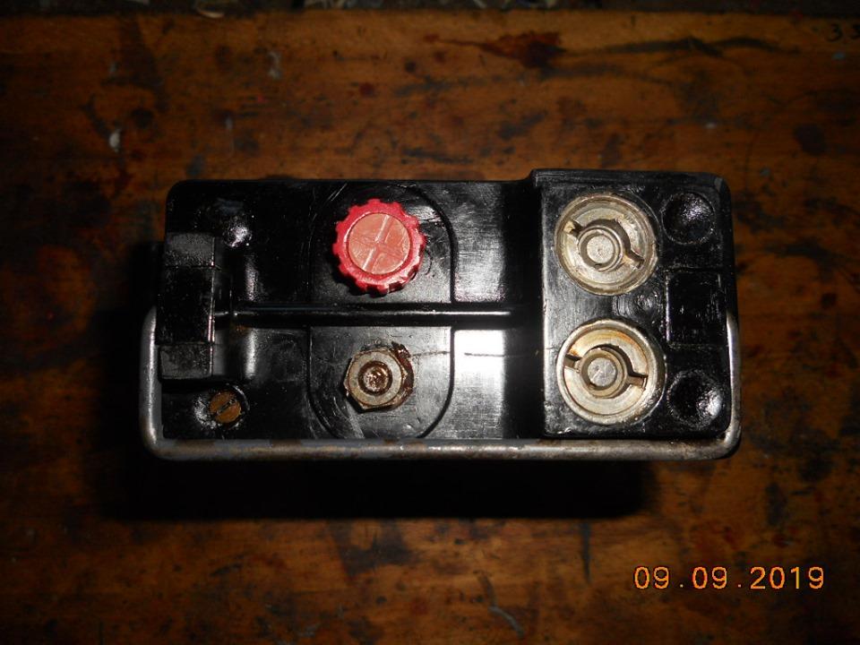

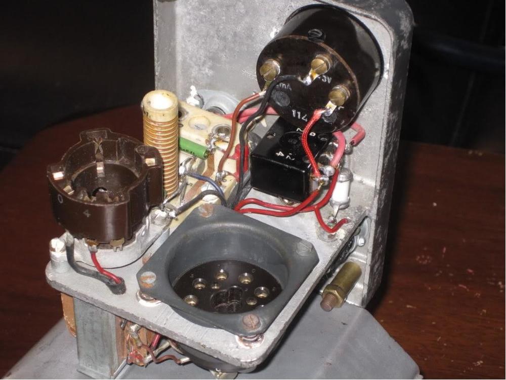

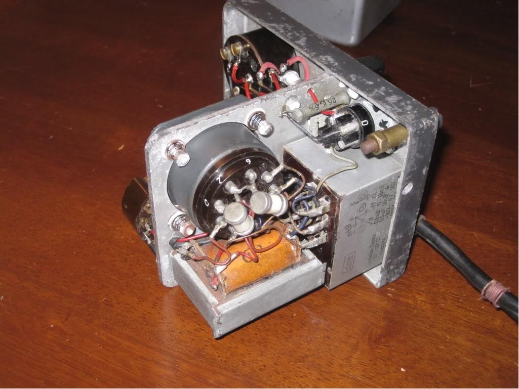

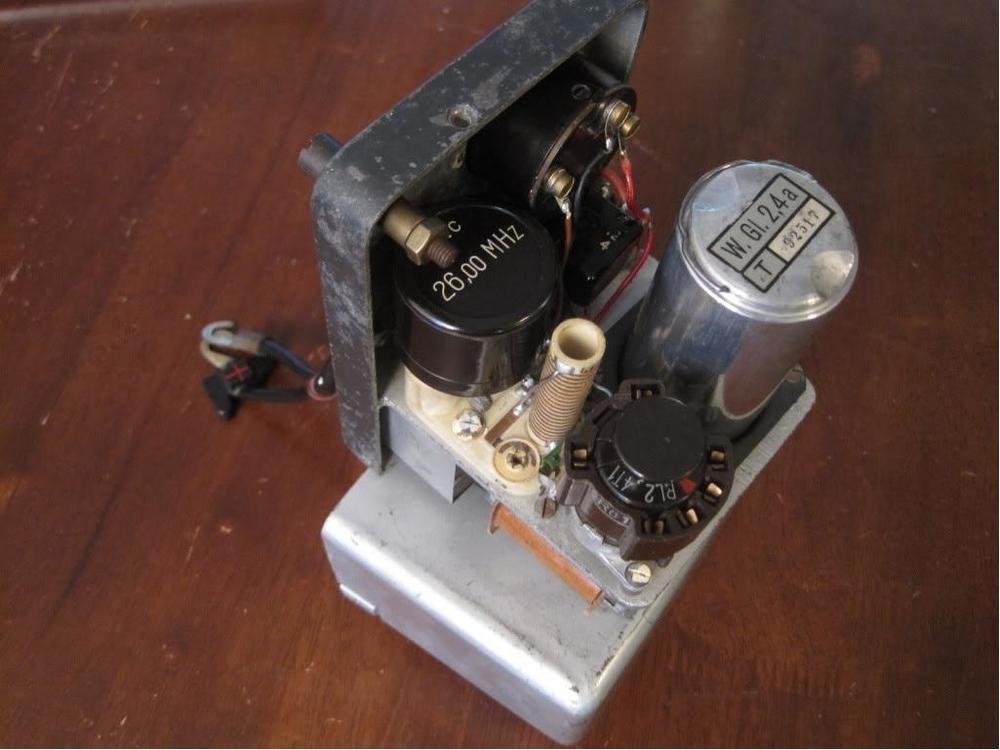

Here are some pictures from the inside of the Frequenzprüfgerät f (undernieth the cover)
Frequenzprufgeratf077.thumb.jpg.2e9eaf3bf1597395dda0ae8236c53c14.jpgFrequenzprufgeratf107.thumb.jpg.69182a16464042388a1fa174bc98f359.jpgFrequenzprufgeratf121.thumb.jpg.972fb1ec42776ab83b640a2ca7ff4051.jpg

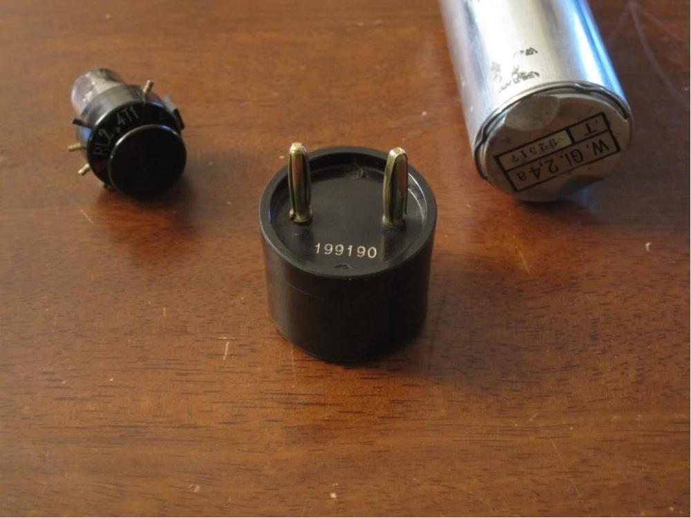

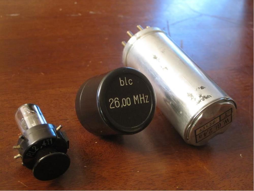

And some pictures with the RL2,4T1 tube, the 26MHz crystal and the Zerhackerpatrone removed.
Frequenzprufgeratf013.thumb.jpg.55d8ce803e98886d0d09fdfb484a1b40.jpgFrequenzprufgeratf016.thumb.jpg.f105b4e14e7247f6c97e76e3a7780a52.jpgFrequenzprufgeratf017.thumb.jpg.228399e70f3de9f1014dbc3b6ed34a14.jpgFrequenzprufgeratf030.thumb.jpg.3f9d1c3d132c7352189a5751e402a7f5.jpgFrequenzprufgeratf063.thumb.jpg.333315de911960a95f0c501169f4c4b0.jpgFrequenzprufgeratf050.thumb.jpg.8bd44b6a0405922bb2453c92bf038aae.jpg
A very interesting device, wich only needed a cleanup of the contacts inside the vibrator/Zerhackerpatrone to come back to life.

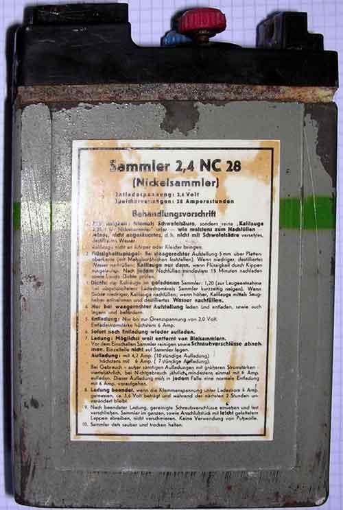

But lets talk a little bit about the batteries for the Feldfunksprecher, the 2,4NC28.
The name 2,4NC28 stands for: 2,4 Volt - Nickel - 28 Ampere hours.
the NC abbreviation is often misunderstood today, and translated to Nickel Cadmium. This is wrong, as these batteries are Nickel Iron batteries.
[EDIT] : New undisputeable information presented to me proves me wrong in my last sentence here. These batteries are indeed Nickel Cadmium batteries!

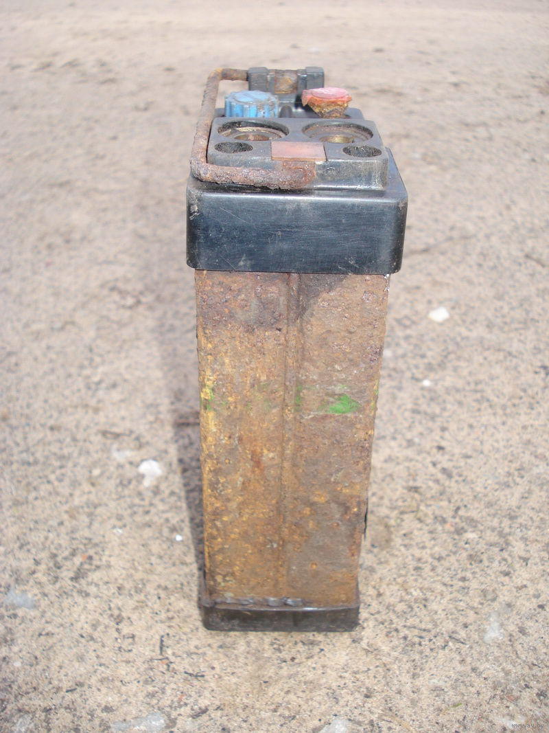

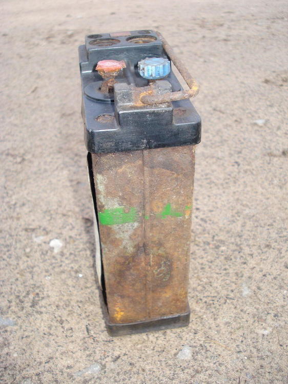

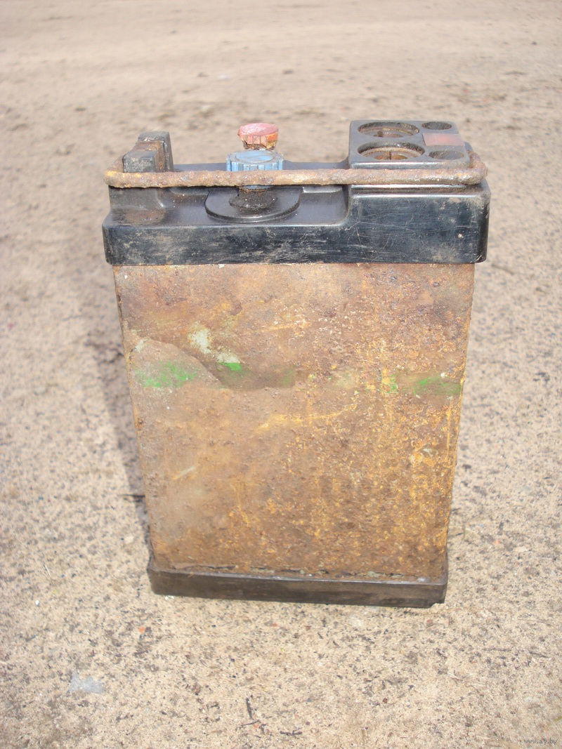

I do not know how rare these original batteries are today, but I have found that they can be quite hard to find. And most of the batteries that surface today, are ground dug specimens from the battlefield in Russia.
However they do show up from time to time, but I would say that 99% of the good condition batteries that show up are either repainted, or missing their labels and original paint all together.
The main reason for this, is that spills of the elecrolyte inside these batteries, potassium hydroxide or Kaliumhydroxid - also known as Kalilauge has dissolved and ruined the original paint on these batteries.
The few pictures that i have found of 2,4NC28 batteries, that shows original paint points toward a light gray  color with a green horizontal stripe around the body of the battery.
Edited by Björn
Wrong information was unknowingly posted.

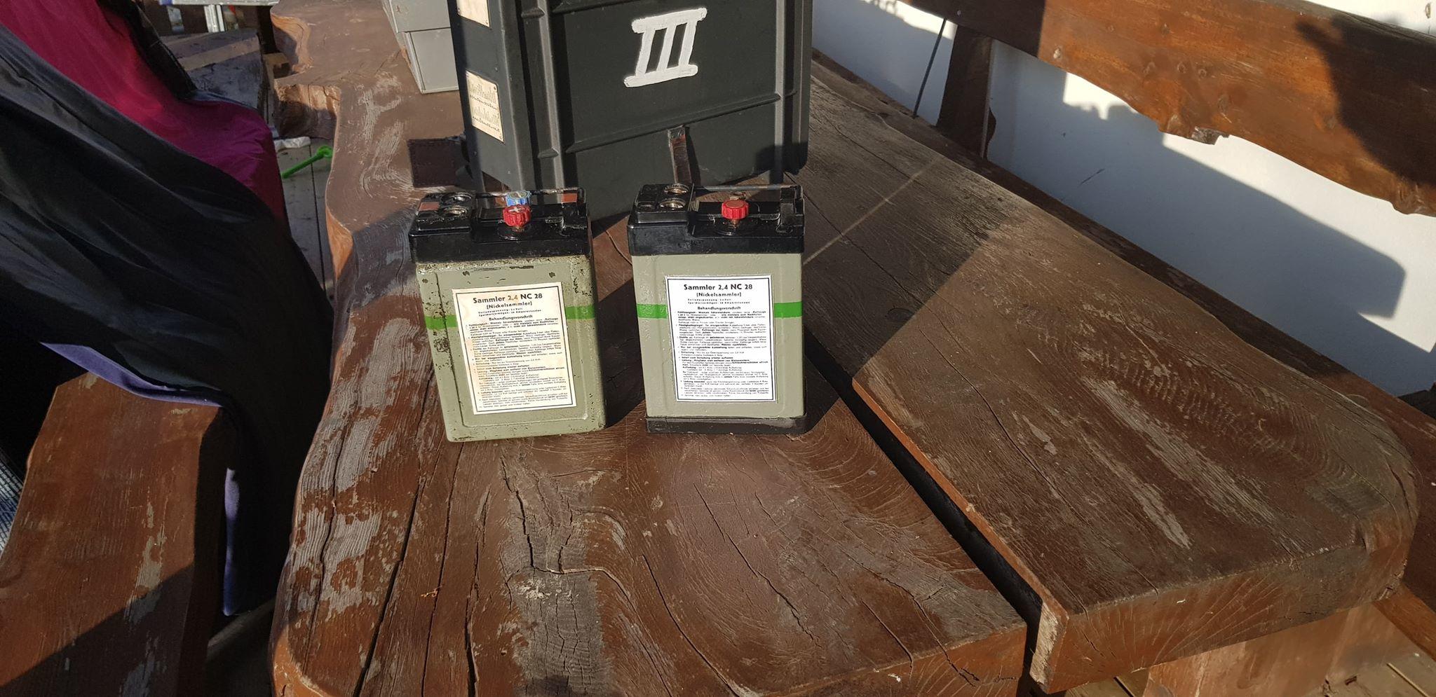

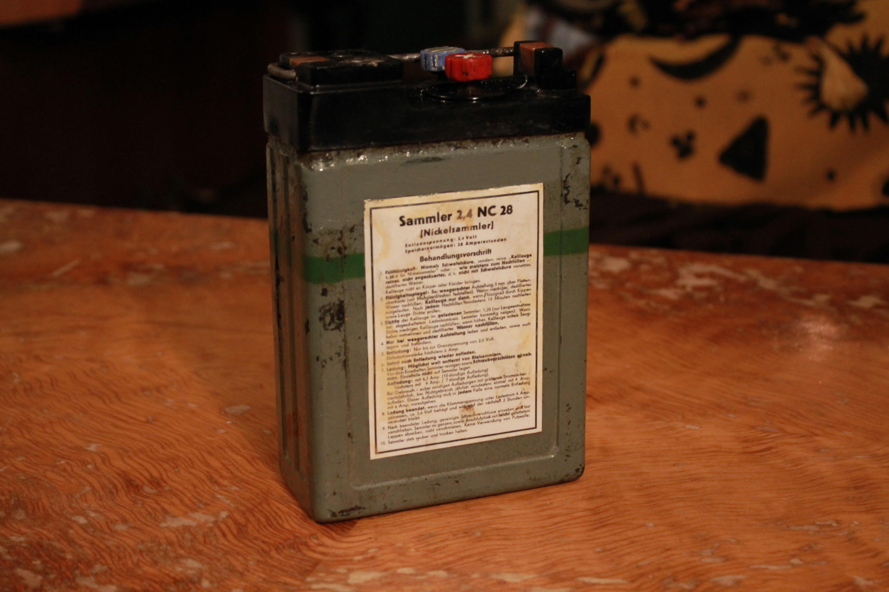

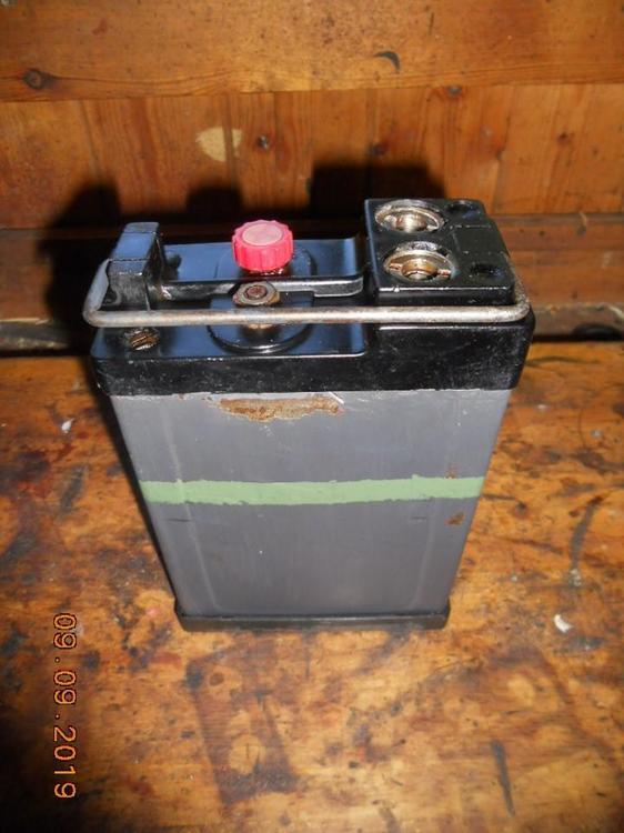

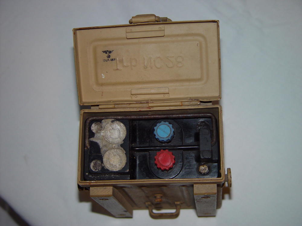

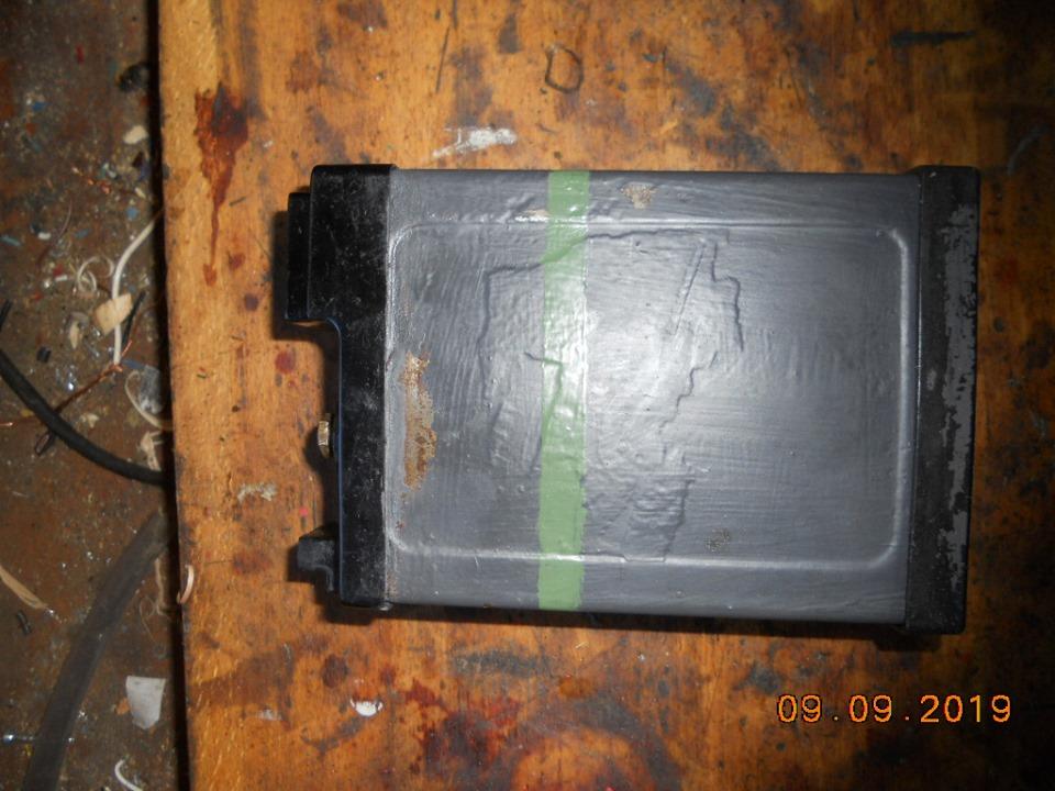

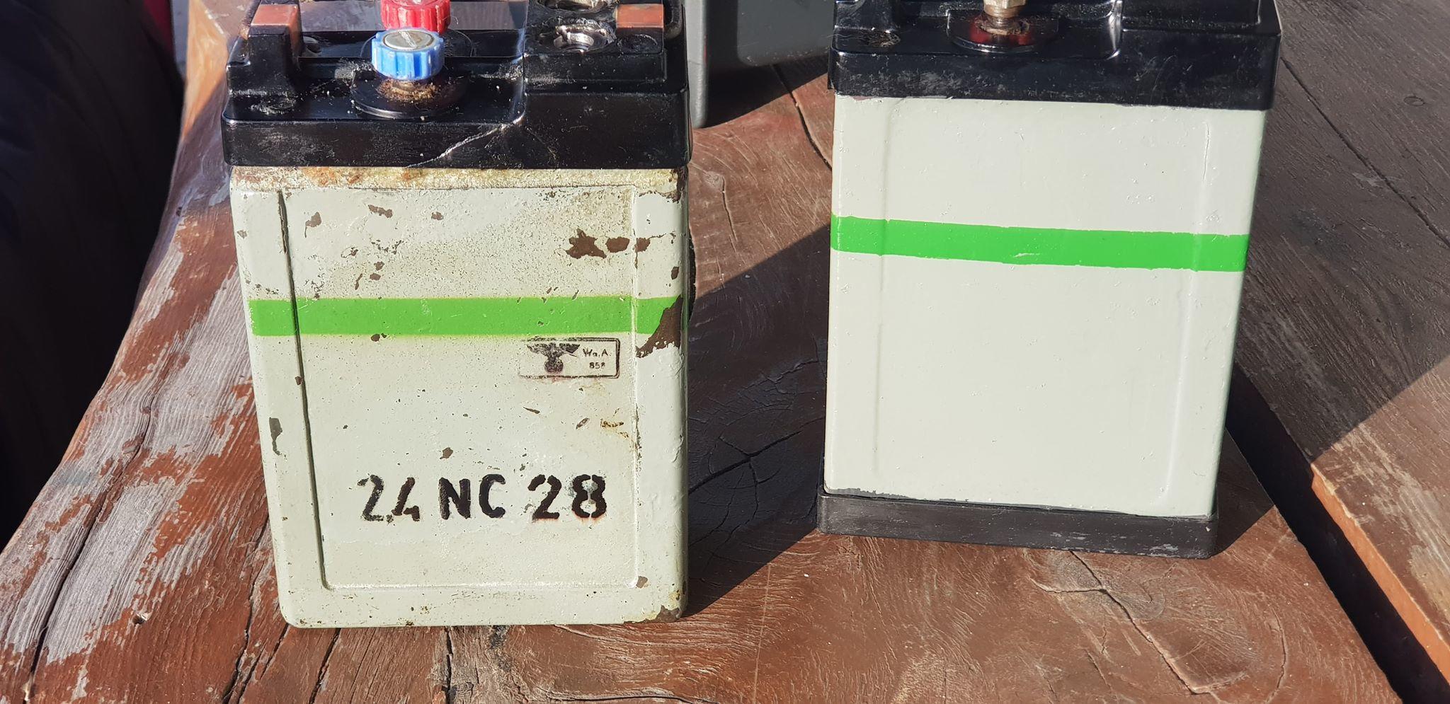

About one year ago, I was very lucky to get hold of a original battery in very good condition, with original paint and label intact.
02.thumb.JPG.7e62978cf41d707978cc5afaa11b7007.JPG01.thumb.JPG.6967416cb26964d4dffa409654abb58a.JPG

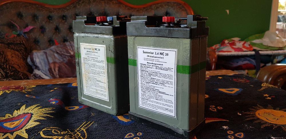

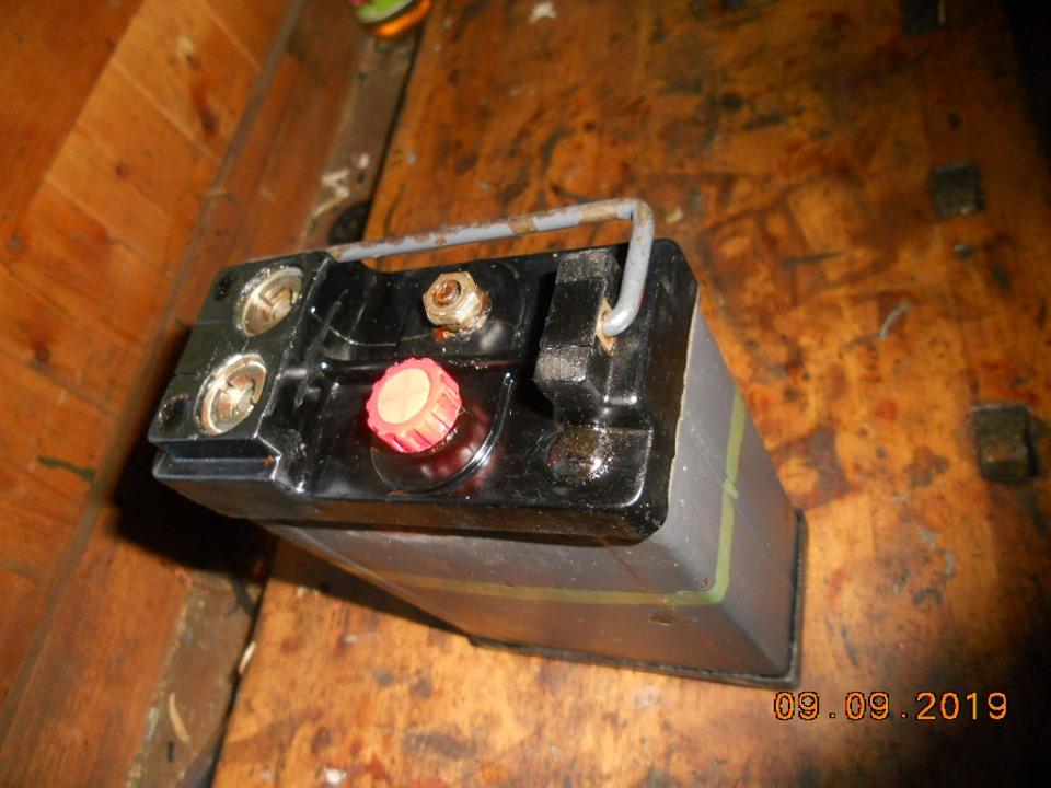

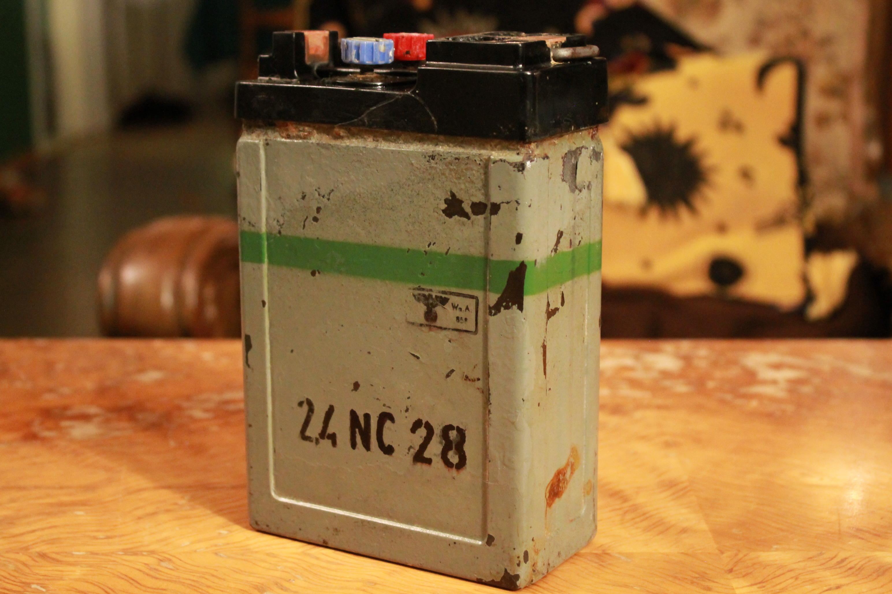

And just a couple of weeks ago, I managed to trade for another 2,4NC28 battery from a collector-friend here in Norway. This battery was in quite good condition, but was repainted in a wrong color scheme. And It was missing it's original label as well.
03.jpg.393dee27e34cf09e1ba8a6a84e8b2909.jpg 04.jpg.042e66977451b4ace05f0a7d226c6a3a.jpg05.thumb.jpg.ef83d7b03a469f5f6967da06b40769ed.jpg06.jpg.f4d98fbdbadf8796314c5bb3531240dd.jpg

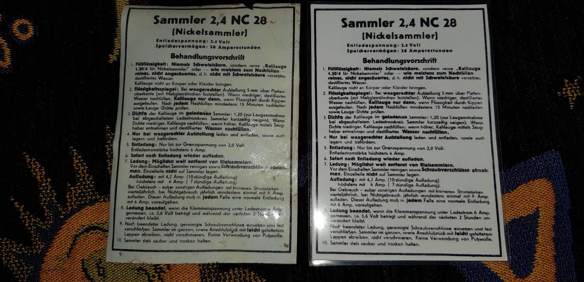

About the label for the battery. I do have a loose original ground dug label wich I picked up on ebay a few years ago.
I took this label and scanned it in high resolution, and cleaned up the image on my computer.
I then printed out a few copies in the exact same size as the original, on photo paper. I then laminated the labels to protect them from damage from elecrtolyte spills from the battery.
In the next picture, we see the original ground-dug label to the left, and the new, reproduced and laminated label to the right:
I then brought the battery that I have with the original color preserved, to a local paintshop in my town, where they have a scanner that can scan paint color and shade, and then mix an exact match. I got a small box of paint with the same color as the original battery, and cleaned and repainted the new battery that I got a few weeks ago.
I'm quite happy with the resault. I have not yet gotten around to get the 2,4NC28 lettering stencilled on the new battery yet, but with the new color and label it looks quite good, I think.
But here's where it gets even more interesting. This type of batteries - originally a Thomas Edison Patent from 1901, are potentially still capable of being in working and serviceable condition.
I know, it sounds like a far reach, but Thomas Edison said in 1910, that his batteries would last for a 100 years..
Look at this article that I came across just recently:
https://newatlas.com/scientists-give-new-life-to-thomas-edisons-nickel-iron-battery/23102/?fbclid=IwAR2Y2riBBhgJbZ6bDjYIX0s16MotmuwnzEjk0HNo7XLMHq20_abBmzKHW90
They can possibly be revived and recharged and put into the Feldfunksprecher radios and used today - almost 80 years after they were made.

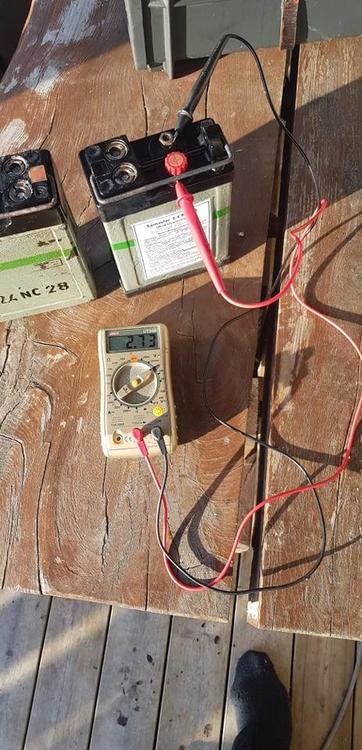

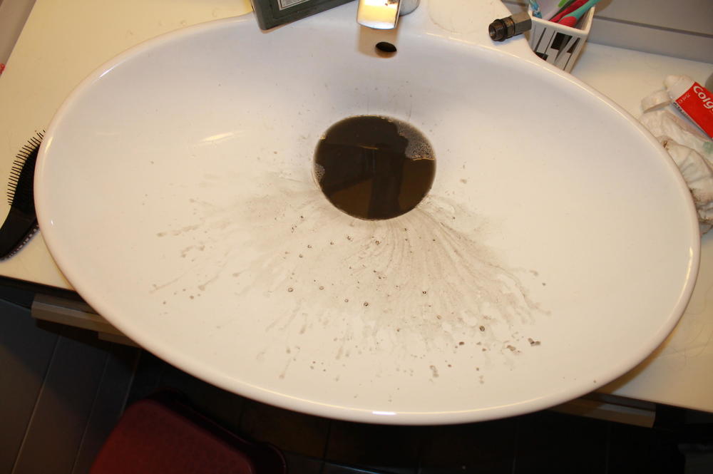

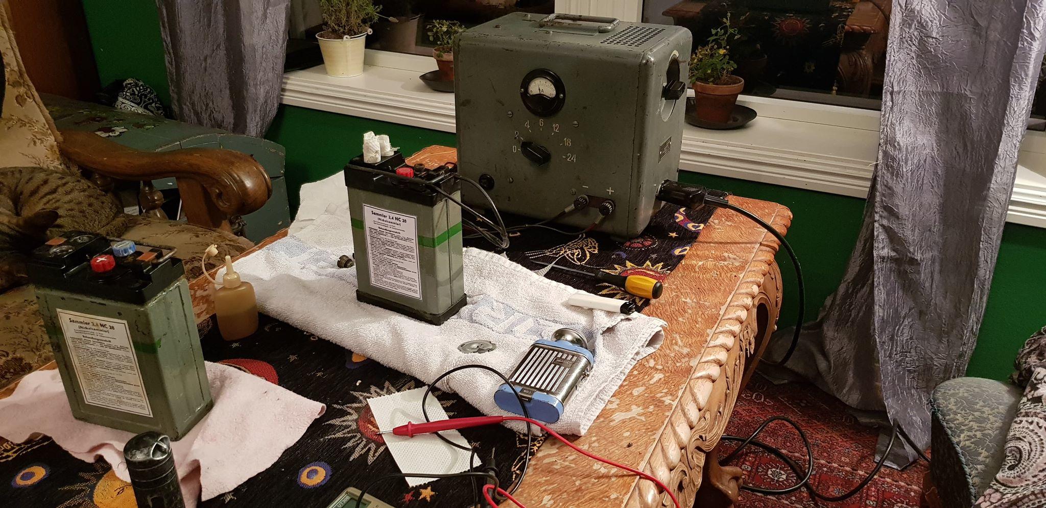

So I bought some pre-mixed Kaliumhydroxid from ebay, washed the batteries inside by filling a bit of Kaliumhydroxid in them, shaking them good and emptied them a few times, until what came out of them was clean kaliumhydroxid, void of any dirt and grime.
Here's what I got out of one of the batteries, in my bathroom sink:

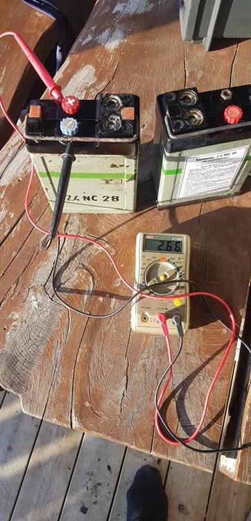

And then I put the batteries on charge for around 10 hours each with 2 Volt and 3,5 Ampere.
And belive it or not, here's what I got today:
15.thumb.jpg.e625c61afcaea1e3833ced647f35d66c.jpg16.thumb.jpg.06db8e243737b5b20bd9fa0c5edb1f3f.jpg

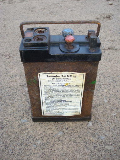

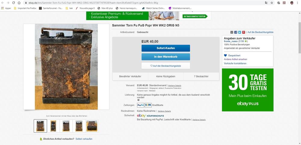

There is a dug up 2,4NC28 for sale on ebay at the moment.
I must admit that I am tempted to buy it, but I think it's a bit pricy regarding the condition. The shipment cost is as much as he want for the battery alone.
It could however be a interesting experiment to see how the battery would react to get new electrolyte and a charging cycle ☢️
But chanses are that this one is a deceased specimen. But on the other hand it could also be cosmetically restored into a non-working display object.
