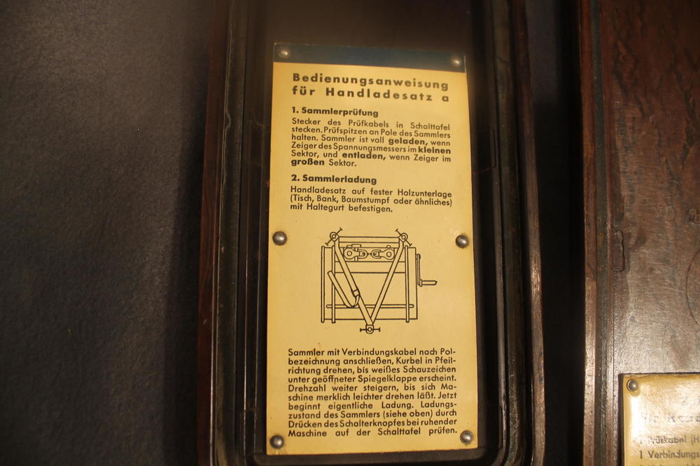

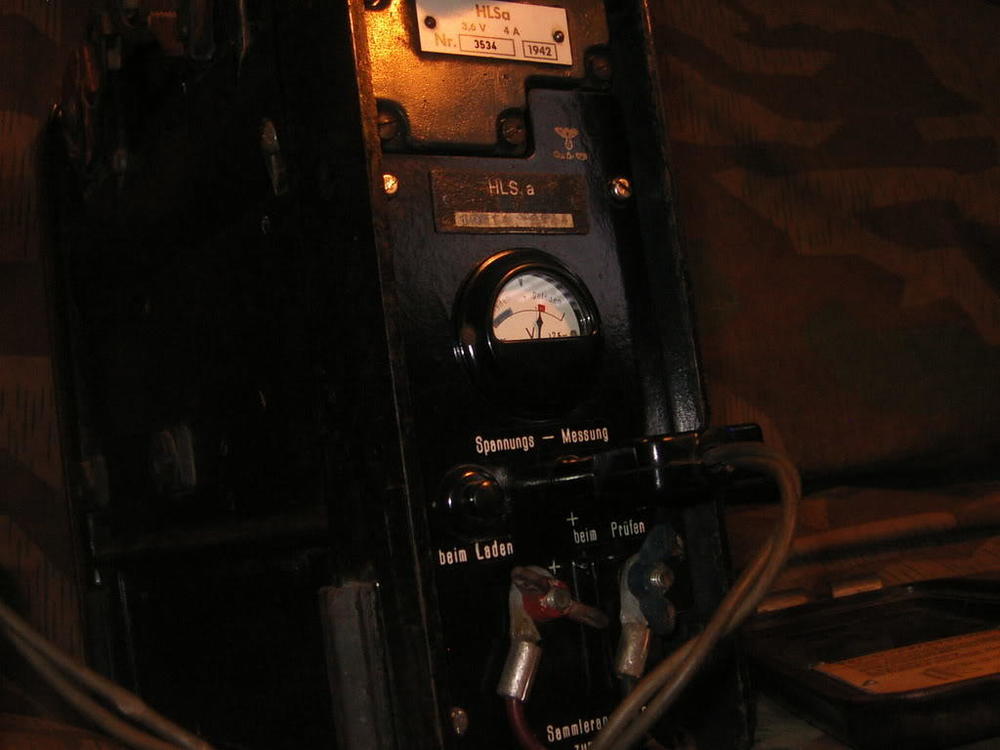

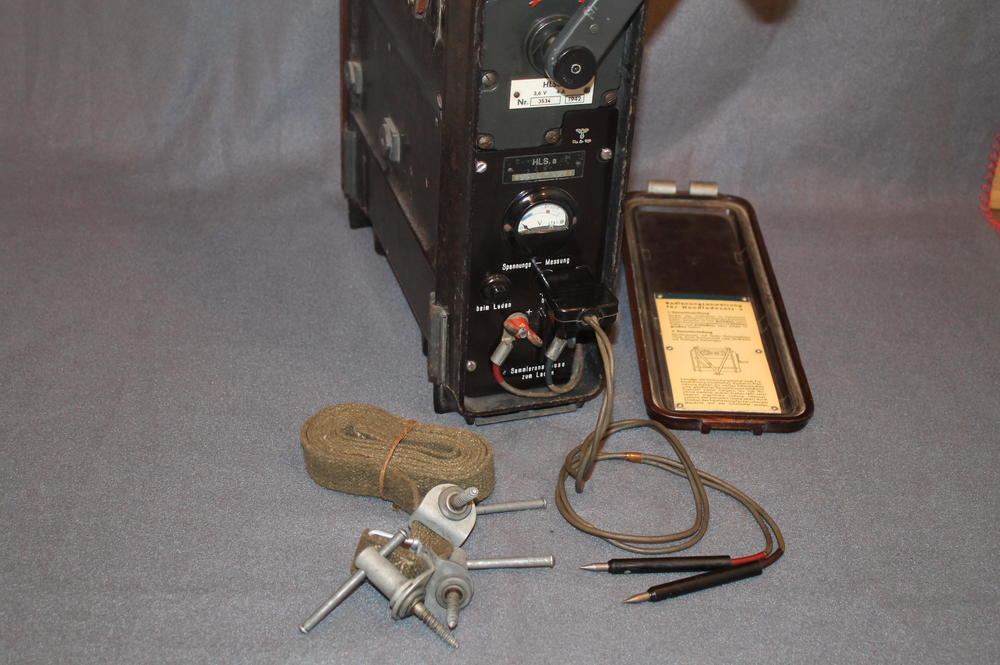

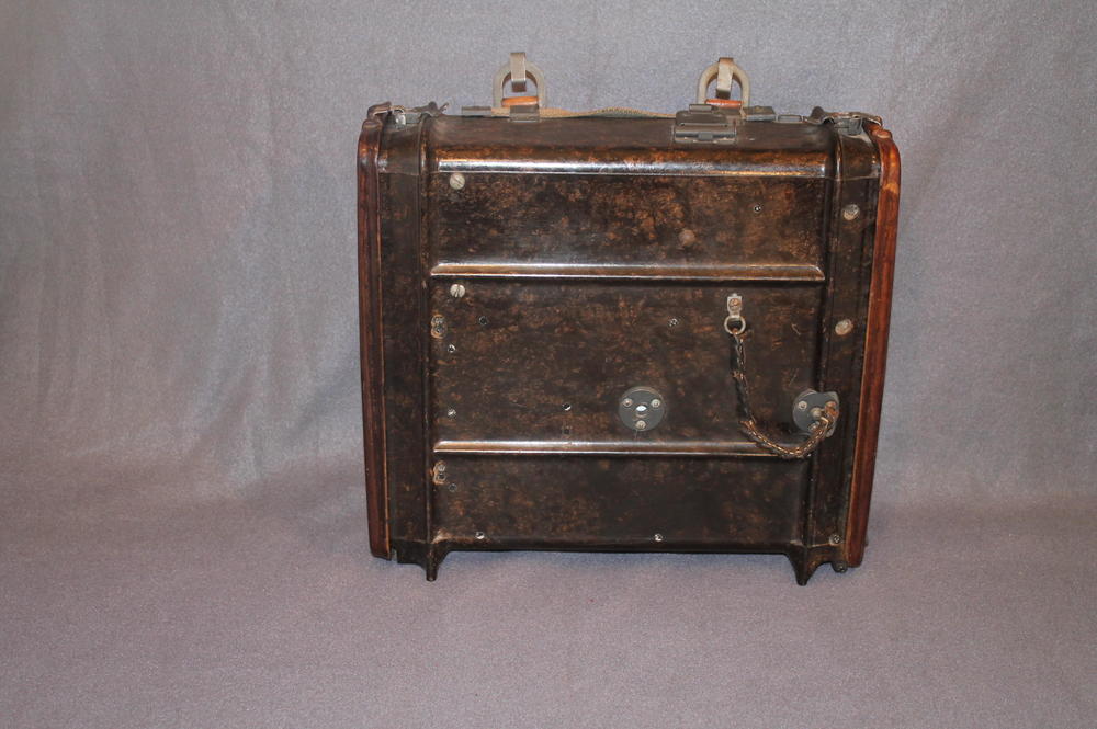

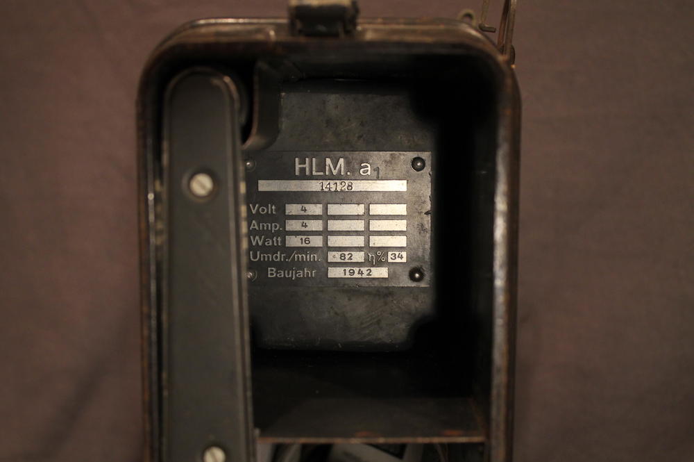

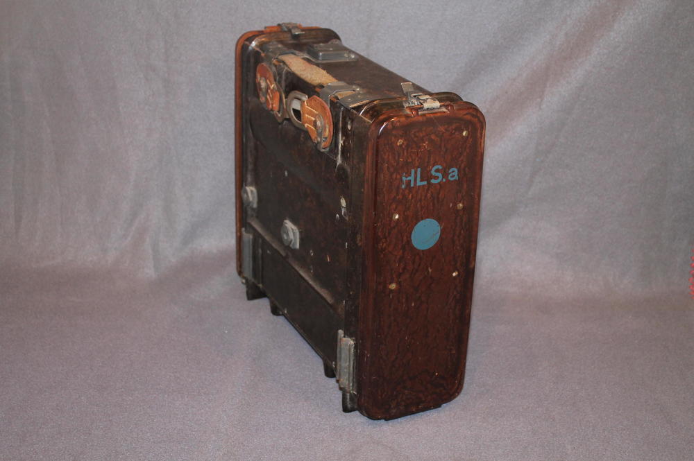

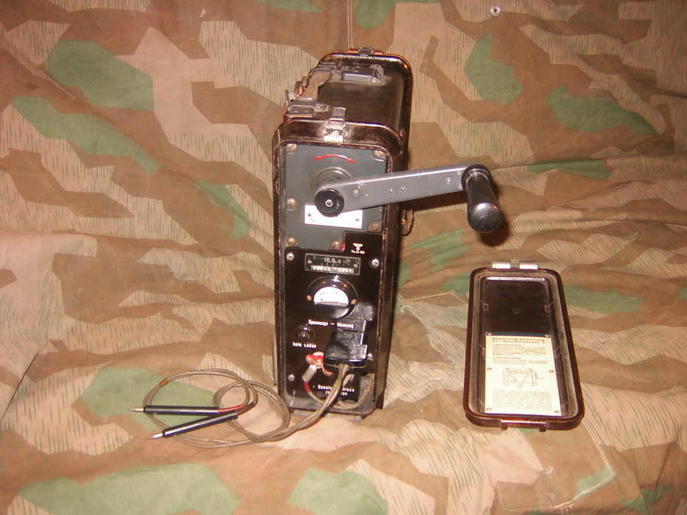

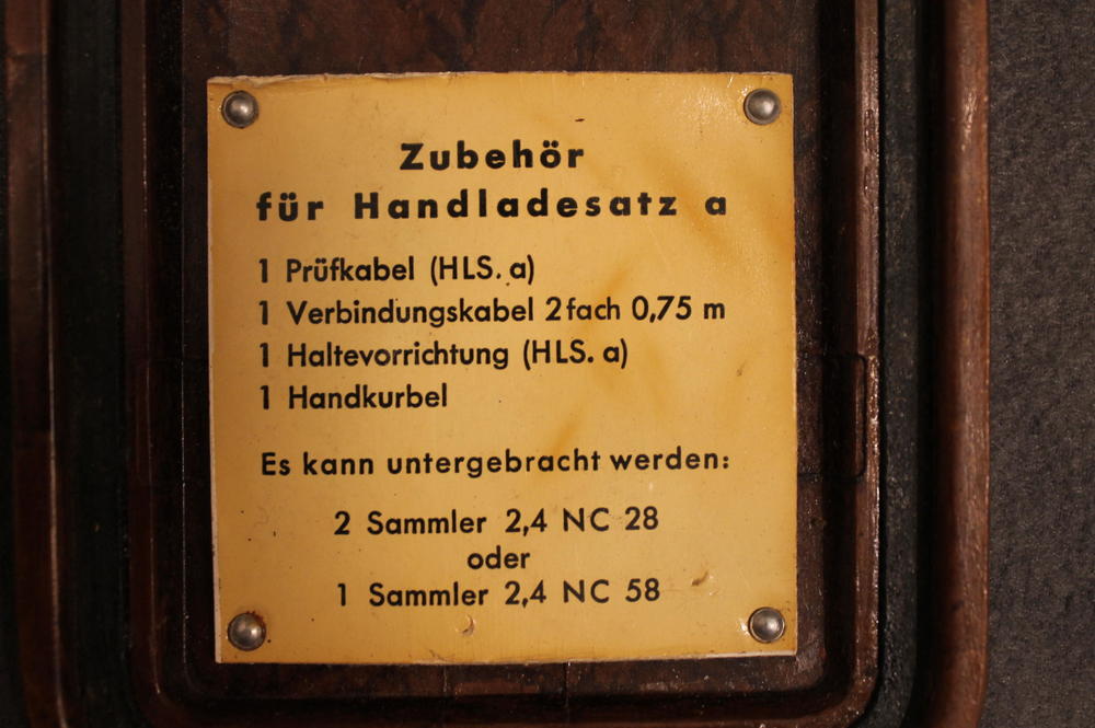

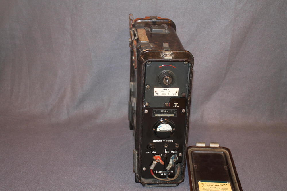

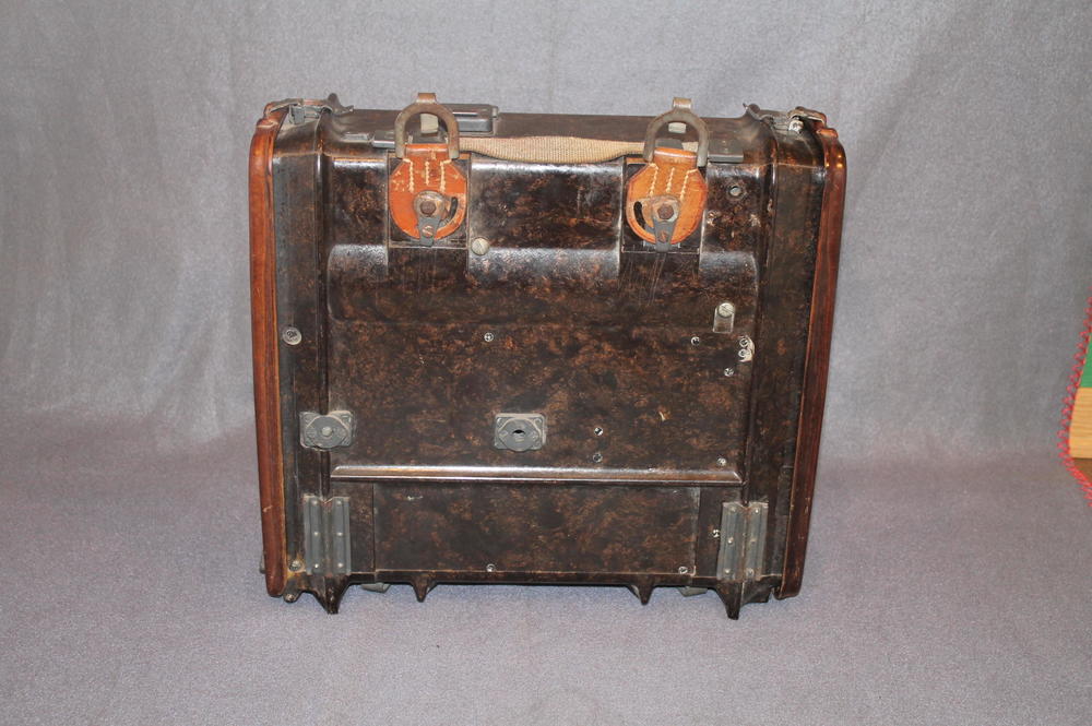

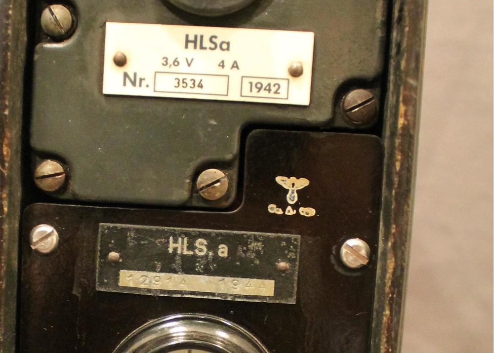

Here are some pictures of a HLS a - Handladesatz a that I have in my collection.
It is complete with all the parts, but it has two different Typenschilder / Dataplates. It has been put together or repaired with different parts.
But other than that, it looks very nice, and it is in working condition.
It came into my possesion together with one of my Feldfunksprecher b's in a trade i did with a fellow Norwegian collector in 2005.
I hope you like the pictures 🙂

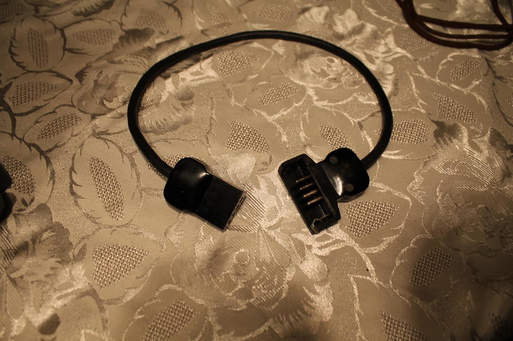

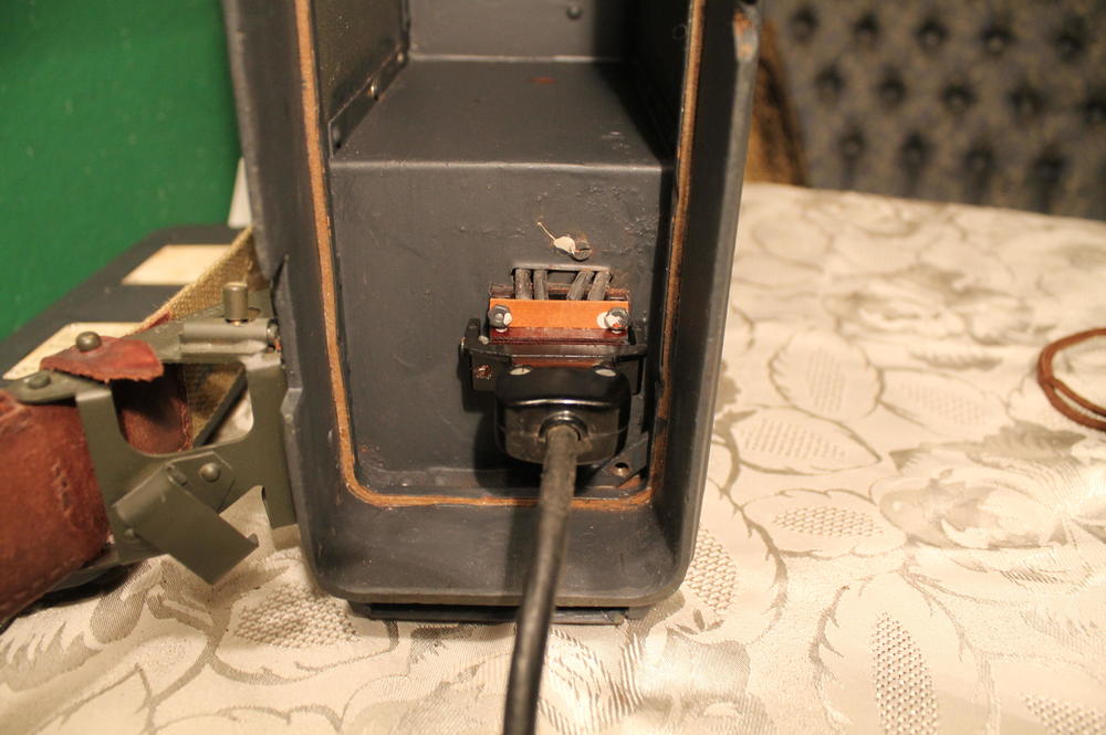

Friday night after a long week at work. (and christmas preparations) I'm winding down with a small cognac.

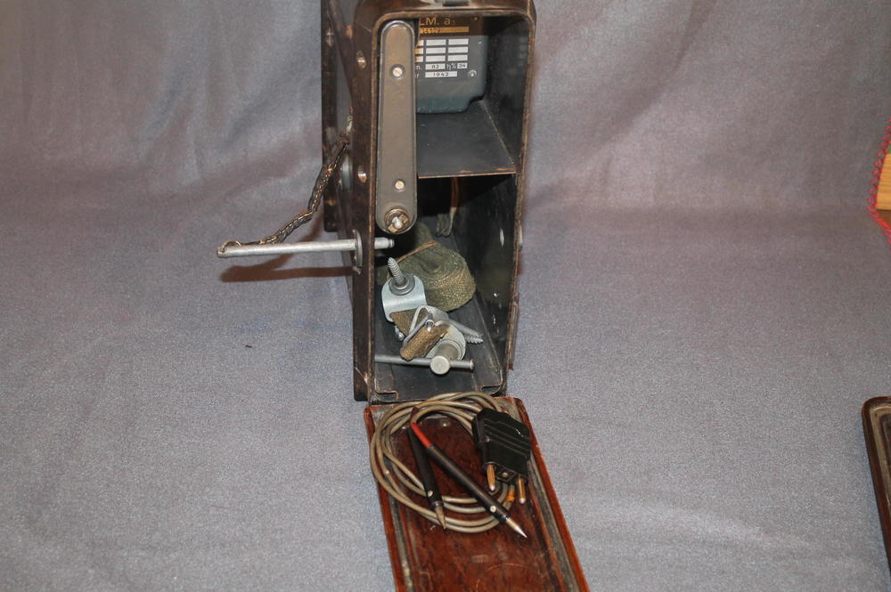

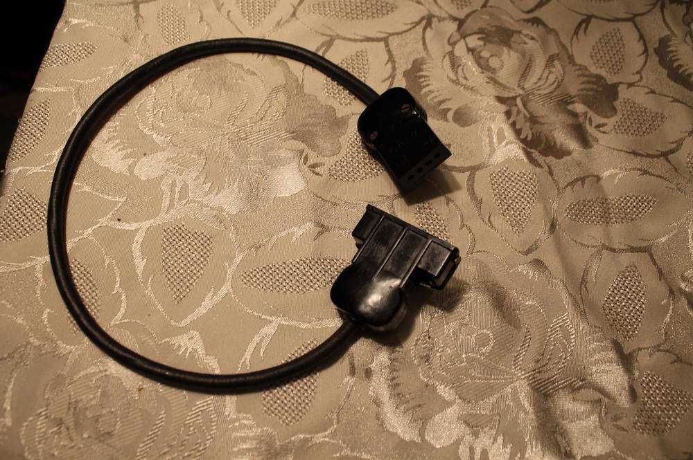

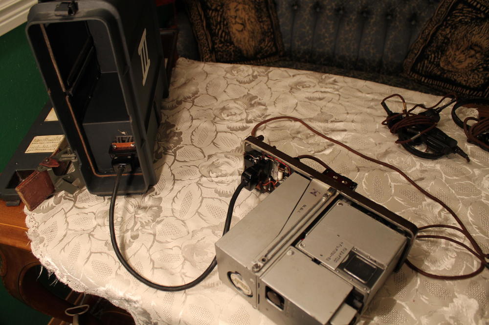

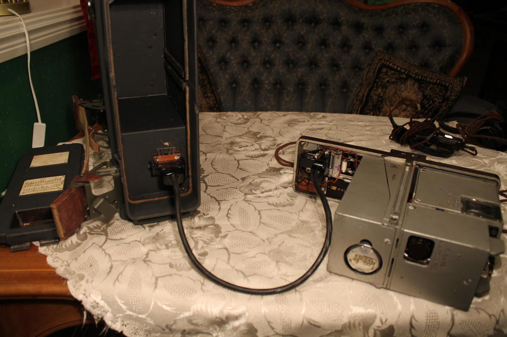

In the midst of shopping for christmas gifts, I actually stumbeled across a original Feldfu. Prüfkabel, or test cable, as shown earlier in this thread by Funksammler.
It's the first cable like this, that I have ever seen for sale.
Needless to say, I just had to have it. I have just tested it between the radio and the casing, and it works like a dream.
Cheers 🥃
Björn
Great find, these are quite difficult to find. I got mine also quite by accident, its the best way to find stuff!

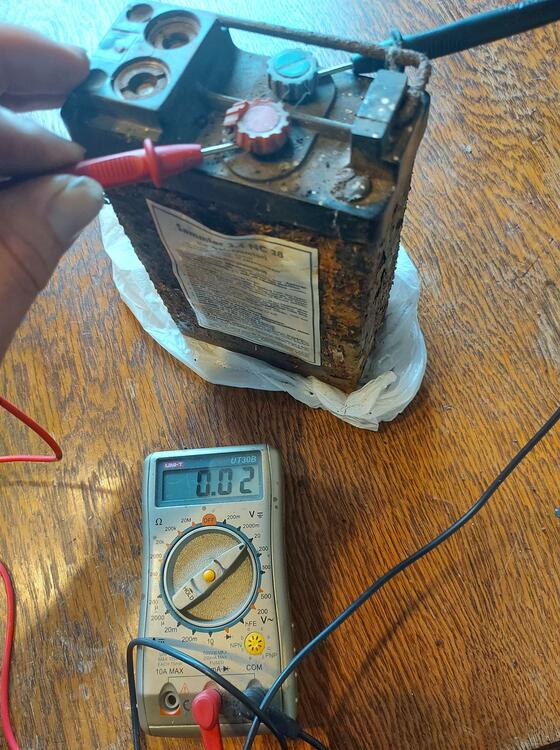

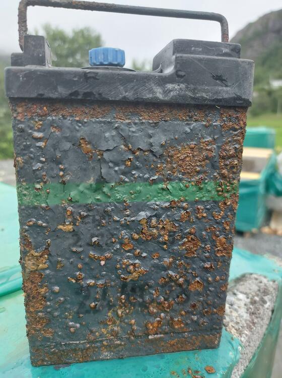

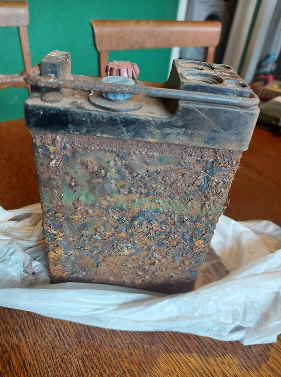

About an hour ago, I picked up a parcel at my local post office.

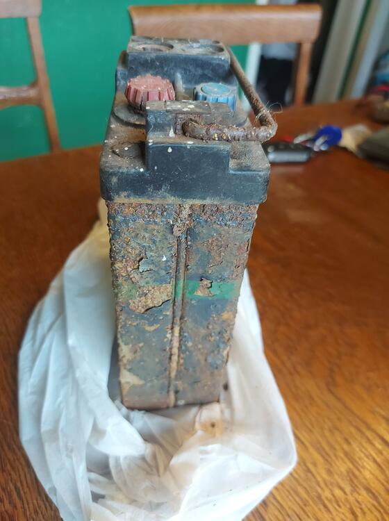

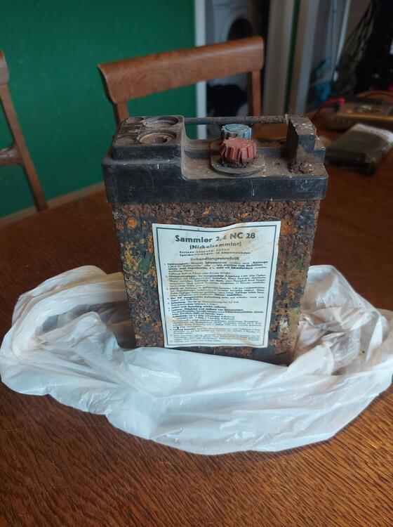

Here are some unboxing pictures. It's a ground dug 2,4 NC 28 out of ebay.
It looks a bit rough, but from the sellers pictures, it does not look like it has rusted any holes in it.
I wanted to do a experiment, and see if there is any chance of bringing this rare battery back to life. If it can't be done, i will restore it into display condition.
Unboxing pictuers. Have a look:

These batteries seem to be bloody indestructible!

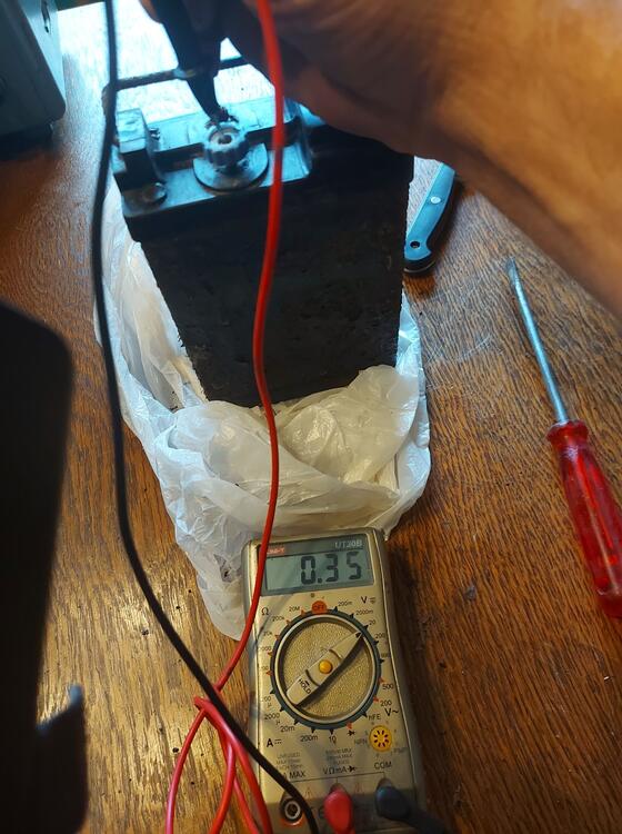

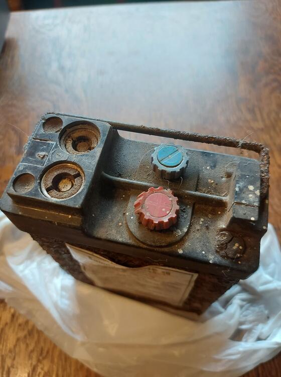

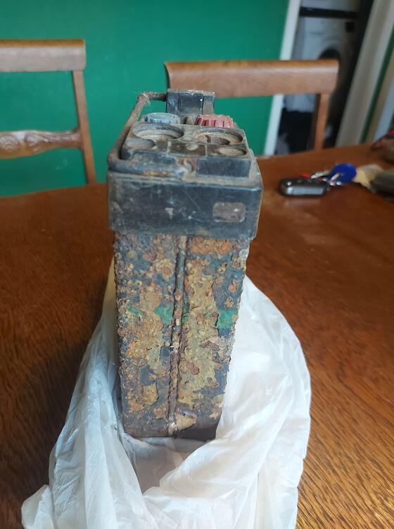

A lot of rust, dirt and grime. The connection nuts were frozen, but by scraping a bit on the posts, I got a initial reading of 0,02 Volts at the posts.

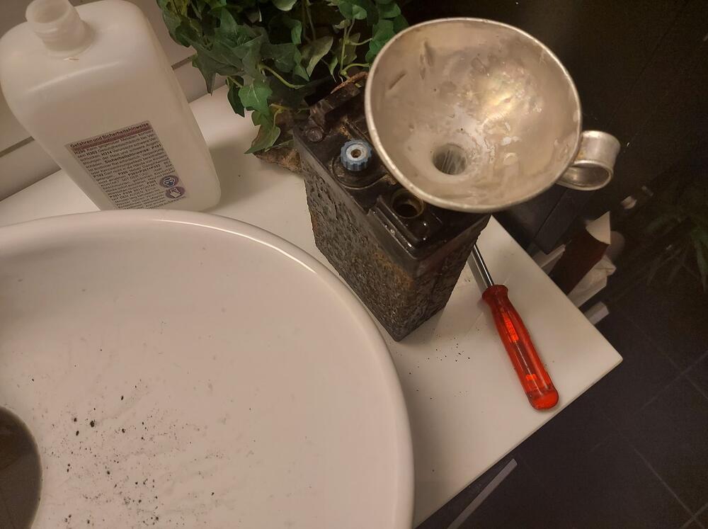

So I took the battery outside, gave it a bath in oxalic acid and tried to clean it a little bit.
Original paint appeared, dark gray. And part of the stencilled legend actually became visible.
I was able to loosen the nuts at the posts. ( I have carefully taken off the red plastic on the positive post, and will glue it together and back on the nut again.

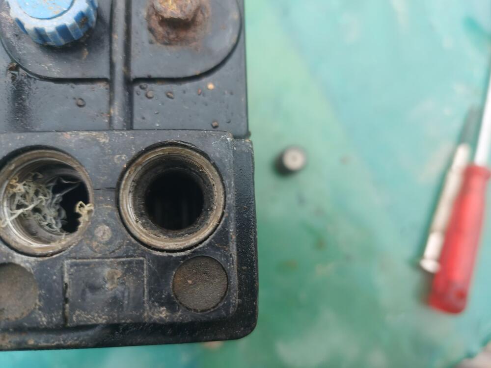

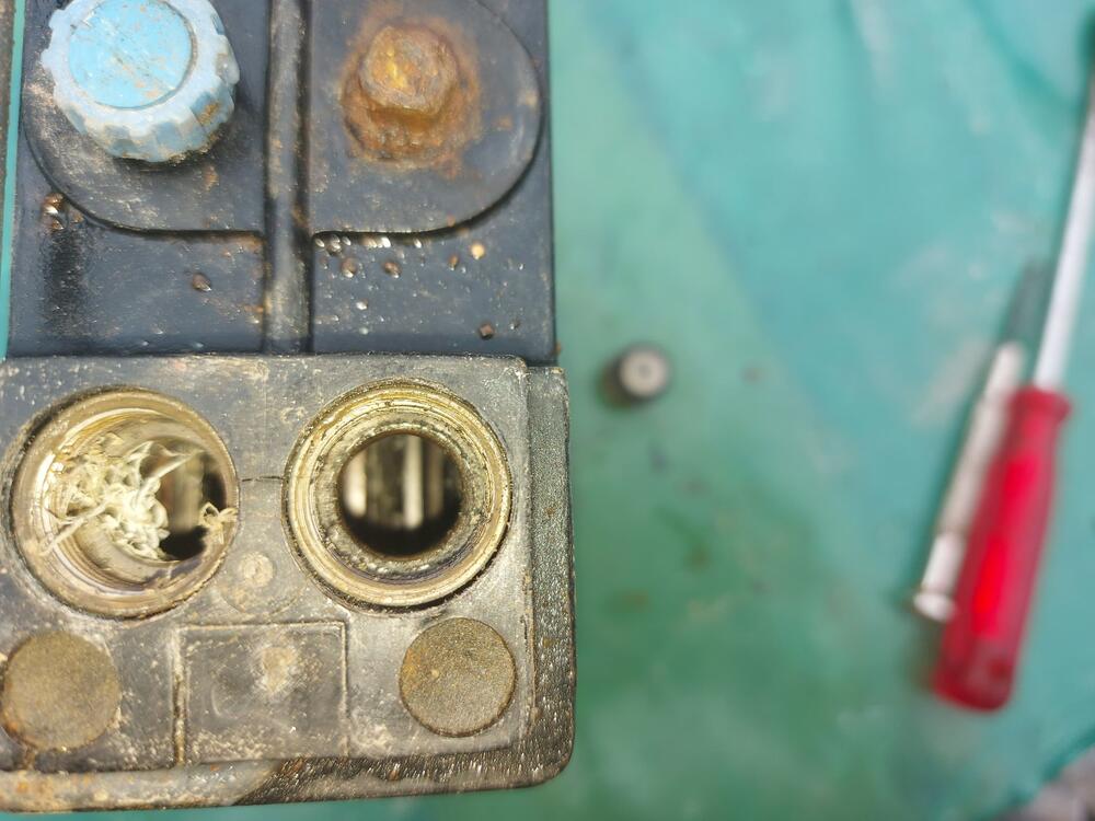

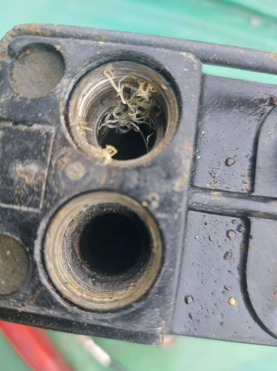

I also got the filler plugs out. Look atr this. It looks like that there is some life form growing just under the filling plug at the negative side. I was able to take it out, it was not growing further down in the battery.
But anyway.

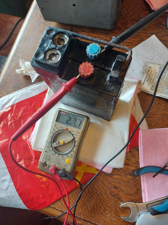

When I got back in, having cleaned the connection posts a bit, I tried to meassure the battey once again.
Look at this. 0,35 Volts.....
I have not done anything to the battery, other than clean it up a little bit on the outside
This is amazing. The battery has for sure not been recharged since WW2, and it still have som juice in it.
I will flush the battery and fill in som new Kalilauge electrolyte, and put it on a charging cycle. If I am lucky, I will have a third working battery for my feldfu radios. It only need some cosmetic restoration.
I will keep you posted, and let you know how this turnes out. I'm still a bit flabbergasted, that this battery still holds measureable power in it..

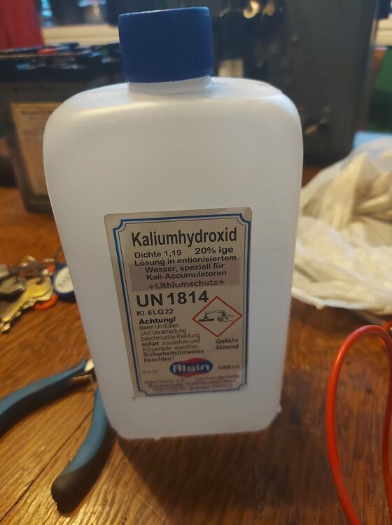

Some flushing pictures. I filled som more Kaliumhydroxyd in the battery and shook it, to loosen som grime inside. Here's a picture of the first (of many) flushings. The contents of the battery was pitch black.
Almost finished on this picture. Notice the empty bottle in the background - I spent a Liter of Kalilauge, just to flush out and clean the battery inside:
And Here I am finished with the internal cleaning.
The battery is topped up with fresh Kalilauge.

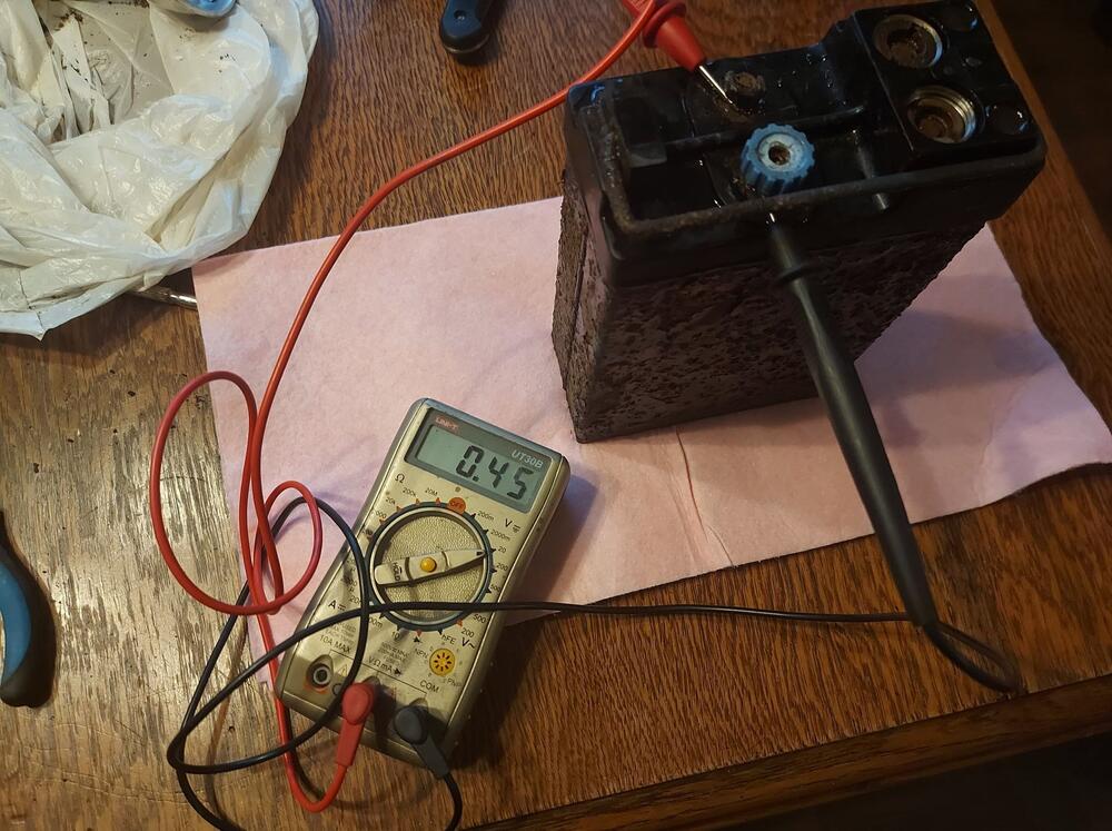

I just wanted to do a measuring, before I started to try and charge it. 0,45 Volts.
Gentlemen, I believe we have a live one:
I bought 10 Litres of Kaliumhydroxid a few years ago from ebay. Should last a whole lifetime for me, on just 3 Batteries for the Feldfunksprecher :)

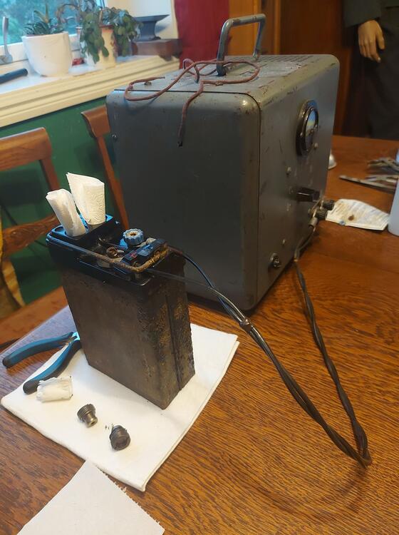

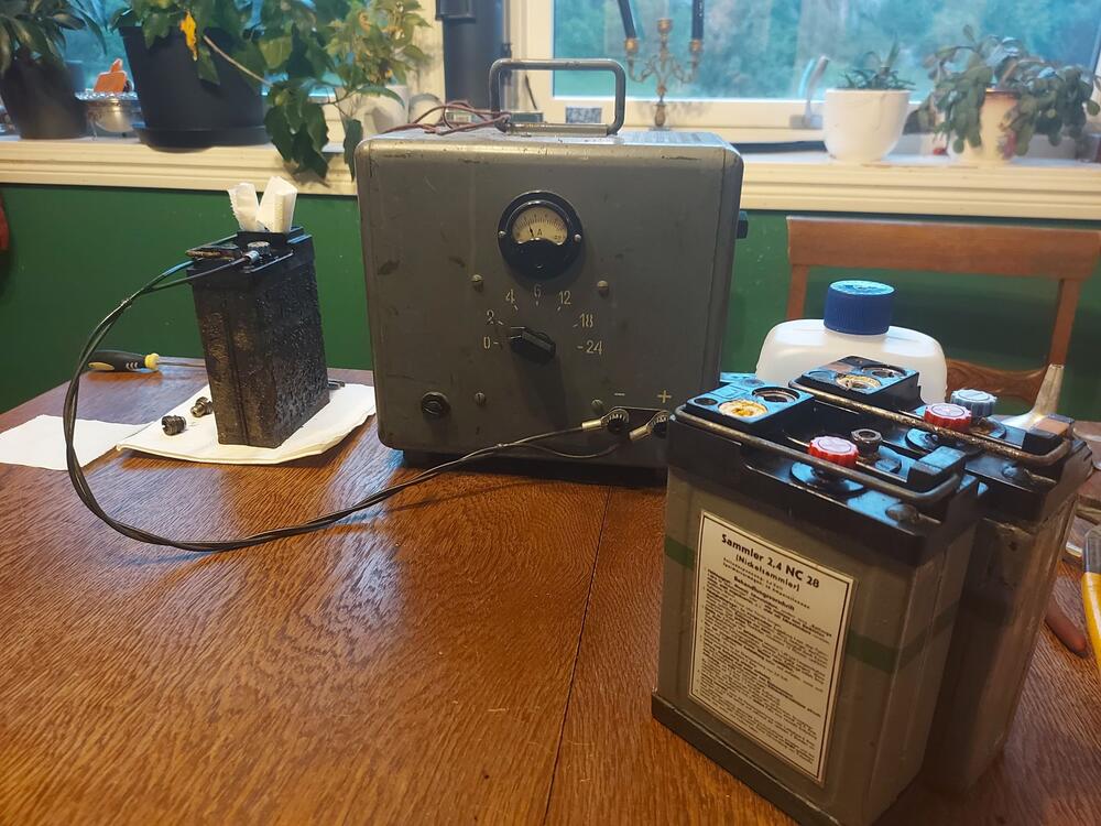

And here we go.
The first charging cycle in around 80 years. Everything looks good so far.
I will go over my other two batteries as well, and give them a charge, in the next few days.
I put some small pieces of toiletpaper in the filler holes, to prevent spills from the electrolyte during the charging. Small bubbles of hydrogen started to appear almost immediately when I powered up the battery charger.
I will let the battery stay on charging until tomorrow morning.
I will keep you updated on how it goes.
